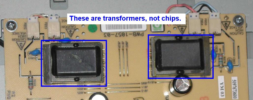

                        Re: HP W22 lights up then goes dark.
                        Originally posted by Logistics
                        this particular little guy has a little bubble on one corner that has a white streak through it, but it isn't dry like other burned IC's I've seen, it's shiny.
                        I've has south bridges burned out by bad PSUs that had shiny spots.
                        Basically means it got hot enough to melt the casing.
                          Originally posted by davmax
                          It would help greatly if you could supply a picture of both the top and botton sides of the power/inverter board
                          Is this it?
                          Presonus Audiobox USB, Schiit Magni 3, Sony MDR-V700
                            O
                            I
                            C

                            • gonzo0815
                              • Feb 2006
                              • 1600
                              Most likely one of the CFL inverters transformer is bad, if cfl tubes and mosfet transistors are ok.
                              The over or under voltage or current at the high voltage output is monitored by the smps controller IC.
                              If it senses an failure it shuts down. I have seen this in some Medion 19 TFT`s. You can`t do much there, as you won`t get a suitable replacement transformer.
                              in th end the only way to fix it are those rather messy things like a complete cfl inverter or a completely new electronic innards.
                              At ebay you can get full electronic assembly for LVDS panels for about 50$ or four tubes cfl inverter for about 10 to 20$.
                                Originally posted by PCBONEZ
                                O
                                I
                                C
                                Nah, the IC with the white spot is on the opposing board with the audio stage and other stuff on it. I see why you thought I was confused, though.

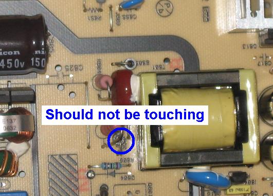

                                        I know this is an old thread but I still have not resolved the problem with me unit. I just got back at it. when I plug the thing in I get a hissing sound at one of the backlight connections and it is actually burning with smell and smoke. If I disconnect that backlight the screen comes on and than goes off again but no burning. Is this a failed mosfet transistor? I am not sure how to test these transistors Do I have to take them out or can I determine this in circuit?
