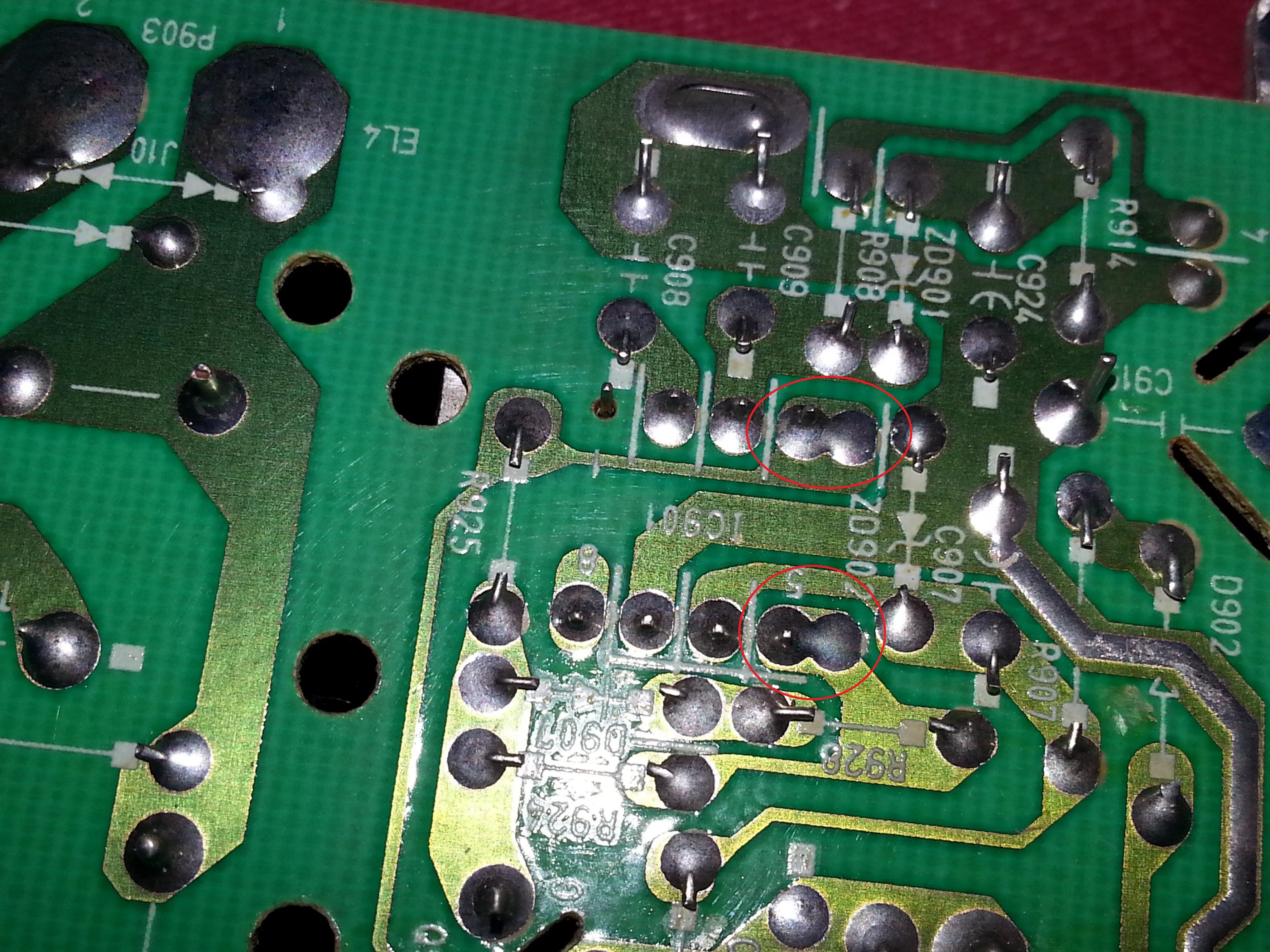

      Re: LG L1810B no life

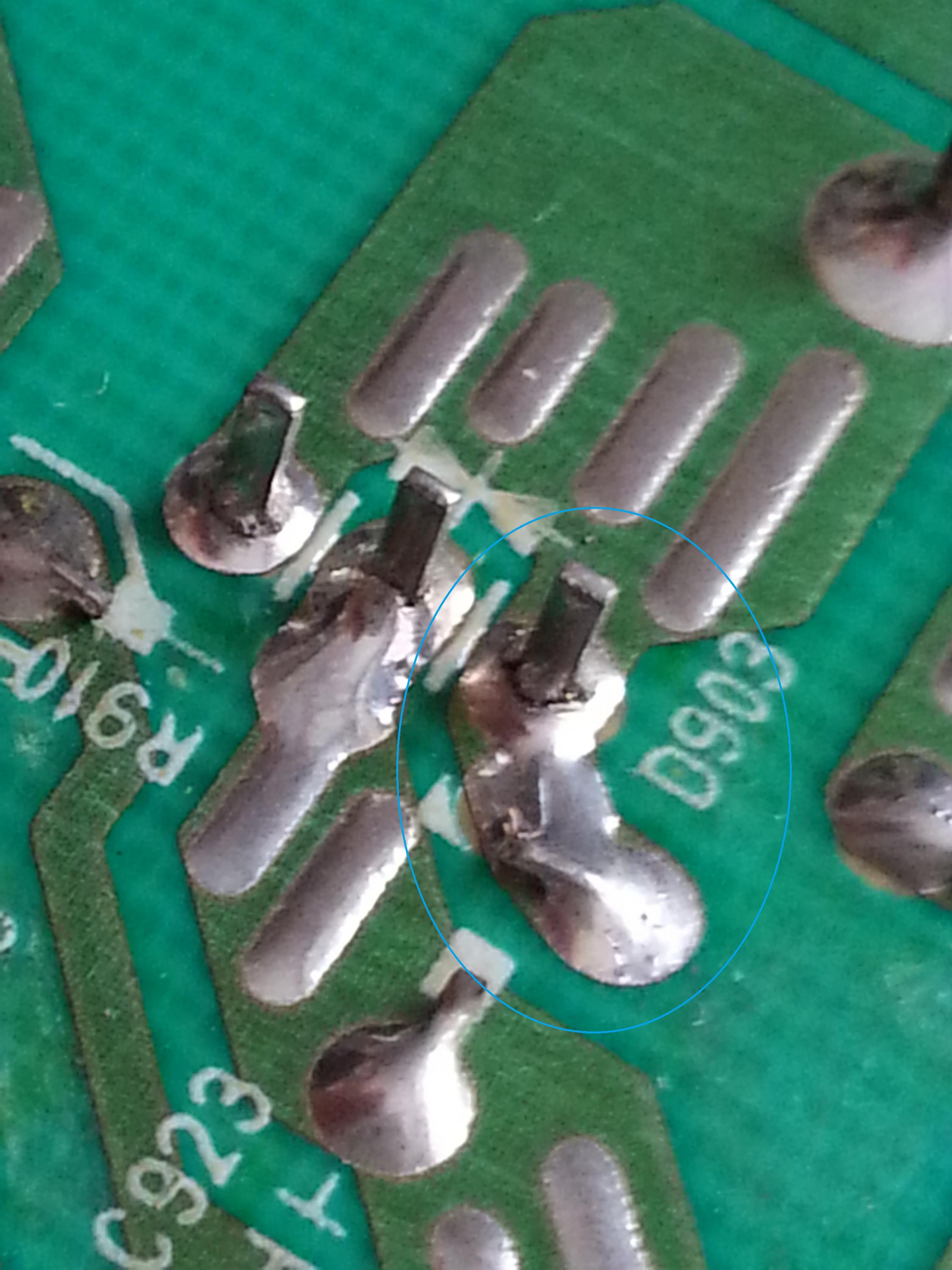

      Can someone help me please, are those solders good up there or not ?
      And why some pins are solder like this (in red circle) is that normal ?

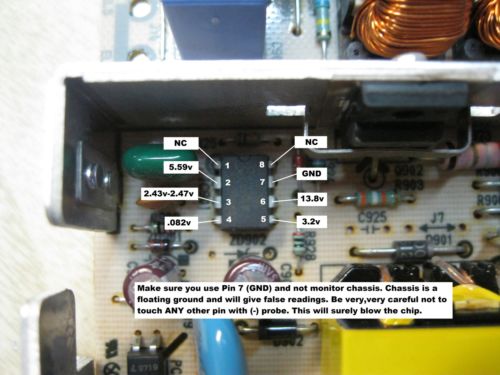

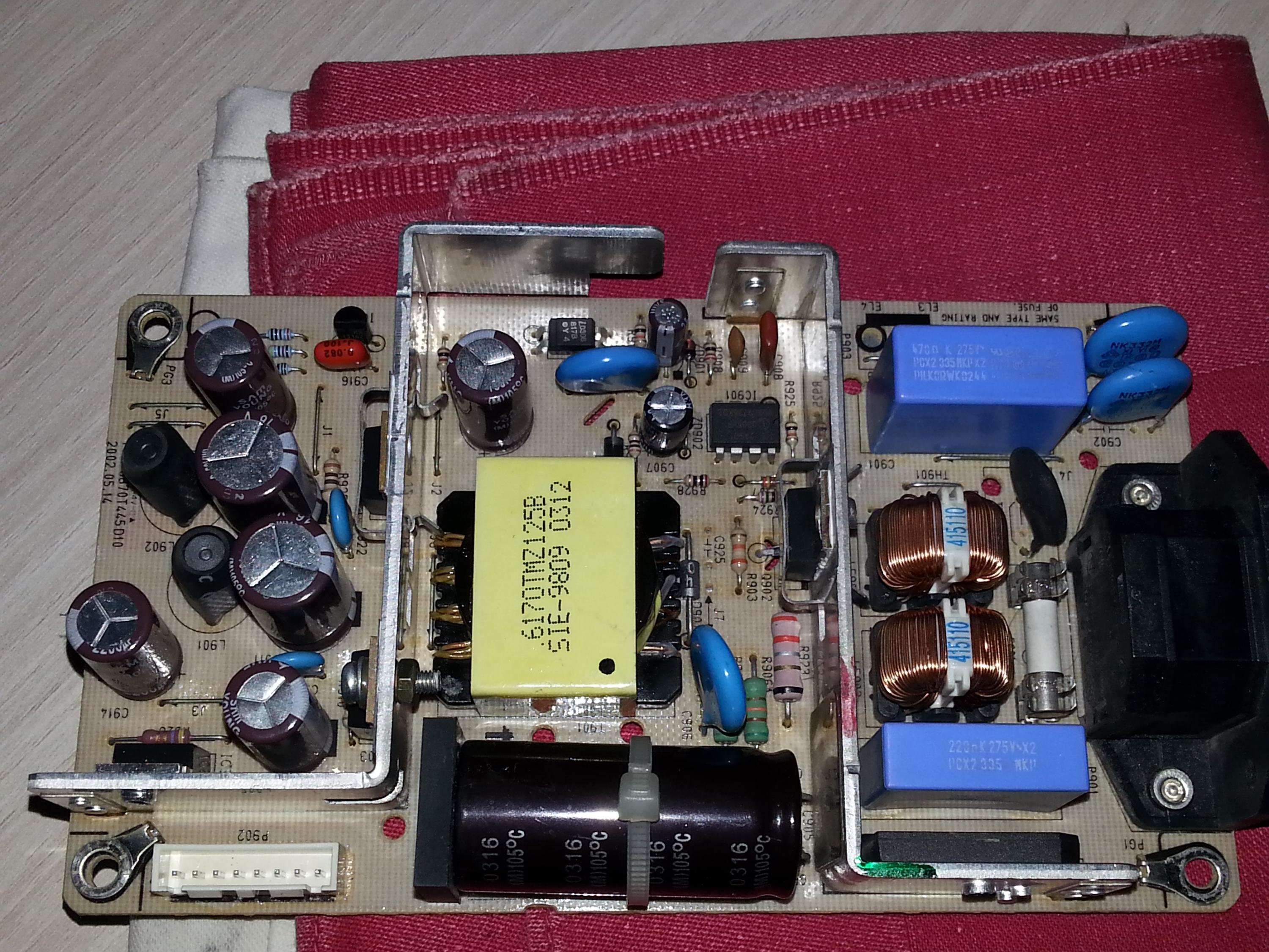

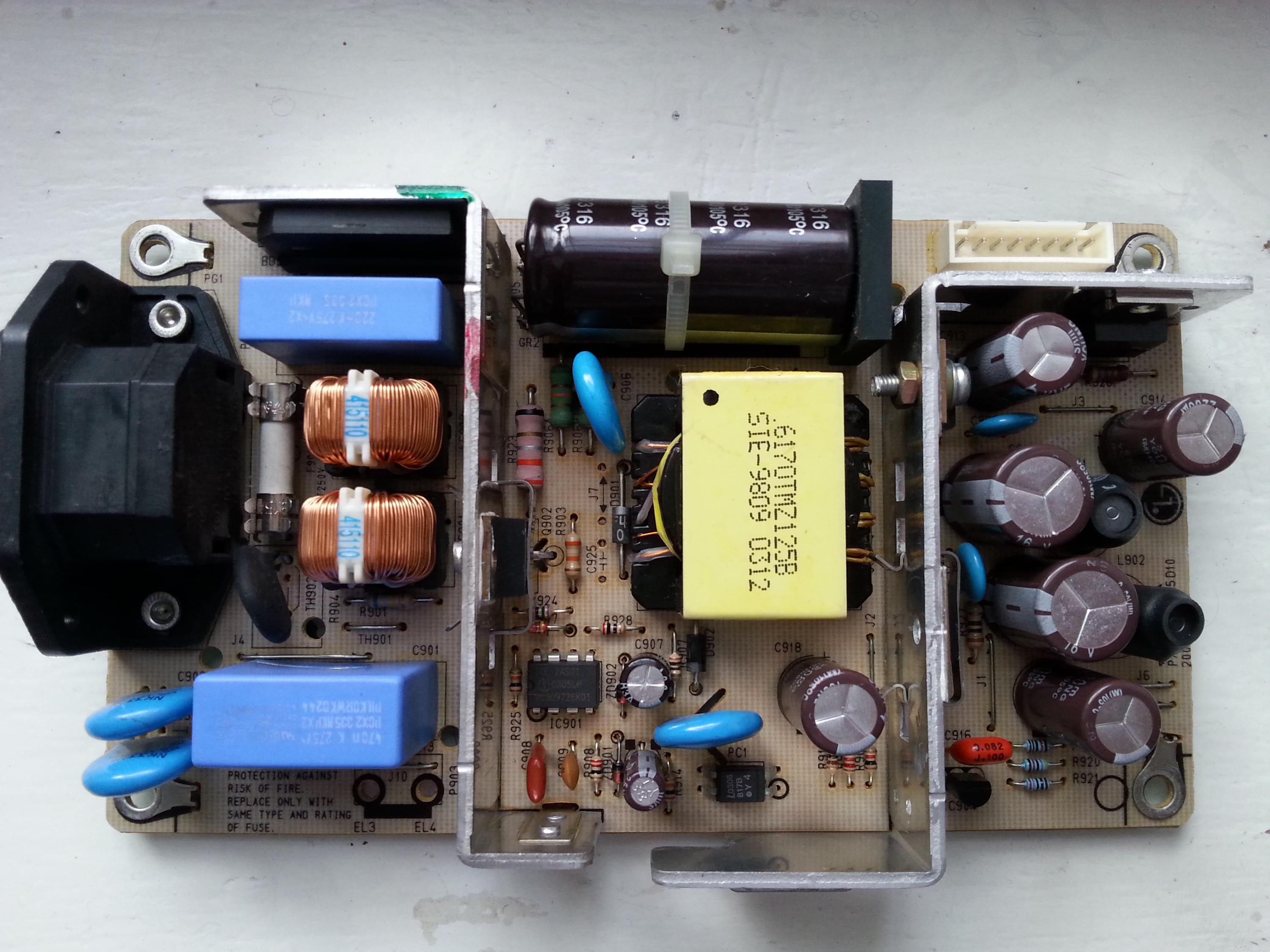

          Originally posted by Thermaltake
          problem is there is no life when I plug it and he said it is like that for a while.
          Check for standby voltage. It should be present on at least one of the pins on connector P902. For this voltage measurement, measure with respect to ground (monitor metal chassis), since this is the secondary side.
          Also, post a picture that covers the whole solder side of the power supply board. That way, I might be able to tell you which pin(s) provides the standby voltage.
          My friend told me that I have to plug cord into power supply and measure pins(he gave me the picture how to do it, also attached) can someone confirm if that's okay I mean I don't have to push Power button right, just plug it and measure ?
          Correct.
          The instructions your friend gave you to measure with respect to primary ground (pin 7 on that IC or the negative [-] pin of the big capacitor) are correct.
          That said, the voltage you are getting on pin 6, Vcc, (13.8 Volts) suggests the ICE2AS0 PWM chip is working normally. If there was a problem, that voltage would pulse up and down (though, even this may be okay, as long as the voltage on pin 6 is above 8.5 Volts and below 21 Volts). Either way, I don't suggest you change this IC yet. I think the problem with the monitor may be elsewhere. Could even be possible that the problem is on the video board.
          Once I see more pictures of the underside of the power supply and you determine that there is a steady standby voltage going to the video/logic board, then we should be able to narrow down where the problem is.
          By the way, here is the datasheet for the ICE2AS0 IC, just for reference in case we do need it:
          Solder looks okay to me. If it's cracked, you will see crack "rings" around the joint in many cases (though sometimes, they can be very thin and almost impossible to see).
          Yes, this is normal.
          Sometimes, solder spots like that are used as "test" pads (where a needle or probe at the factory checks the voltages at those places). Other times, it it just leftover solder mask from a possibly previous (older) revision of the power supply board.

            One more question, how come then green led on monitor is not showing when I plug it, I mean If voltage is not coming to P902 I think green led would still show but monitor would have some problems turning on, right ?

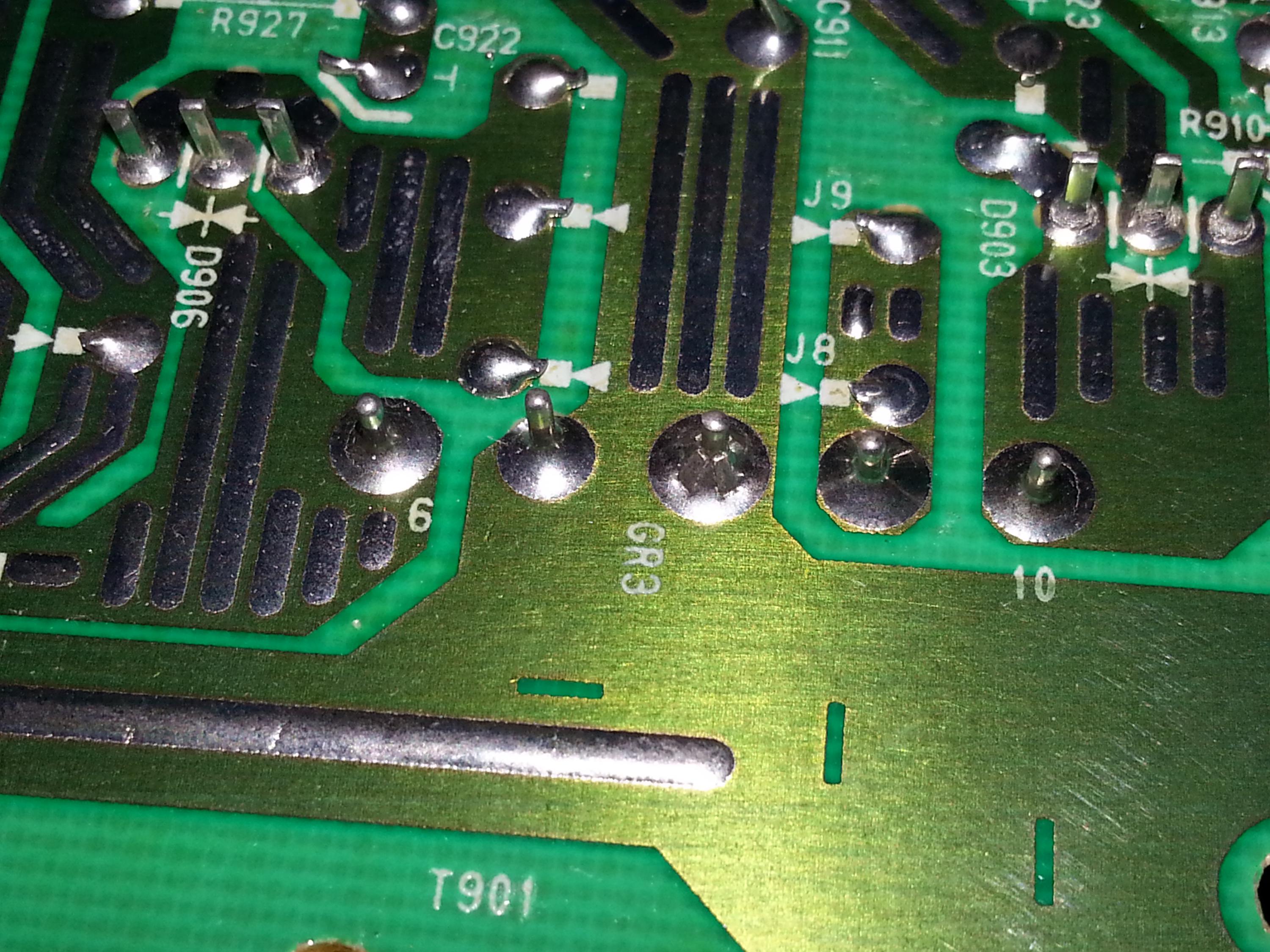

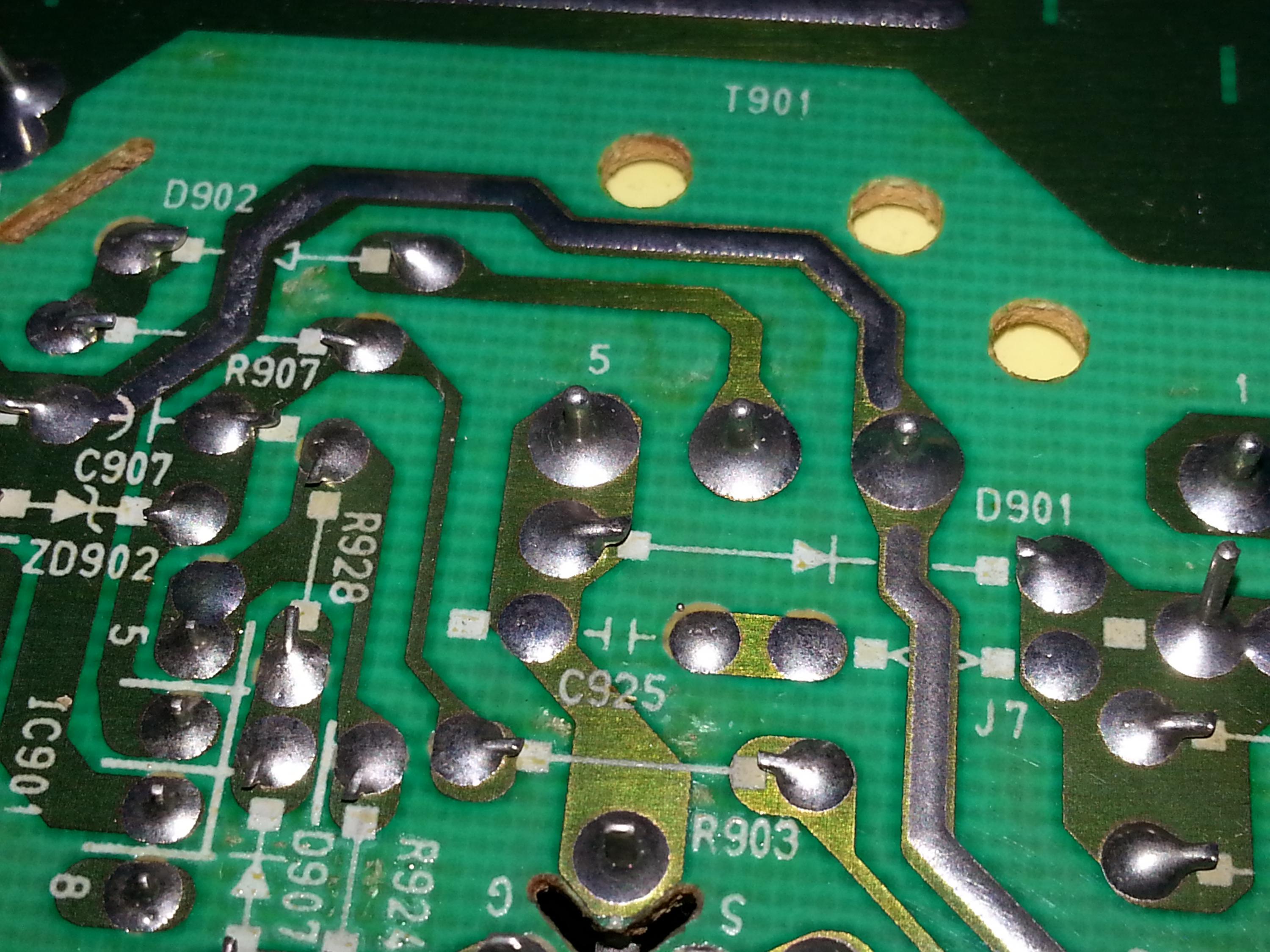

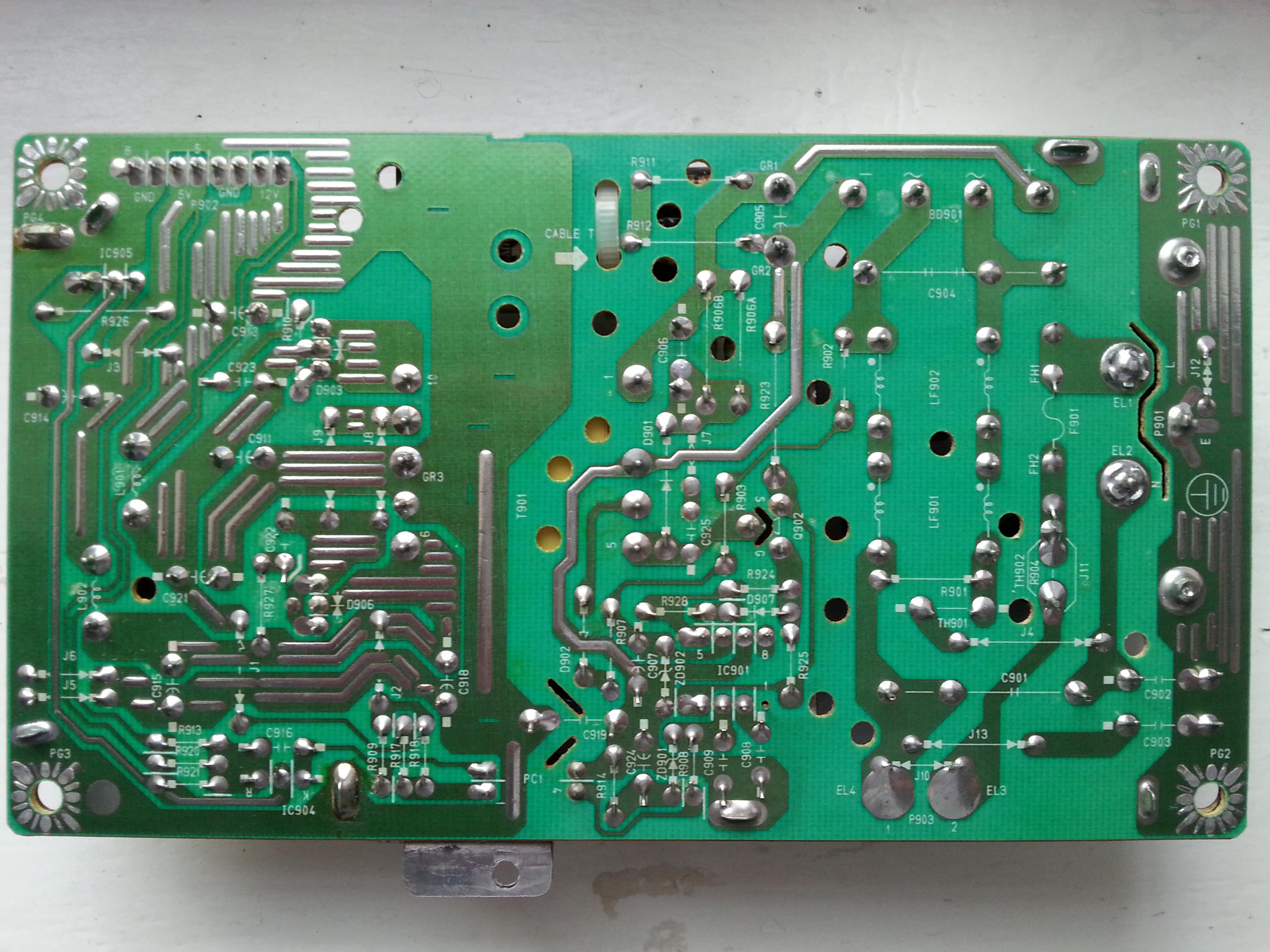

            here are picture of the whole board down and up
            I forgot to mention I remove all the glue from the board I read it can make problems with conductivity after some time and turn brown (like case I had one Samsung LCD Tv).

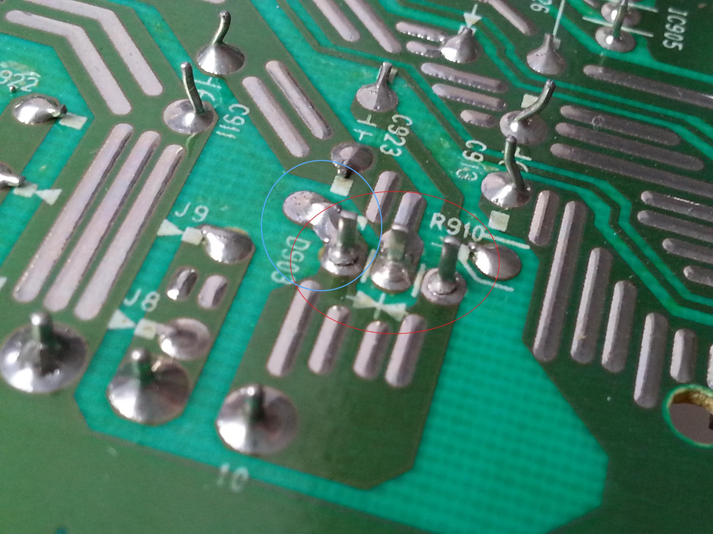

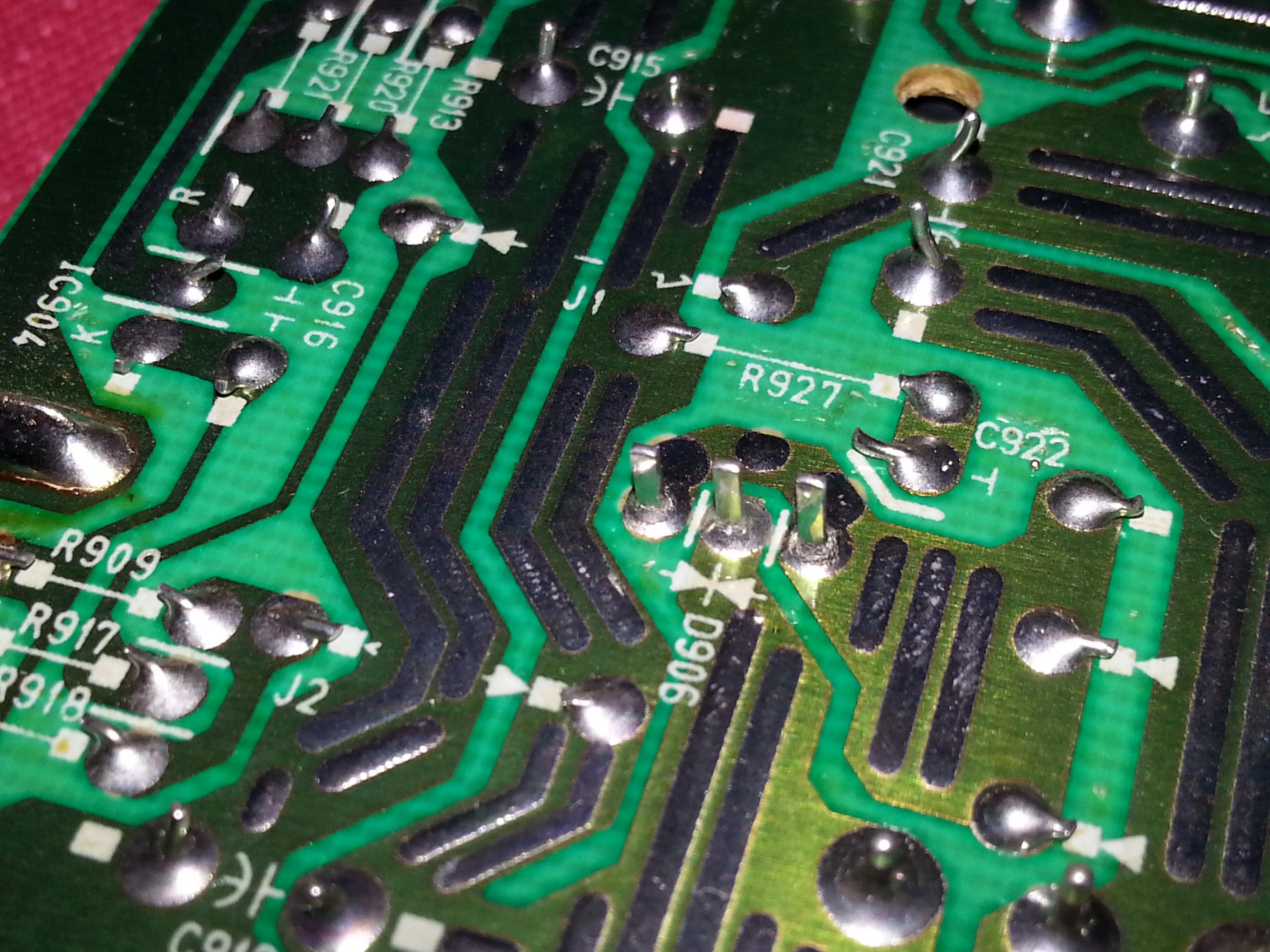

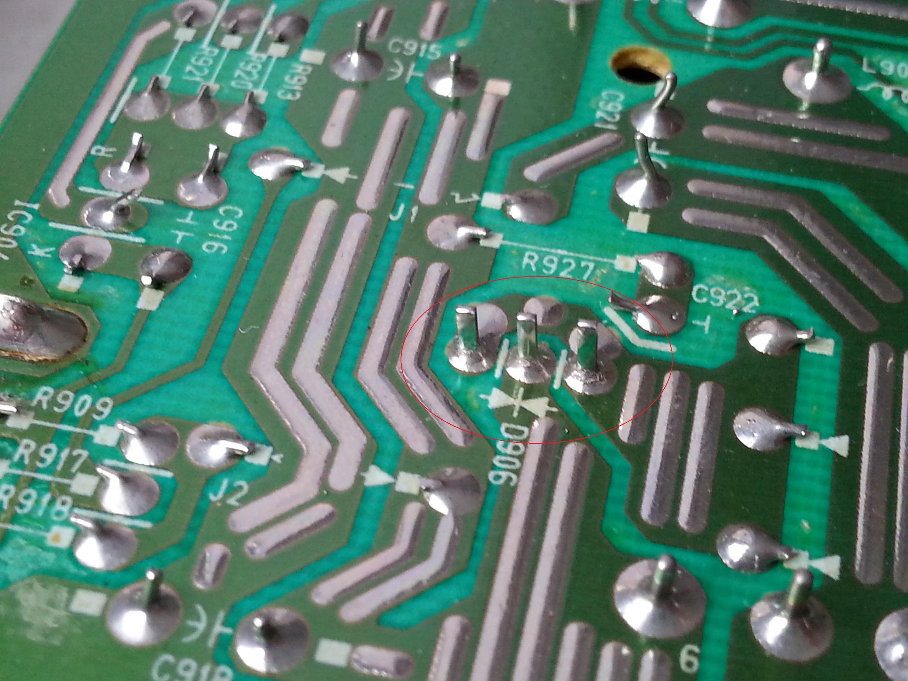

            EDIT:
            Found a problem broken solder on D903 and on D906 that right one don't look good (pictures attached).
            I will resolder them today. But when I resolder them can this happend again or was it just a factory fault with bad solder ?
            Could just those solders be a problem or IC chip die when it cracked too ? I circled with blue color this solder it looks strange like solder was connected with that other solder and it's shorted or thats normal ?
            And thermal paste under mosfets is dried and hard I know on PCs when it's like like that chip is heating up like crazy.
              The power supply in this monitor has only one transformer. That means the power supply is turned ON all of the time, regardless if the monitor is ON or OFF.
              Now, it's good that you provided those pictures (particularly, the solder-side shot), because I can see that connector P902 has the voltages labeled.
              Pins 1 and 2 -> 12V supply (probably logic board and inverter)
              Pins 3 and 4 -> ground
              Pins 5 and 6 -> 5V supply (probably only to logic board)
              Pins 7 and 8 -> ground
              If you do some back-tracing, you will see that diode D903 with the bad joints is for the 12V supply and diode D906 is for the 5V supply. There is also IC905 - not sure what function it serves (my guess would be the PSU voltage output is lowered in standby mode and IC905 makes 5V from the 12V supply.)
              Either way, with the monitor plugged in, you should definitely see 5V on pins 5 and 6 of connector P902 and anywhere between 7 and 14 Volts on pins 1 and 2. Let me know what voltages you get, though.
              Therefore...
              Yes, definitely re-solder those joints. Could well be the reason why the monitor is not working. Also, have a look at the joints for diode D901. One side appears to have a very small "ring" crack. Diode D901 is located right next to the yellow transformer. I suggest you re-solder both joints, just in case. This is the snubber diode for the primary side winding. If its joints go bad, it will make a lot of other things go in the power supply.
              The bad solder joints could have been a factory fault, or they could have happened if the monitor was dropped or hit. Or it could be that someone else took the monitor apart before you and was too rough with it.
              I also see that the leads on some of the capacitors are very long. Was the monitor recapped before? To me, it looks like it has. And Sam Young capacitors aren't that great in terms of reliability. I guess you can leave them in there for now. But you might have to recap the monitor again 2-4 years from now again (maybe more if you are lucky).
              That's normal.
              The solder connects the anode side to the cathode side through capacitor C923 and resistor R910. C923 and R910 form a secondary-side snubber network for diode D903.

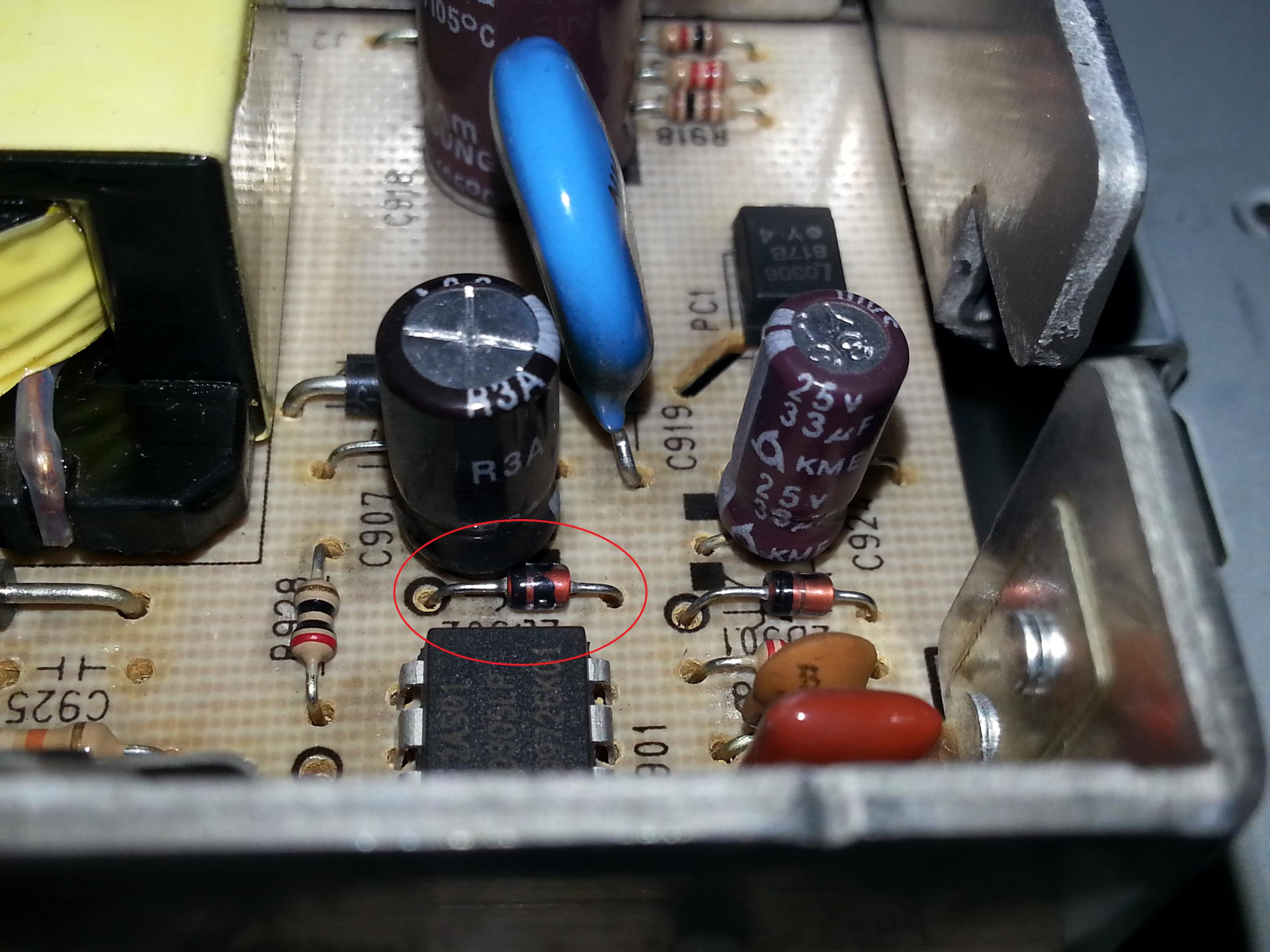

                  I noticed something on my PSU I have this zener diode, what is her purpose ? If she is protecting that IC chip maybe he is okay then, because on other PSU that I saw here on various topics on similar PSU from DELL monitors they don't have her. I need some details and explanation why is she on my supply and not on others is my like some revision 2 or something ?
                  On one of the topics budm said
                  Originally posted by budm
                  ...typical failure mode of the ICE2AS01: shorted VCC pin. You need to get the same IC, there is no sub for this ICE series IC. The later version of this power supply, they added 18V Zener Diode (Vcc pin to ground to clamp the max spike voltage to 18V) to stop the power supply from destroying this IC.
                  So I guess my IC chip is fine because of that zener diode I just need to resolder that mosfet and maybe change that caps around the chip. Ah there it goes 1.38$ in the air
                      Now I just have to wait for new IC chip to come, I read that when that mosfets solder crack IC chip died if that's true I don't even have to measure IC chip I will just replace it with new one that I bought for 1,38$ pretty cheap.
                      If the ICE2AS0 was bad, you wouldn't see the voltages you posted in this picture (especially the one in pin 6):
                      https://www.badcaps.net/forum/attach...8&d=1451921380
                      On one of the topics budm said...
                      Yes, that Zener diode (ZD902) is to protect Vcc (pin 6) of the ICE2AS0 IC from voltage spikes.
