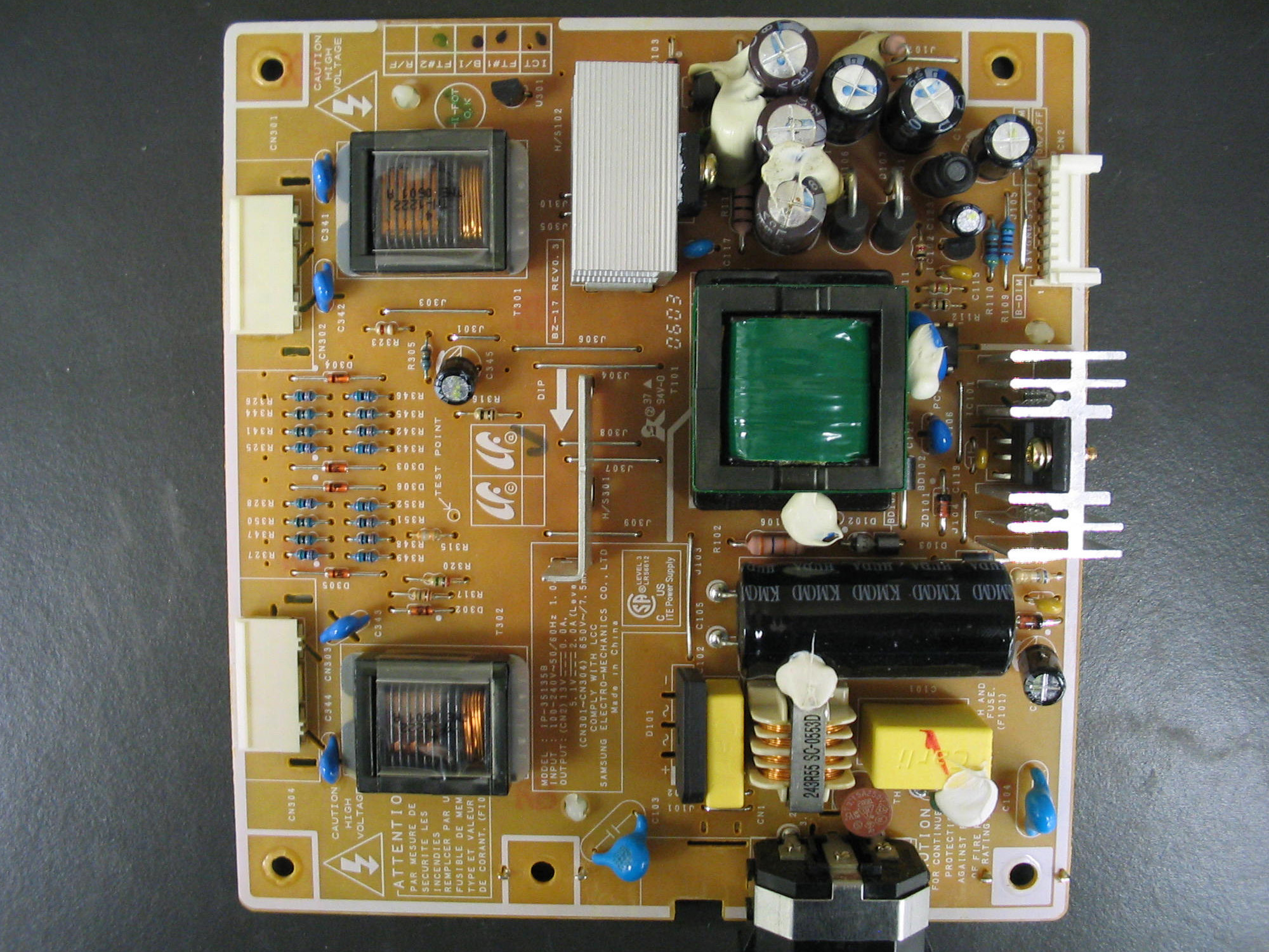

    I am new to this site and hoping there are a few of you out there that can help me get to the bottom of a problem with a number of Samsung 740N monitors that have been failing after about 18 months of continuous operation. The symptom is no picture and bulging capacitors on the power supply/inverter board. This is a typical flat panel power board where the backlight inverter and video controller power are integrated onto the same circuit board. The monitor is repaired by replacing the capacitors and replacing a fuse that supplies power to the backlight inverter circuit.
    Samsung has admitted to numerous failures of this type and is claiming that the failure is due to bad capacitors made by CapXon.
    However, I don't want to readily accept that this is the root cause of the problem.
    I am surprised that a company like Samsung would be using "bad" capacitors or that CapXon is still shipping capacitors that don't meet their specifications. It seems that the problem may not be as simple as having just used cheap capacitors. I am wondering if the problem may be a marginal power supply design overall and that the CapXon capacitors are just the first component to go. Or that the fuse may have failed first and caused the capacitors to fail. Is there any advice someone could give to get to the bottom of this mystery?
    Thanks for reading to this point.

    Welcome Sherlock.
    Bad psu design can be sometimes traced and recognized on schematics or on photos; however bad caps will fail even on good designs as well (e.g. Antec psu) simply because their quality is inferior and/or suffer from manifacturing defect (bad electrolyte formula or bad Al supplies).
    Posting a few pictures may help Davmax and Kc8's diagnosis.

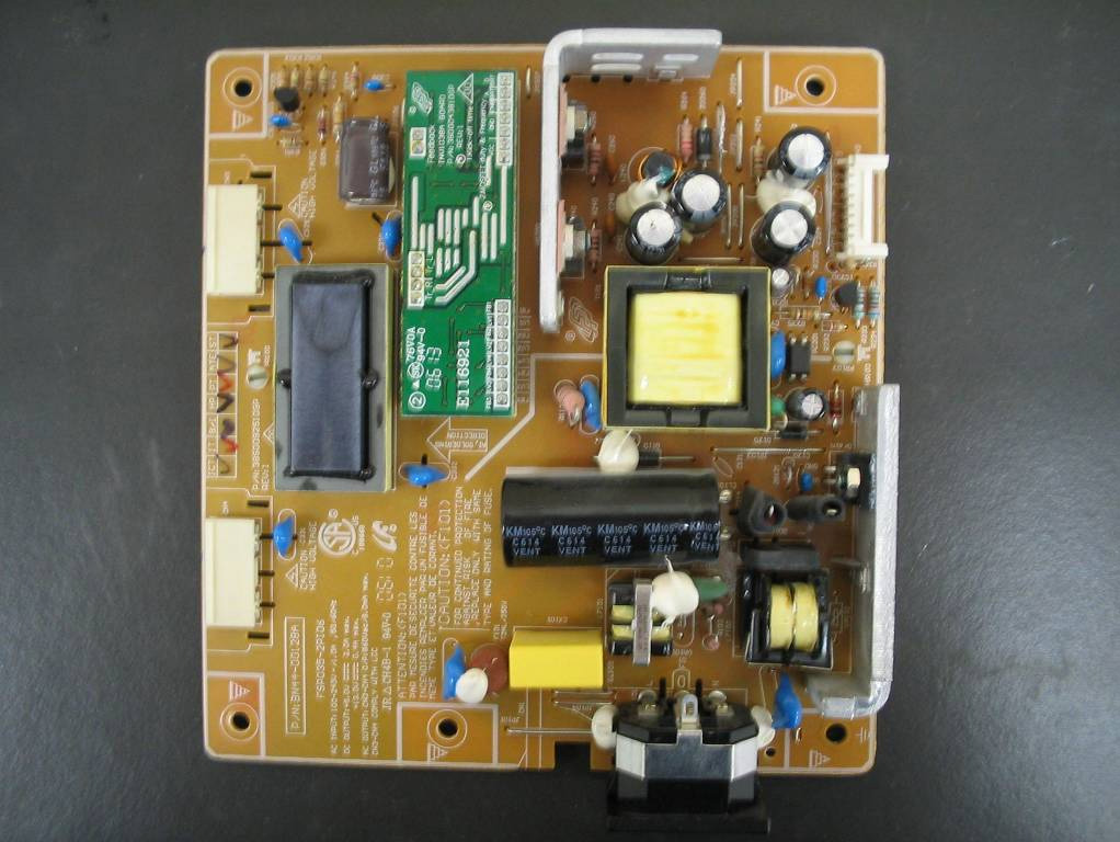

      Re: Problems with Samsung 740N monitors
      I took your suggestion and am posting photos of two different power supplies that are from 740N monitors. The encircled caps are all bulging. I know on the second one that replacing the caps and the fuse restores operation.
        Since your photo are quite big and putting them into a doc file is bad idea, I attach them to this post.
        In pic1 the failed caps are the black ones near the transformer: unfortunately is too out of focus to recognize them.
        In pic2 bulged caps seem United Chemicon ones (from the cross vent and that brown jacket): perhaps KZG?
        Try posting more detailed pictures and their signatures too: from top view I can guess caps only from vents and these are common to many companies.

        • i4004
          • Oct 2006
          • 2029
          that looks like typical topswitch (or alike) design, and there really is not much that designer can do with todays silicon but pick best surrounding components, which samsung didn't do in this case.
          so it's a good design with bad caps.
            those are samxon gl.
            known junk.
            they are a replace on sight part.
              Thank you for your comments. Just to clarify, the failed caps are CapXon. On the first photo, the failed caps are the three nearest the upper heatsink and they are CapXon KF 10v 1000uF. On the second photo, it's the three caps to the right of the upper heatsink. They are also CapXon but GLs 25v 820 uF. There are some SamXon to the right of those but they appear to be fine.
              So with that added information, are your conclusions the same?
              If so, why does a company like Samsung use caps from a known bad supplier? Maybe this doesn't surprise you guys but it is going to turn out to be a big warranty issue for Samsung. It seems that a company of their size would not slip up like this. Your thoughts on this subject are welcome.
                        @sherlock or to others
                        i have a samsung 740n lcd,
                        1st - the problem was no display produce, but there is power on the lcd
                        2nd - i replaced this three bloated capacitors as per instruction here
                        3rd - my lcd has display now but no lights, do i also have to replace the fuse?
                        if i have to replace it, where is the fuse located?

                          found the 3A fuse, but it seems its so hard to look for one, do you think masters it's really the fuse?

                            looking at the pic i'd say those inverter-transformers are toasted...

                              I think both transformers are fine... the black color is due to the part number printing. Please post a picture of solder side. The switching transistors are probably SMD ... and they could have gone bad.

                                well... okay.. the upper one looks fine... but what about the bottom one? the coils look much darker than they should be (right side ; input)

                                  @sir Scenic
                                  here is the pic of the solder side
                                  transformers are all fine its just the part number that it's makin it look bad
                                    finally solve the problem i replaced 3 capacitors and the the said 3A pico fuse
                                    it's now working
                                    thanks to all who helped
