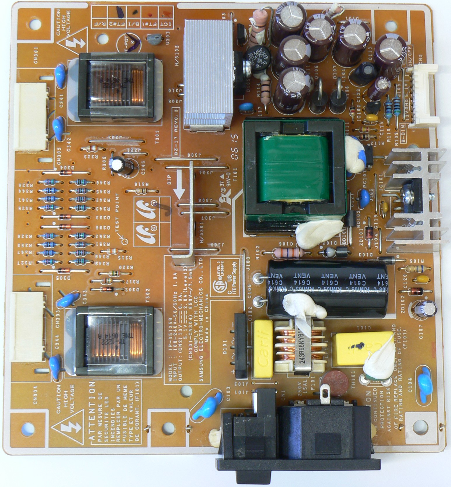

                  I have an 740N with a IP-35155A board. After switching the screen on the backlight is on for about two seconds and then goes off. The screen itself is still displaying, i can see it with a flashlight.
                  I replaced all capacitors which didn't help. The board has both transformators in one shell instead of two separate ones. The resistance on output side between 1 and 2 is about 1kohm, between 3 and 4 about 7.5kohm. So i think the transformer is faulty. On the upperside it has printed TM-1017, on the downside SEM1852. Where can i get a drop-in replacement for this transformer? I'm in europe.
                  Thanks.

                    TM-1017 is readily available on Ebay.

                      I have 740N and totally dead, led off dan smell something burn before it's dead. Before dead my 740N can be displayed but need about 5-10 minutes. I cek, one component, i don't know what it's melt, i can identified the series because the mark is missing, anyone knows what the cmponent it's?.
                      I'm also already change the 3 cap (1000uf/16v) and 1 470uf/25v, but it's not working. and where is the 3A pico fuse found? am i must change this fuse too??

                          You would get more help if you didnt post pictures in line and if the front of the board picture was the other way up so the numbers could be read.
                          A quick look through this thread doesnt show a board like this one and I have tried to find the board but failed - didnt spend a lot of time as I cant really read the model no.
                          Please state the model number and revision of the board and get a magnifing glass and post any numbers off the burnt component that you can decipher.

                            This board does not look very good to say. It seems there is no fuse at all, thats usually the reas for half of the components to burn. Also thre are ordinary diodes instead of bridge rectifiers.
                            Anyway, to me, the component looks more like manual (re)soldered/changed to me. Is that some kind of dual transistor in one package?

                              That DUAL MOSFETs are badly burnt out, you need to look at the service manual for the P/N first. The IC (on the bottom side of the board) that drives the MOSFETs may be damaged also.

                                Having enhanced your pic I think it might be one of these
