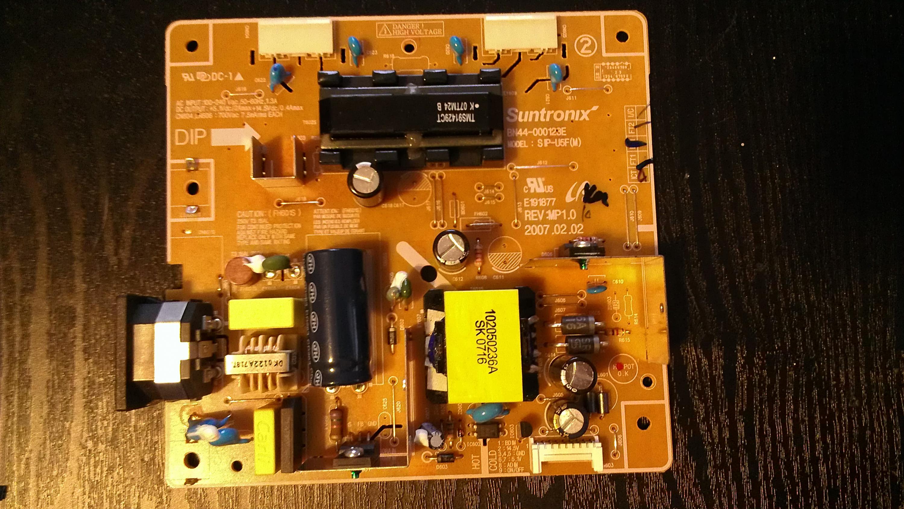

    Samsung Syncmaster 940BX built in August 2007
    Symptoms:
    With a PC connected via either VGA or DVI cable, power on the monitor and you can see the display for a couple of seconds and then it goes dim. Shining a flashlight on the screen show the display is there, but the backlights are off.
    Troubleshooting so far:
    The caps show no signs of bulging or any leakage, but I have ordered new ones anyway.
    Following the recommendations of https://www.badcaps.net/forum/showthread.php?t=8292

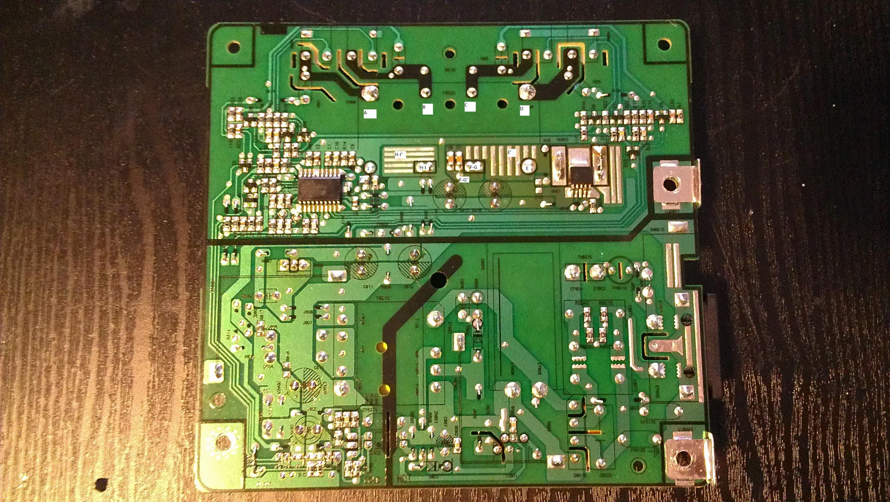

    and referencing the attached picture, I get the following measurement:
    A-B = 1.155k ohms
    C-D = 1.213k ohms
    E-F = open
    F-H = short
    H-J = short
    Since the primaries are different and one of the secondaries looks shorted, is it likely the transformer or maybe something else?

    Re: Samsung SyncMaster 940BX backlight turns off
    I would say transformer - fortunately they are available and reasonably cheap
    if you can wait
    http://www.ebay.com/itm/1pcs-TMS9142...-/181063460040
