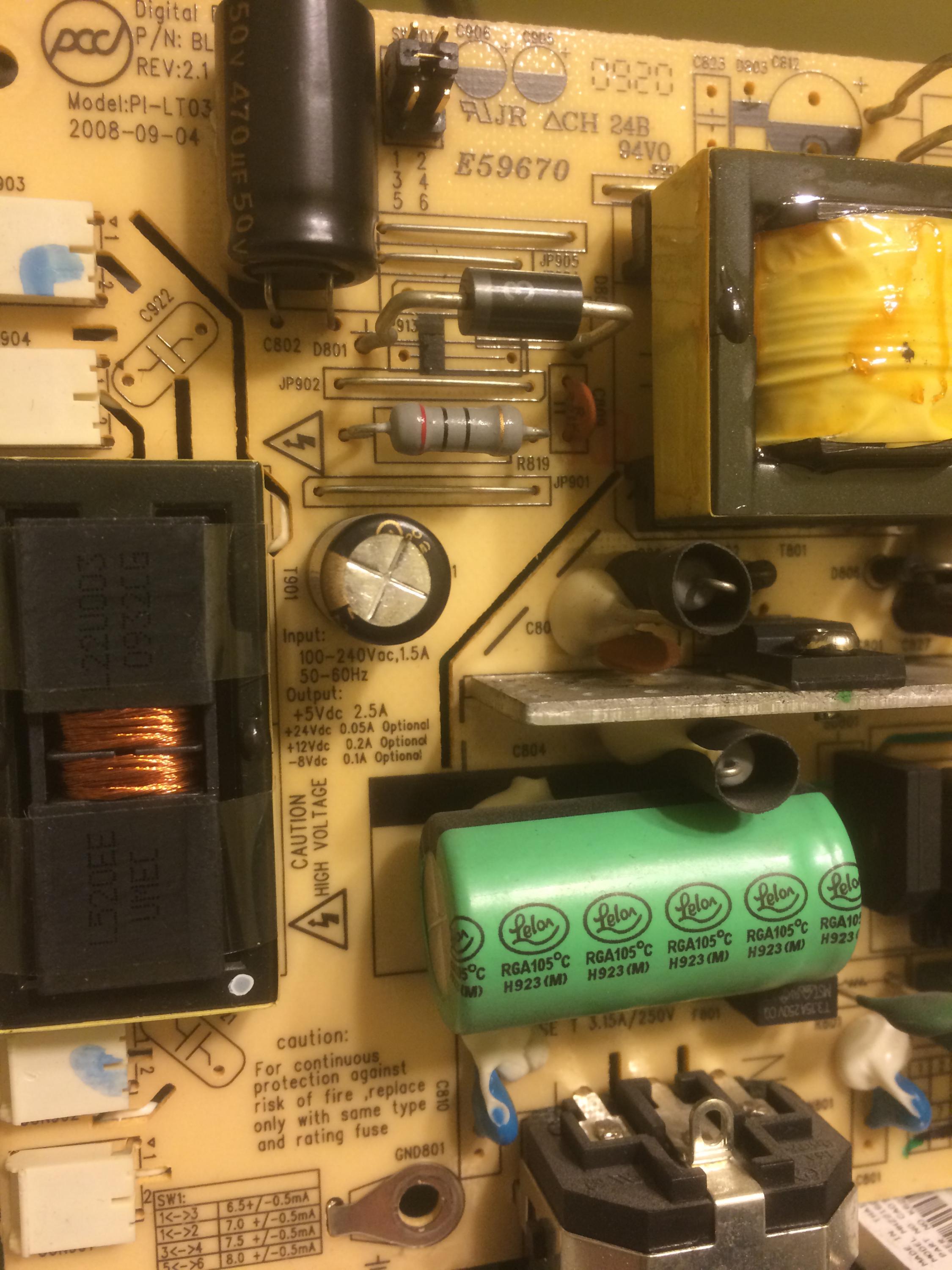

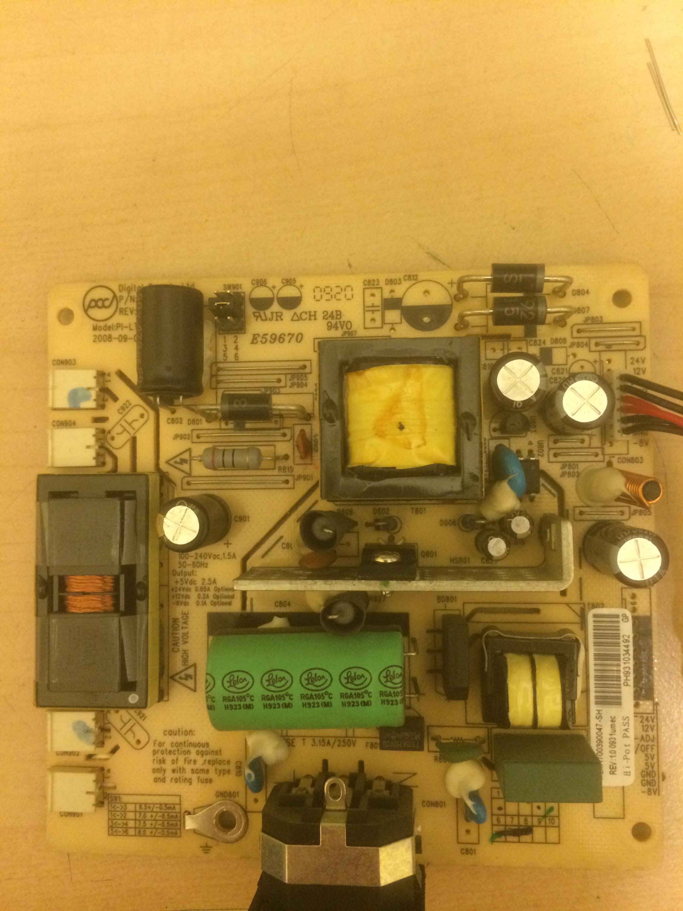

Good day!
Todays patient:
ViewSonic VA926 - Model Number VS11886
PWB - Digital Decade BLM1700P60720 - Model PI-LT03
Symptoms:
After plug-in 220V, lights up with clear picture from PC.
After ~1-2 seconds, back-light and picture shuts off completely (no image in background).
Power led turns orange(standby) or off.
Pressing power button does nothing at all (led stays orange or off, depending on state it was).
Time to time after ~5-10min monitor tries to power on, but again for 2 seconds and off.

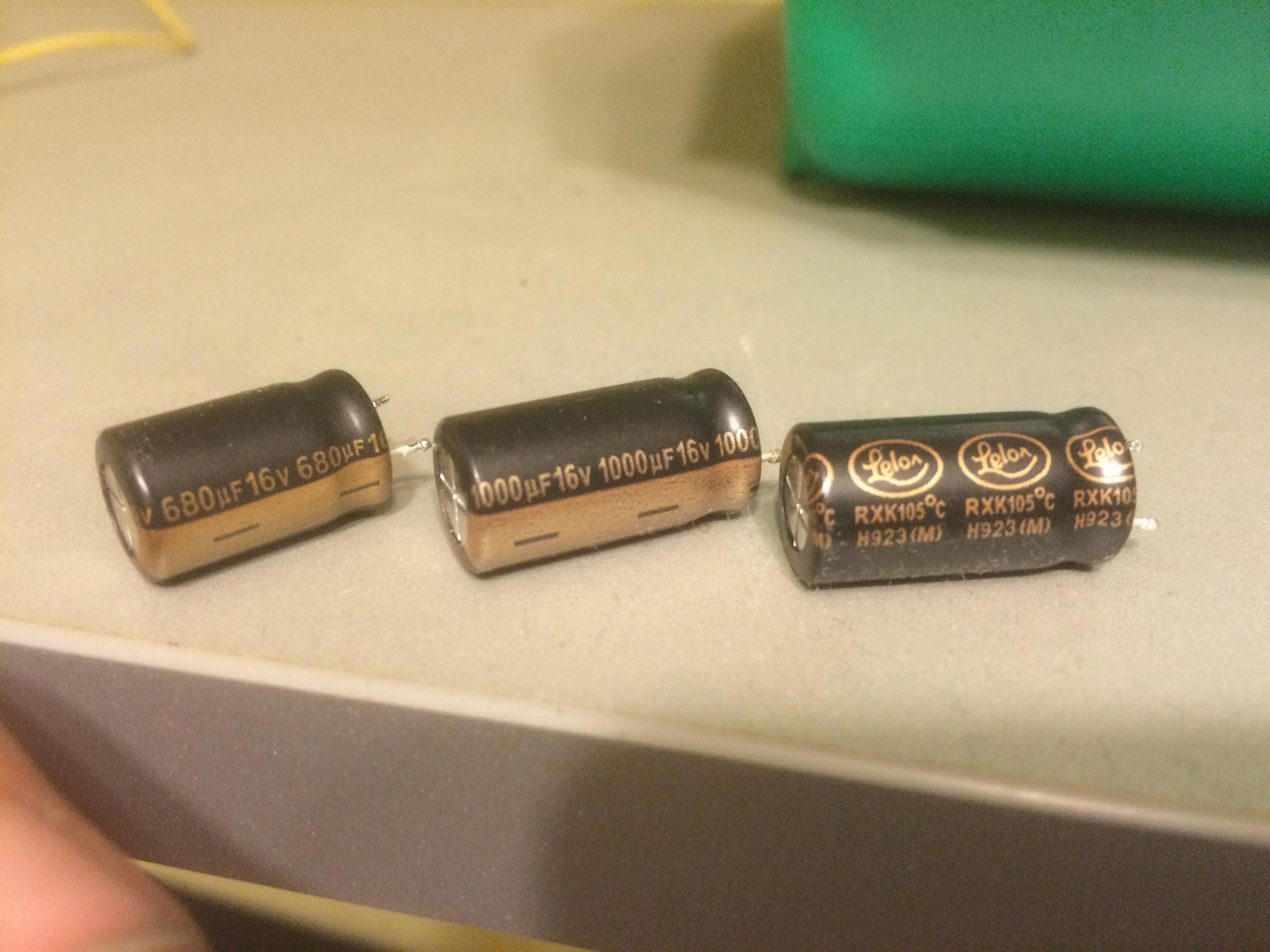

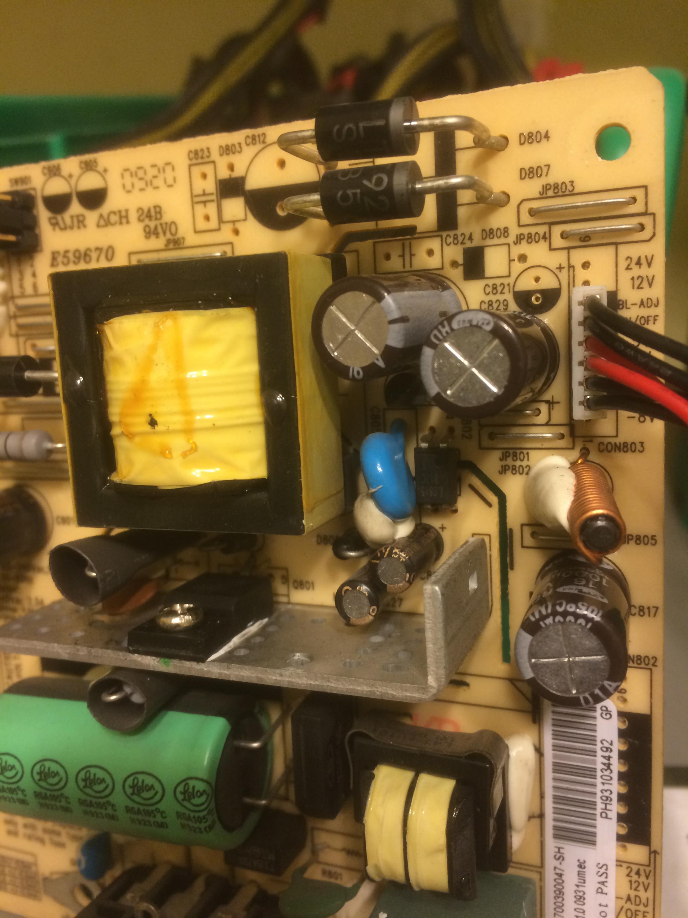

Caps (originally Lelon brand):
2x 16v 1000mF , swapped to another ones - no change (C816 and C829)
1x 16v 680mF , swapped to 16v 1000mF (don`t have spare 680) - no change (C817)
1x 50v 470mF , visually ok (have no 50v caps to fit in) (C802)
1x 50v 220mF , visually ok (have no 50v caps to fit in) (C901)
Big One, i believe 450VA (it`s glued to board with captions), visually ok (C804)
Diodes seems to work the way they must.

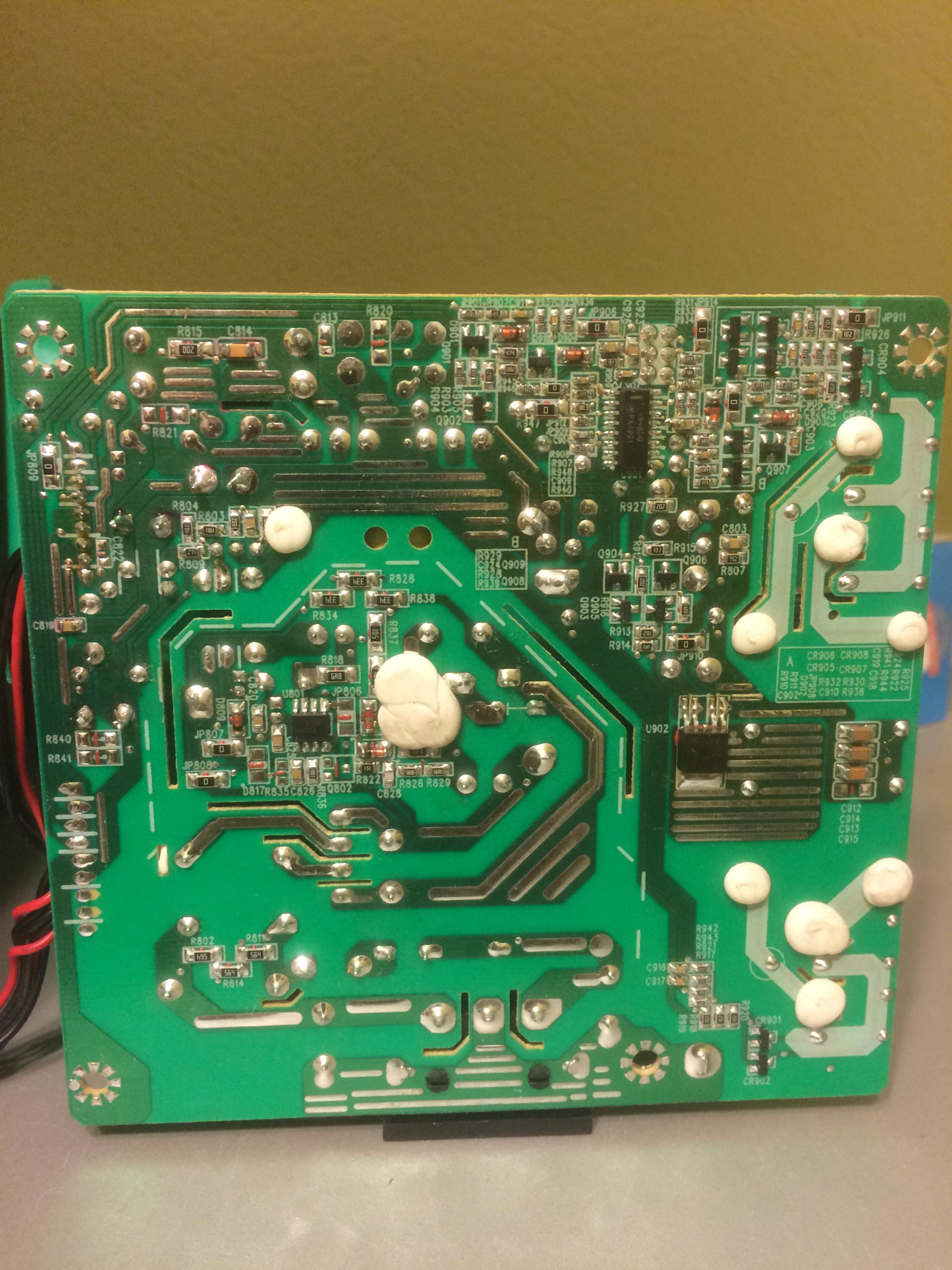

Did not have no luck to find schematics in internet for the board.
Searched here for pwb or similar monitors - no luck.
No signs of overheat.
I`m open to suggestions, where to start, what to measure?
Thank You!
