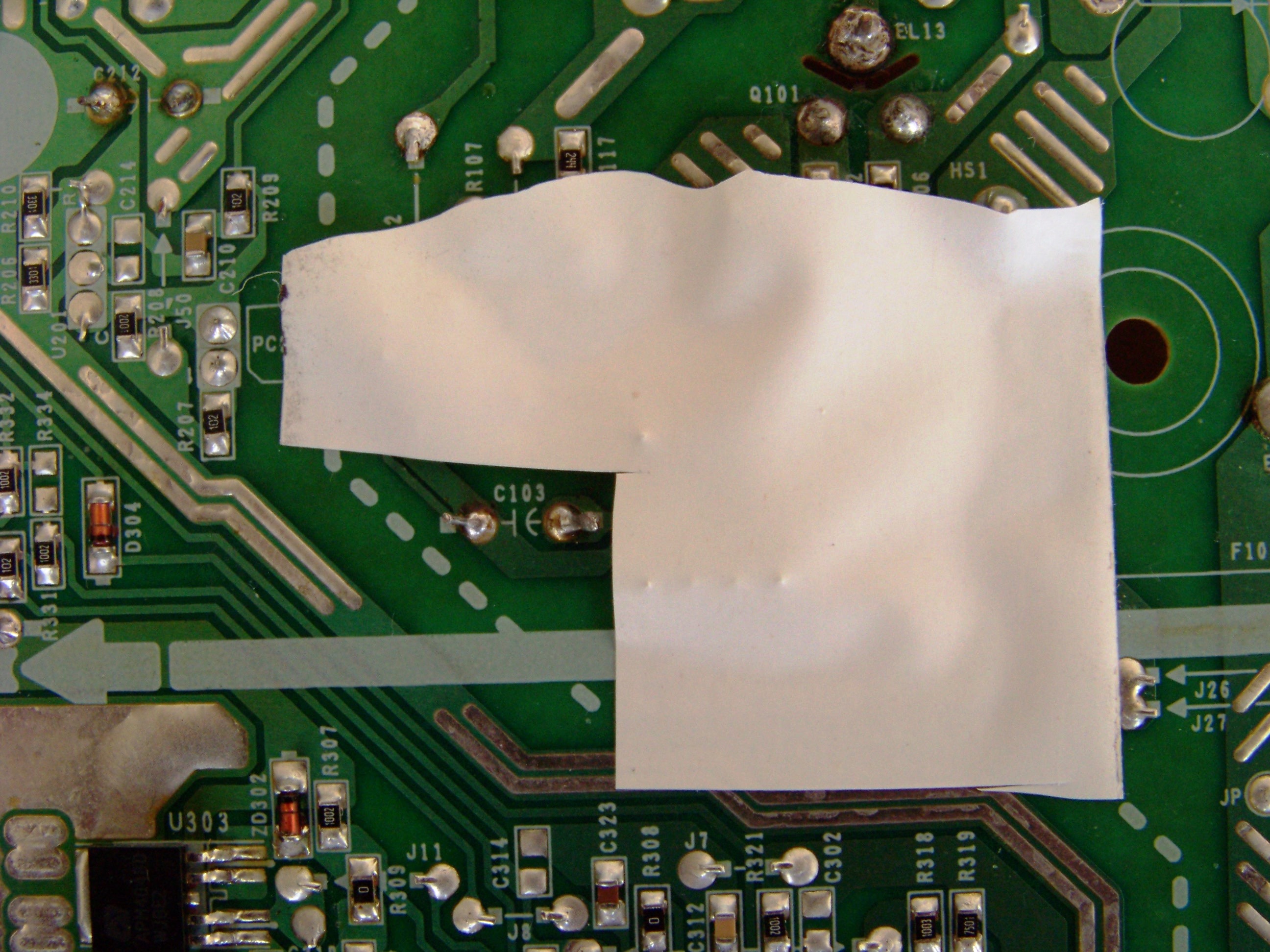

      OK. if you look at page 10 of the app notes of the IC, D102 in page 10 is the same as D102 on your board.
      C107 (connected to the VCC pin of the IC) in the page 10 is the same as start up cap C103 on your board.
      C109 on the Latched pin 3 in page 10 is the same as C105 on your board.
      So you need to find the safe way to measure the DC Voltage right at the two legs of the cap C103 (startup cap) on your board.
      You should also check the resistor R109 on your board, it should be <1 Ohm.

        Re: LG Flatron W2242S 'Dead in the Water'
        Ok I should have said the main thing I would need to test this board is budm.!!
        Here is my board - I know its a mess - I have to say I have half given up on it as I dont need another monitor. Repaired it once with a new inverter transformer and replacing all the caps then 18months or so it just upped and died q101 blew taking out some diodes and the fuse. Replaced Q101 but couldnt bring myself to buying packs of 10 of each diode so I was waiting till I found some on other boards but project got shelved
        So I would just set it up like this with the panel plugged in. Sheets of card between boards (including the button board - missed the card out on the picture though I would probably take the logic board off the frame as well.
        I have put a tape on this board to highlight where C103 is - at least its the easier of the two to get at.
        Pic 1 is out of focus sorry but you will get the general idea in pic 2 you could cover the bottom half of the board up to the white line with a bit of card
        as you will be working above it.
          Originally posted by budm
          That white connector is on the cold side which the circuit ground is also connected to the chassis, so yeah, do not touch anything in the primary hot side. I myself use outlet with GFI and Isolation transformer on what I am working on.
          BTW, do you have the spec sheet of that SMPS IC u101 LAF0001?
          Never mind, it is the same as FAIRCHILD FAN7601.
          Startup cap connected to VCC pin shows 0V?
          From app notes: Page 2.
