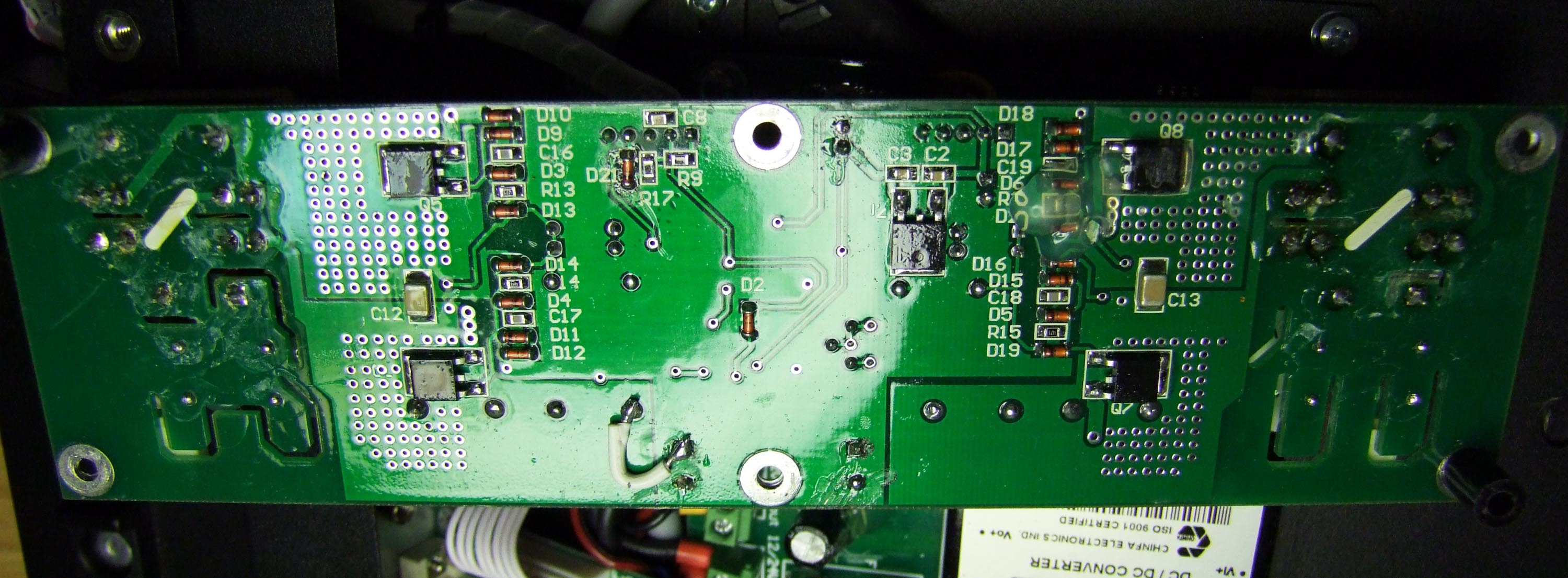

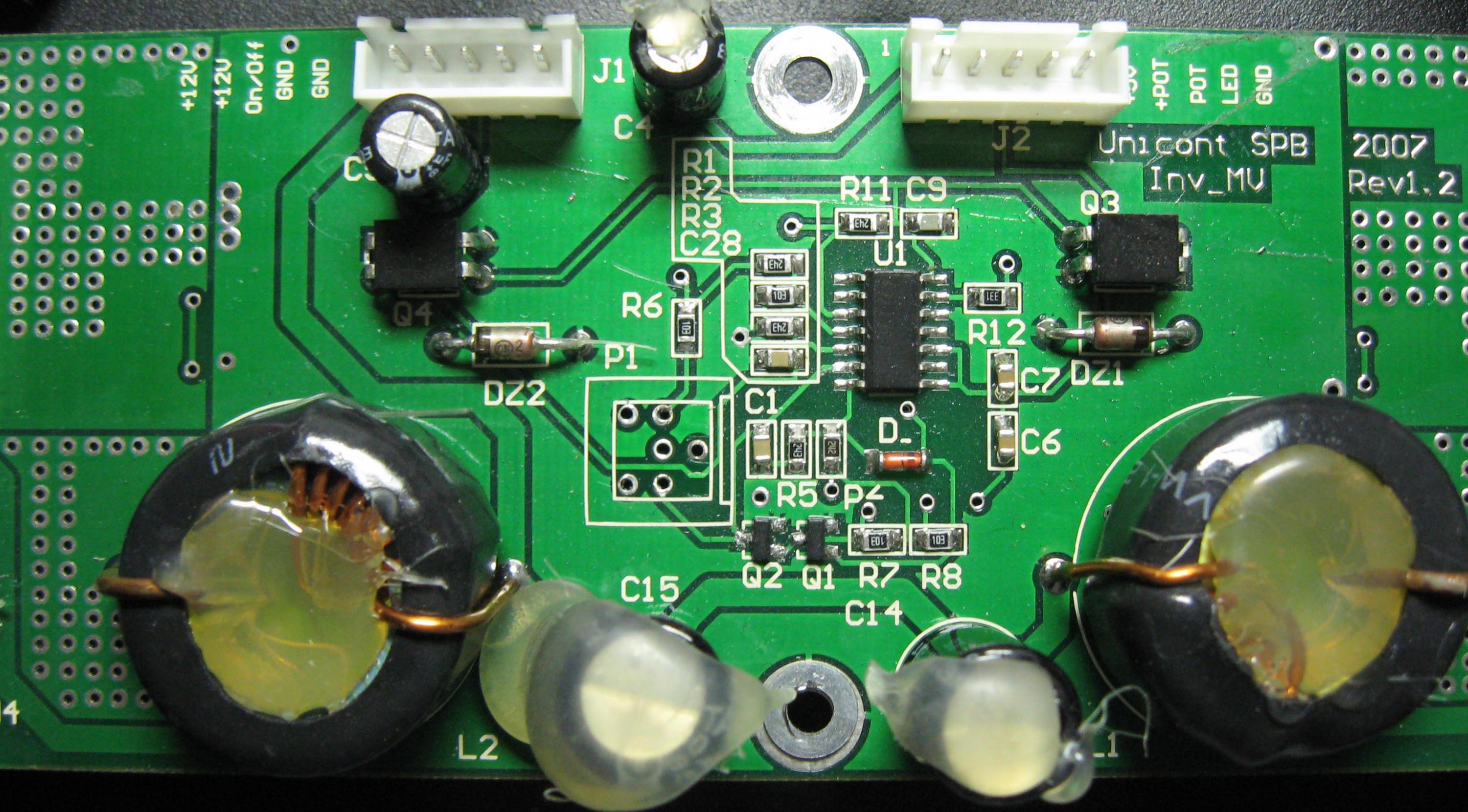

                  Re: Nuova Marea MV-1501 (Unicont) Blink and off at power on
                  The whole bottom of the board in one pic.
                  The On/Off white wire gets 0.03V at power on. When power supply is switched of it jumps to 0.3V and goes slowly to 0.
                  The main chip on the top layer is ST. It has 339 on top line and EZNQ750 next to ST.
                    I saw the pinout and the bottom of the board, but would like to see the whole pictures of the bottom side instead of two sections.
                    It looks like the 12VDC for running the inverter is generated from the step down modules, I wonder if the 12V is on steady during the lamps are turn on.

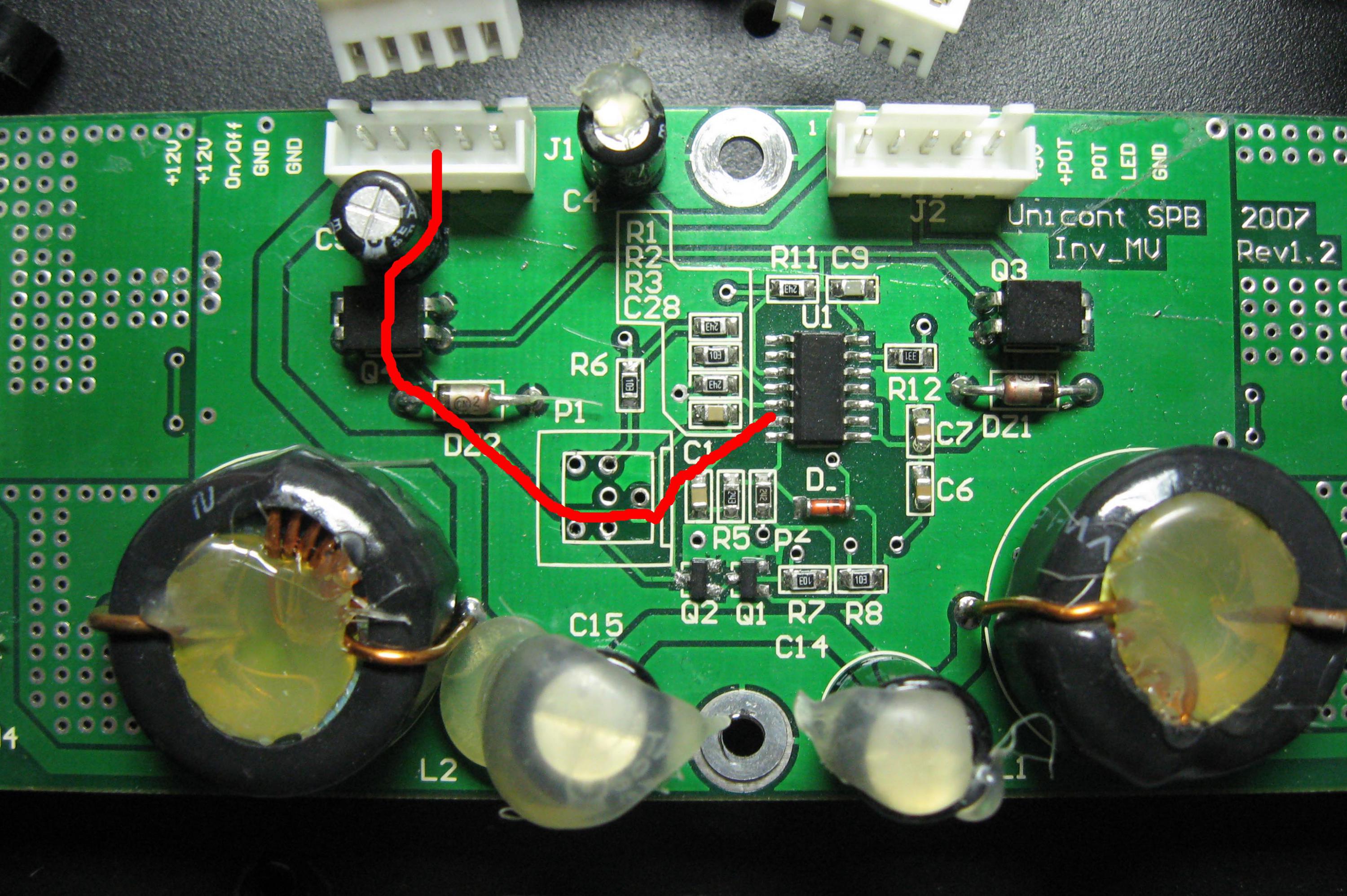

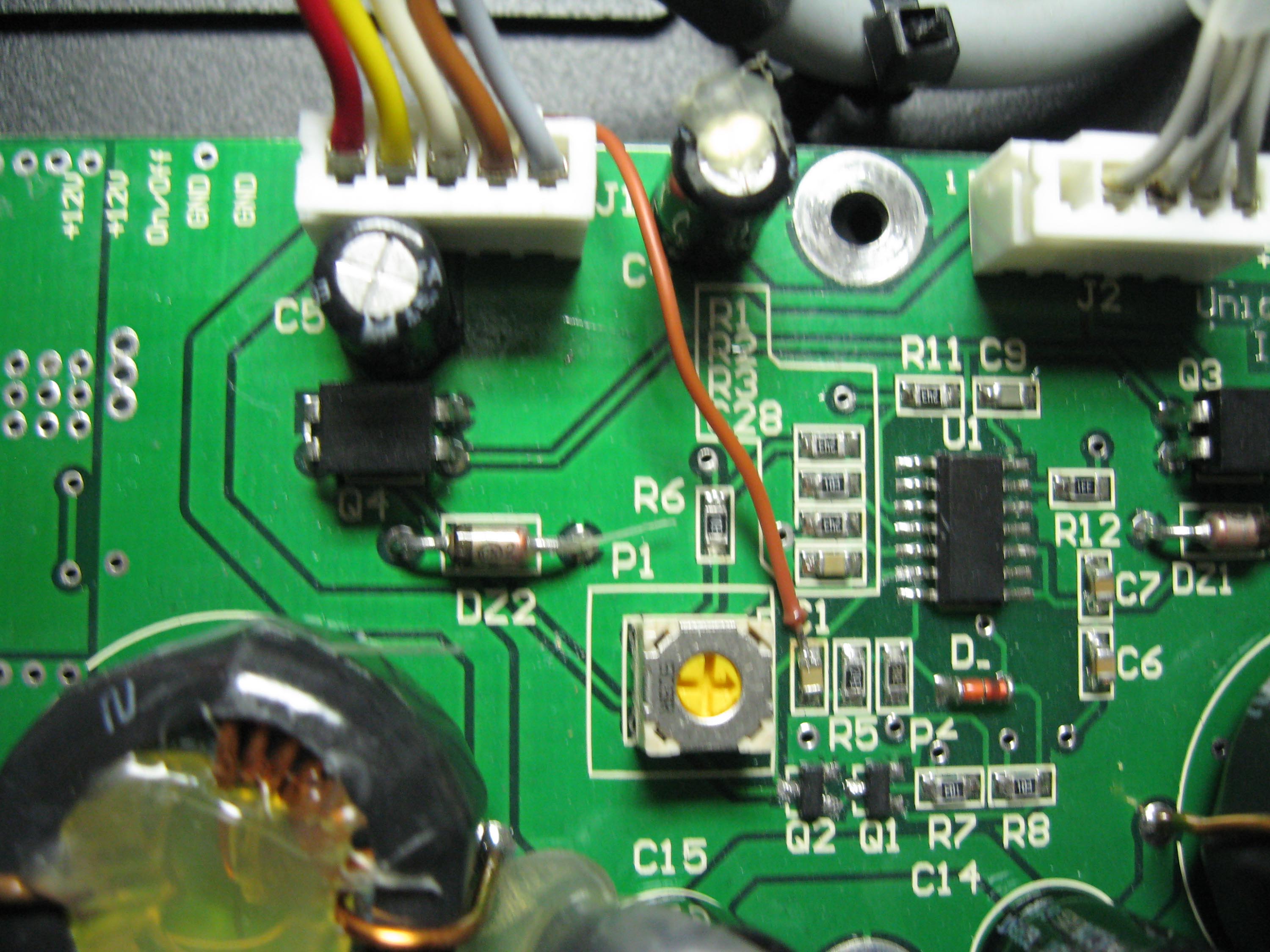

                                I hard wired the on/off pin to the point i could see the track was going and fired up the monitor.
                                Backlight starts and stays on constantly!!
                                No other signs of life. Power button does nothing and no image on monitor.
                                This is confusing..... I hope i haven't damaged the logic board when changing/testing some caps ...
                                But may i should start checking the very small caps on the logic board??
                                Thanks!
                                  Never the less - a great step forward you know now that the bulbs work.
                                  I was wondering if instead of soldering your jumper you touch it on - obviously it will light but then what happens if you remove it?
                                  Is that U1 chip the ST one you gave the number for earlier?
                                    Ooops ... just realized inspecting the photo that i connected a different track!
                                    I am really lucky i didn't fry anything up and find out the the inverter is working at some way!
                                    So on/off pin goes to C28 and not C1 as i painted in previous photo!
                                      Yes U1 is the chip i described earlier.
                                      The only thing i found is 339 comparator which i doubt is this one ... on the other hand i am not sure....
                                      Some other thing .. Do those zener diodes look discolored or is that normal?
                                          Struggling with the datsheet any chance of cleaning up the top of U1 and getting a close up picture to show the part number. I have spent many hours looking for parts using wrong numbers B-3-8 D-O 0 2-S-5 and so on.
