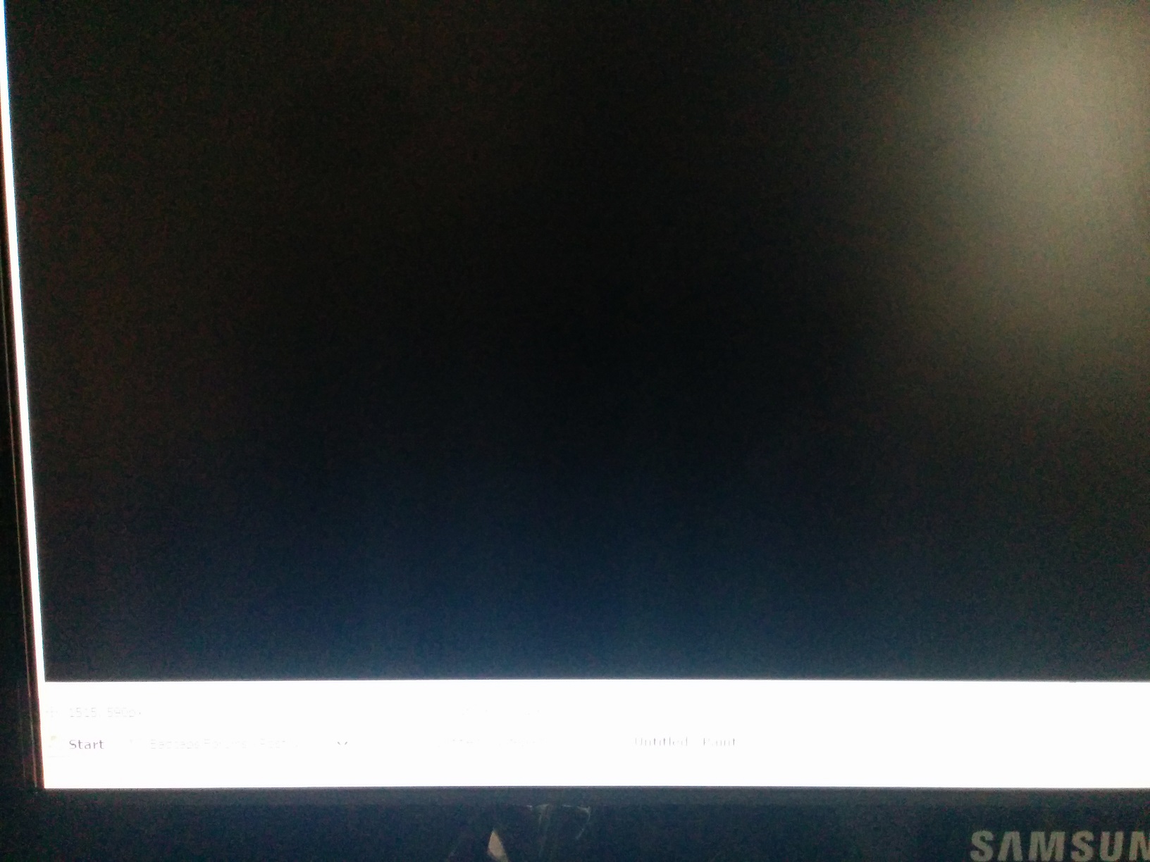

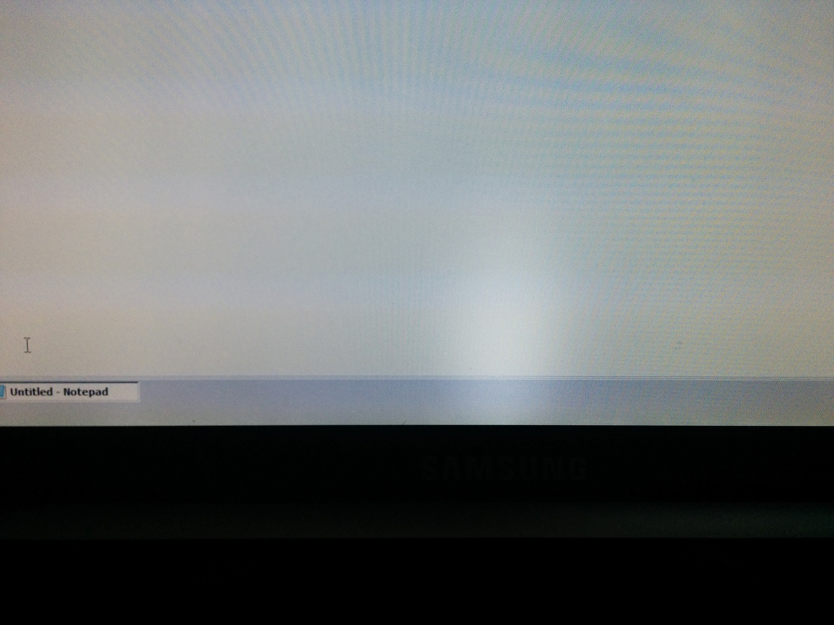

    Anyway, it all looks great... Except the lighting isn't perfectly even.
    The center of the screen, on a white picture (say - notepad open), has a slightly blown-out, brighter spot. Only on the bottom, I think?
    -The only thing I can think that would be in this area is the little "twist tie" thing (bad term) that holds the two bulbs together.
    Then on a black screen, there's these lines that run up and down it of just very slightly different in intensity from the next.
    I've actually gotten used to it a little, I think. But if I ever decide to find a new owner for this one... that'll be tough.
    Pictures attached (had to accentuate the problem in post, a little so that it would show up how I see it with my eyes).
    What could cause this? Bulb problem? Not perfect quality? I don't think I could have possibly missed a diffuser when I put it back together... I think I might crack it open soon (day off) and see if there's anything obvious.

      Upon looking inside, it sorta looks like little fractures line the edges of the glass. I could see these causing bright spots/refractions or something. I'm not sure how I would have possibly created these marks, but who knows?

        Considering the source of light is positioned at the edges of the panel (edge-lit) then the condition of the edges are going to affect the ways the light gets spread and diffused in the panel and could have any result.

          Re: (Generic) CCFL replacement - uneven lighting? - 223BW
          It's hard for me to tell, but it appears they are perfectly vertical. I guess that doesn't sound farfetched (mark in edge of glass light shining perfectly vertical through it), but my first thought was something was wrong with the panel itself, and the lines were literally following vertical blocks of pixels.
          Say, there's that tiny little potentiometer on the back of the [T-CON board? Is that what it is called in these small LCDs, too?]
          I'd play with it, but turning random pots is scary.
          Seems like something is being "blown out", too intense of a signal.
          I'm just thinking out loud, here.

            if you mean a pot on the lcd panel - DONT TOUCH IT.
            that's the screen bias control.

              Thank you, that's what I was wanting to hear.
              Well, I guess I was *wanting* to hear "tweak that sucker, your lines will go away!" but knowing I was right not to touch it is pretty good, too.
              I think I'll just live with the lines. I've got a couple other same-size displays that I could use for myself, but I realize selling this one would be difficult, considering it would be hard to break even with the new bulbs and this malady.
