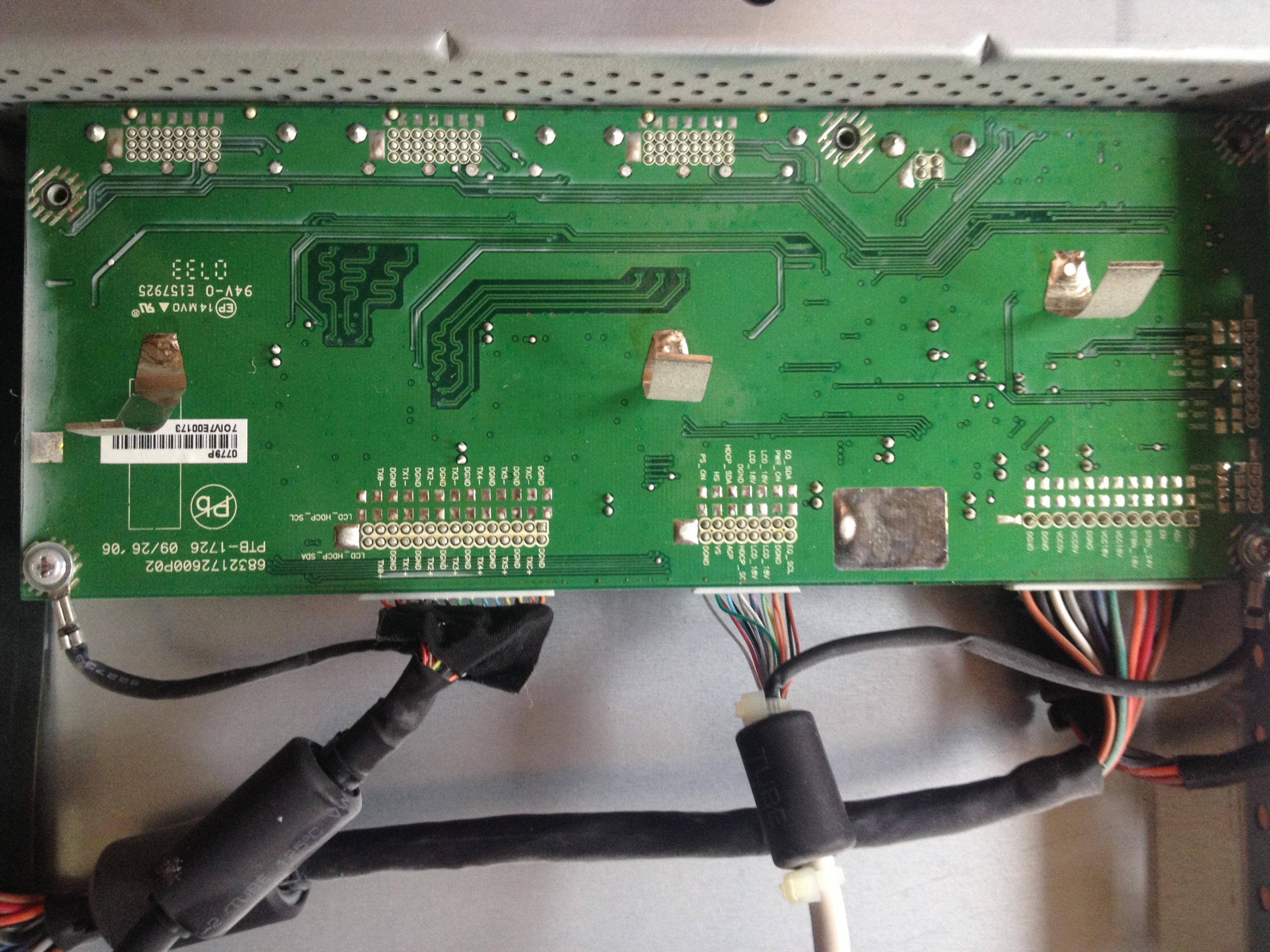

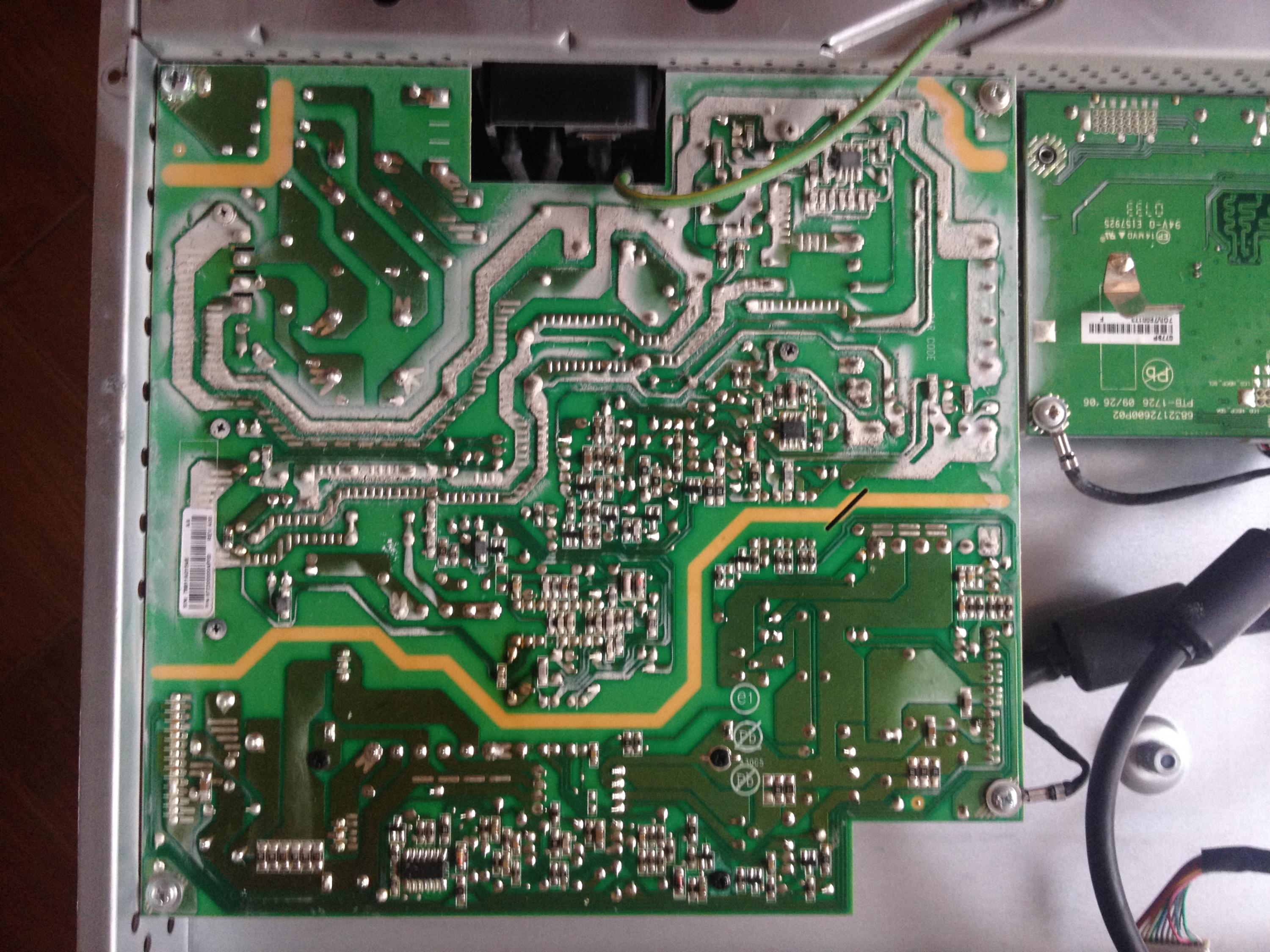

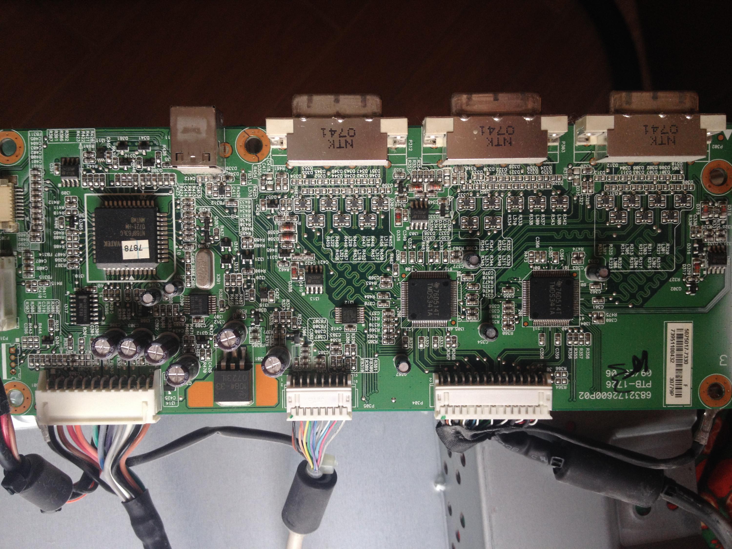

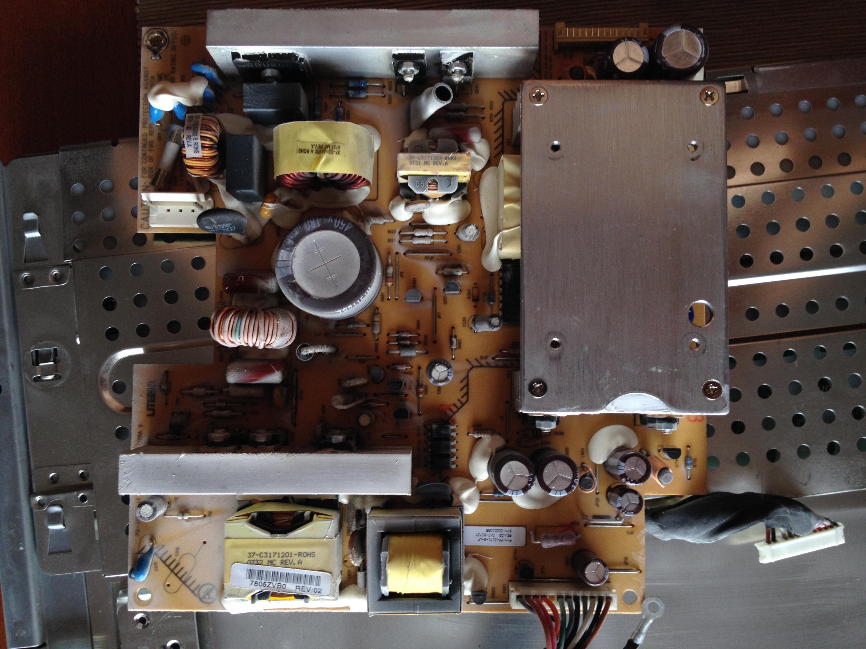

                            • Serzh
                              • Aug 2014
                              • 9
                              • Russia
                              Re: HP LP3065 will not come out of standby after connecting XBOX
                              Input Board and Power Supply Board
