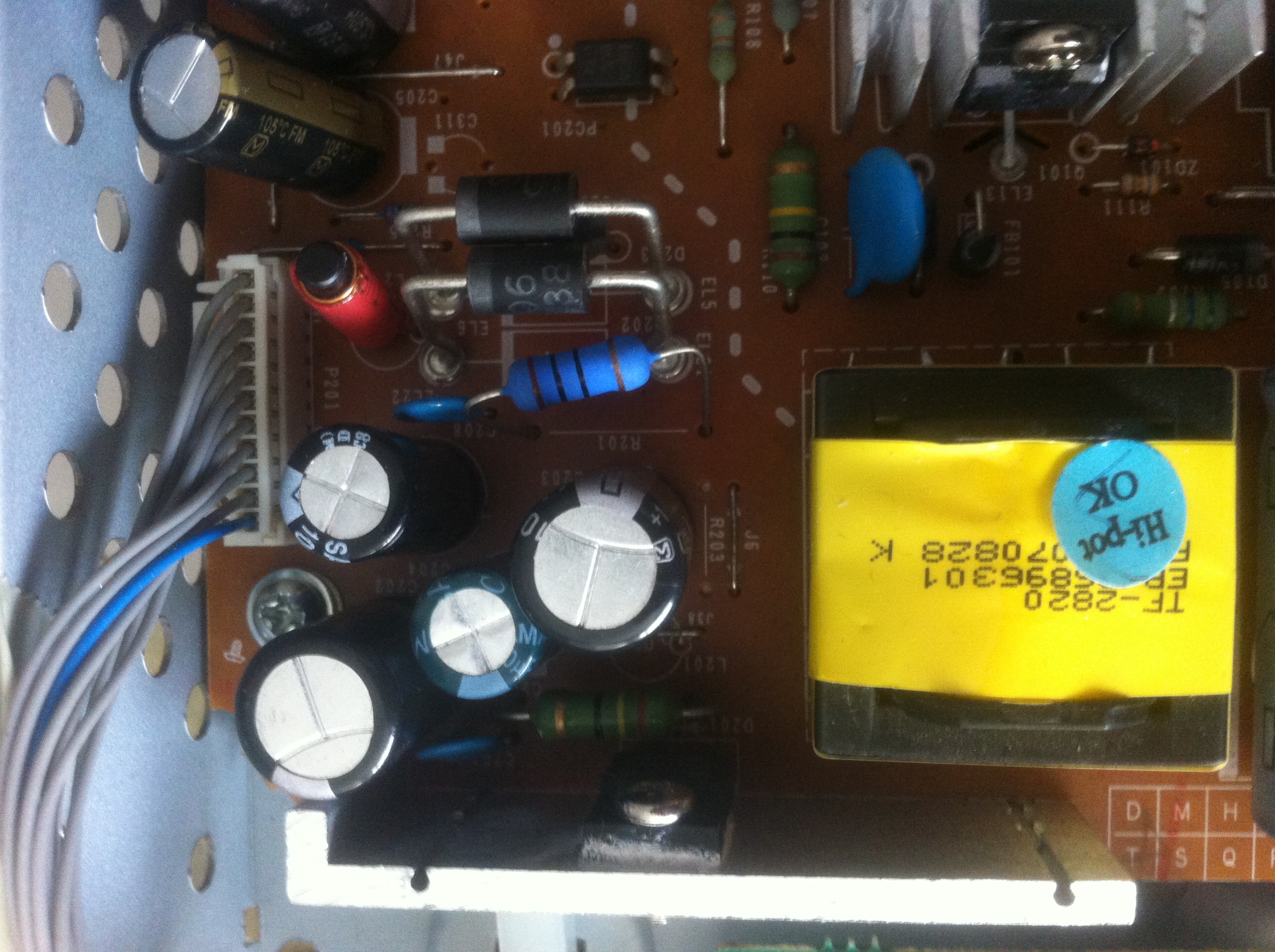

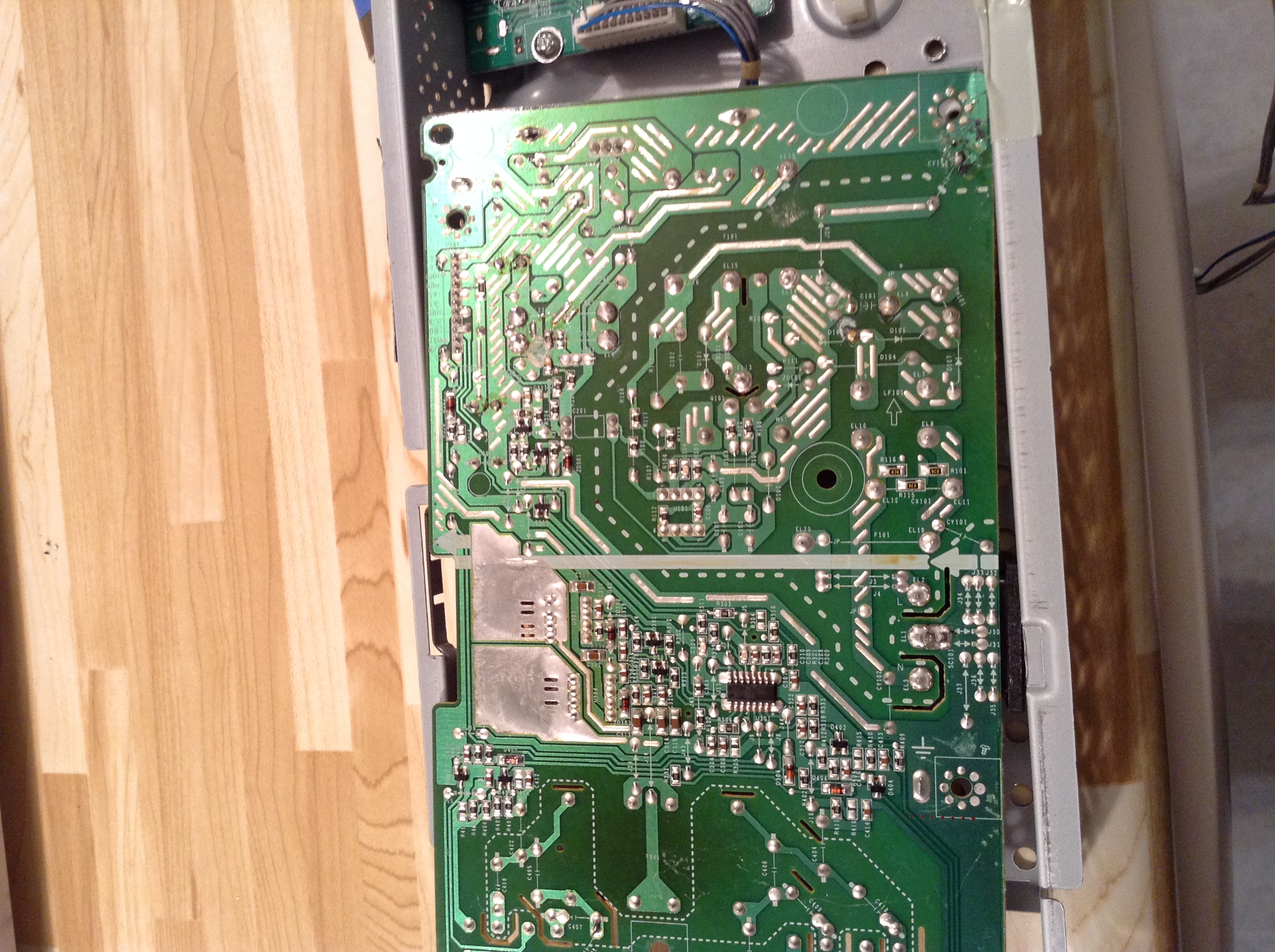

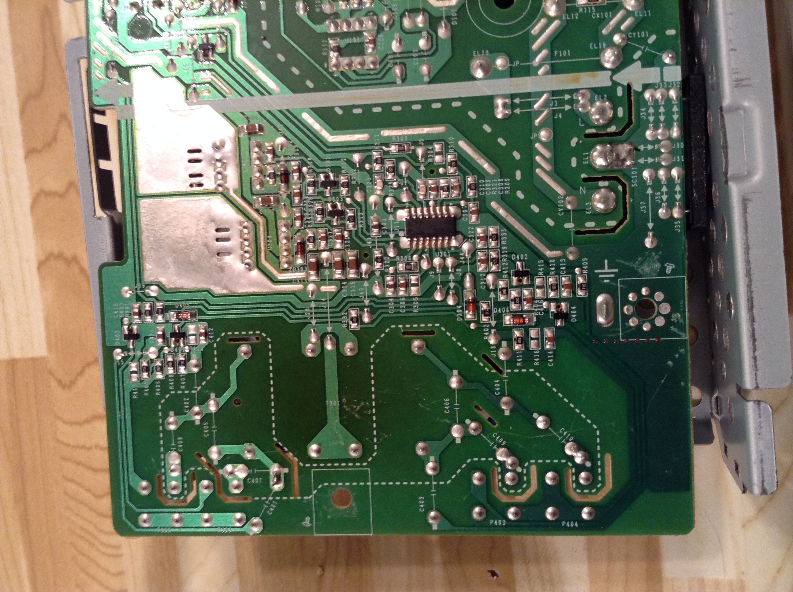

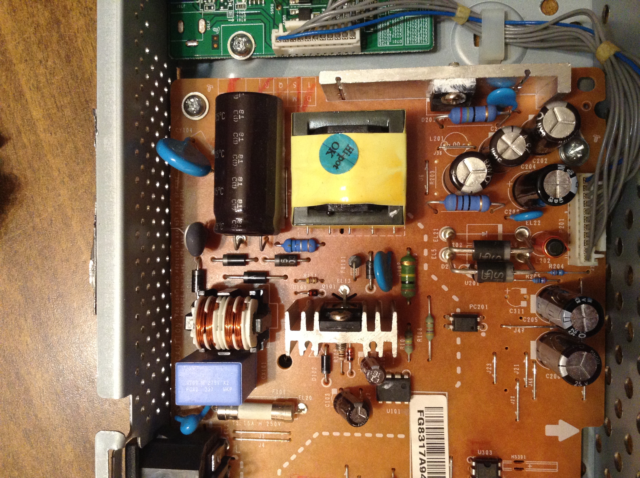

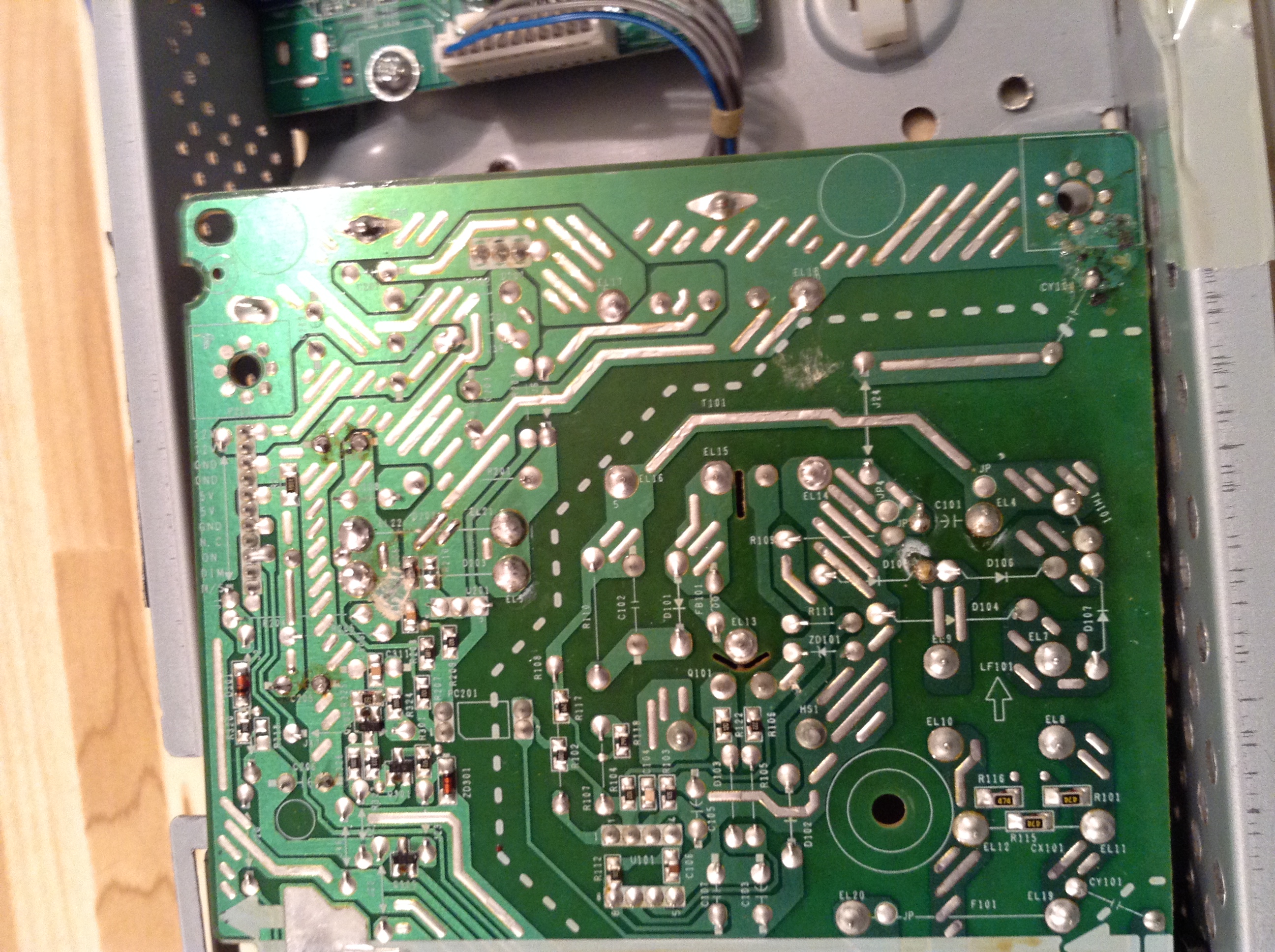

    We like pictures of the whole board straight on back and front
    Also post close up ff the back of the board where the inverter transformer is
    (The oblong one with the yellow stripe round - also advise any part numbers on it.

      Re: LG Flatron 1953t-BF 2 seconds to black
      Try my backlight on my second LG and its the same thing but its not the backlight who's making the sound but one big electronic thing. Will post the photos. It has Qc OK marked on it. 4 backlight is doing the same thing.
      I post this thread in the wrong section...
      Pics was the second screen.

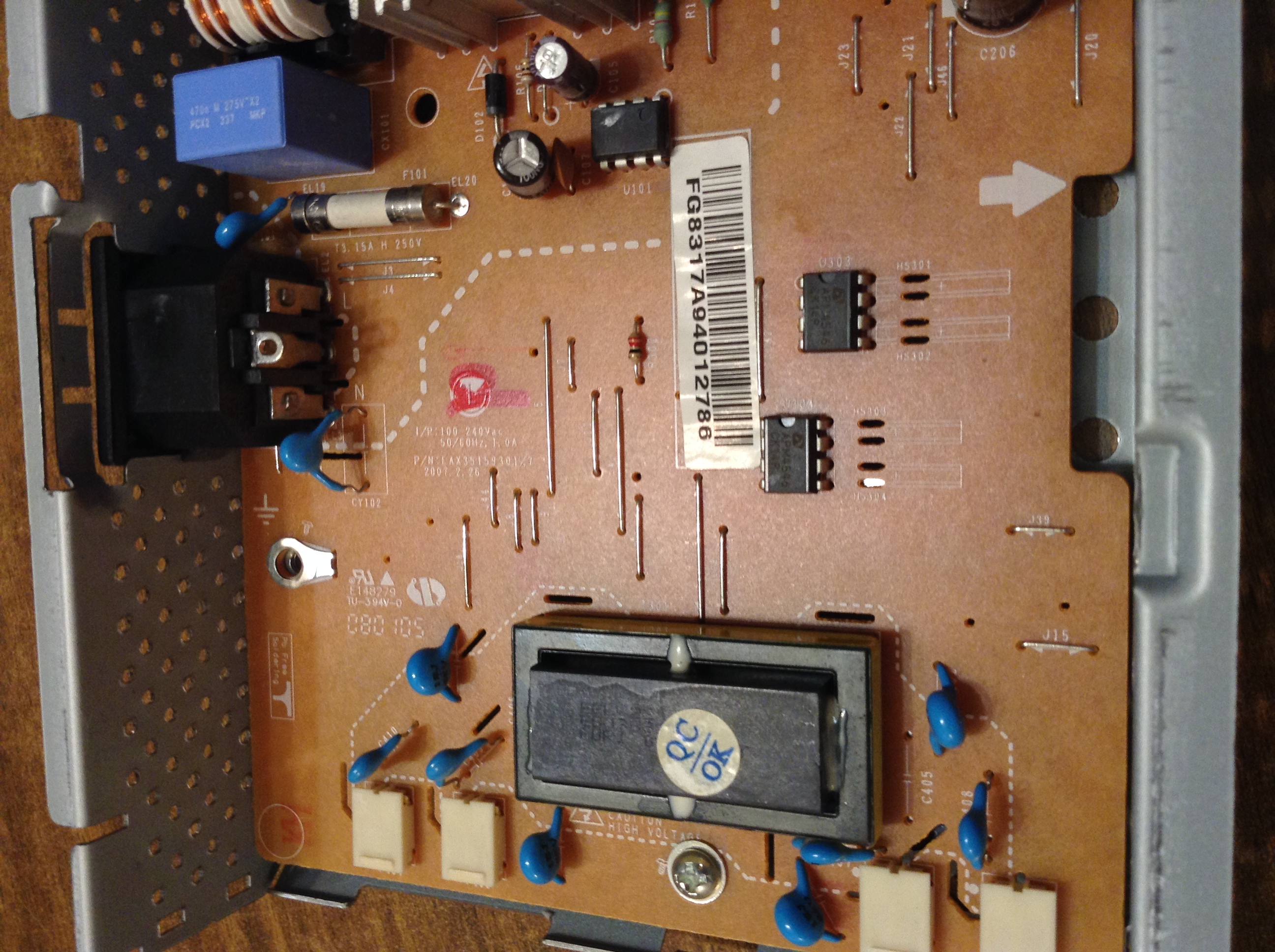

        Please only deal with one set at a time - you can do what you want to the others but dont mention them on here until this is finished.
        You are in the correct forum.

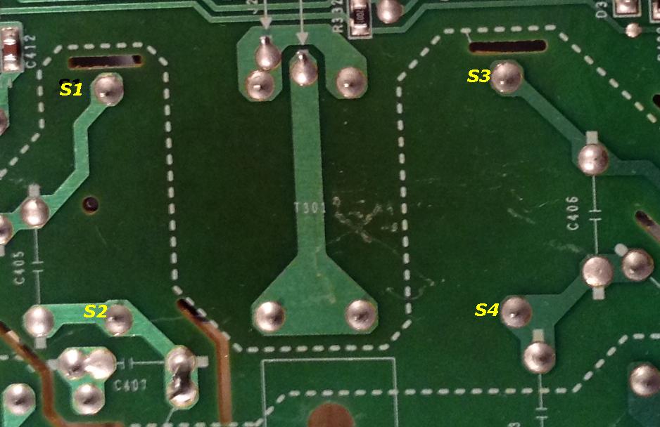

        See attached - NO power to boards - set your meter on ohms 2000 and test S1 to S2 and S3 to S4 and post results

          Sorry but I'm really noob about this but what do you mean by S1 to S2? Where's can I find them.

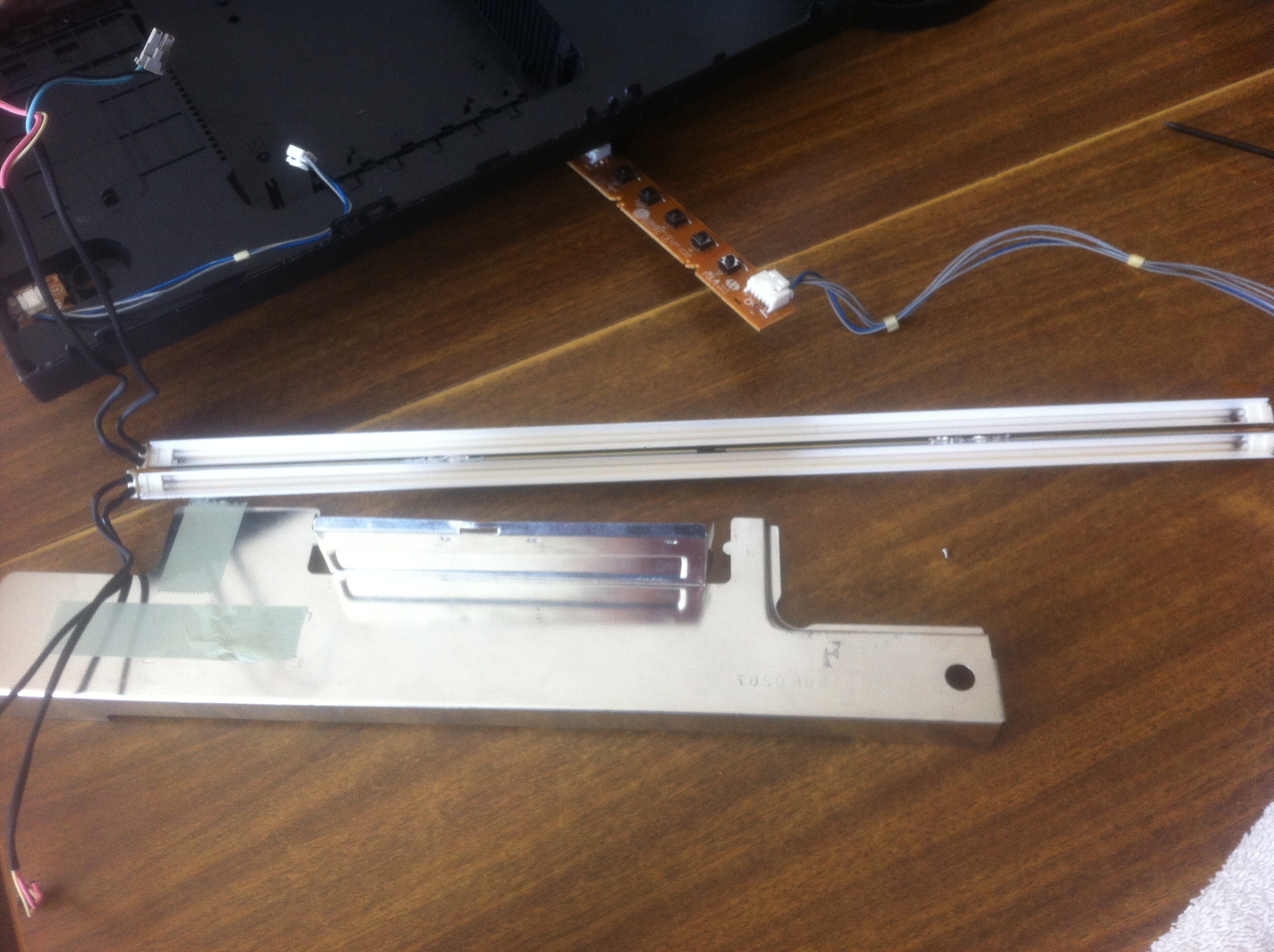

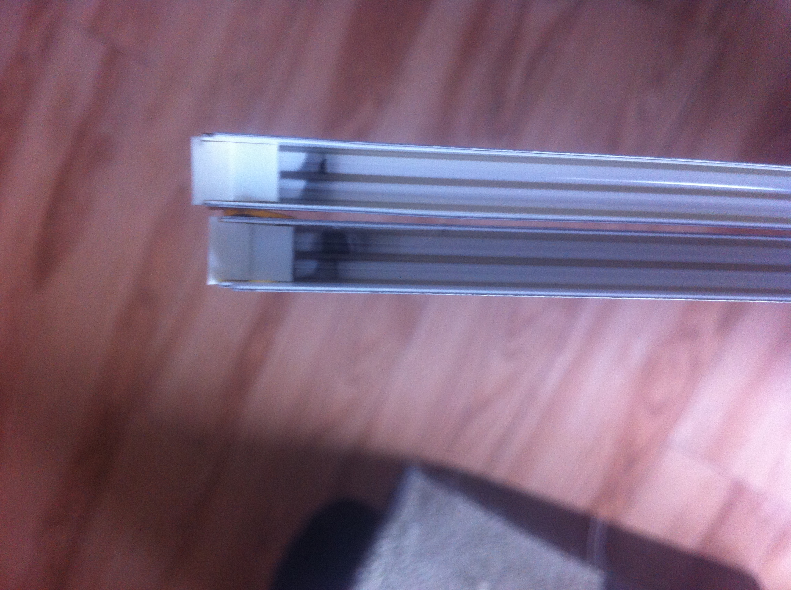

            Hi sephir, you much probably have to buy new lamps, i see in the picture darkened ends in one side, just to be sure try to make a close up picture of each end of the 2 sets of 2 lamps (4 lamps in total) maybe not all the couple is bad..
              "The backlight does make a sound when I power on my monitor and a smell too" You should gently tug on the wires to see if they will come off the end of the lamp, you probably smell an Ozone. Those lamps do not look good.

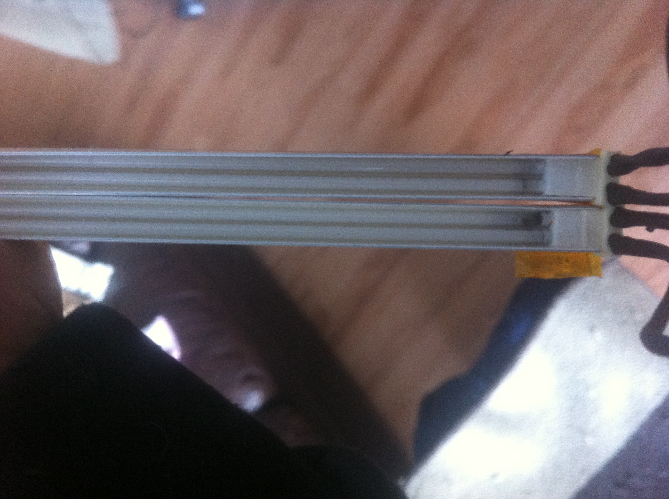

                Heres the close up pictures
                http://s807.photobucket.com/user/bud...ml?sort=3&o=13
                http://s807.photobucket.com/user/bud...?sort=3&page=1
                Will try to disasemble these to see if its a bad connection. For the moment, its aint look good?
                  Change them all...
                    Sorry - its me at fault- forgot to attach the picture oh:
                              Tested. Here's it is.
                              S1-S2 = 994
                              S3-S4 = 997
                                The transformers are good but the fault is clear like sun.. the lamps.
