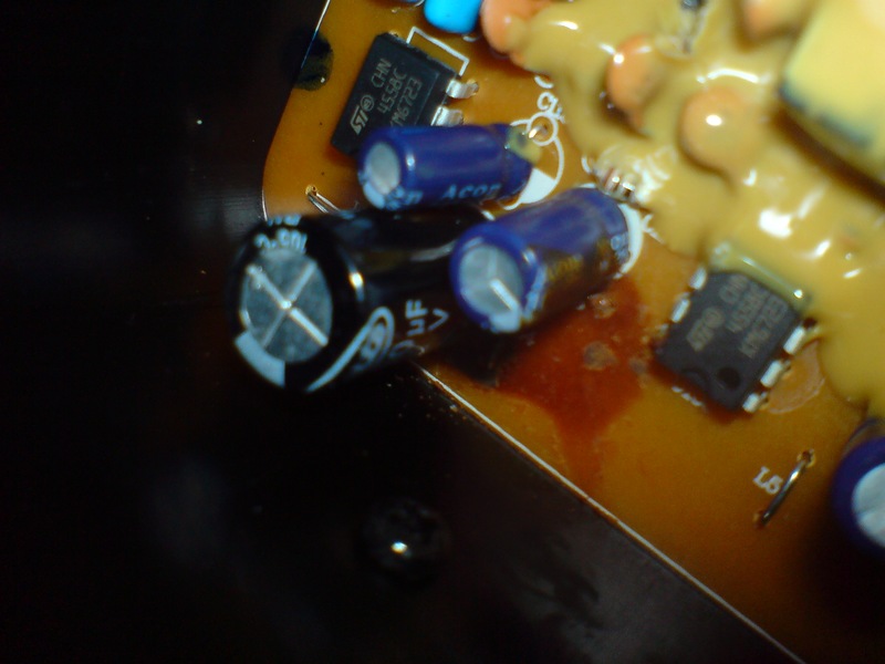

                Sometimes pictures can tell a thousand words. Do these pictures tell the story? Once a while I would take some snapshots of degraded glue and the carnage...

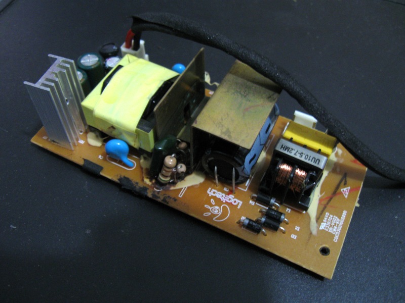

                                Hello badcaps, i was reading this thread and found it interesting because i encountered the same yellow glue (i think) in a Klipsch Audio Amplifier, can you confirm it is the same thing:
                                http://i.imgur.com/L14Q8.jpg
                                Id like to know which tool and which chemical cleaning solution do you recommend to remove this damn glue? I had a horrible plain to remove it but i think i used wrong method (i used cutter and tweezers). Thx.

                                  I use Alcohol to soften them first, it does take awhile, you can also use small cutter to trim it off as much as you can, scraping with small thin blade also help, just take your time.

                                      No. That's exactly the thing - with heat, the bad glue turns from yellow to brown and becomes corrosive and conductive. It also hardens rather than softens, making it break in little pieces when you scrape it off.

                                        Ok, so isopropyl alcohol (that i use to clean flux on PCB) should be used. I had tried acetone and it wasnt working at all. I also tried hot air (with my SMD rework station) without any luck too, this glue cant melt even with high temperature.
                                        Based on my reads it contains chloroprene or melamine material, right?
