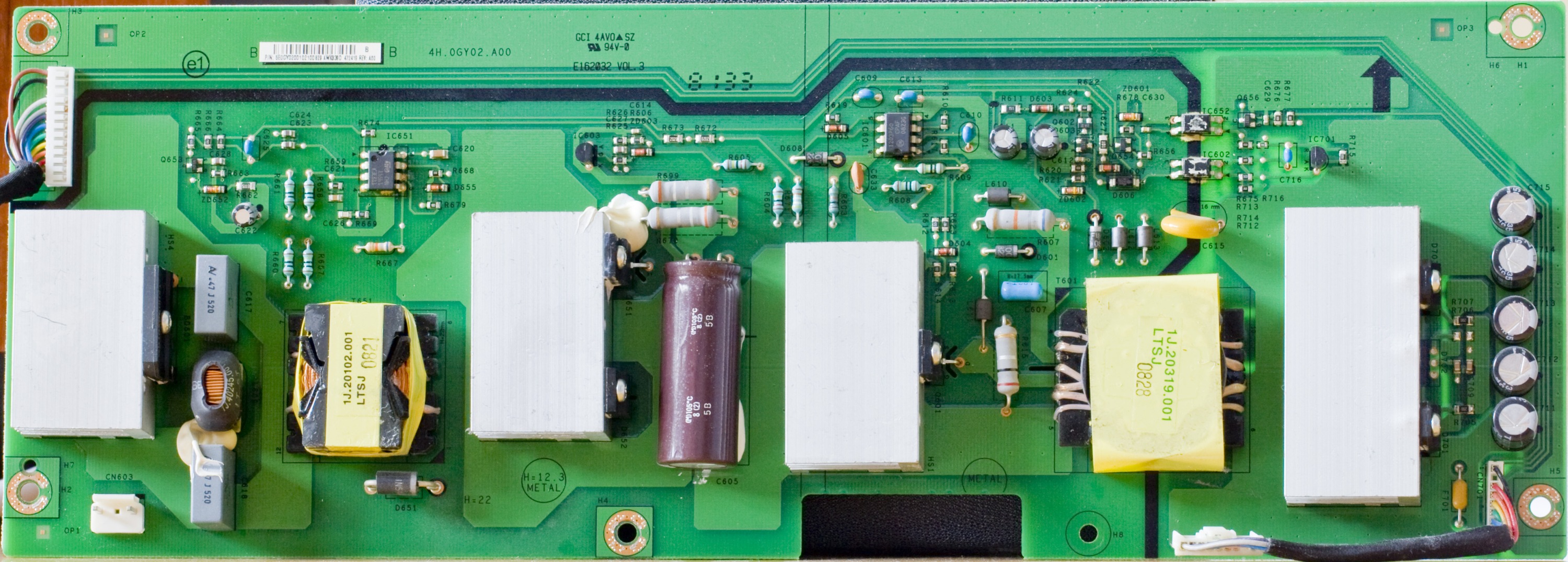

      Re: Dell 2709w No power
      A question to you that have this monitor, heatsink (HS1) to the right of the bulk filter capacitor in the picture below does it become really hot?
      Mine emits a crazy amount of heat, so far I've only looked at this monitor briefly.
      The cap has 378VDC across it's legs with 230VAC on the incoming
      There is no voltage at all on the 24v output connector.

        As you notice, they put the thermal transfer pads (4) to transfer the heat to the chassis, they do run hot. Did you check the temperature to see how hot it is?

          It was too hot to touch, I will get a temperature probe & check how quickly it's heating up.
          Does anyone have a schematic for this PSU?
          I will compare all voltages with the first post in this thread, a little later when my brain starts working (It's 30°C outside now )

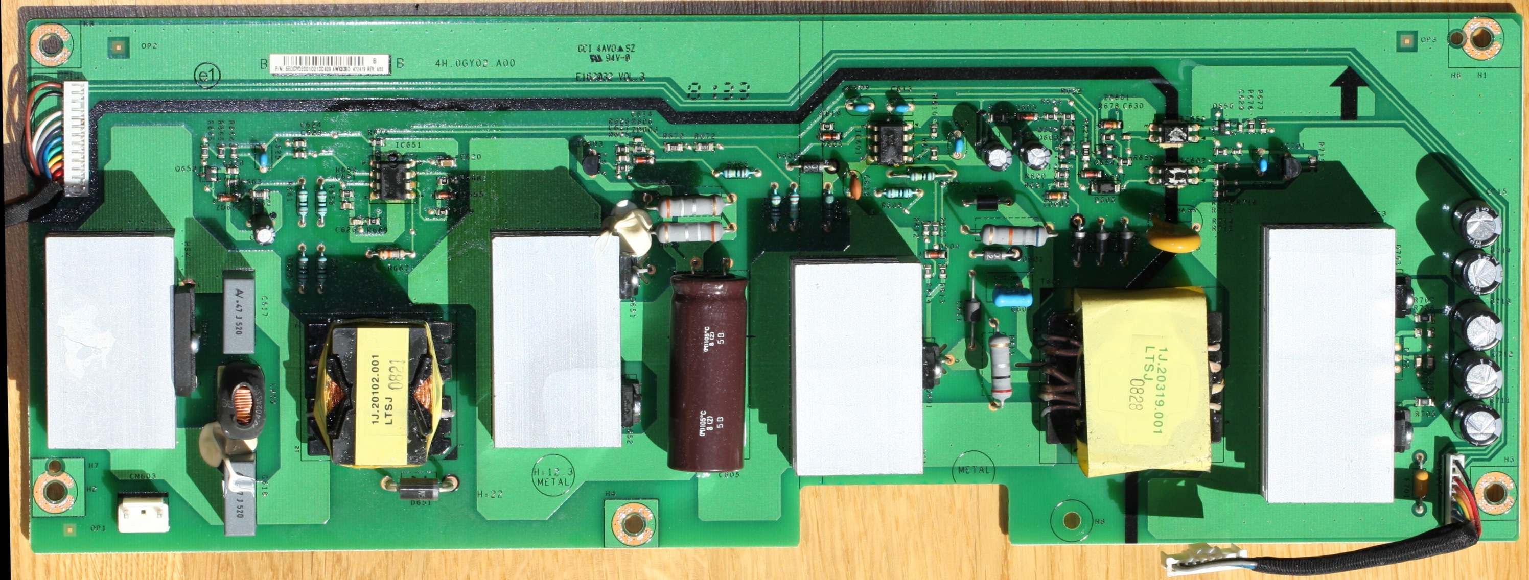

                Ok, had some time to look into this monitors PSU now.
                It takes ca 2min for HS1 to go from 35°C to 75°C (logic board & backlight disconnected)
                The fuse F701 checked out fine.
                C606=10.4v
                C611=10.8v
                C622=33v (slowly builds from ca 32.5v > 34v under 1 min)
                VCC on IC651=10.7V (ST: L6561 PFC Controller)
                VCC on IC601=10.8V (On Semiconductor: 1203P60 PWM Controller)
                I have labeled the pins on transformer T601 in the attached picture.
                Between 1>5 & 3>4 I see 0.5Ω
                Between 1>3 & 4>5 I see 320Ω
                Between 1>3 & 4>5 I also see 375V
                On the other side of the transformer there is 0v between all legs & resistance is 0.4Ω
                So the problem is probably in the transformer (1J.20319.001) or the rectifiers D701 or D703 (VF20200C) that follow.
                It's time for bed now though, so will have to desolder them tomorrow to look further.

                  Any voltage on the caps C711to C715 - the ones in a row along the edge

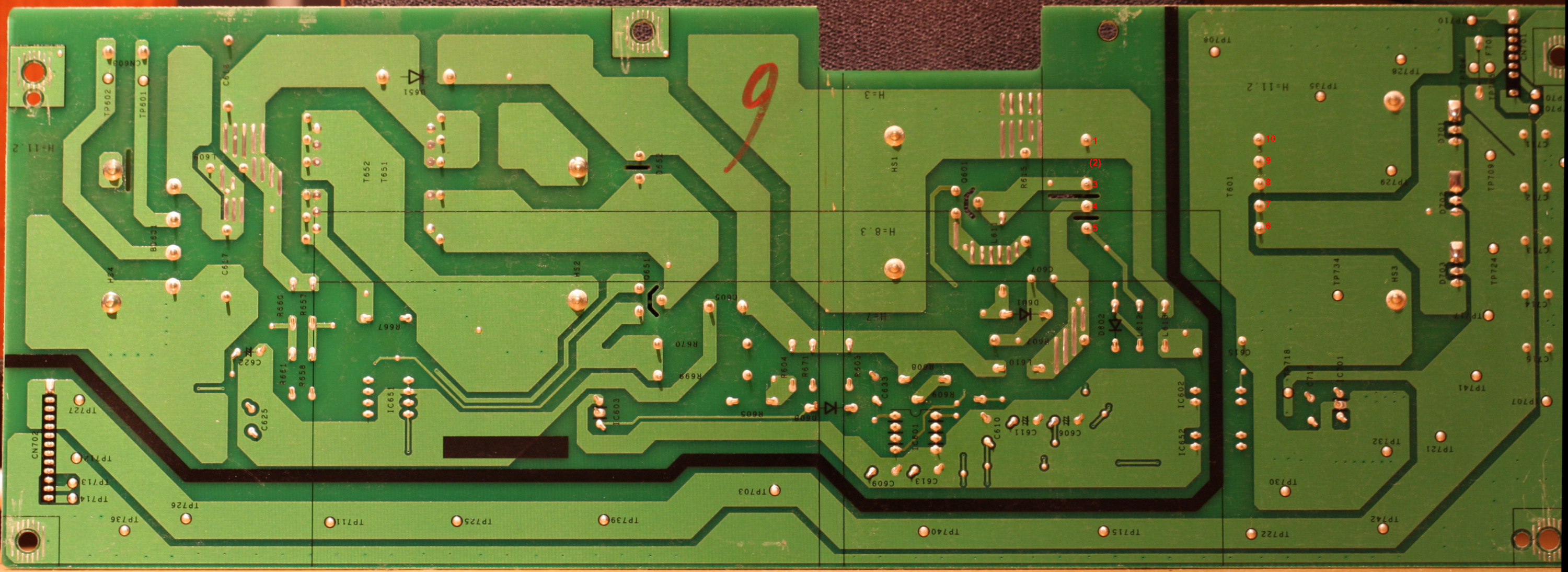

                    No the entire output is dead...
                    Took another picture of the board and played a bit in Photoshop:

                        #51
                        IC651 is a ST L6561 PFC Controller, I attached it's datasheet in a post above now.
                        The four resistors R657, R658, R660 & R661 all measure within 1% of 1MΩ out of circuit.
                        Their color codes are Brown, Black, Black, Yellow, Brown which = 1MΩ
                        I desoldered the 2x VF20200C rectifiers D701 & D703
                        Resistance was still 0.4Ω between the output legs of the transformer.
                        So I desoldered the secondary side of the transformer, resistance on it was the same.
                        Resistance on the now empty traces on the PCB changed from 0.4Ω to infinite resistance.
                        When I applied power there was no change:
                        The HS1 heatsink still heated up the same way and there was no power on the output of the transformers legs. (which now where in the air).
                        I take it the transformer is bad?

                          #52
                          I dont think these type of transformers show a resistance on the secondary windings
                          until they are working at which point you cant measure them im sure budm has mentioned this a few times I will try and find it. (in case i just made it up )
