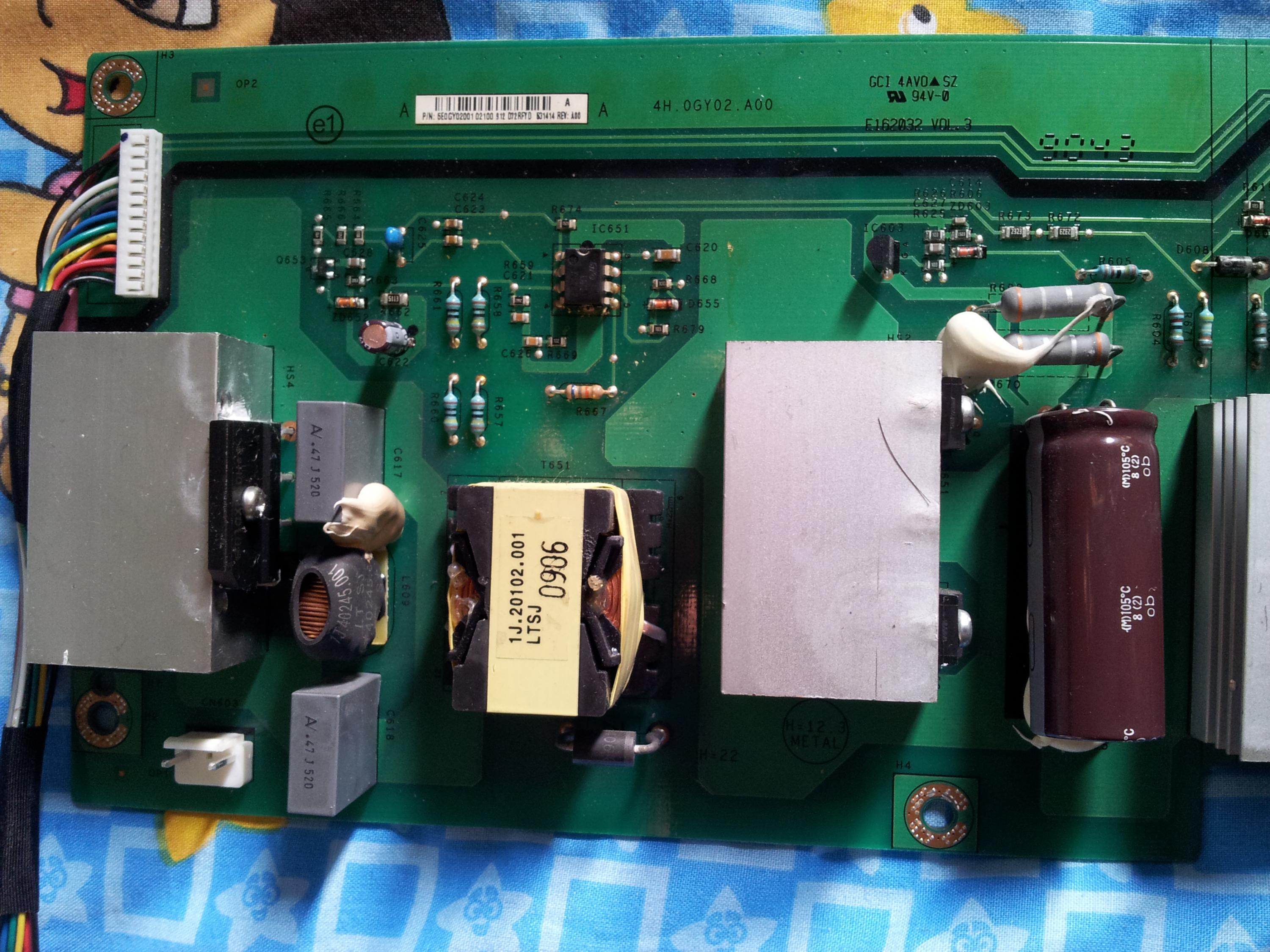

    Hey guys,
    First of all, thank you for those who are still keeping this forum alive.
    It has been a while since I posted.
    Probably because most of the monitors are all plain sailing repairs, or I am shamelessly buying or swapping cheap power/logic boards. Hee.
    Right now, I am facing with two big monsters, or should I say ‘white elephants’, which are ‘Dead’. One of them could be intermittently revived if NOT unplugged from the mains. (But recently could not ON at all even leaving it plugged for hours) The other could not be turned on at all. I could not find any schematic on the internet on this model. I hope someone can assist me in troubleshooting them.

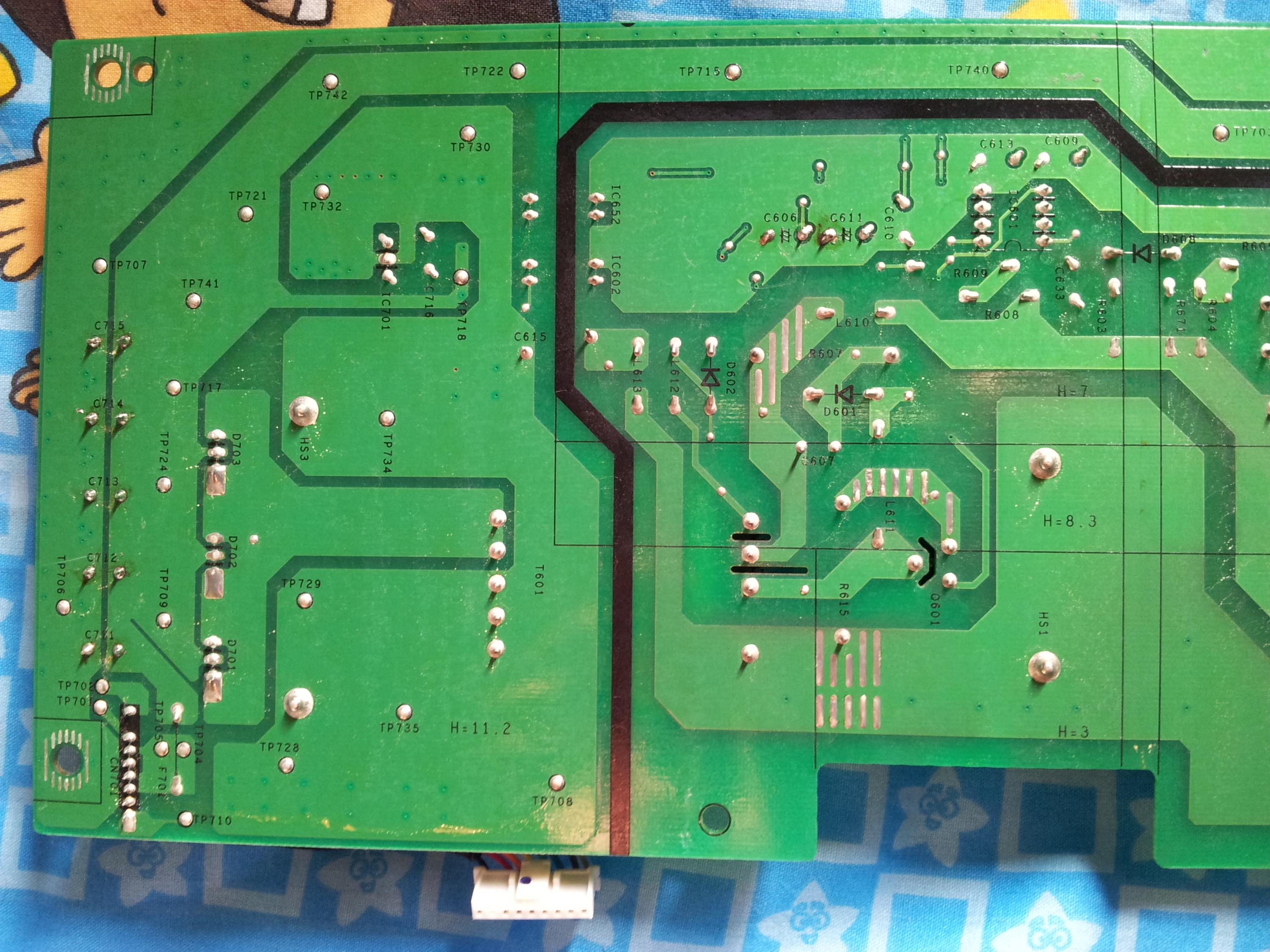

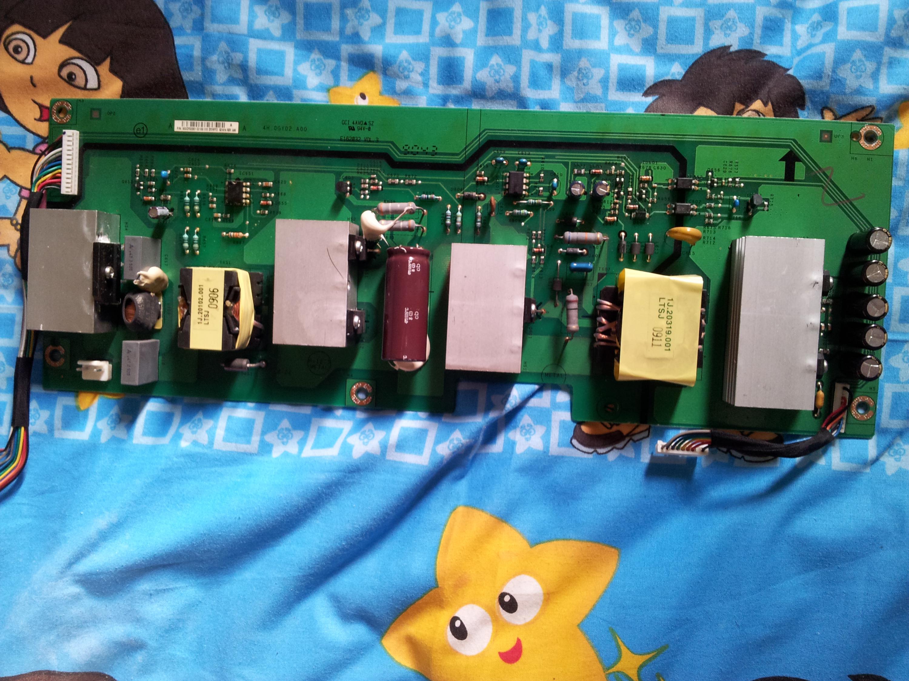

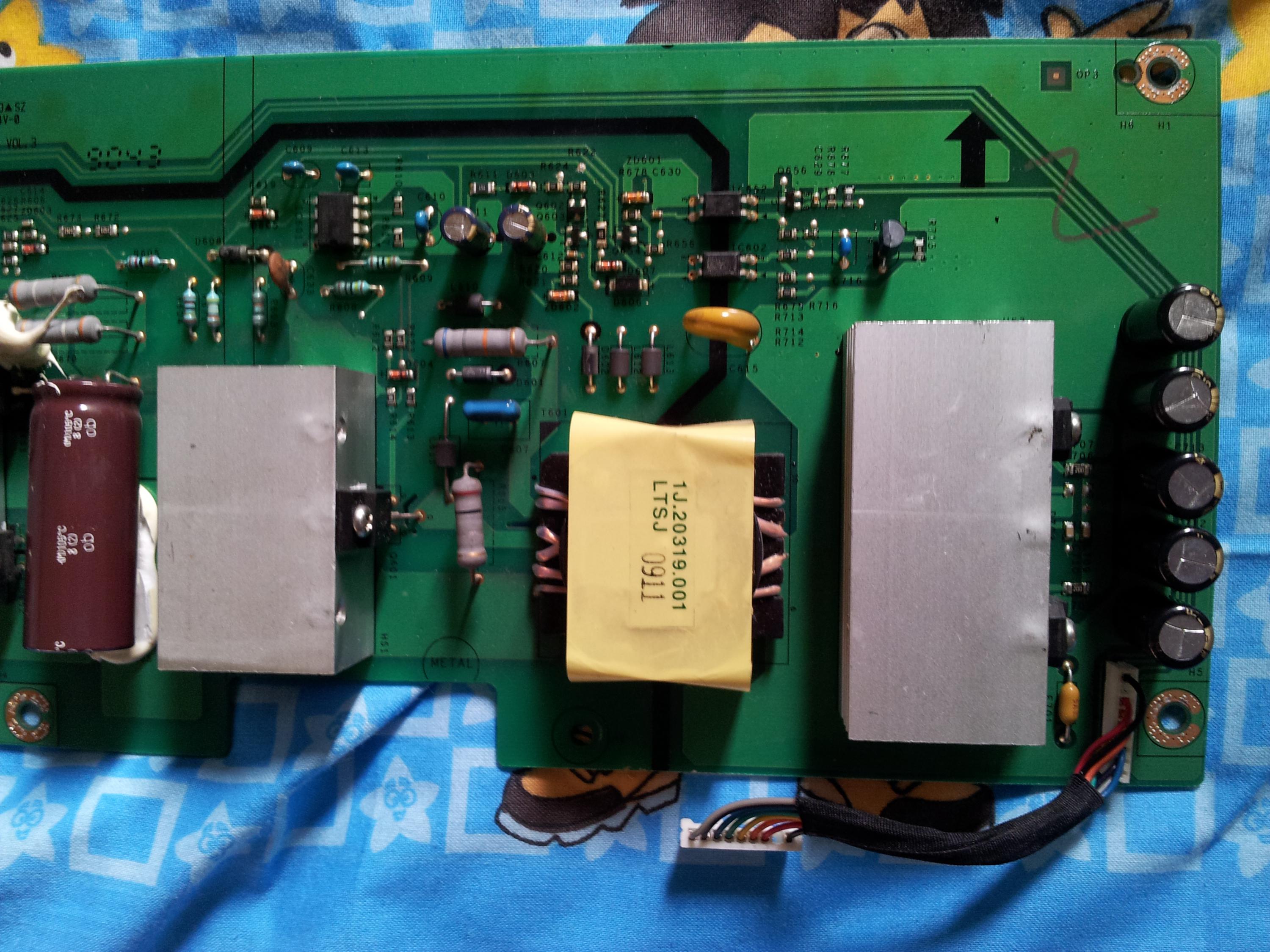

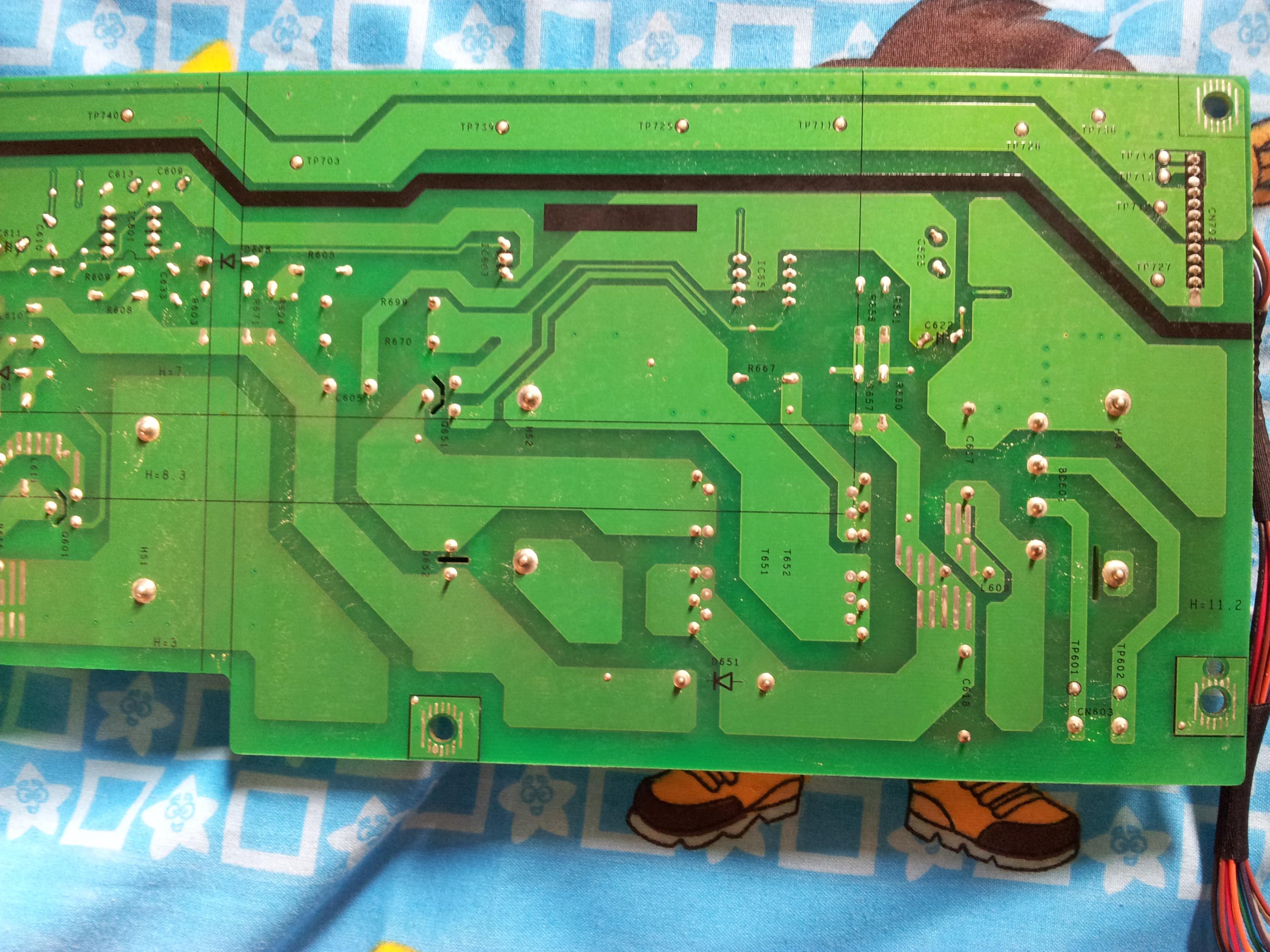

    Model : Dell 2709w
    (Photos as attached and both boards are the same model 4H.0GY02.A00)
    Set#1 –
    What I managed to measure on the power board–
    *Big Cap – 325V
    *Voltage out to the main board
    1 (to most black wire) - 0v (3.1V if turn ON)
    (empty)
    2- 0v
    3- 24V
    4- 0v
    5- 24V
    6- 24V
    7- 0V
    8 (bottom grey wire) - 0V (3.1V if turn ON)
    *Across electrolyte cap 47uf (C11) (next to IC601) – 14V
    *Across electrolyte cap 1uf (C622) (next to IC651) – 33V

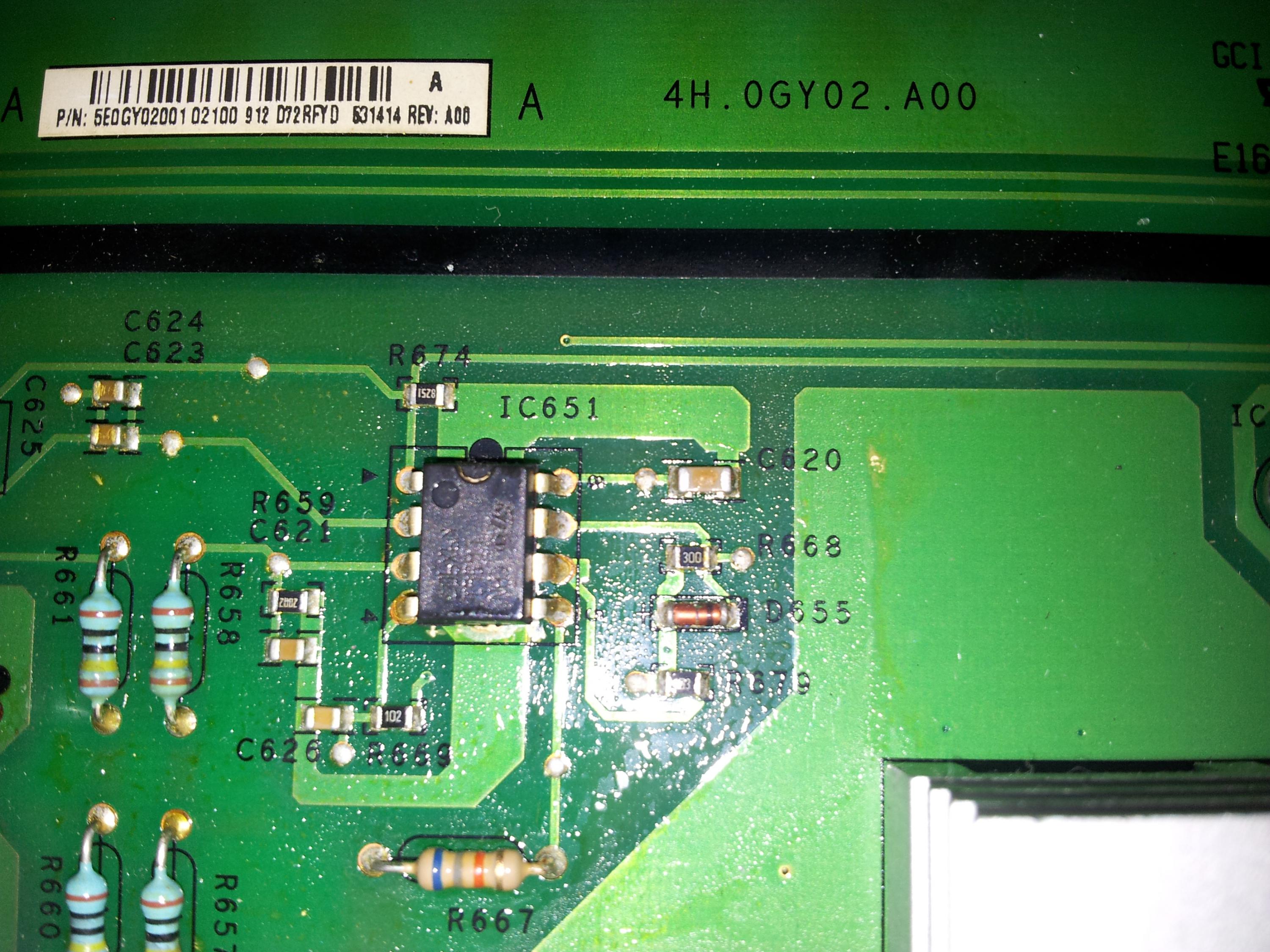

    * VCC of IC601 (123p60) – 14V
    * VCC of IC651 (L6561) – 0V!!
    What was done – Replaced the entire electrolytes. Re-measured the above and they are still the same. No power. Unfortunately while measuring the VCC of IC601 I shorted it out; there was a spark, loud BANG! and resulting in killing many components (2 SMD resistors blown, Diode K3679 on heatsink, D604 & ZD601 – shorted and main fuse goes south). Oh well!
    Moving on to Set#2
    *Big Cap – 325V
    (empty)
    2- 0v
    3- 24V
    4- 0v
    5- 24V
    6- 24V
    7- 0V
    What was done – No replacement of electrolytes because from Set#1, they do not rectify the failure.
    Continue to trace the VCC of IC651 (L6561) ( 0V) and it leads me to the Gate pin of SMD Q554 (directly below ZD601). The Base and Emitter of this diode is Both reading 14V though.
    So my questions are
    1) Am I concluding it rightly by focusing on the power board or the mainboard could also be causing them to be dead?
    2) Am I right to say that VCC of IC651 (L6561) should be the range of 14V also? If yes, could it be the IC622 (L6561) is faulty (not producing 14V) or should the Gate of SMD Q554 be supplying it instead to it?
    3) Any other measurement should I be taking?
    Apology for the blurred pictures, please let me know if any one needs a better lighted image. or i can link to my dropbox folder?. Damn! I should have placed it on the floor while taking the pictures. Lol!
    Thank you in advance for all your replies

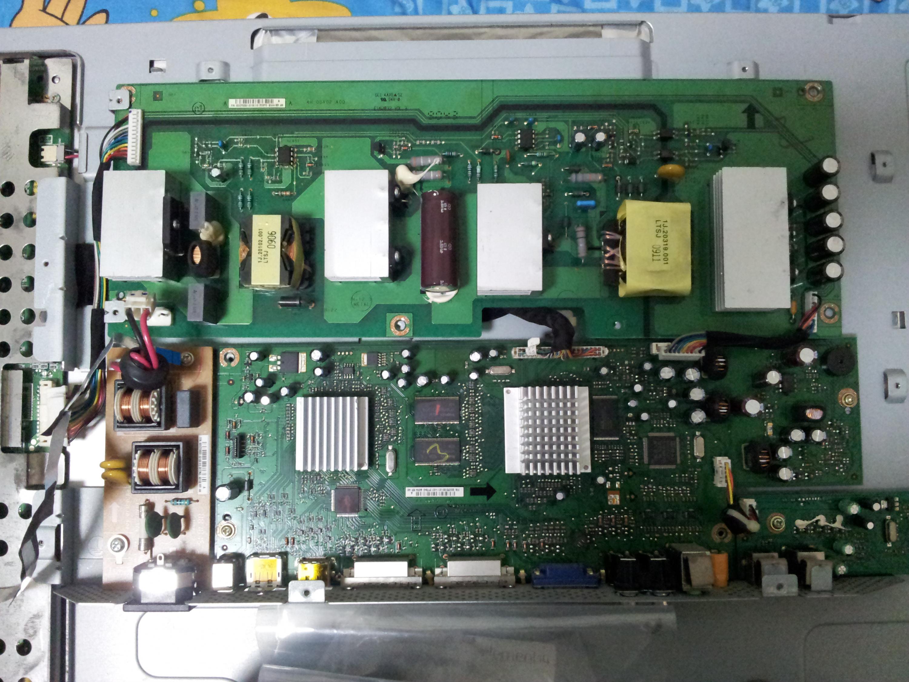

        Still battling this monitor. I have started drawing up my own schematics. I'm beginning to think this monitor is not repairable. Anyway here are some photos:
        This is the layout with the back off. The power supply module makes just one Voltage, +24V. When the power is on the mainboard sends a signal to the power supply however no extra outputs are enabled and the output Voltage does not change. I suspect the signal is there to get the power supply into a high power mode.
        Here is a close up of the various secondary supplies which are made on the main board. I have replaced all the electrolytic capacitors here. All the supplies are fine, with no ripple. I have labelled the power supply connections. Another way to get the monitor to work is to keep the +24V connections on the blue and green wires, then apply the 24V to the orange wire.
        Here is a close up of the keyboard connector J13. When power is applied to the monitor the +5V is present however there is no activity on the SCL and SDA lines. If I trick the monitor into starting up by slowly ramping up the power then the CPU initializes and there is activity on the SDA and SCL lines, then you can power the monitor on. Regardless of whether the CPU initializes or not the 19.6608MHz crystal runs.
        Such a mystery....
