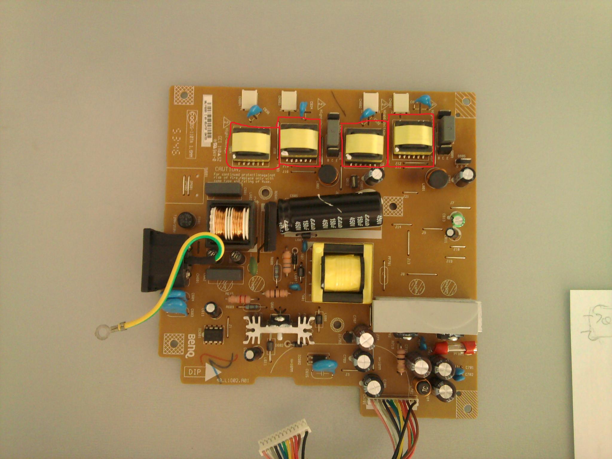

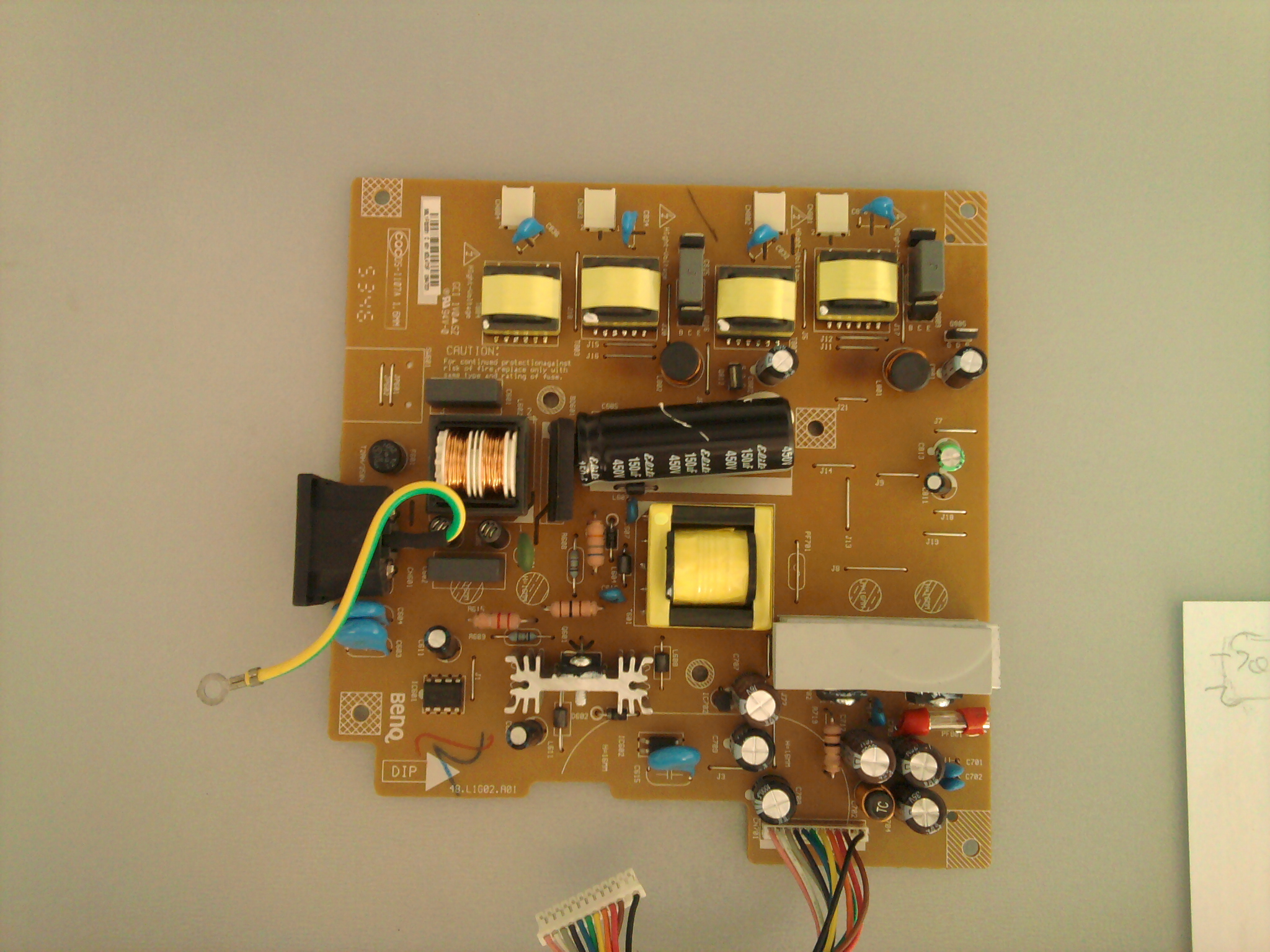

    have LCD HP 1940. Got out in it's backlight.
    Power board: BenQ 48.L1G02.A01
    Replaced Q808, Q809 on C5707, Q805 on FU9024N and PF801 125V/5A fuse (I had no counterpart here so when I put the glass fuse 250V/4A).
    When the monitor, there is a backlight for about 2 seconds and stops working again.
    What do you propose to make this work?

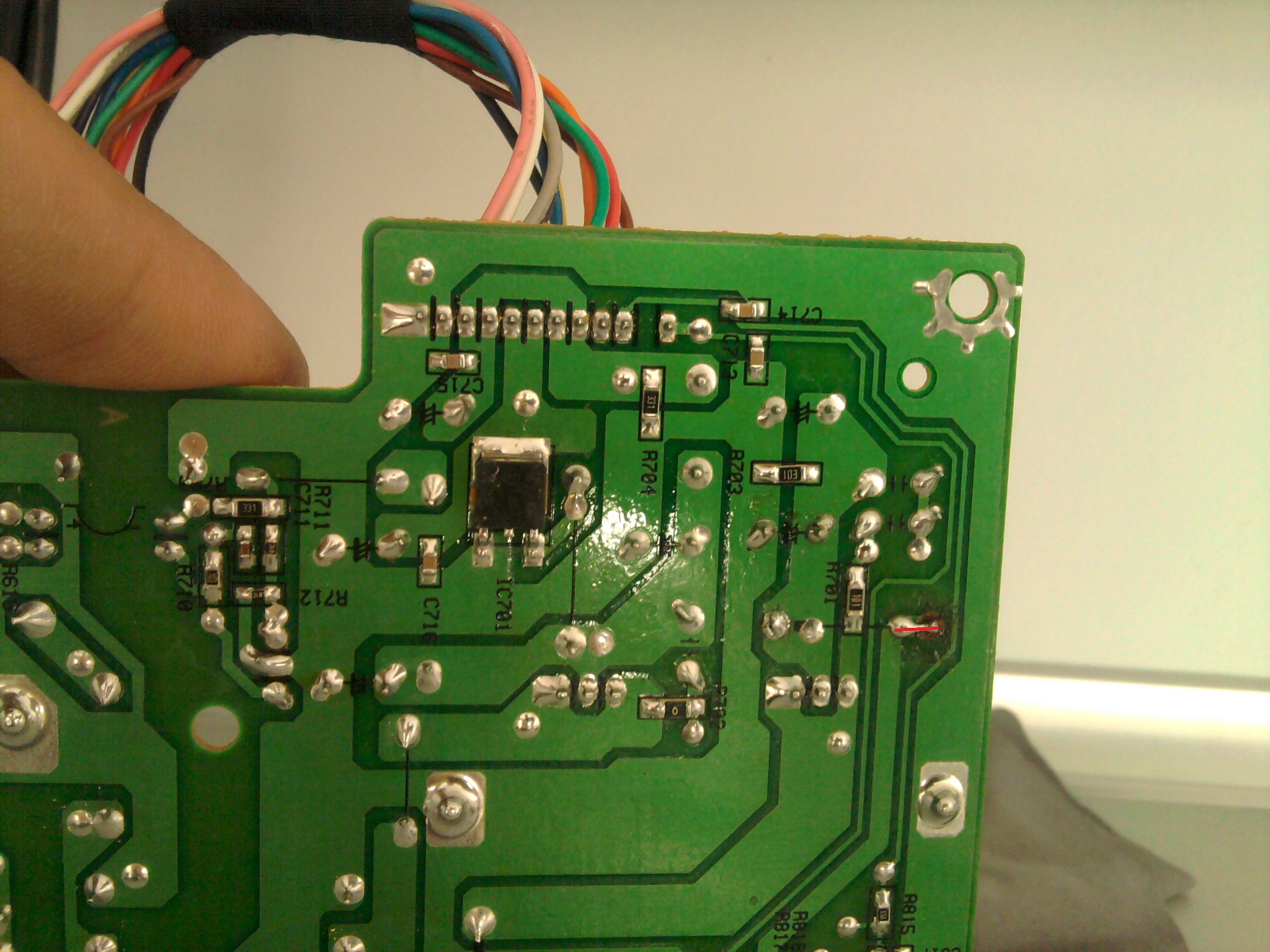

    When replacing the fuse busted my pad of PCB. So I did this (IMG_20130719_164600.jpg ). I think it has no effect on the backlight.

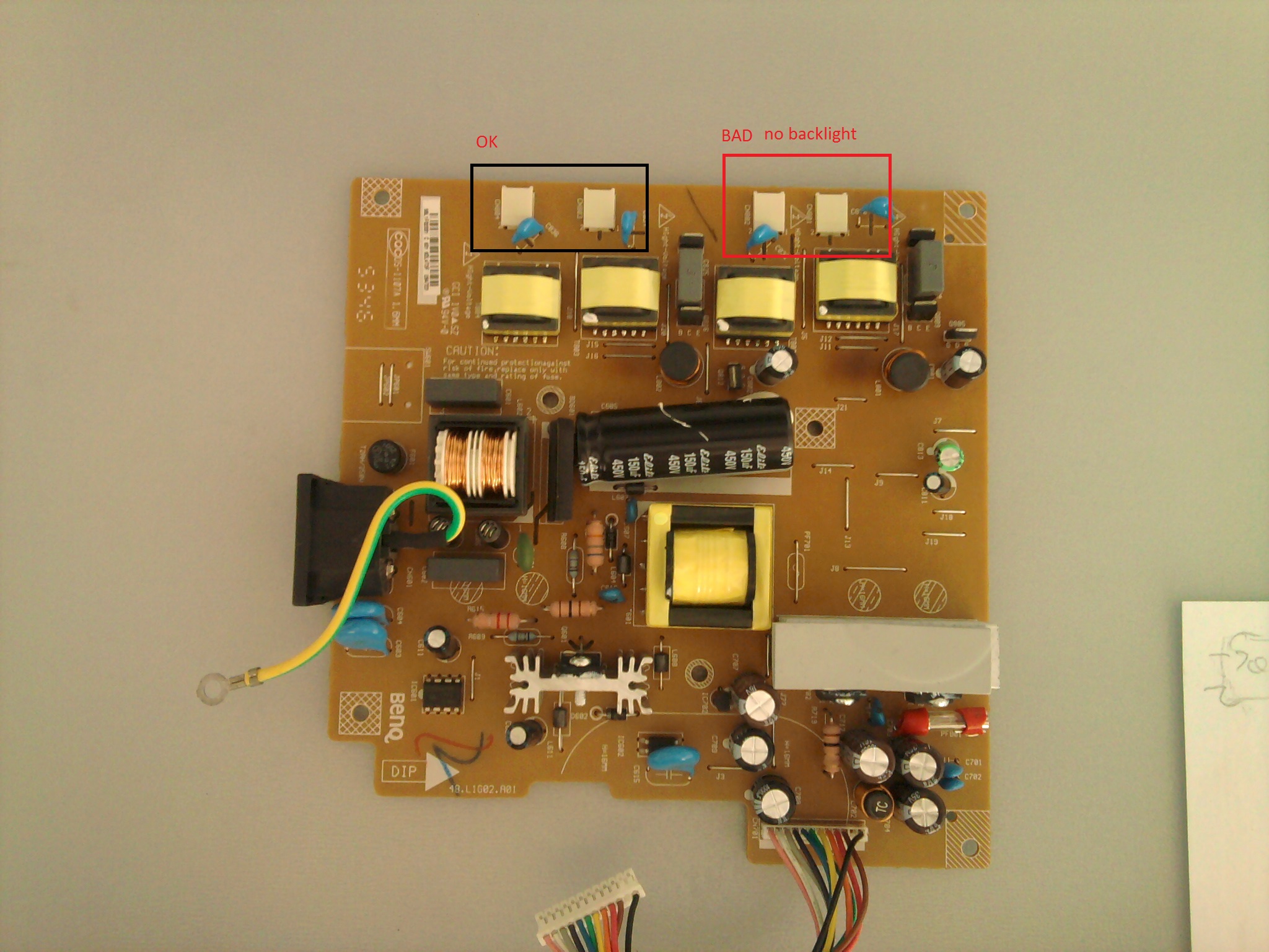

                  I connected the two pairs of CCFL. The effect is the same. The backlight lights up for a moment only a first line (shown in photo). The second line there is no backlight.
                    Re: HP 1940 - no backlighting
                    "Replaced Q808, Q809 on C5707, Q805 on FU9024N" so those transistors are in the section that dose not light up the lamps, I cannot read the designators of the part from the pictures.
                    Did you also re-solder all the connections of all the transformers in that area?
                      My suspicion is bad transformer. Have you measured the transformers on the side where there is no backlight?
