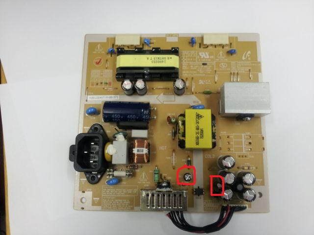

    I have a Samsung T200 monitor i picked up to repair (no power)
    Opened it up and found someone has already tried to repair it and made a bit of a mess of it (wrong caps a damaged tracks) using Jamicon 85*c caps .
    Anyway the help i need is with 2 caps i think are the wrong
    C103 = 47uf 25v
    C204 = 10uf 50v
    C103 is on the primary side
    C204 is on the secondary side See pic
    I think C204 should be the 47uf 25v as it is in a cluster of 25v caps
    and C103 should be the 10uf 50v as it is on the primary side.
    Has anyone got this power board BN44-00177D that can confirm this for me
    Thanks in advance

    I think those are actually correct. C103 is 47uF, and C204 is 10uF. Just that the rectifier diodes are missing! Looking at images from around the web, like this one here: http://www.shopjimmy.com/samsung-bn4...upply-unit.htm (which has a very large image that is zoomed in when placing the pointer over the designated area) you could see that C103 is much bigger than C204.

      Cheers mate will check for the diodes ,but should have said that rhe pic was just for location and is not the board i am working on sorry.
      Will double check everything today and post proper pic if still no joy
