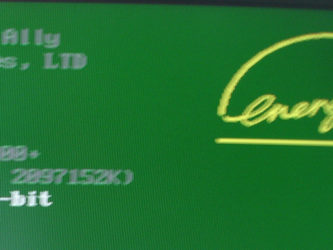

          I did that but no change. This is how black background looks. If you look closer you see something like vertical lines. In windows alot of colors are missing in the center of color wheel from color correction section (all are replaced with this color I see on black background).

            Re: Samsung 305T bad picture
            Originally posted by andrew1
            Sometimes it works flawless. Could be a bad DVI cable or something else? Thank you.
            Try cleaning the LVDS cable and the FFC/FPC connectors on both the Tcon and Dscaler boards, with contact cleaner. Also check the supply voltage to the Tcon board. If that does not help then you're looking at a failing panel (ie. possibly dying Tcon board).

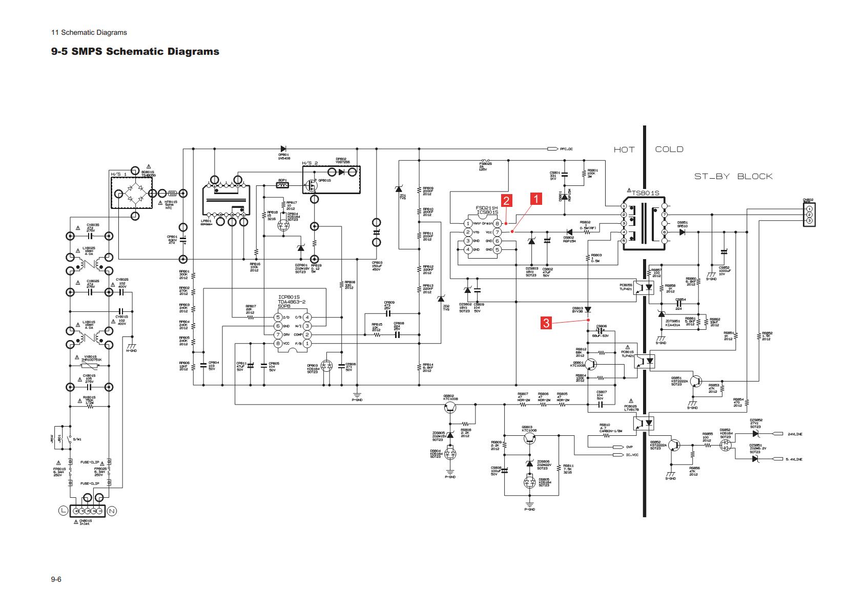

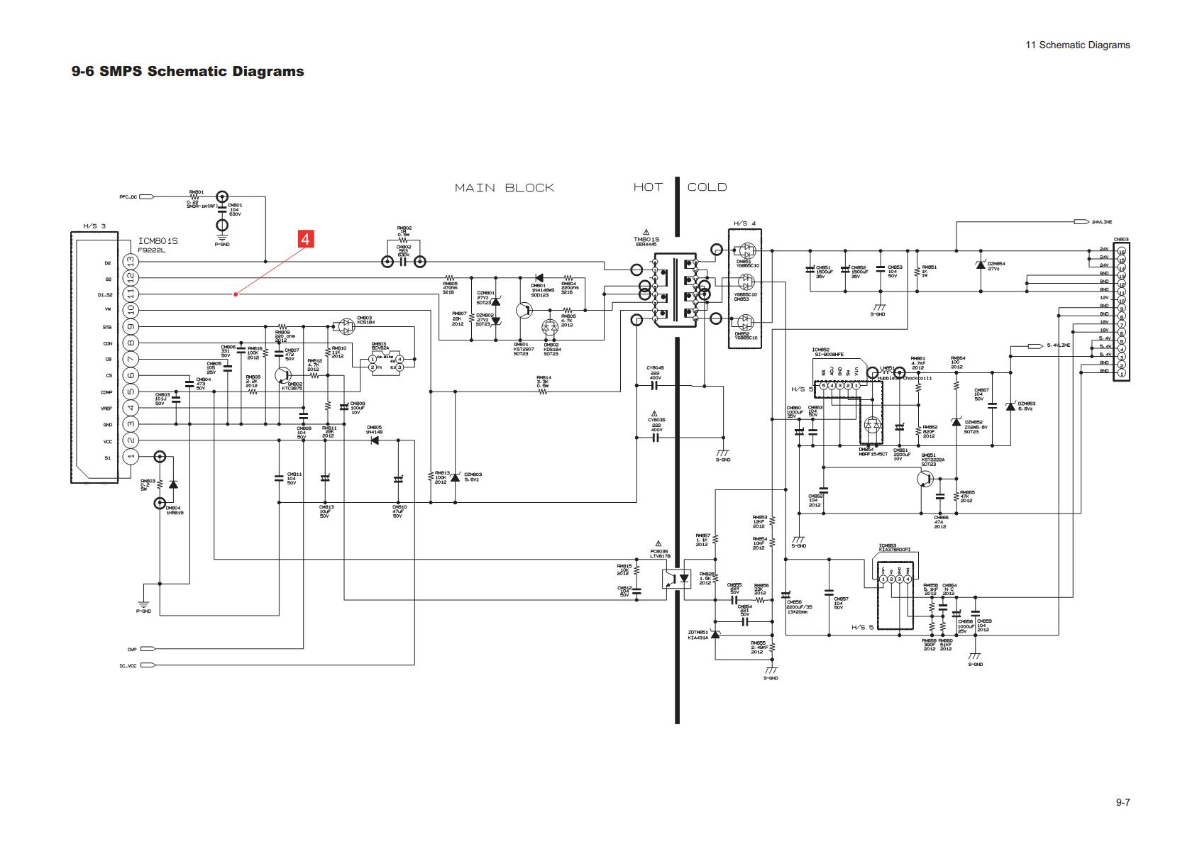

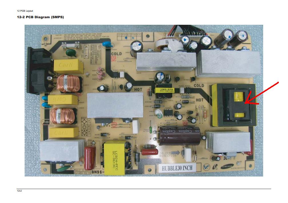

                  The transformer in the picture make a buzzing noise. Any ideas? (Check SMPS diagram).
