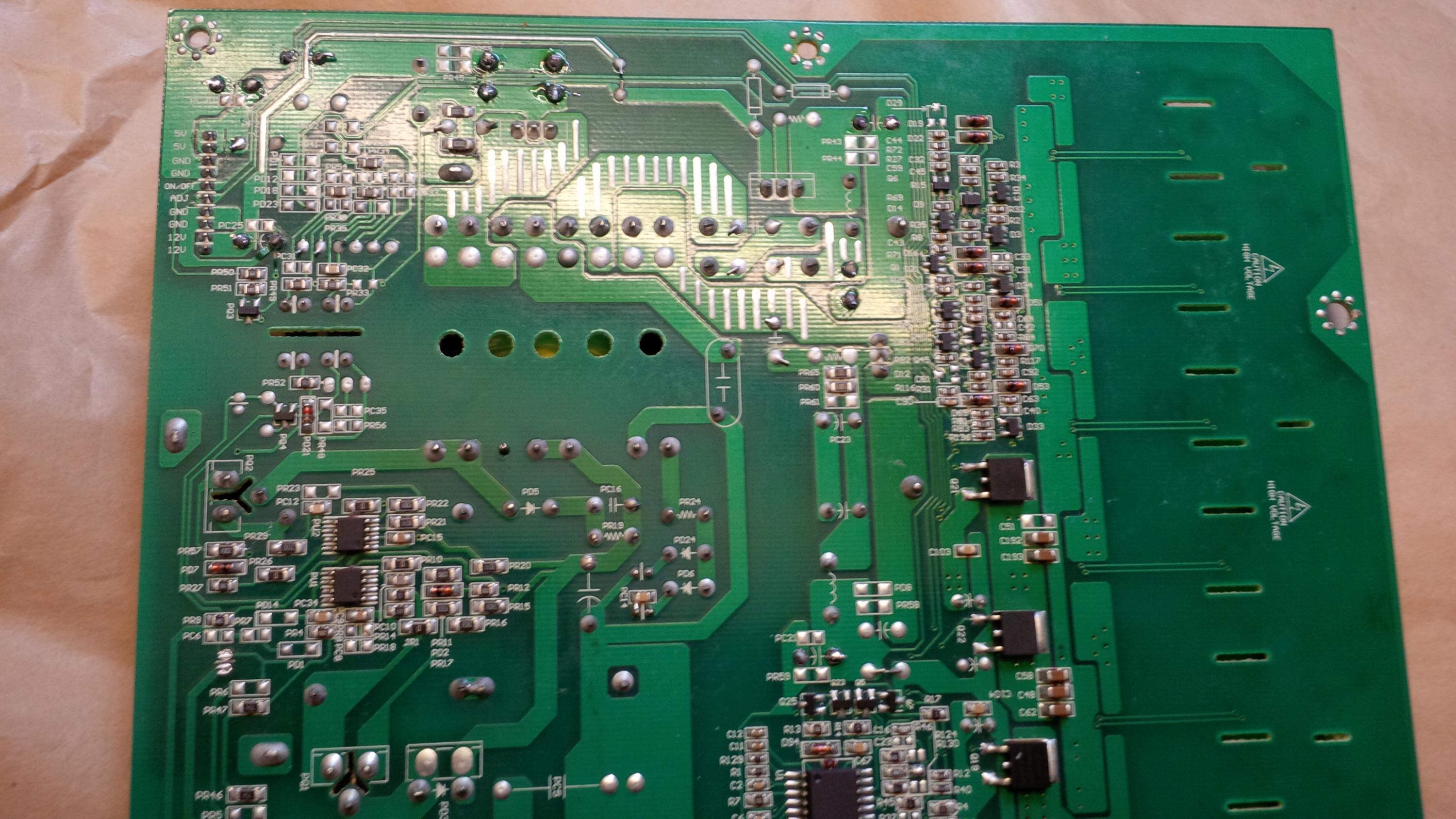

    Hey folks,
    I've got a DMG 24" monitor bought from ebay, the user said it was working fine and then it just started to show lines on the LCD.
    So I grabbed it opened it up and saw clearly two bad caps, plus a third that was the same make (and identical farad and voltage), so I replaced all three. In the process however I seem to have snapped the board that contains the buttons!
    Now the LCD just flashes on for about 1 second (all seems perfect image wise), then goes black. This happens when power cable is re-plugged and ALSO when the DVI cable is re-plugged in also.
    Since the buttons are broken a little multimeter check showed the buttons are high and each button takes the line low to trigger it.
    Since I have it disassembled, I can hear a high pitched noise when the monitor powers on, it then disappears for a few seconds (while the LCD backlight is on) and then re-appears once the panel switches goes black (and stays there), once I unplug from mains the sound seems to wind down slowly.
    So folks your help on getting this fixed would be most welcome! It's an extremely nice LCD and only reason I bought it is for sentimental reasons, I had the exact same panel a few years ago and had to sell.
    Monitor also goes by the name of Digimate, Yuraku but is acutally a Viewsonic Optiquest Q241wb.

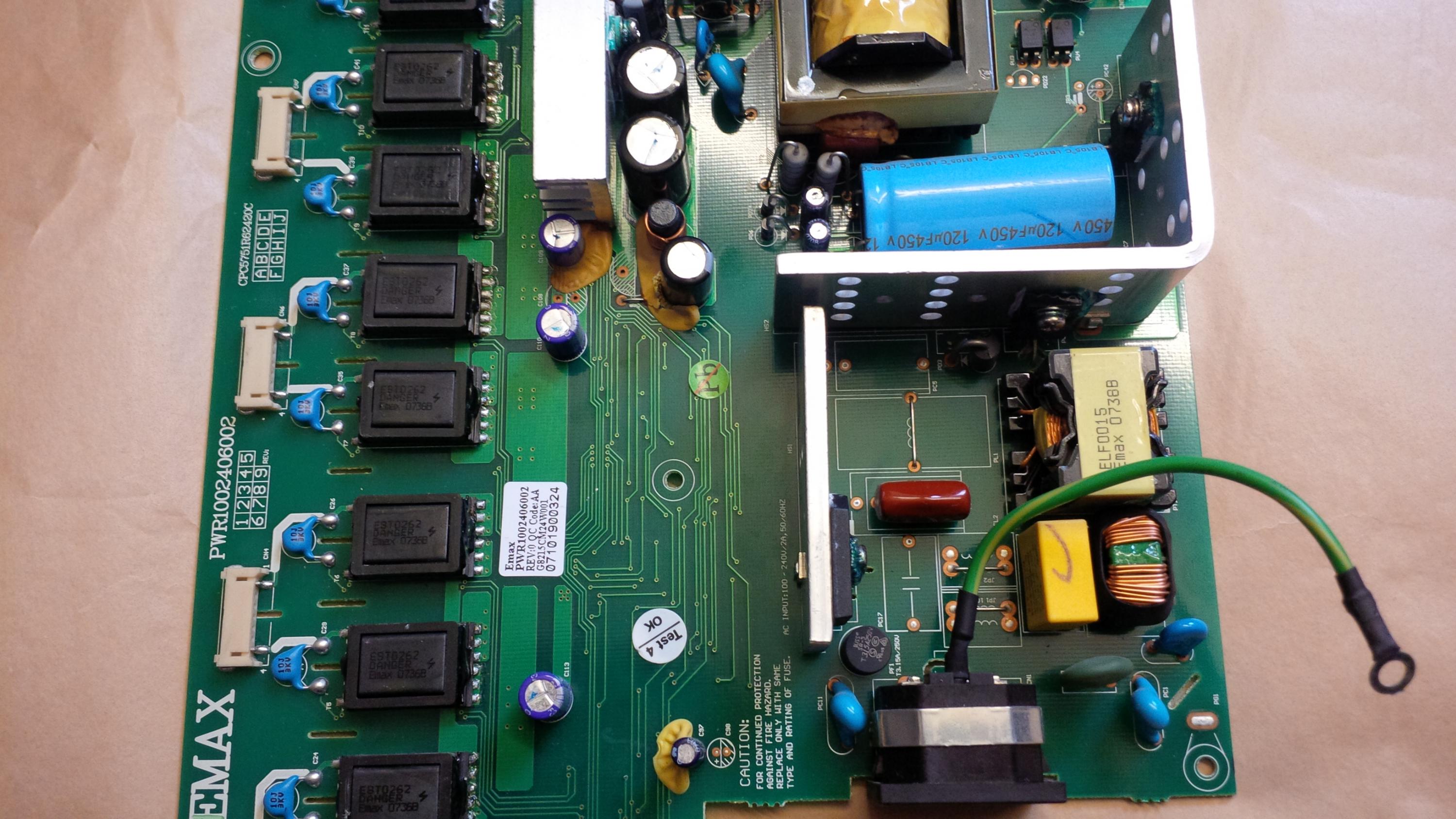

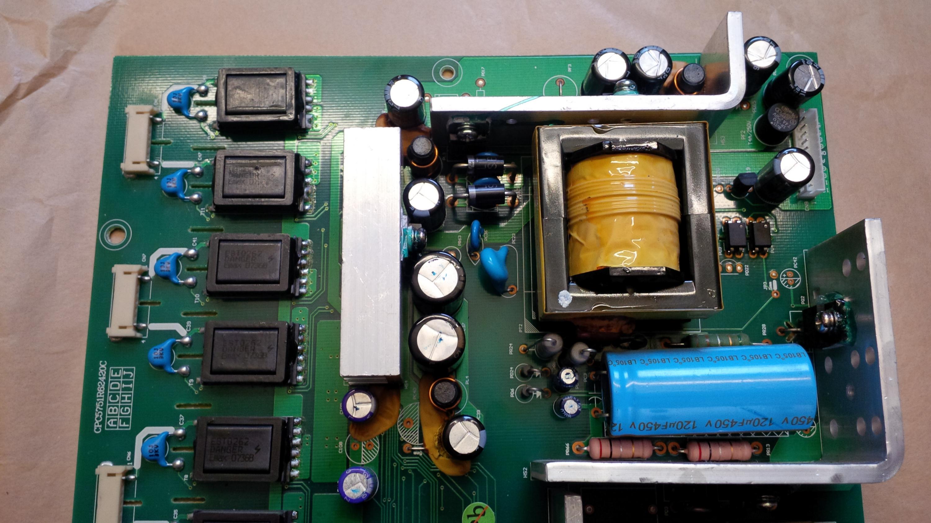

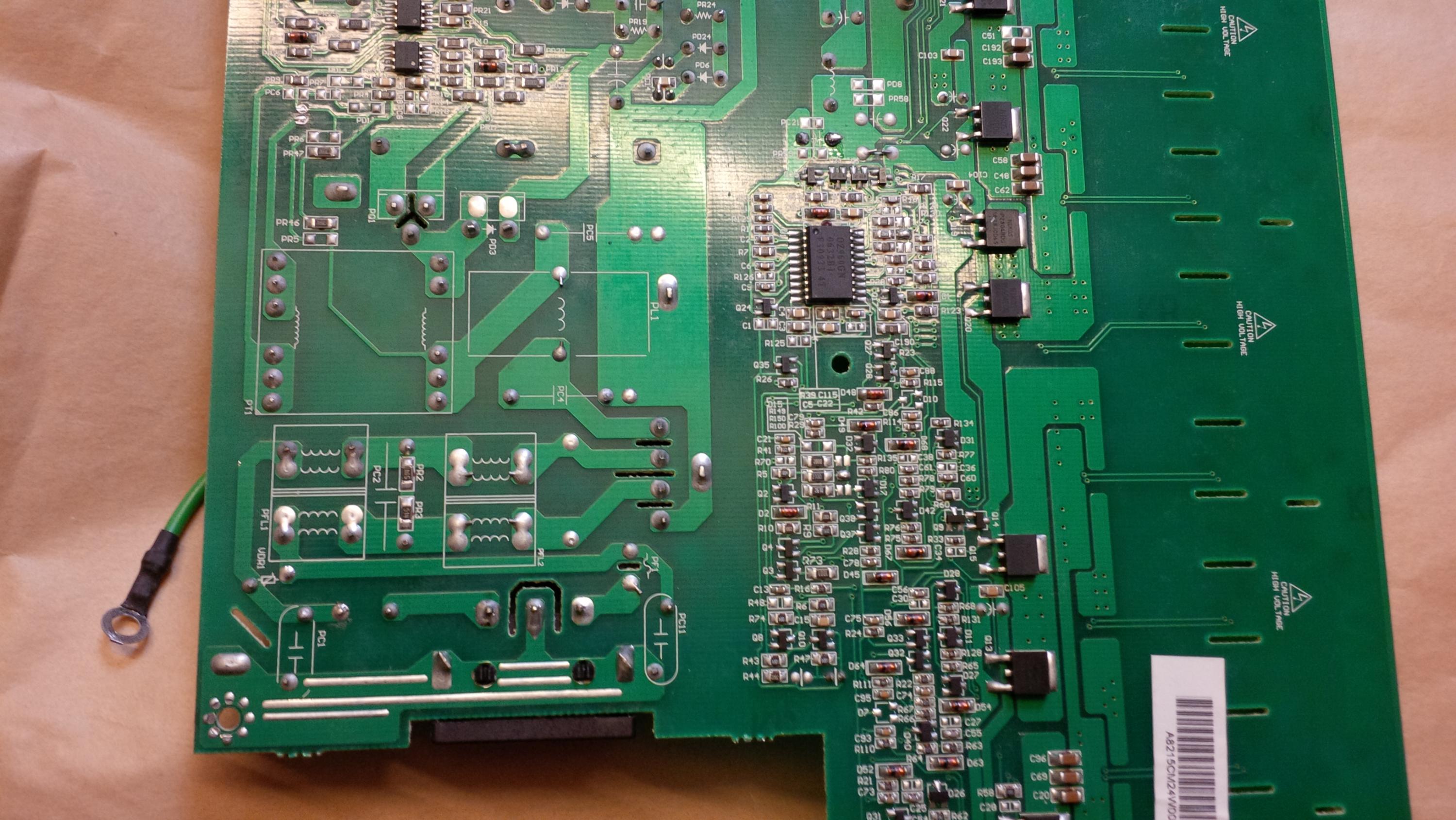

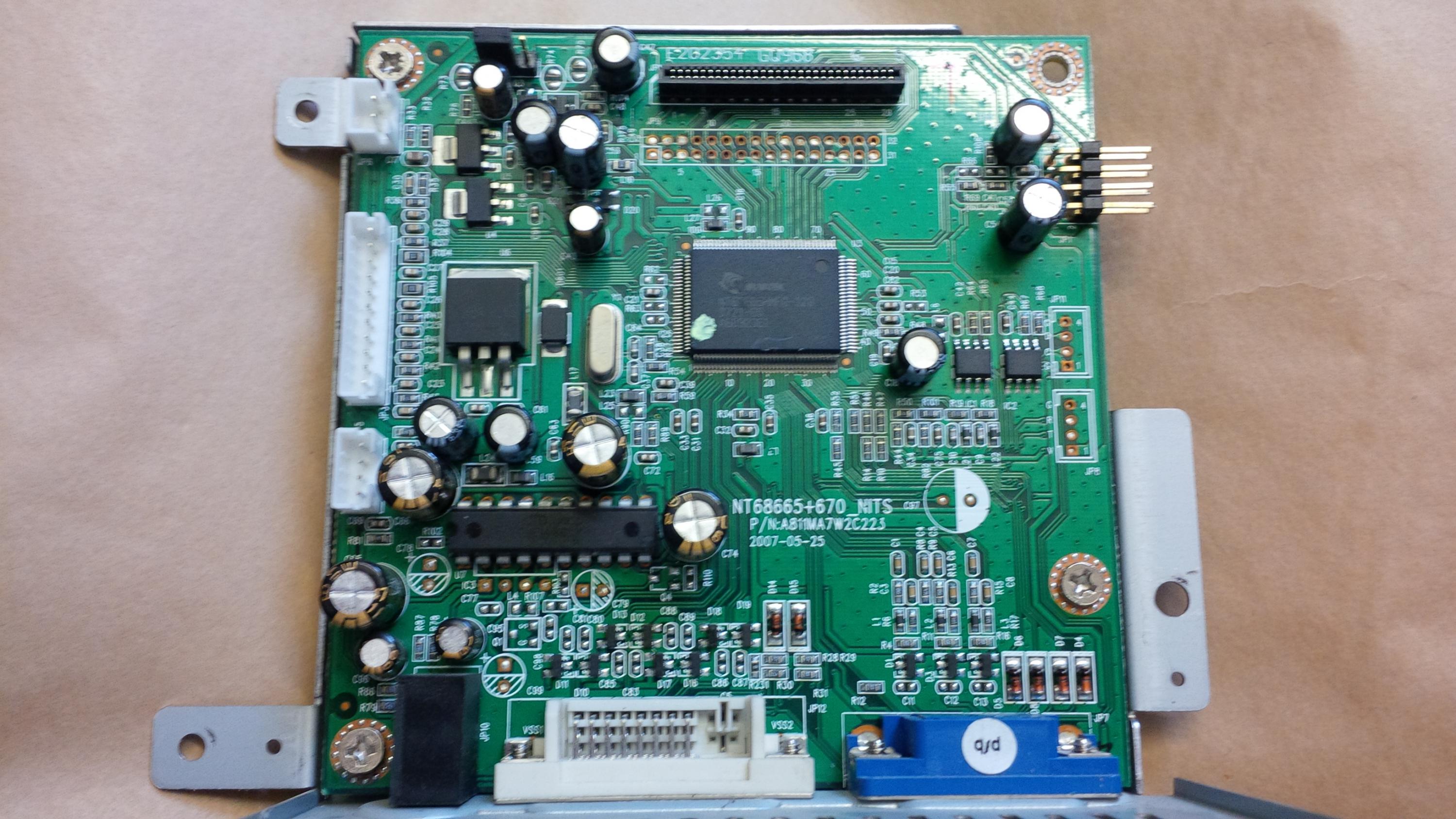

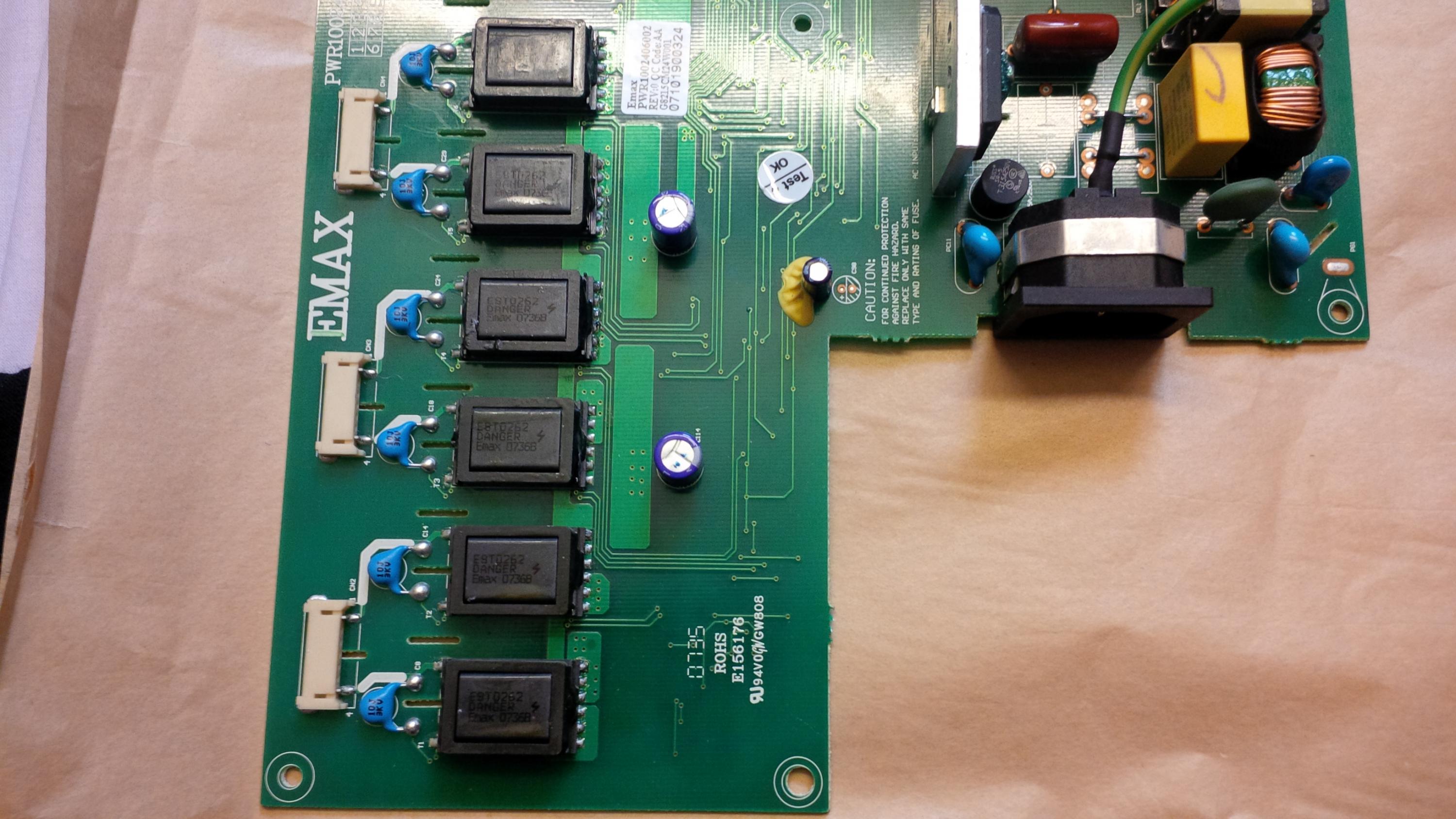

    pictures of the power board:
    https://www.box.com/s/9r8h8nalopf5mzj2banz
    https://www.box.com/s/nhd7s48wpyy00z8e6nsf
    https://www.box.com/s/8ztl1ym5ssfbs8tqlb3n

                On the left hand side in the first picture, the white connectors (above and below where it says ABCDE FGHIJ), the pins inside the connectors where the inverters plug in were bent - so one pin would make contact and not the other, so a complete circuit would not be made.
                I straightened the pins and voila! Working!
