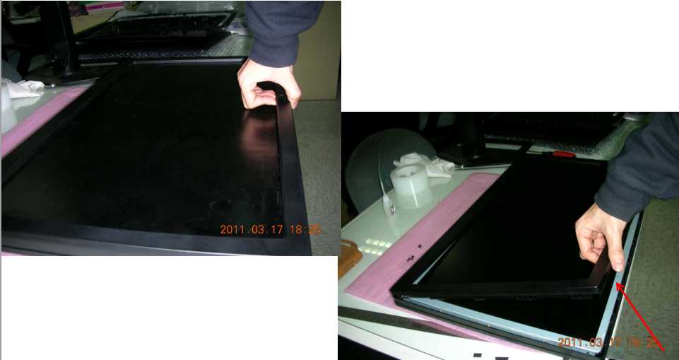

    Opening HP LP3065
    Took all the screws out and tried gently to pop it open... no luck
    I do not want to damage the case out of frustation
    Any pics or tips out there from people who have worked on this monitor
    Thanks from 1st time poster

    Re: Opening HP LP3065
    Just pull out front bezel with your hands until it pops out, then you'll be able to remove screen from plastic housing.
      Thanks for the reply
      Mine was on there tight as all getout
      A little screwdriver and hammer action from behind seam coaxed it lose with no damage
      Will keep updated to see how it turns out ... badcaps or something else
        Same experience I had, really nasty clips all around the frame.
        They really know how to make these things extremely difficult to open
        What were your monitors "symptoms"?
