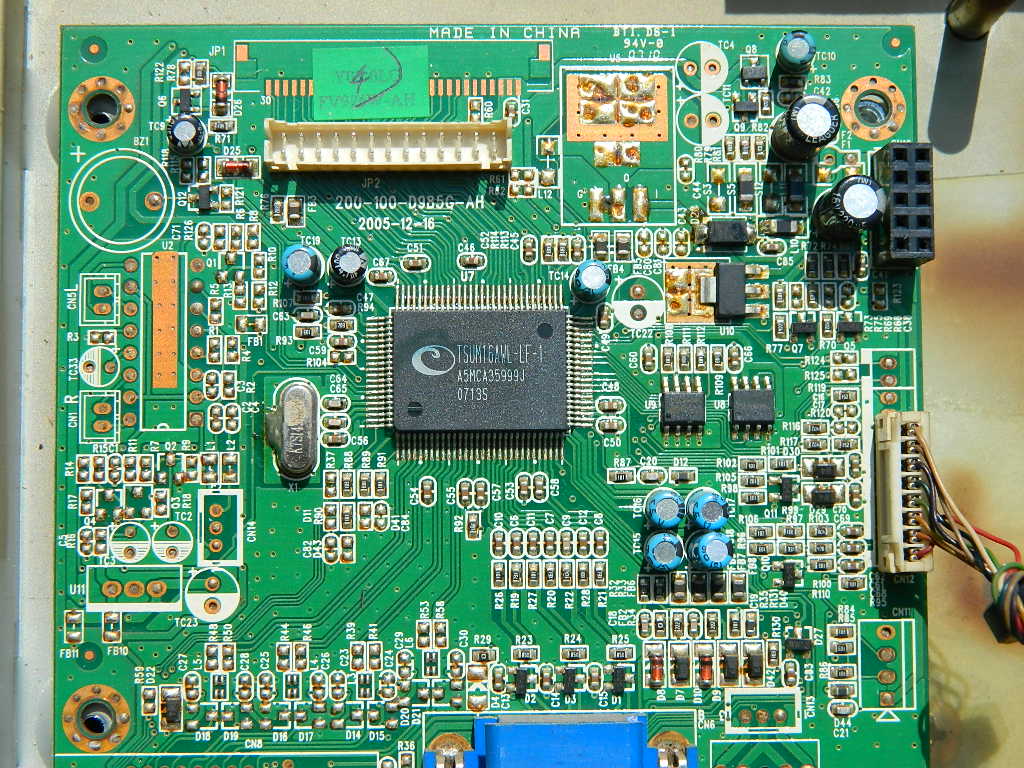

          The 1st pic is what I believe to be the logic board.

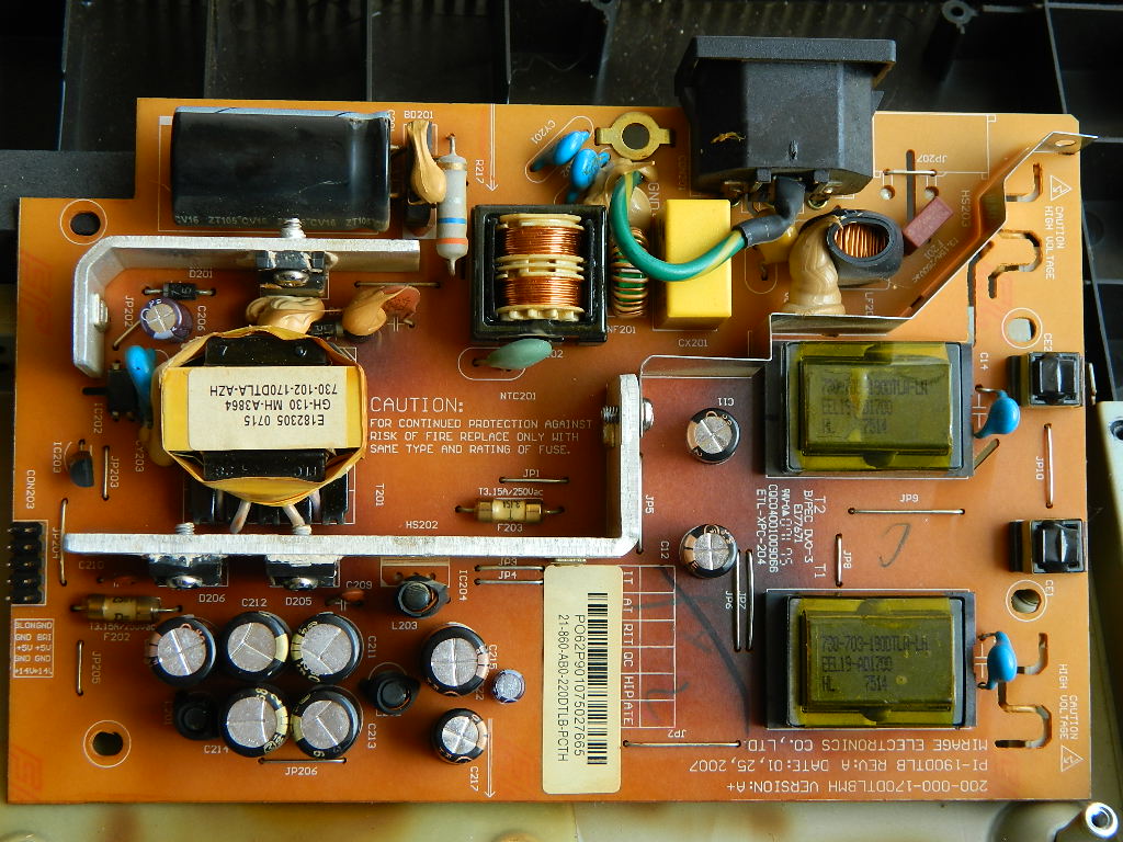

          The 2nd pic is a pic of the 200-000-170DTLBMH power board. All caps, except the 100uF 400v, have been replaced.
          The 3rd pic is of the reverse side of the power board. Took quite a few pics to get clear identifiers of the points.
          OK, so what is the inverter board?

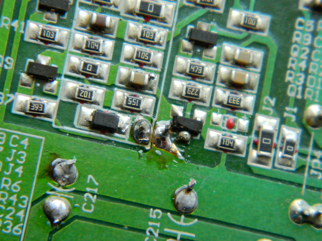

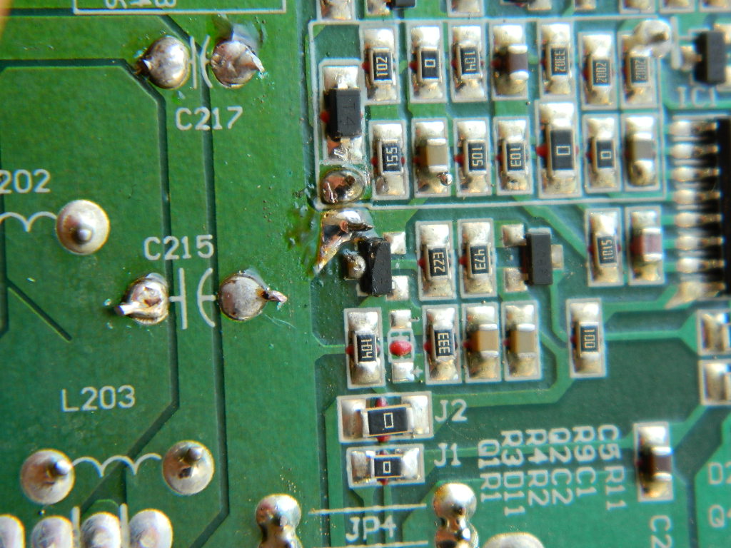

          The 4th and 5th pic is of the reverse side of power board zoomed in at a concern with C22 ("C22" can't be seen printed on this side of the board). First of these two pics (4th) is from same angle as the 3rd pic, the 5th pic is of same location, just a different angle. The C22 cap gets a 0 voltage reading. I was concerned originally with the solder as the pics show, when I originally solder wicked away the original solder, what was left behind was the metal exposed on the board as you can see. There is a concern with the resister in the 4th pic just above the "104" resister. I can barely make out a "t04" on it (I'm assuming that it's a resister). The corner closest to the C22 looks chipped.

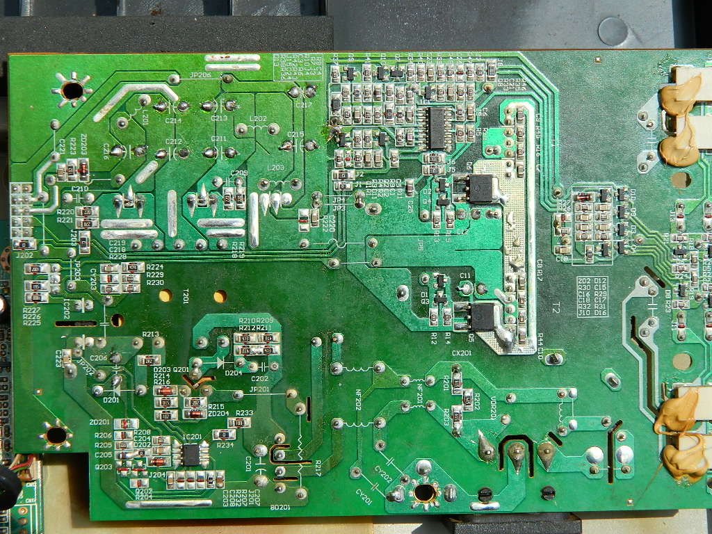

          I haven't looked at the CCFLs yet. I'm trying to find a good video showing someone breaking into the screen. I don't want to start just tearing into it without know what not to touch and such. So far, the best I have found are low resolution videos getting into a laptop screen. (why tear something apart never knowing about that "hidden screw", when you could get a heads-up seeing someone else do it first)
            Re: Proview PL926Wbi - recapped, same shut off issue
            It doesnt have an inverter board as such- the inverter transformers are the two big gray
            rectangular components in Pic2.

            That "resistor" is at Q1 and I think it is a switching transistor - I will try and find it T04 you say?
            EDIT2
            I think it might be one of these
            http://pdf1.alldatasheet.com/datashe...BZX84-A11.html
            t= made in malaysia 04

              **oh and from what I can see on the thing that you think is a switching transistor, what I can see when I look real close is lowercase "t"04 on it. I can't tell if there is or was something after the "4". teenyweeny

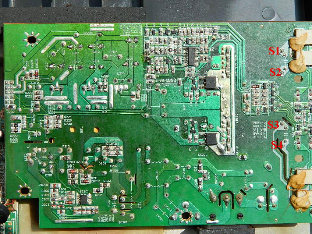

                Ok Anal we like - saves a lot of problems.
                Looks like although it is chipped that Q1 may be ok.
                Just before you get to the lamps do this test POWER OFF meter on ohms
                2000 test S1 to S2 and S3 to S4 as on attached.
                Also if that glue has become hard and is brown you should try and remove it as with age it becomes conductive

                      Well that sounds bad but I expect you have tested them incorrectly or I have marked the wrong pins!!
                      Set your meter on 2000 ohms and touch the probes together should read 0.00
                      or near. Probes apart should read "1" or "OL"
                      Put red lead on S1 black lead on S2 if there is any lacquer on the joints
                      scratch through it.
                      Then Put red lead on S3 and Black lead on S4.
                      Fuses
                      Almost the same - POWER OFF Set meter on ohms 200 put one probe on each side of the fuse - should read the same as putting the probes together -0.00
                        I see what my first problem is, when i touch the probes together for an ohms test, my meter reads 002 @2000 ohms. =/
                        with that said.. S1-S2 I get a reading of 797, S3-S4 I get 805, and both fuses read 002 (which is the same when I touch the probes together.....so should be good?

                              That's extremely high voltage. The best method is to plug in a spare ccfl and locate the bad bulb.
                              Your inverter transformers look fine. The readings are within 3% of each other.
                              Do you have a spare monitor that you can plug in a known good cffl from it into each connector on the bad monitor, and find out which bulb is bad?
