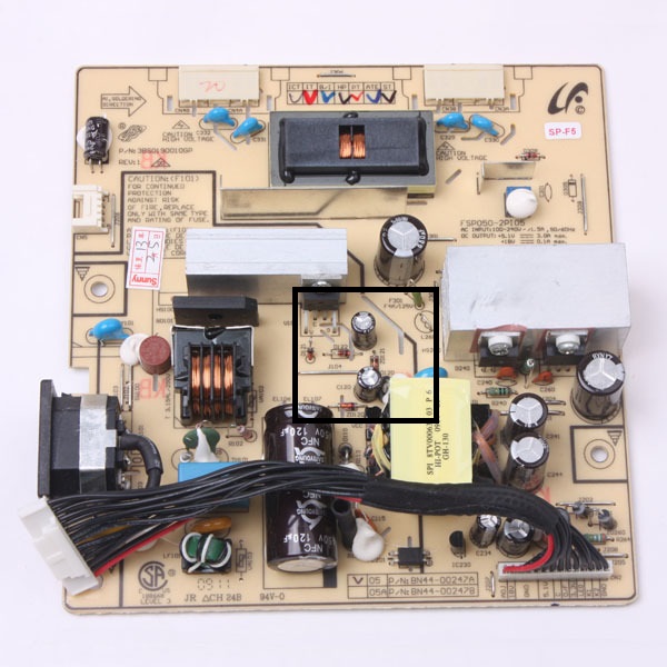

    Hello All,
    I've looked through the other threads on this monitor and didn't see what I was looking for. I was working on this board when I was interrupted by a phone call.
    I then forgot what the cap values were for C120 and C123. First I thought they were the same value but later realized they were different. By chance does anyone know which value goes to what spot on this board?
    Thanks As Always,
    lcdman

    Hello Again Everyone,
    Almost 25 views and no one knows the values for C120 and C123 on this board?
    All the other pictures of this board have not been good enough to see the caps in question. I need help here folks.

      470uf /35 volt or 330/35 volt

        I checked and I don't have that board, sorry. I scoured google images but nothing was clear enough. In each picture I noticed the bottom cap (C120) was mounted right up against a small component with glue on it. In some pics the glue extends to the cap. Do you have your old caps that you took out by chance? Look for one with a mark on it. A scratch. Some glue. Just a little clue that shows that it was the one butted up against the little component. That'd be my best method of deciding, short of somebody actually having that board handy. The usual disclaimers apply. ~L-J-7~

          For c120 is 47uf 50v and c123 is 100uf 25v.

            Thanks for that very awesome information. I was in a bind without it. Thats what happens when you don't make a cap placement/value sketch before you start taking caps off the board that you're working on.

              I found some useful info here and will add some more if someone else needs it.
              This is for BN44-00247A / FSP050-2PI05 as pictured.
              The model I got it from was a 2343BWX.
              Electrolytic Cap values
              C241 1000uF 16v 105C
              C244 1000uF 16v 105C
              C261 680uF 35v 105C
              C319 680uF 35v 105C
              C120 47uF 50V 105C
              C123 100uF 25V 105C
              C114 120uF 450V 105C
              C234 47uF 50V 105C
              C242 470uF 10V 105C
              C270 unknown, not breaking it off to see.
