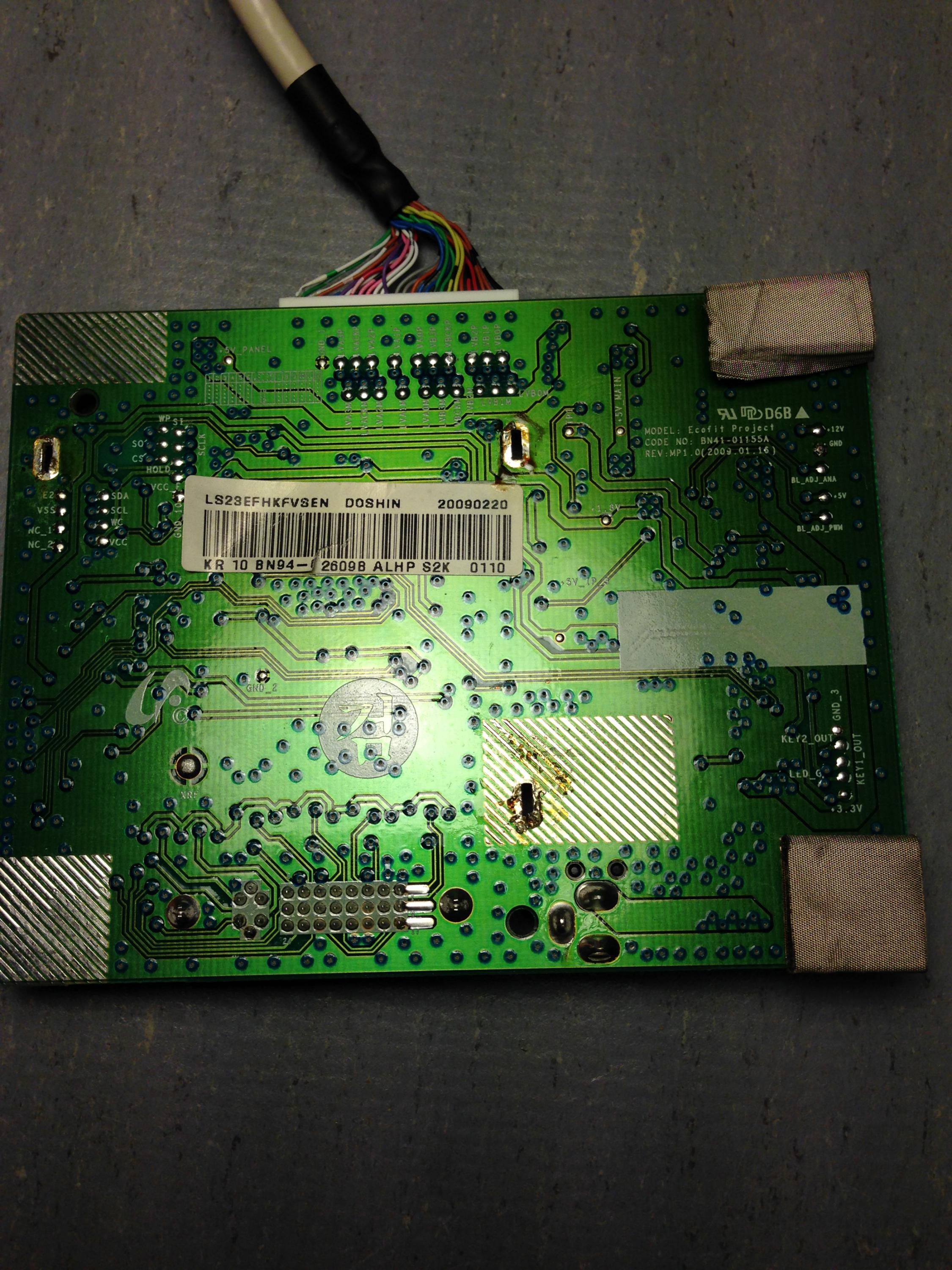

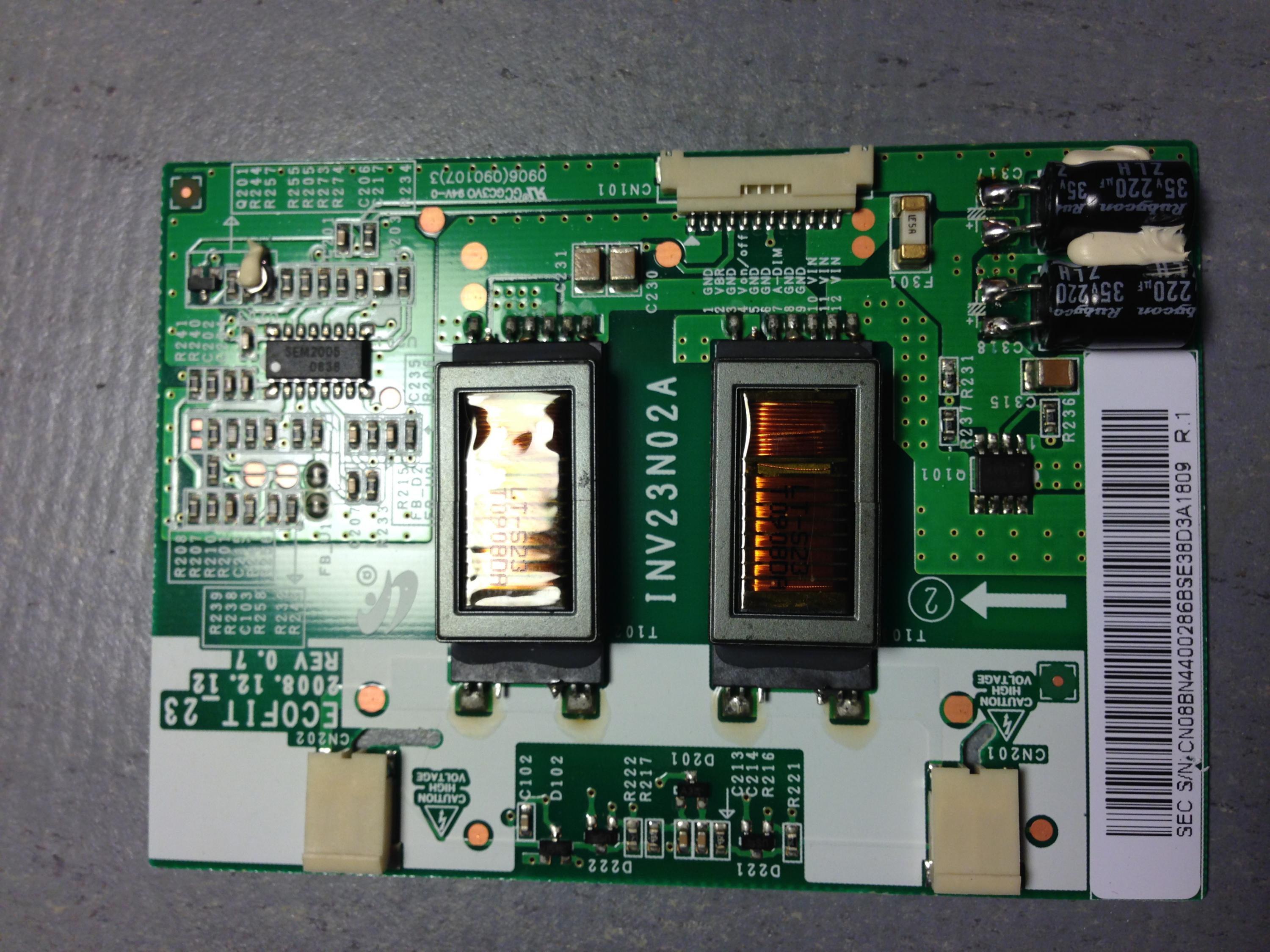

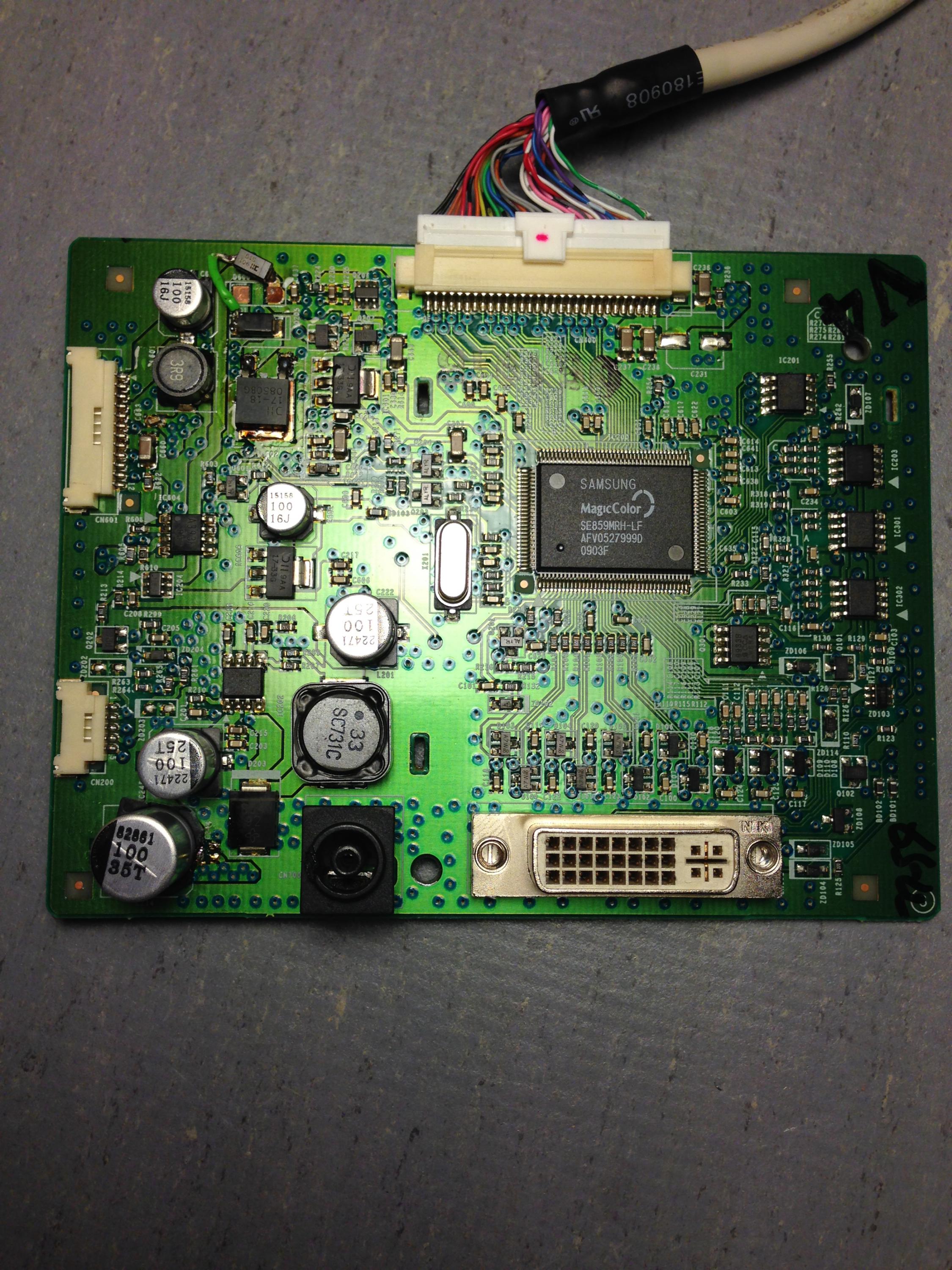

      Re: Samsung SyncMaster P2370 - white screen

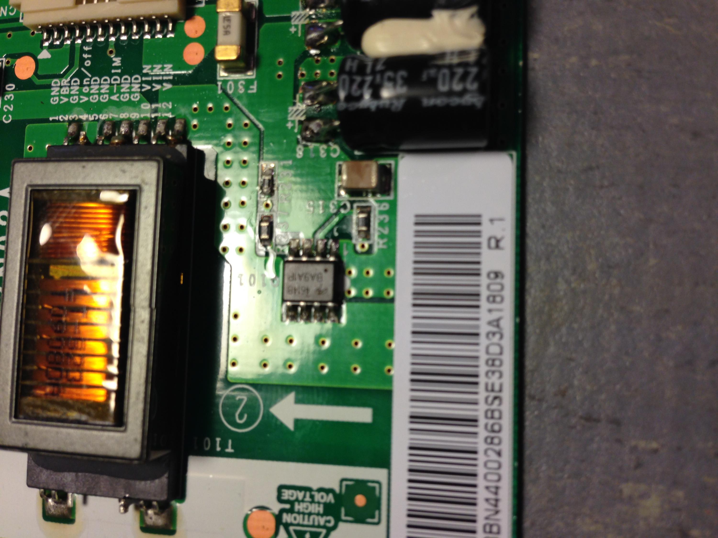

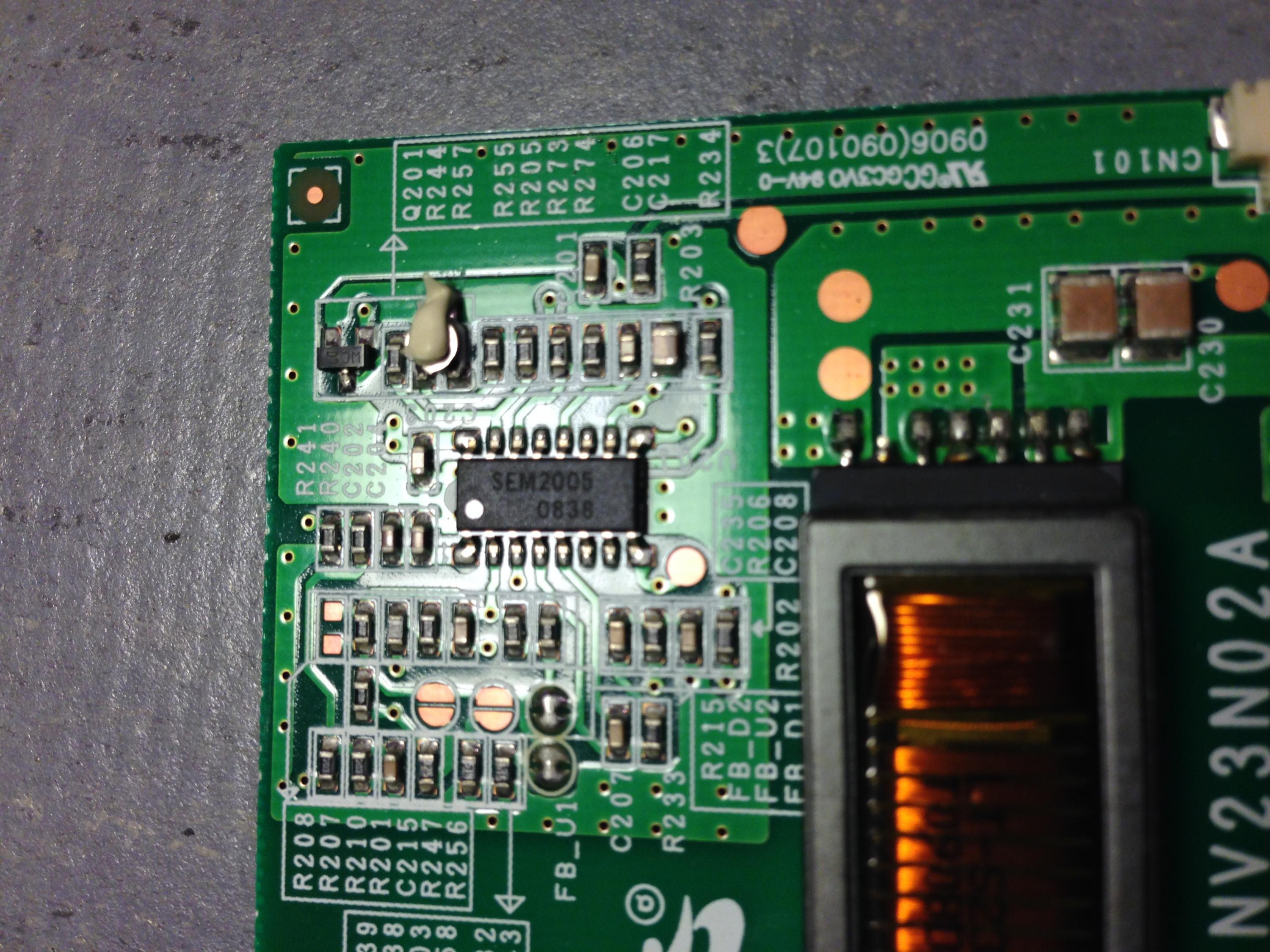

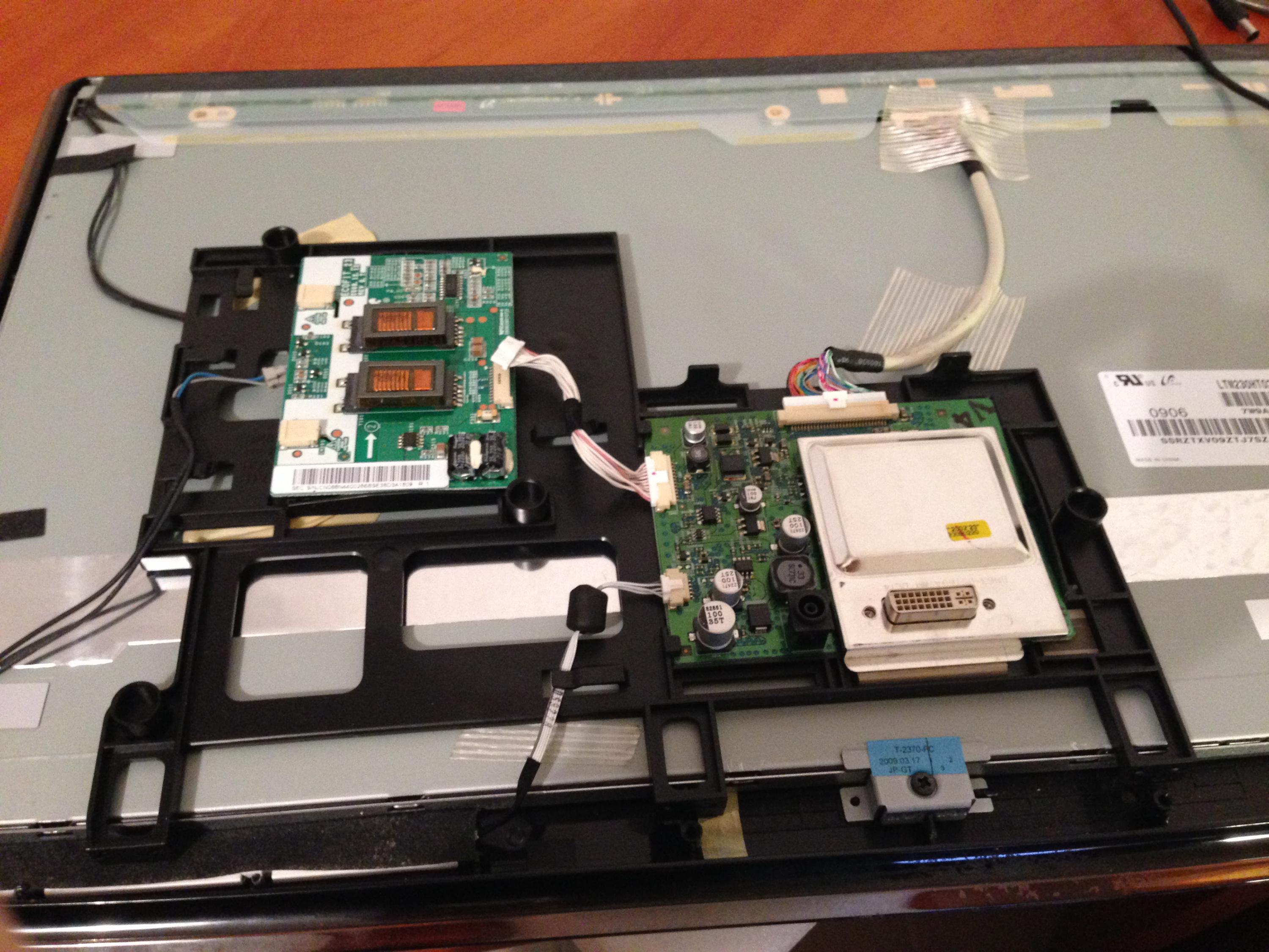

      hello again, the monitor now work for few minutes and then turn off. I take a picture of inside board. The inverter board get 14v (this monitor work on DC 14V adapter). i suspect of faulty inverter driver IC.
      Please help

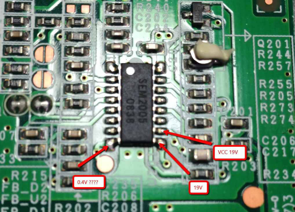

        i check with 19V supply and nothing, i found that on one of the output i have 0.4V and other output 19V is this confirmation that IC is bad?

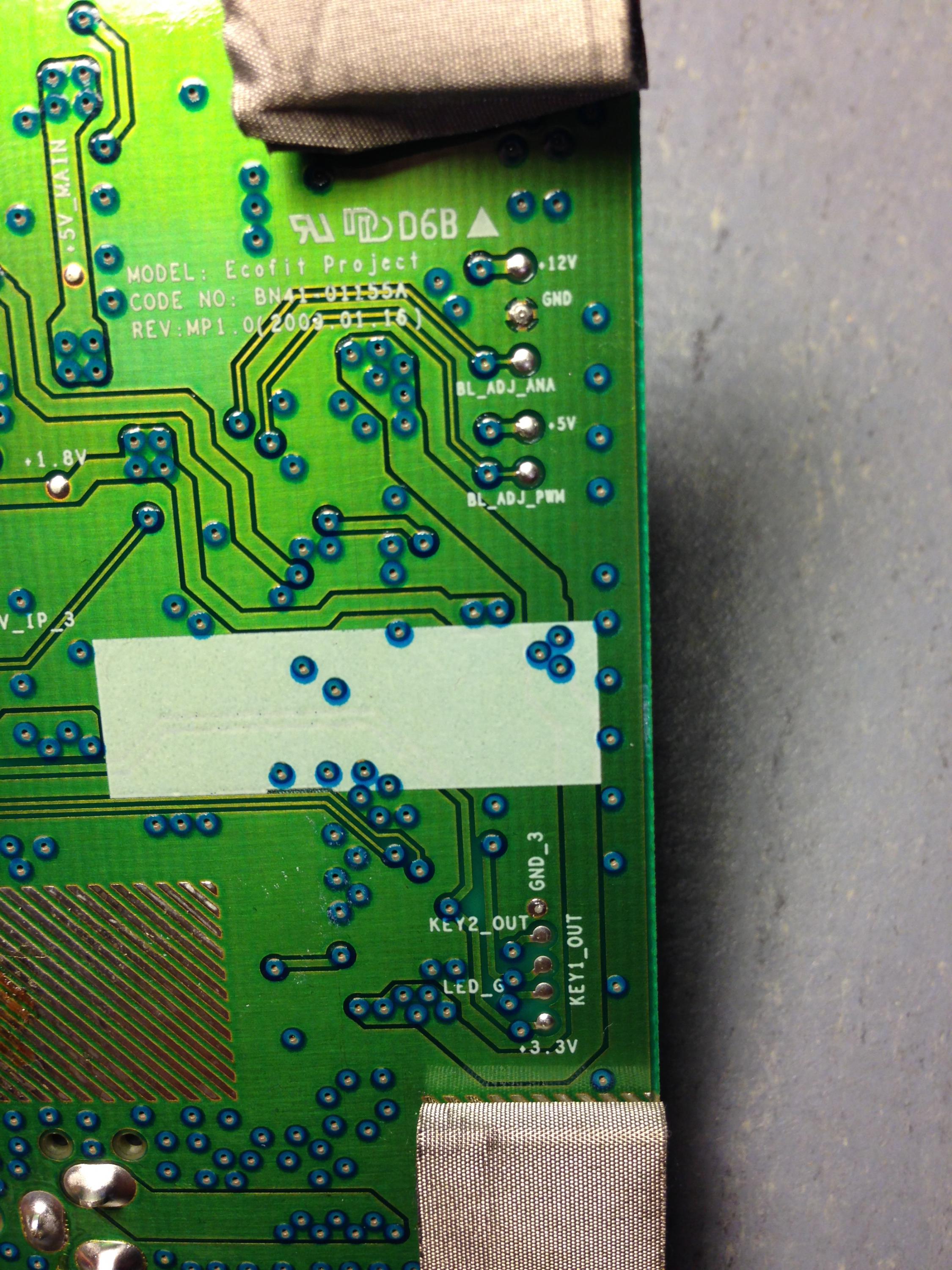

          ok so i find out that monitor working on 12V DC /3A. I test with that voltage and nothing i got power on touchscreen (the menu bar) but thats all i get, no background and no picture.
          On output (to the inverter) i have 12V and 3.3V (no 5V)
          ...the quieter you become the more you are able to hear...
              I do not have backlight, i think i see white color when i flash with flashlight on it
