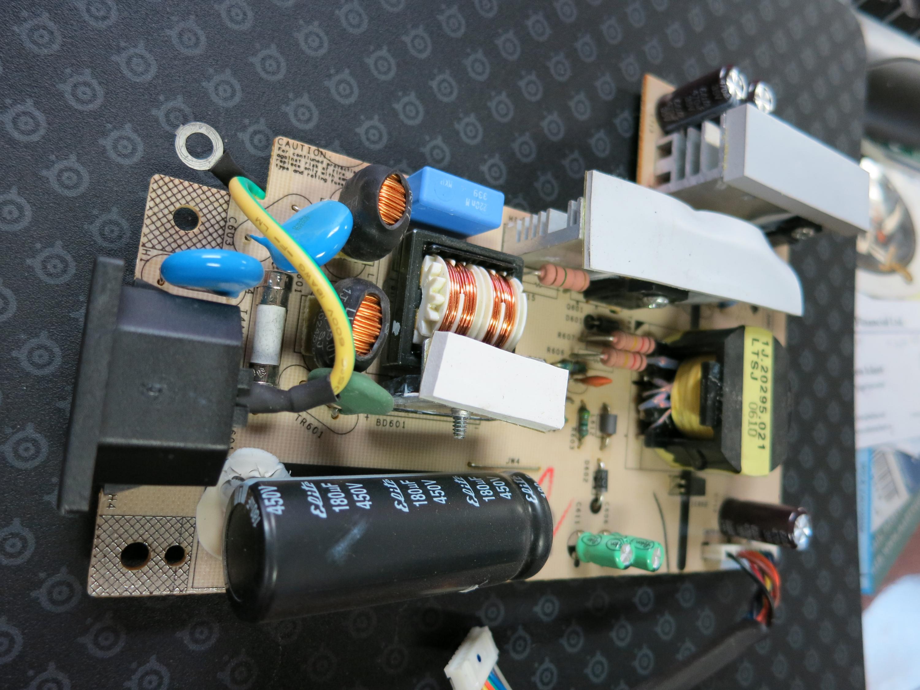

    SO i have a Dell 2007wfpb which works intermittently but less and less lately. I have considered just binning it and buying a new monitor for 100 bucks but i don't like wasting things so here i am.

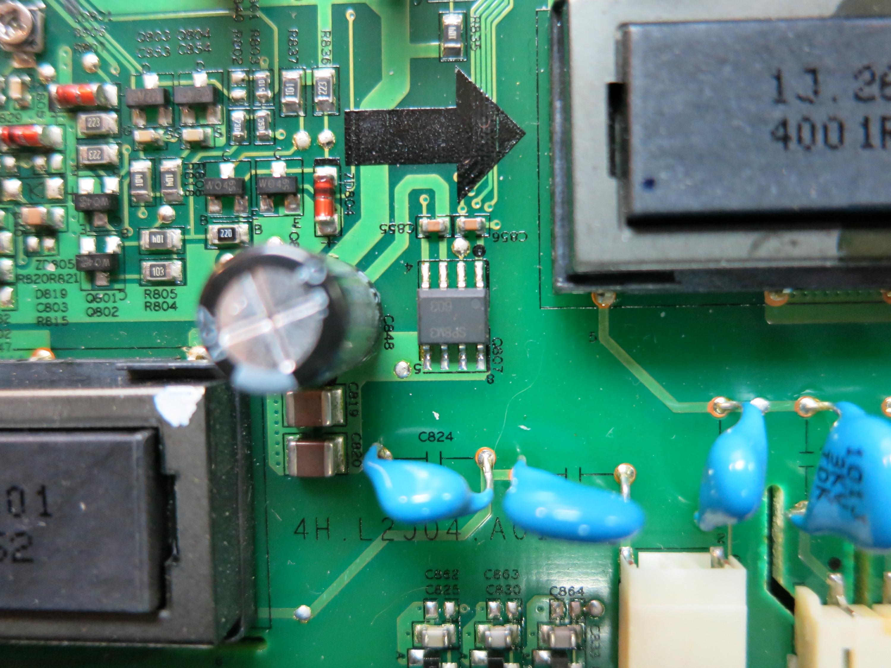

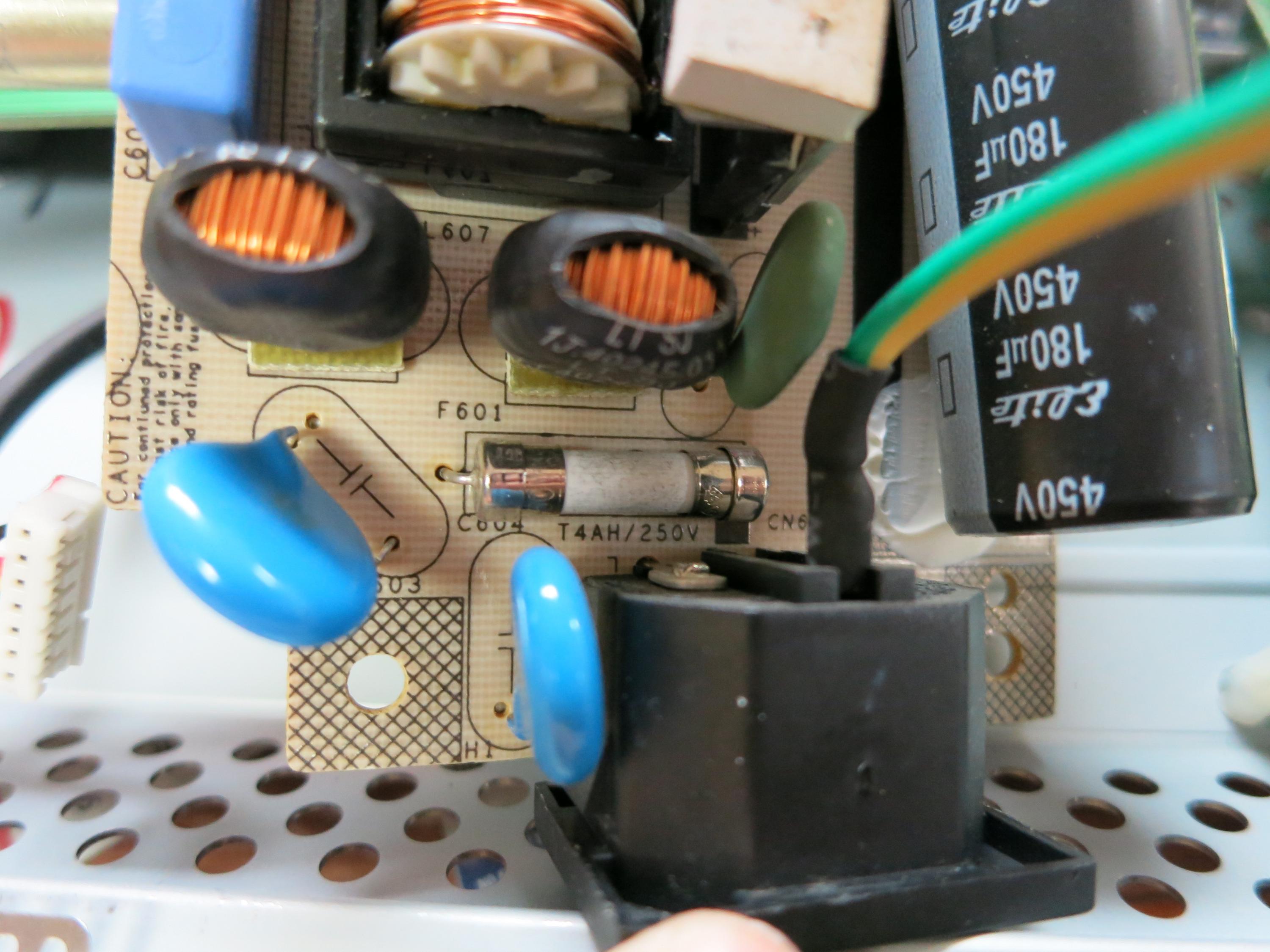

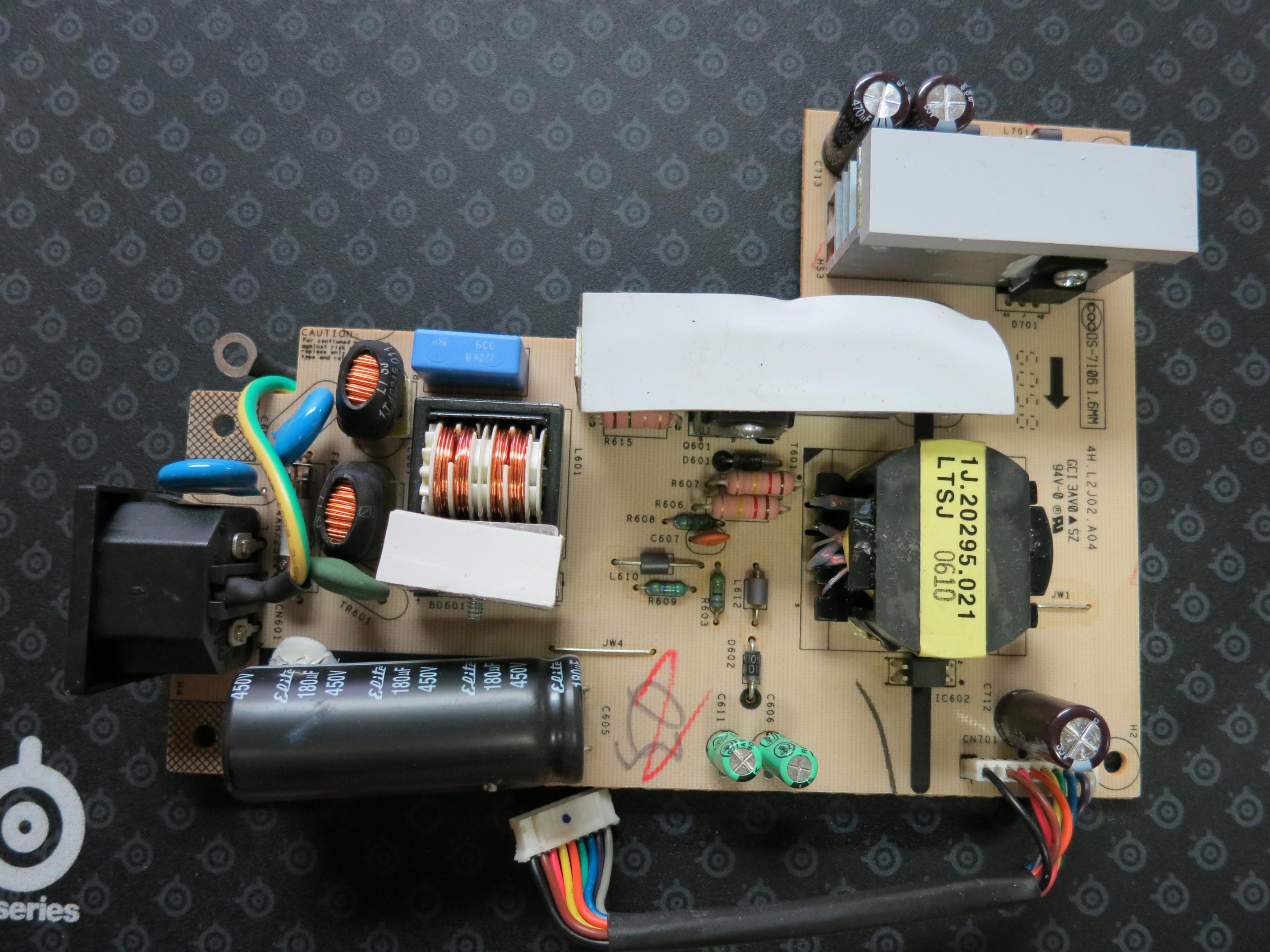

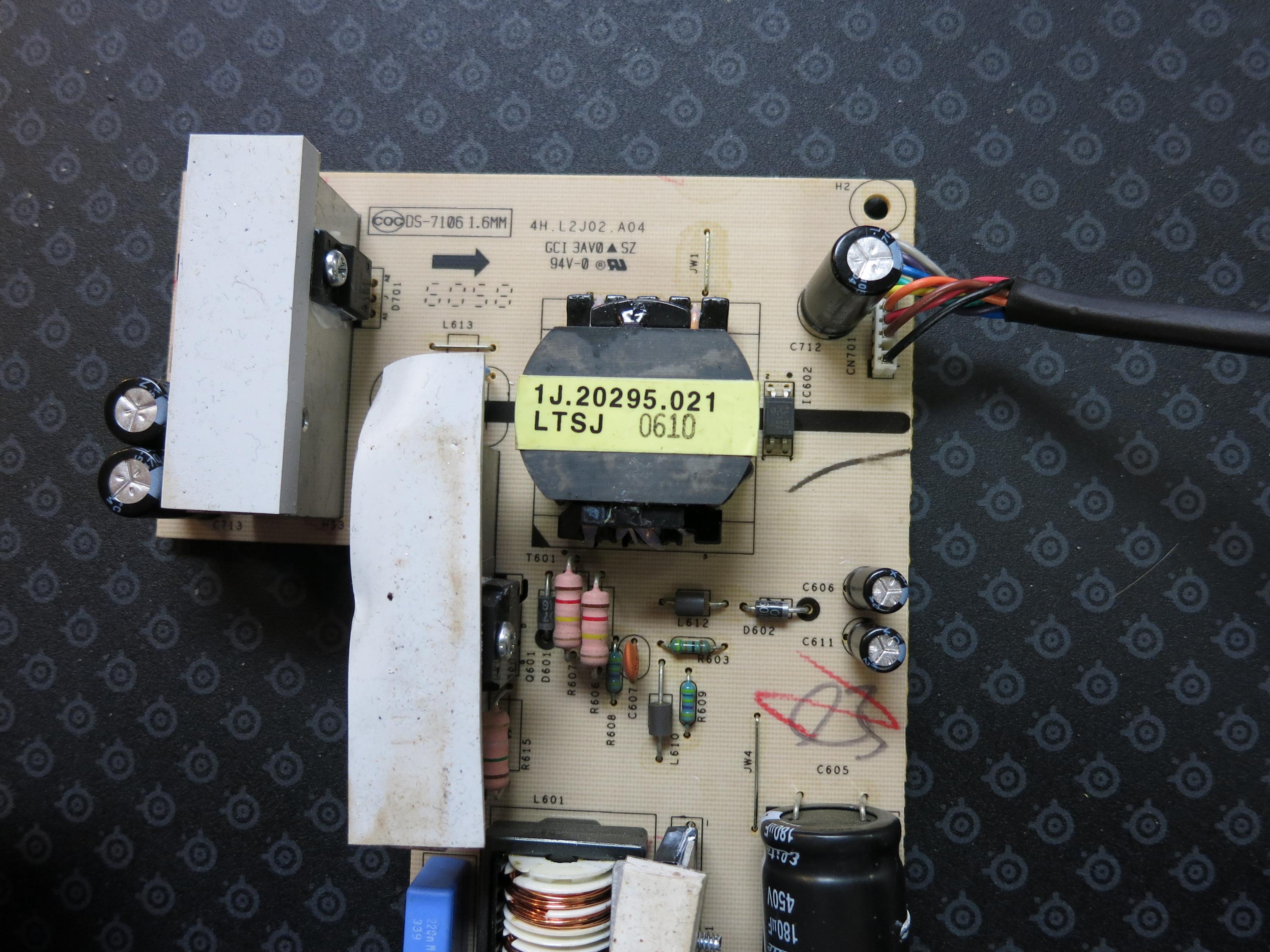

    What is happening is that when the monitor has been off for a long time, unplugged you can turn it on and get the dell logo to come up. if you leave it plugged in and then try to turn it on it goes into this loop of the green LED lights for power and source (1only) flash on then off with about 5-8 seconds in between and you here a relay clicking. it never comes out of this loop and never powers on. I have pulled it apart and looked at the different boards and there is no obvious signs of damage or bulged or leaking capacitors. I checked the fuse on the power board and somewhat checked the capacitors on that board with a multi meter and they all start to take a charge. I have attached the photos i have of the power board. Any suggestions are appreciated.

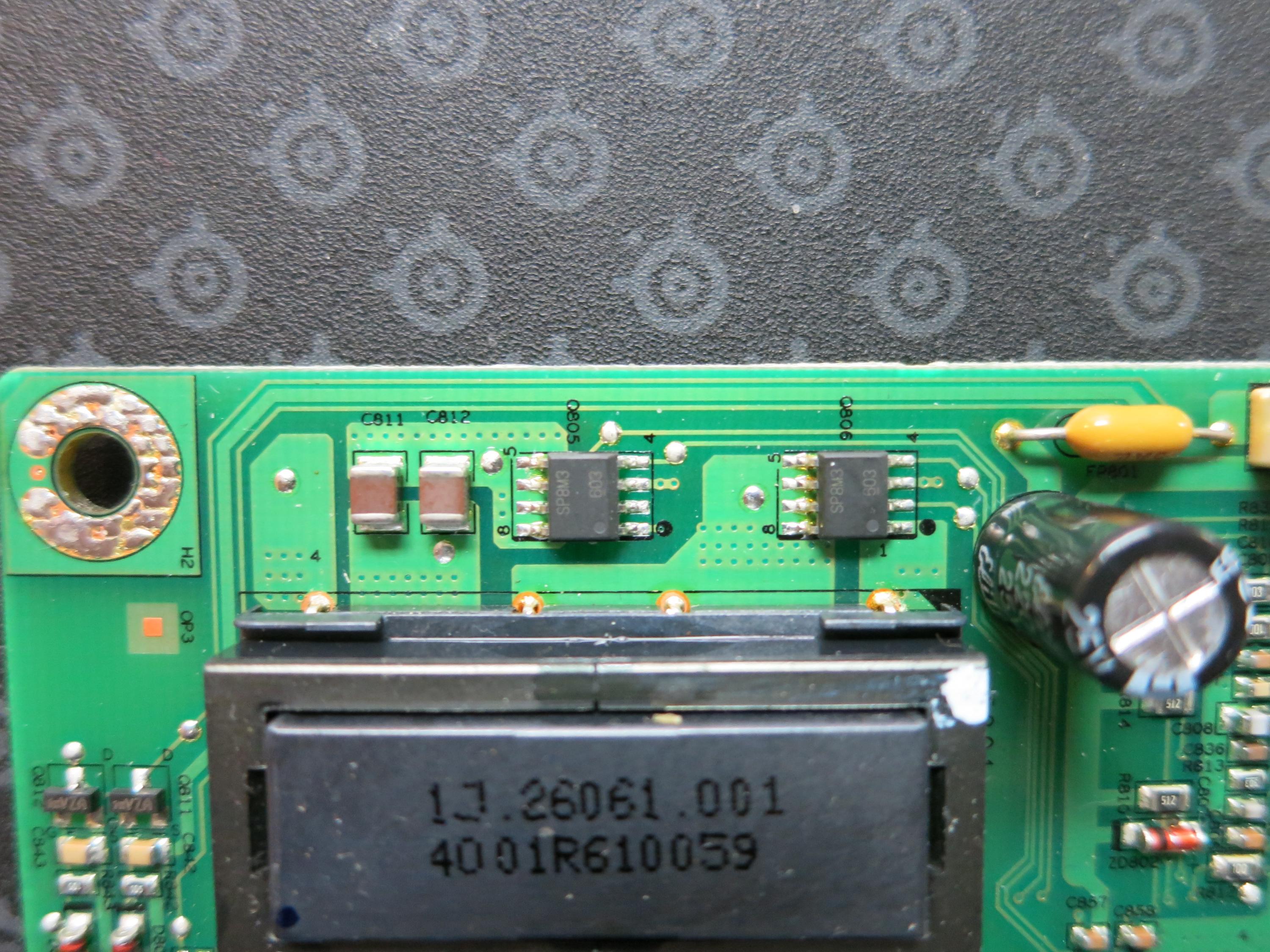

      I am not sure how to check the mosfet
        Re: Dell 2007wfpb power on problem
        Transformer readings look ok. Check mosfet using this guide, start at post #13, step 2:
        https://www.badcaps.net/forum/showthread.php?t=10419

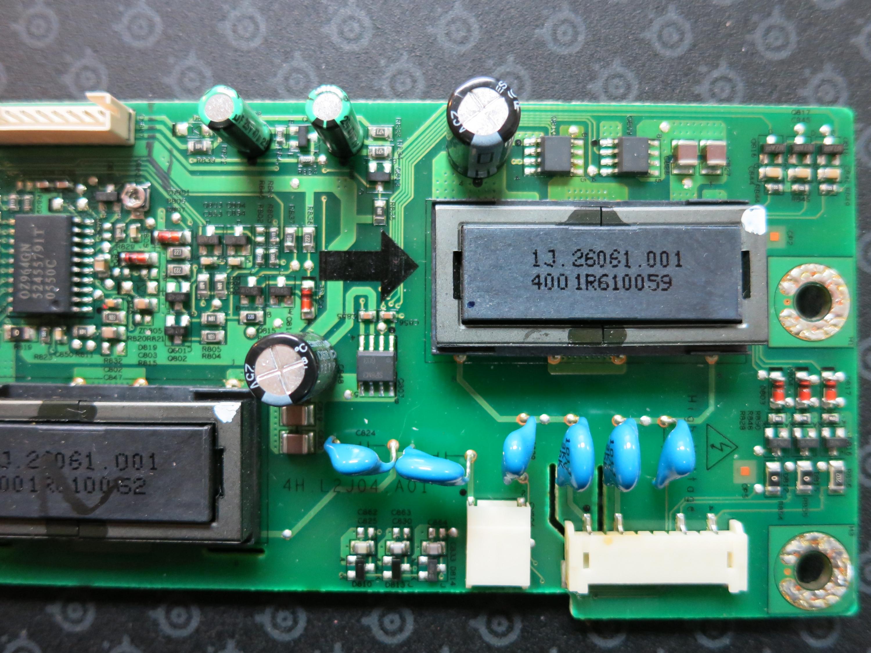

        A photo of the entire inverter board would be nice.

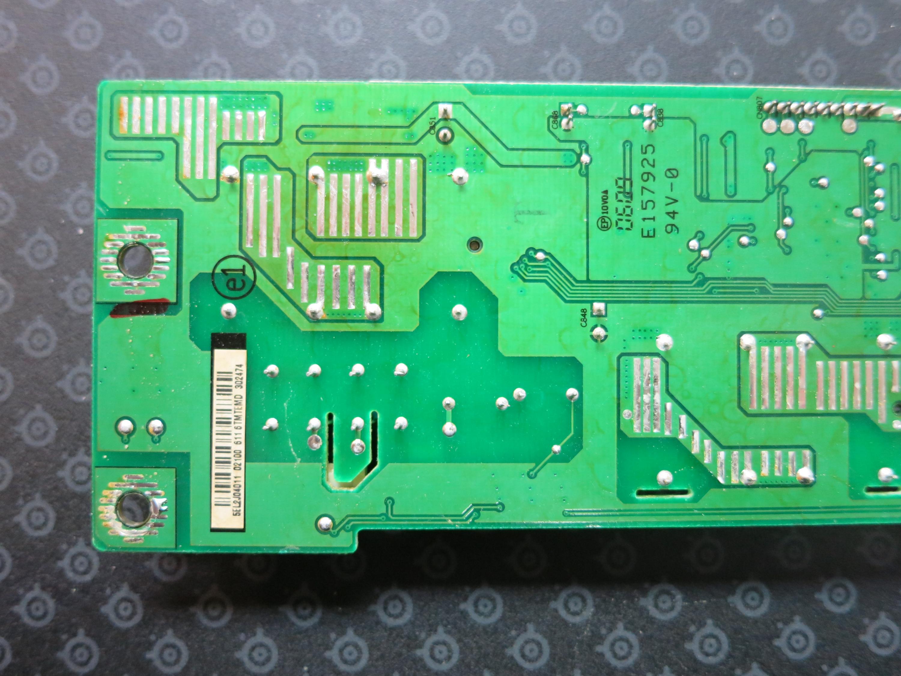

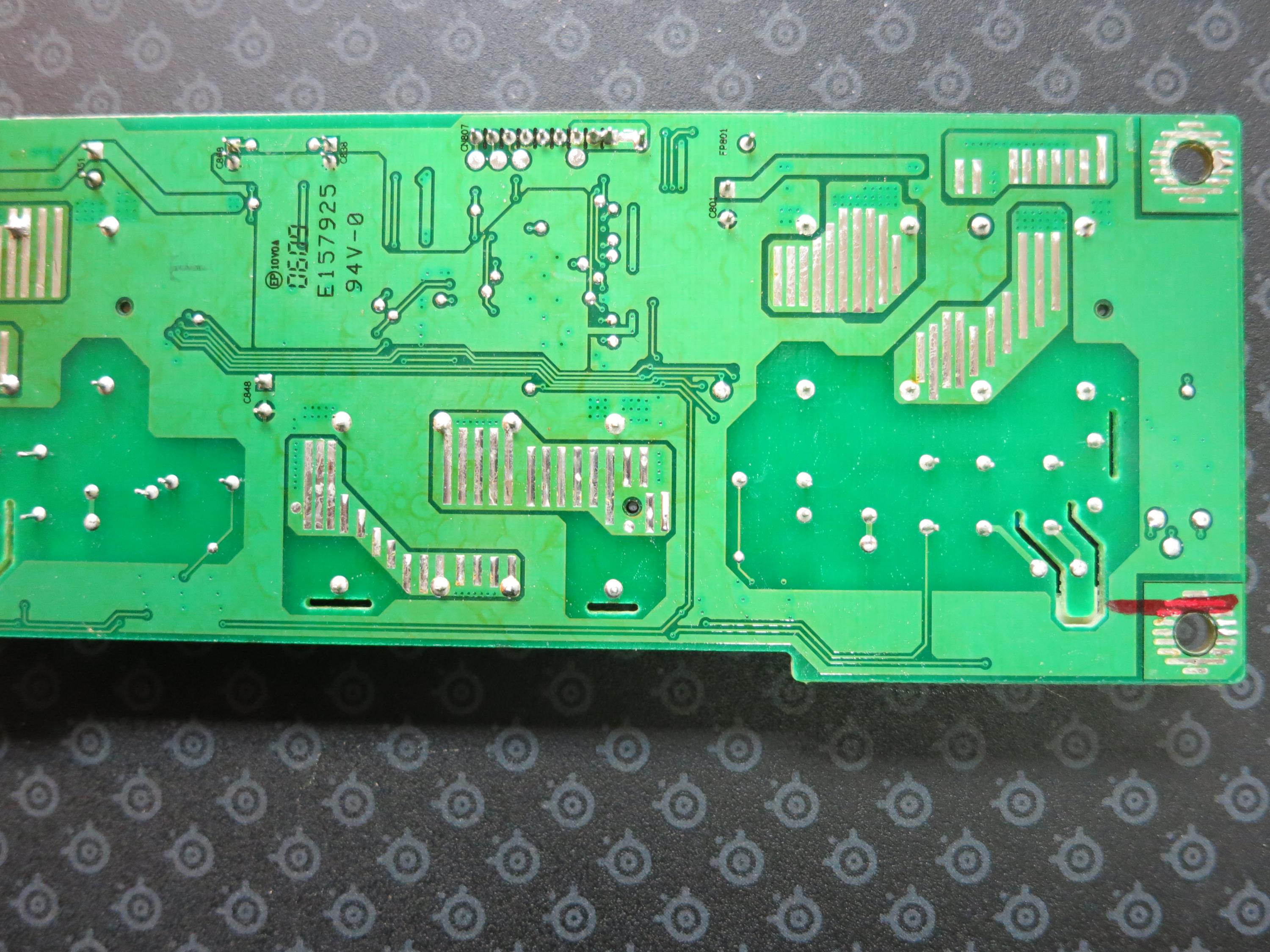

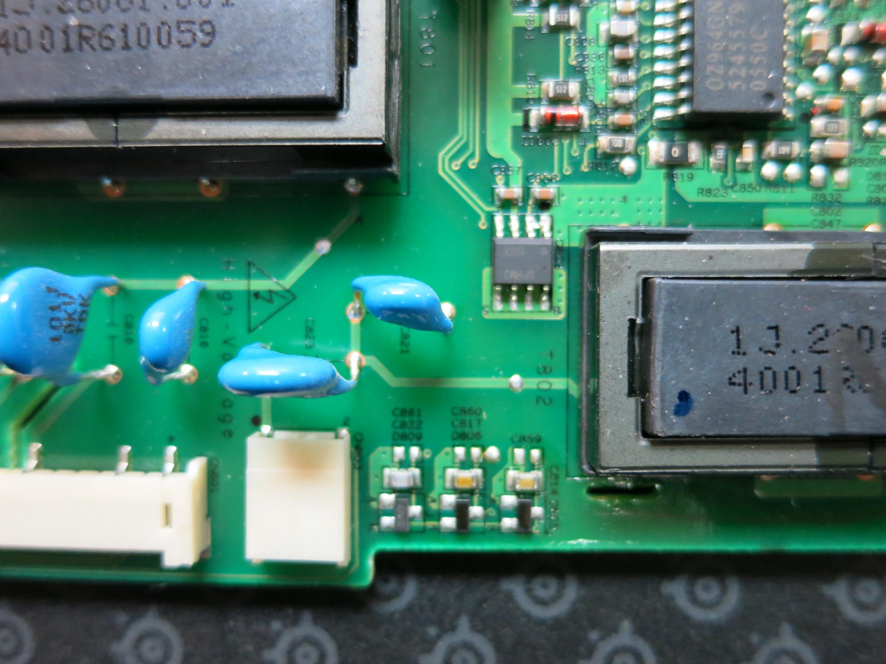

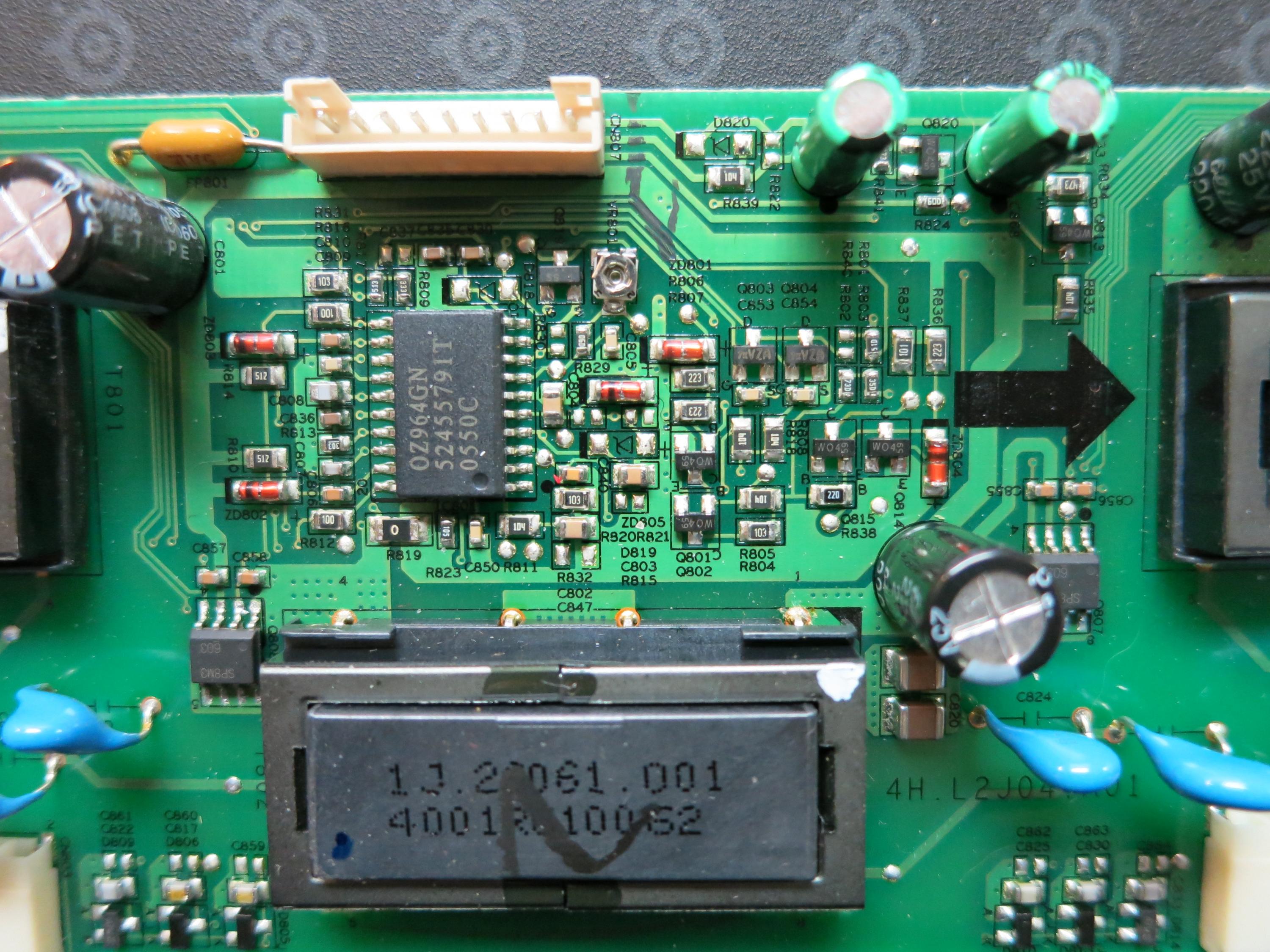

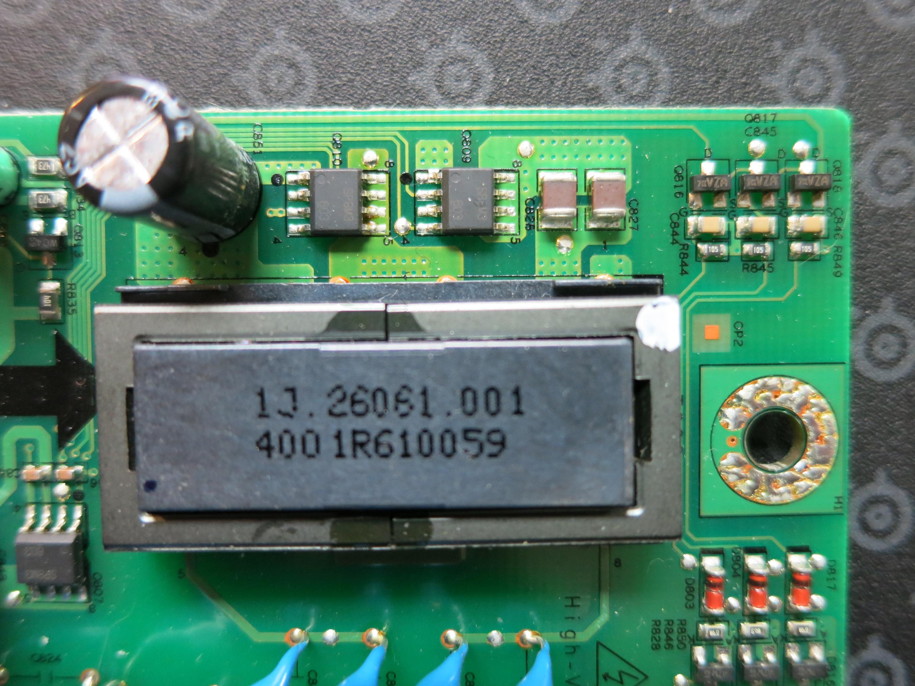

          About to try and check these mosfets, but here is some pictures.

                If it was mine, I'd replace ALL the crap caps on the power supply (except the large one)
                Those are CRAP caps, and just 'cause they're not bulging doesn't mean they aren't causing problems.
                36 Monitors, 3 TVs, 4 Laptops, 1 motherboard, 1 Printer, 1 iMac, 2 hard drive docks and one IP Phone repaired so far....
                  ok so i did that, replaced all the caps on the power board except the large one. Re assembled and its doing the same thing except this time it didn't give me any thing on the screen just the Power LED and source 2 flashes at about a 5 second interval.

                      Check that you have put the caps in the right way round - what make did you use?
                        "Are there voltages marked on the connector on the power supply?"
                        so you mean the 250Volt marked in the attached picture by the fuse?
                        "If so, lets measure them each one referenced to ground. So meter on DCV whatever range is higher than the highest marked voltage, red on the voltage we're measuring, black on gnd."
                        red on the fuse ?
                        Check that you have put the caps in the right way round - what make did you use? Caps are on correctly G-Luxon is he make

                            Didnt notice before as I was looking for a white smd, there is a yellow torpedo fuse on the inverter board pic 2 - meter on ohms - test and post the result.
                              I get 18.9 volts on orange yellow green and zero on the rest. if attached a photo but i see no voltages on the front or the back of the board.
                              The yellow torpedo fuse is good according to the meter reading 1.

                                        I did some searching on other threads about this model, and according to most of the photos, there aren't any voltages marked on the connectors.
                                        When you measured the voltages on the connector, was the other end plugged in to another board?
                                        I did read where a couple of these monitors (one was Retiredcaps) had shorted voltage regulators on the main board. Might not be a bad idea to test those.
                                        How about a good photo of the main pcb and we can help you test them.
