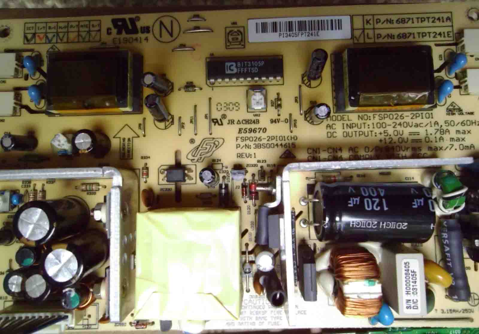

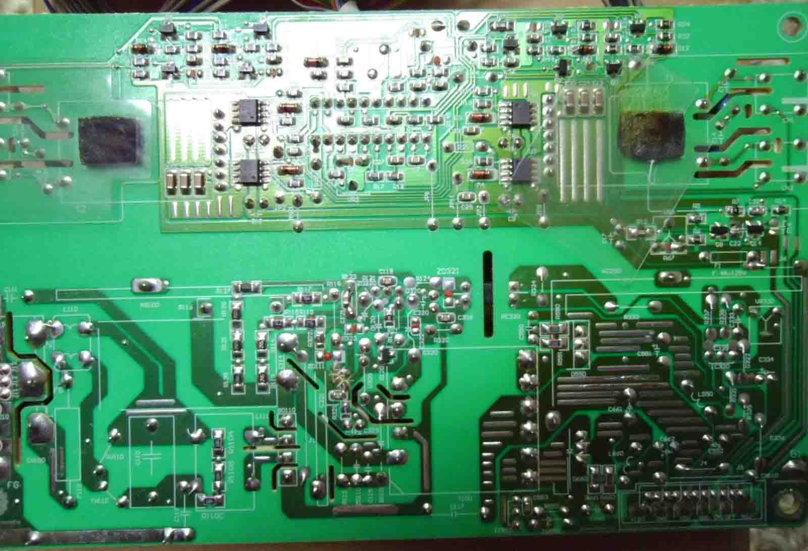

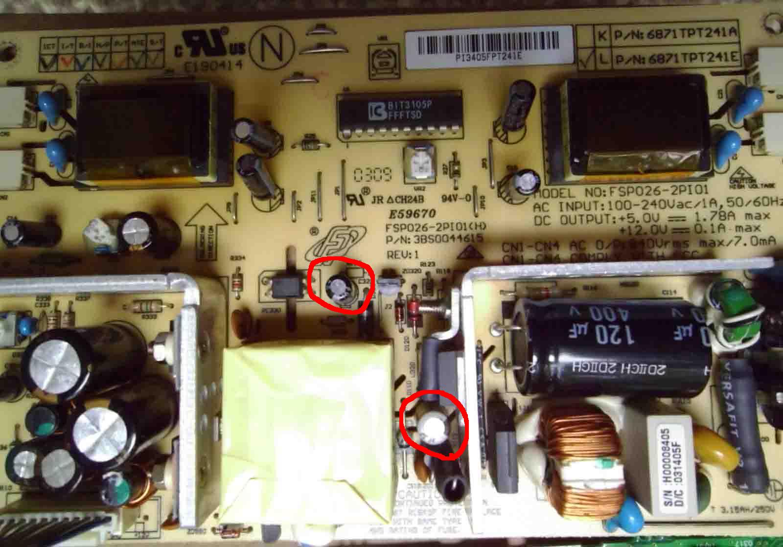

    To start off with, its power LED just blinked continuously
    This pic shows power board in its original condition

    Re: LG L1710B - bitten off more than I can chew
    I first replaced all the tiny capacitors because their values seemed a bit high on my Dick Smith ESR meter, measured in situ
    Hope dashed for a quick easy fix - power LED still blinked
    I then replaced remaining capacitors, although only the four around IC BIT3105P measured high ESR in situ
    Replacements purchased from local specialist electronics supplier's low ESR category, most of the bigger ones being Hitano
    Power LED still blinks, although less frequently than original
    Repeated cycle of staying on for about 7 seconds, then going off for about half a second
    Accompanied by faint tick which seems to be coming from the area around the LED itself
    Help appreciated
          Well, I do not know which one you are referring to: "I first replaced all the tiny capacitors because their values seemed a bit high", if you did, then next thing will be to see if the loads are shorted or not by running the board without the main board connected, this power supply-inverter board is always running when you apply the power.
          Check the DC voltage at the output of the secondary rectifier to see if it still pulsing, the shorted circuits can be in the imverter section due to shorted MOSFET's.
          The symptom you have is the same as LGl1715S:
            Thanks budm
            My expertise isn't electronics, so I'm learning (I hope) as I go, and appreciate your patience
            Please don't misinterpret my post #4, it was a genuine question not a smart arse comment
            Your photobucket album looks good - need some time to give it the attention it deserves
            I didn't try powering the FSP board on its own, because I didn't know whether it needed to be switched on or not, like an ATX motherboard
            And because the power switch is on the little controls board that connects to what I think of as the video board - is that what you call the main board ?

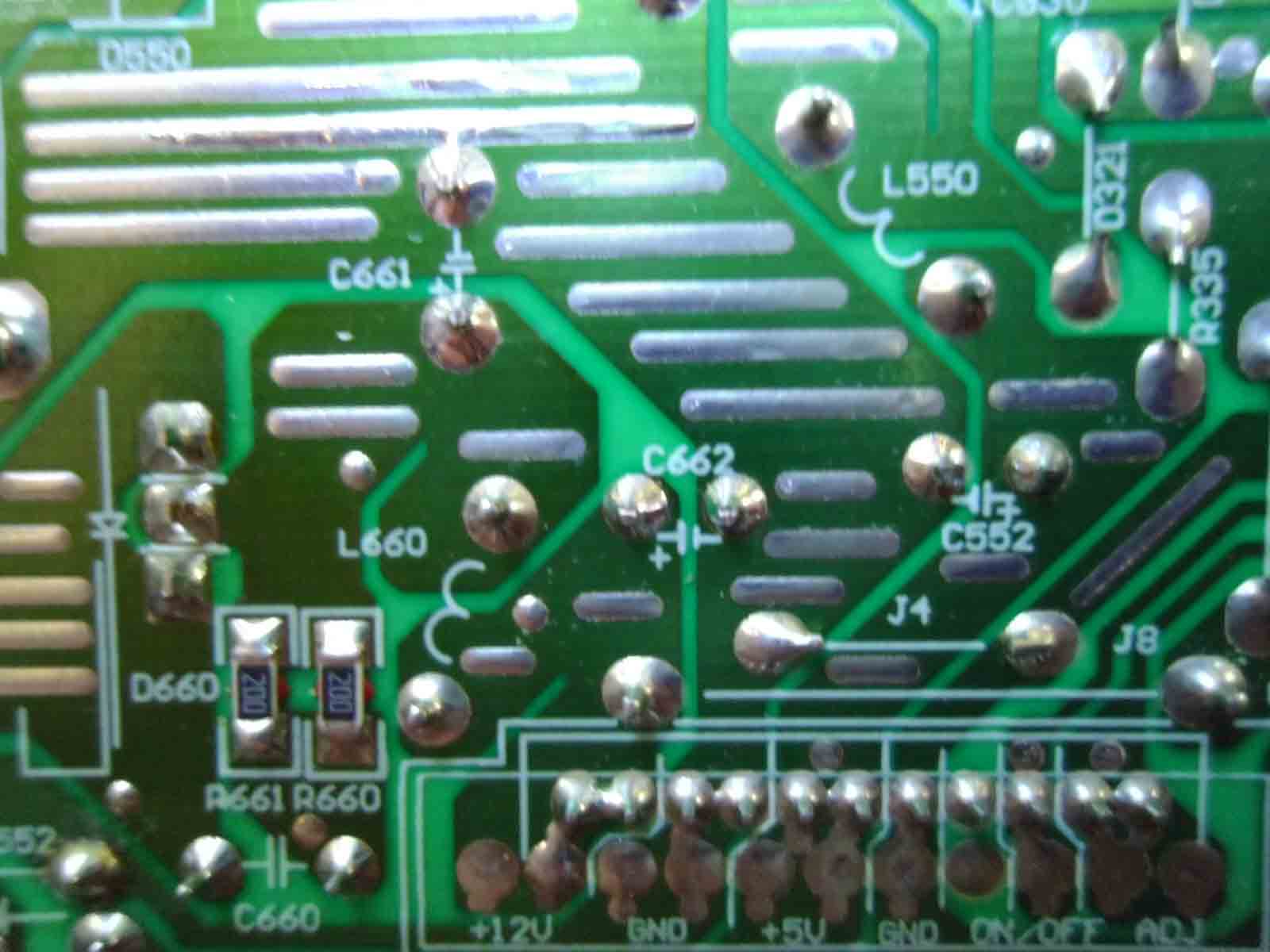

                    I measured on the pads beneath the connector which are labelled as shown in this pic
                    better to keep quiet and be thought a fool, than to open your mouth and remove all doubt
                    • pfrcom
                      Oldbie
                      • Jun 2006
                      • 1230

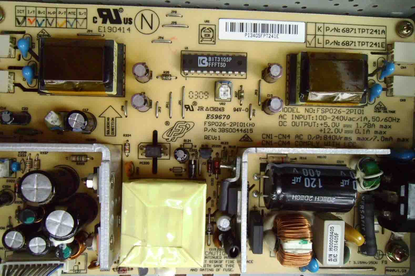

                      First though, I did a bit of rework because it looked like I had a solder bridge from negative of C661 to the track above it
                      This pic shows what it's like now, when I did the measurements, which are:
                      With board only, plugged to mains 240v
                      5v = steady 4.97
                      12v = steady 11.76
                      On/Off = steady .000
                      Then main board connected, complete assembly still plugged to mains 240v, but power button off and LED off:
                      5v = steady 4.92
                      12v = steady 12.40
                      On/Off = steady .059
                      After pressing assembly's power button, LED lights up then ticks off after about 7 seconds, for about half a second, repeats that cycle
                      5v = steady 4.86 until tick off, re-initializes briefly at 4.94, settles at 4.86
                      On/Off = steady .065 - best I can tell, maintains that through tick off
                      12v settles at 13.37 - after tick off re-initializes briefly at 12.14, then 13.3something, climbs by .01 until reaches 13.39, drops back to 13.37, where it stays until tick off
                        That ON/OFF voltage reading does not look right, I expect to see >3VDC for the inverter to turn on. By the way, when you are testing these voltages, do you have all the backlights lamps connected?
                        Please take the resistance readings of the MOSFETS.
                          No, logistically too challenging
                          Meter shows 00.2 ohm if probes are shorted together
                          Assuming the dot denotes #1, and others going away from it on the same side are #2, #3 & #4
                          xx or x in lieu of numeric digits denotes a changing value - values given are where they settled
                          Mosfets are marked 4600 AD3E19
                          U2
                          #1 1.3xx Mohm
                          #2 3.50 Mohm
                          #3 1.2xx Mohm
                          #4 1.3xx Mohm
                          U3
                          #1 1.4xx Mohm
                          #2 3.65 Mohm
                          #3 1.4xx Mohm
                          #4 1.49x Mohm
                          U4
                          #1 1.46x Mohm
                          #2 3.65 Mohm
                          #3 1.3xx Mohm
                          #4 1.4xx Mohm
                          U5
                          #1 259x Ohm
                          #2 2.89 Mohm
                          #3 00.2 Ohm
                          #4 35.x Ohm
                            Originally posted by pfrcom
                            U5
                            #1 259x Ohm
                            #2 2.89 Mohm
                            #3 00.2 Ohm
                            #4 35.x Ohm
                            http://pdf1.alldatasheet.com/datashe...MD/AO4600.html
                            U5 is shorted.
                            http://www.ebay.com/sch/i.html?_saca...Ao4600&_sop=15
                            $1.02 USD + free shipping for two.
                            PS. In my 2 seconds guide, I wrote a procedure on how to test a mosfet for a short. I suggest you take a look and retest the other mosfets to get all possible combinations with reference to the linked datasheet for AO4600.
                            --- begin sig file ---
                            --- end sig file ---
                              I would change them in pair, might as well order at least 4.
                              When you finished installing the new IC, do not turn on the board without having the lamps connected, it will put out big high voltage (1500~2000V) arc at the lamp connectors when it try to start up.

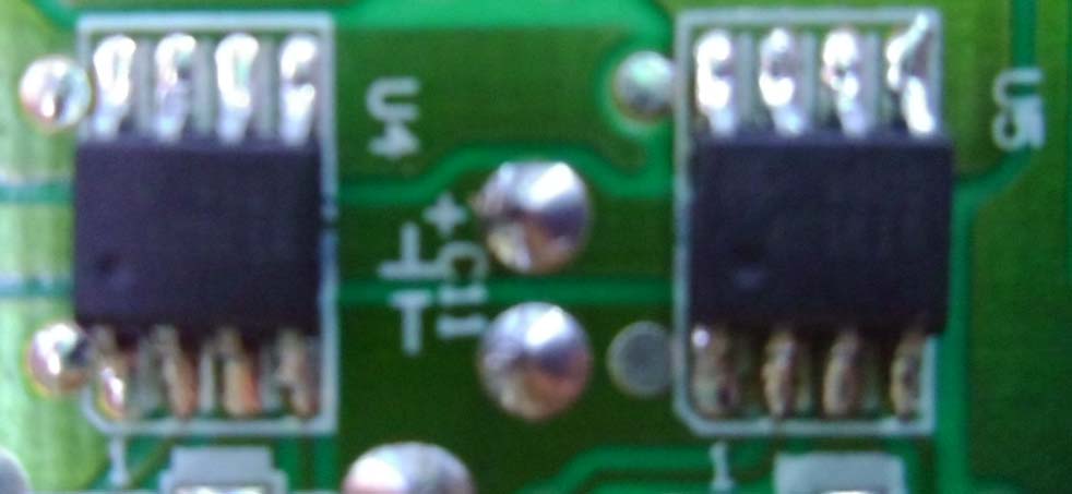

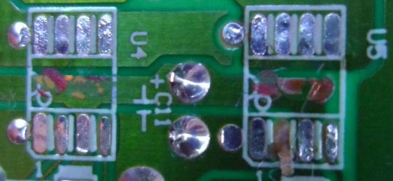

                                  AO4600s arrived yesterday - very good service, especially considering their price, and the season
                                  Here's U4 & U5 after originals removed
                                  For the lifted pad I put a dab of Super Glue underneath, then very carefully flattened it back into place and left it to cure overnight
                                  • pfrcom
                                    Oldbie
                                    • Jun 2006
                                    • 1230
                                    Here's U4 & U5 with the replacements
                                    Sorry budm, mindful of your suggestion, but I couldn't face the prospect of replacing U2 & U3 whose measurements indicated they were probably functional - what with lifting U5's pad, and if it ain't broke ...
                                    Reassemble it so I can plug in the backlights lamps, then the acid test, power it on ...
                                    ... steady green LED, not going Off & On, hmmm promising ...
                                    ... connect it to a computer, and hallelujah there's an image
                                    Thanks again for your help budm, retiredcaps and selldoor - without it, definitely would not have been a successful outcome
                                      Some more questions please

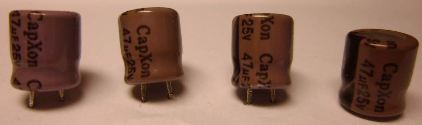

                                      This is the set of Capxons I replaced early on, each of which coincides with an AO4600
                                      Is it fair to blame the Capxons for the demise of the AO4600 ?
                                      With the wisdom of hindsight, I probably should have waited for better caps instead of using brandX (can't recall actual brand) from local specialist electronics supplier's low ESR category
                                      Finally this question
                                      I have some Rubycon YXF 47uf 63v in transit
                                      Could I use those in lieu of the brandX 47uf 25v with which I replaced the original Capxon ?
                                        Now that everyting is working, it is a good time to ohm out U5 and see where the lifted pin has continuity to. That way, if the superglue fix doesn't work over time, you can then run a jumper wire from the U5 pin directly to the ohmed out component.
