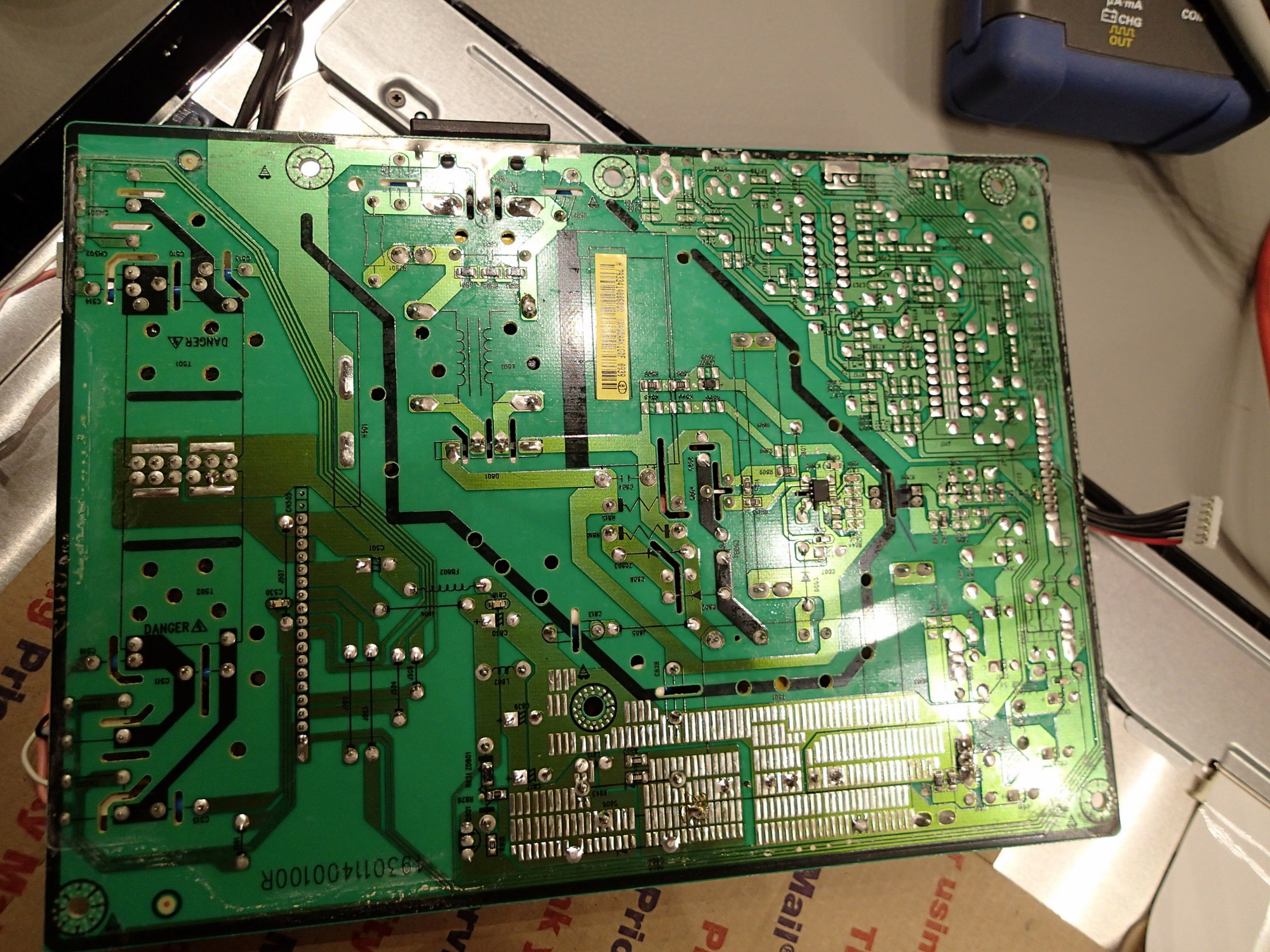

    Hello all, I am new to this forum though not to electronics.

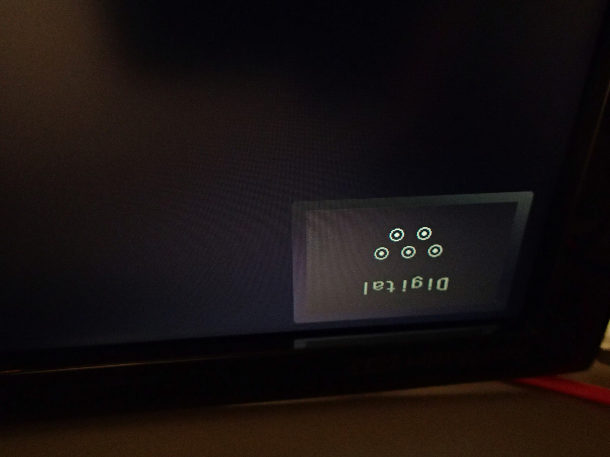

    Samsung Syncmaster 2333 made in September 2009. If it sits by itself, with no input signal, I get alternating Digital and Analog input decals on the screen. As soon as I connect a known good signal, I see a white line for a second and screen goes gray. Backlight is alive, power on LED is on.

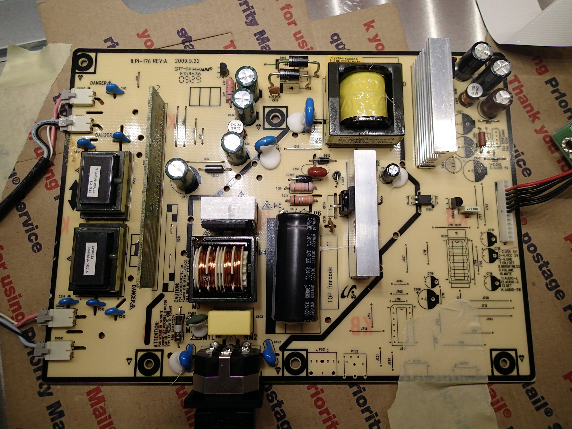

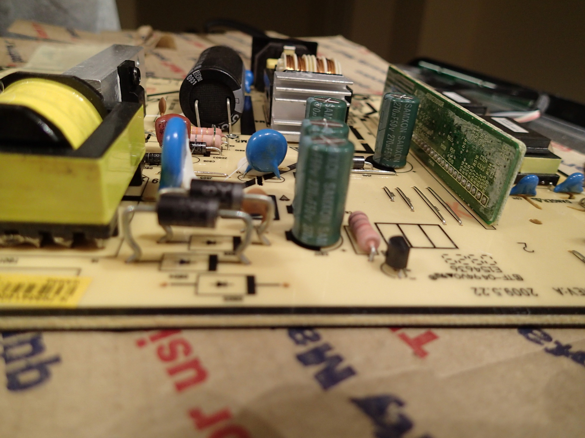

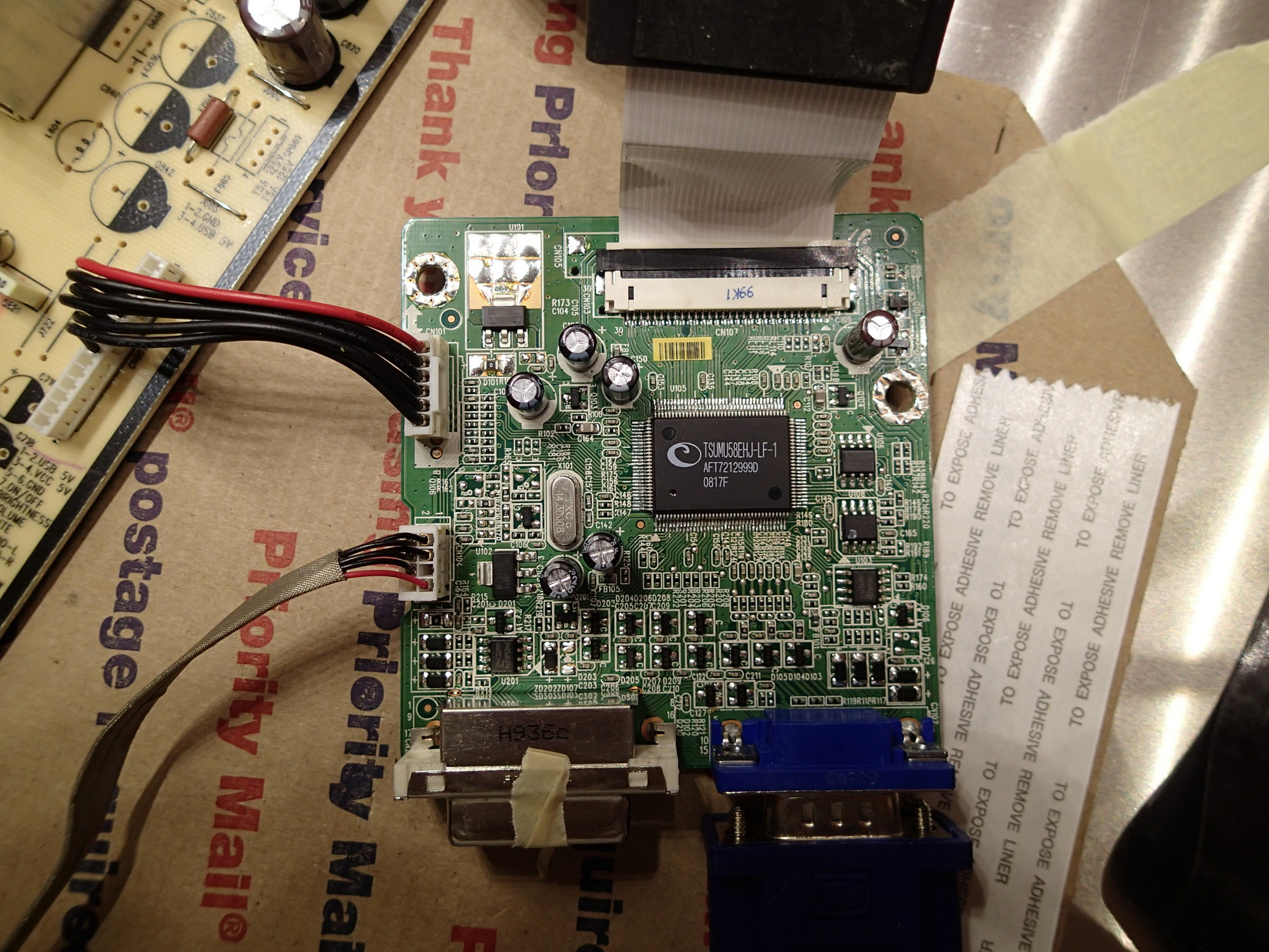

    Caps on the power supply are SAMXON in the inverter section and Lelon or the like in the Secondary side. No signs of bulging or venting. All power rails look happy and clean with a meter and scope. I see no ripple, pulsing or the likes. The digital board gets clean 5V and makes normal looking 3.3 and 1.8V. I see clock (14.3Mhz) on the main controller. I see data and clock wiggling on the SPI flash and EEPROM next to the controller, so I assume its booting alright. I also see VGA and SYNC signals on its pins. I just don't get any output. It appears capable of at least drawing the searching for input decal on the screen, so the LVDS section seems fine. If I disconnect inputs and hold menu button I get Test Passed message. Other menu buttons do not seem to do much. Power button works fine. I did test both DVI and VGA inputs with the same result

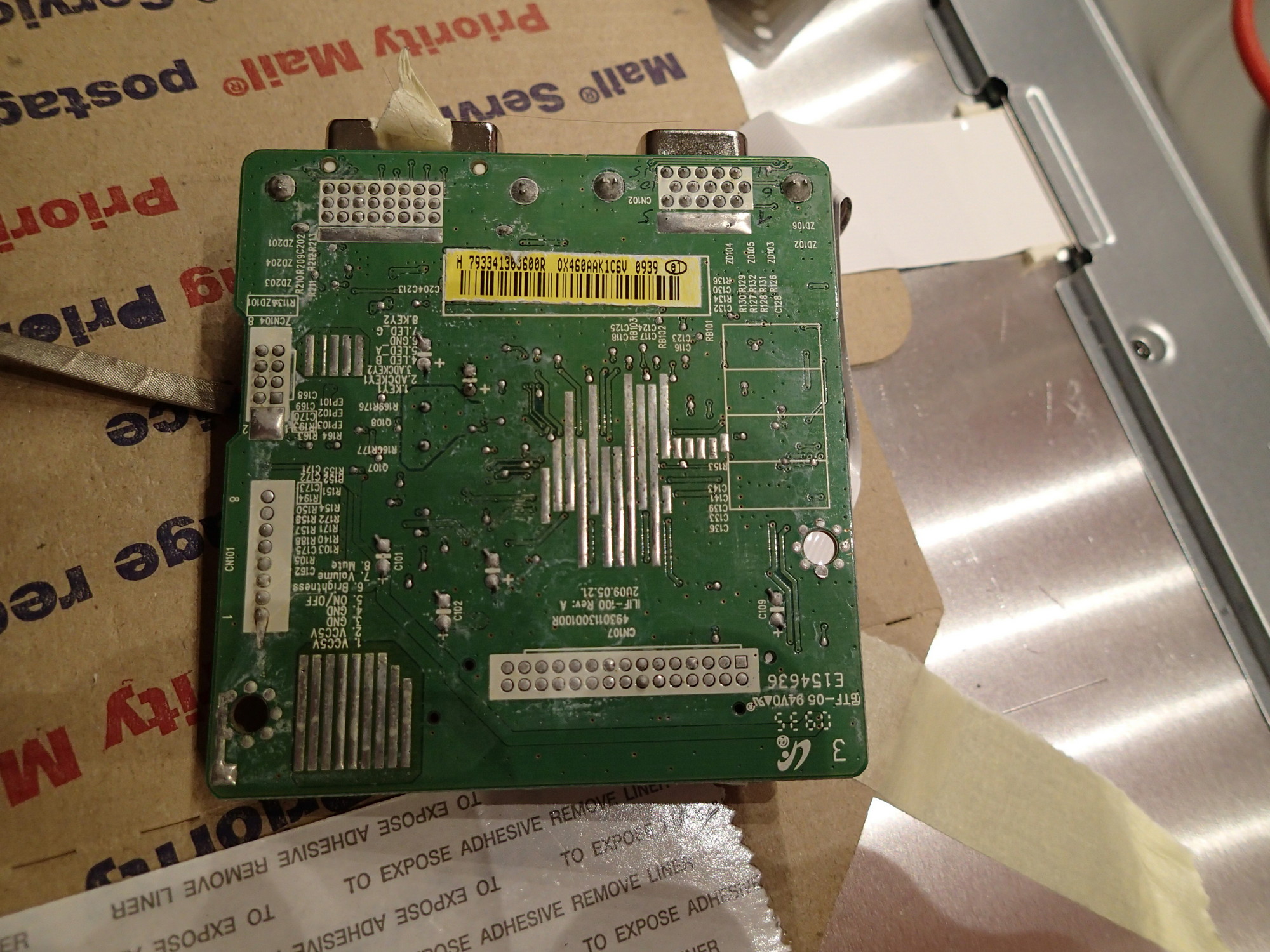

    The chip does run a bit warm- I'd say 50C. Not finding anything else wrong with the system, I've swapped the controller. The soldering job is less than stellar- chips pins were a bit bent when I got it, but I am pretty sure everything is connected and there are no shorts. Or at least that's what a look under a microscope indicated. End result is the same, so that was obviously not an issue. Any pointers?

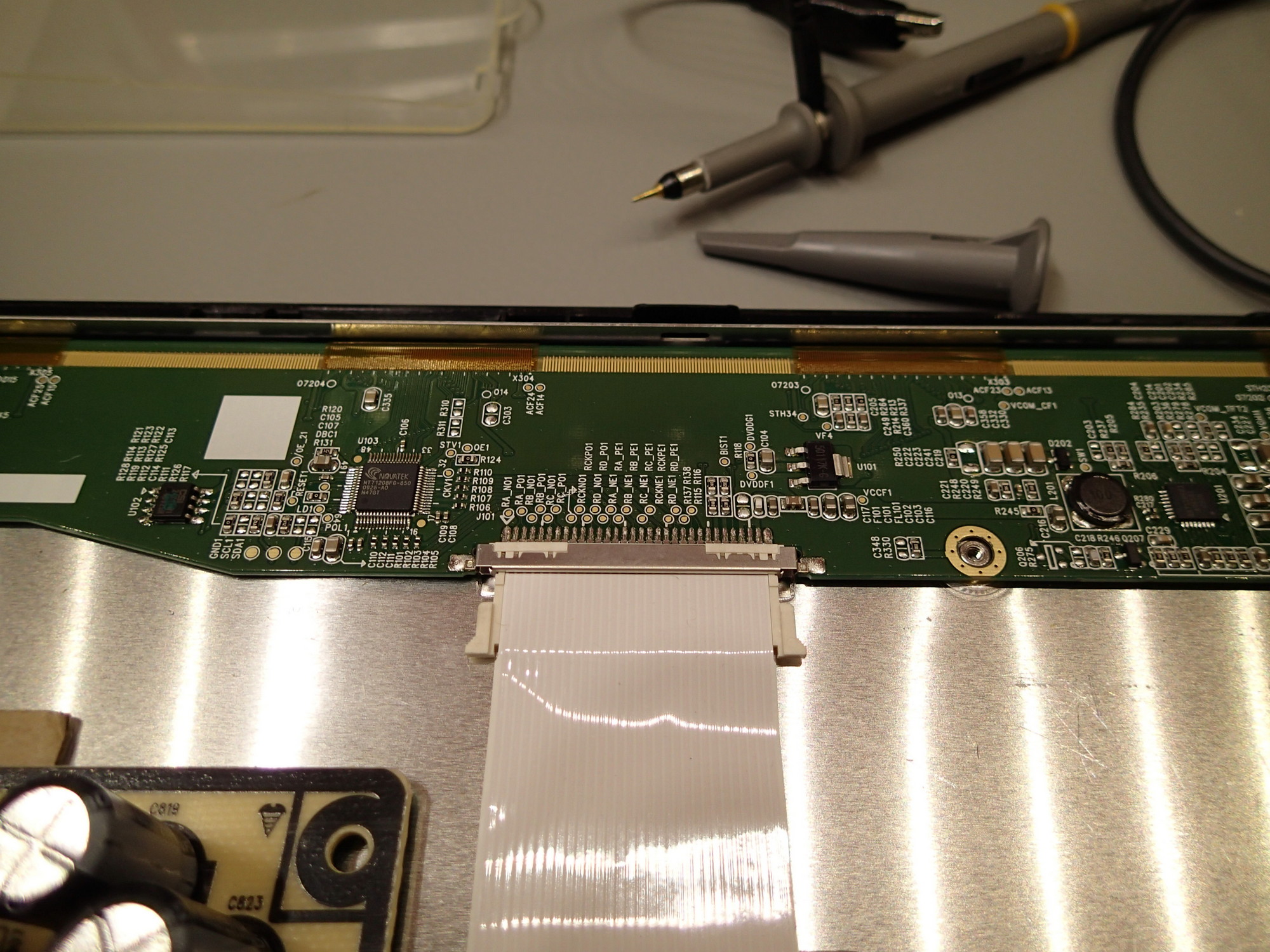

    Can we get a shot of the panel board (follow CN105 cable from the main board)? It is the board that sits right at the top of the lcd and may be underneath a metal shield.

      The panel board? Here you go. I did not bother with whole board, just the main section. The rest is just driver flex connections

        1) I circled a number of test points.
        2) Can you post the voltages for those and check to see if U101 is regulating properly?
        3) What is part number U201 on the panel board?

          VCCF1 is 4.78V
          The other points you've circled are GND and I2C CLK and DATA
          GND is around 0v. CLK and DATA are idle at 3.3v and I did not catch any traffic. U101 is fine 4.78V In 3.3V out.
          The switcher to the right (U201). is generating +27, +5.6 and 9V and+12V as far as I can tell. There is a lot of audible noise from it with the cover removed. U201 is AAT1168B1
          U102 Novatek NT71208 runs a bit warm.
