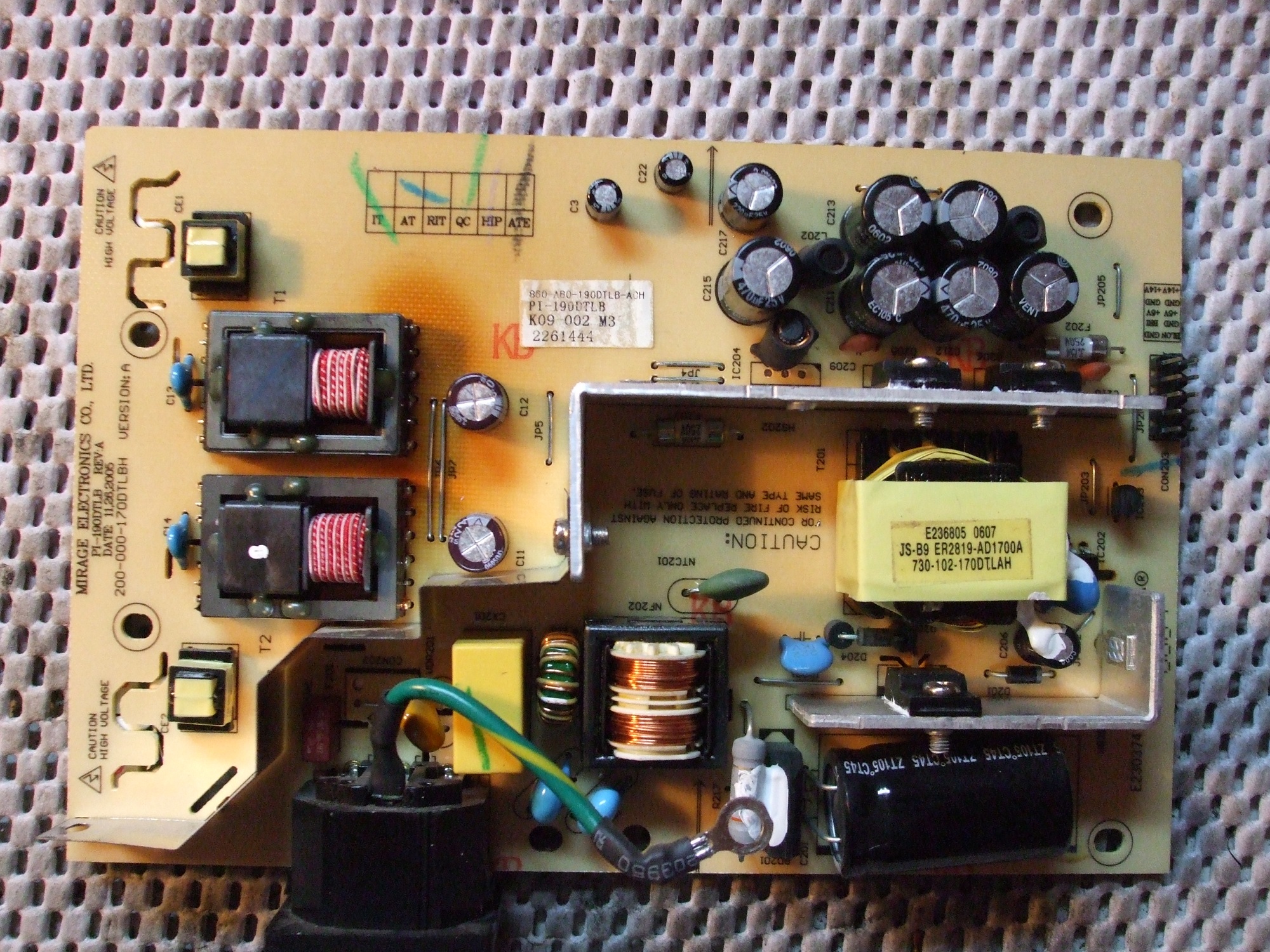

    Hi guys,
    I have a Proview LCD here that isn't cooperating. No signs of life at all, not even a flash from the power indicator light. What I have tried thus far:
    1. First thing I did was check the three fuses that I found on the inverter board, all check out fine.
    2. I checked for continuity on all of the transformers and their windings seem okay too.
    3. The caps all looked fine but I replaced 'em anyway, all but the big one. I also touched up that ugly solder joint between the two transformers, to the right of C12.
    4. I've checked the power switch and the wiring all the way to the logic board, it checks out.
    5. Without the logic board connected I get around 160v at the large capacitor, +5.0v at the +5v pins to the logic board, and +14.9-15.1v on the +14v rail along with a very faint hum.
    This leads me to believe that it's a logic board problem...
    And that leaves me at a loss. Any suggestions? Can I do something to the BLON pin (+5v, ground, etc?) to jump the inverter, to see if it and the backlights even working at all? My apologies for the lack of a pic of the underside of the logic board, my batteries died and I was lucky to get the topside pic. Plus the light isn't the greatest at this hour, I'll get sharper ones if need be.

    Good work on troubleshooting thus far. On your logic board, try measuring the voltage at each leg of the voltage regulator U10. Also, what's the part number stamped on U10 (I'm guessing 1117-33?)?

      Is the 5V present on the logic board when it is connected?

        Thanks for the responses gentlemen. I'm afraid I'm just about at my limit knowledge-wise so I may need a little more instruction.
        1. I'm not sure how to measure the regulator (U10). From ground to each of the three legs from left to right I get 0v, 1.25-1.26v, and 4.68v, while the top contact gets 1.25-1.26v. From the top contact to the other three I get -1.25v, 0v, and 3.42v.
        2. It is indeed an AS1117L-33, good call.
        3. I'm also not sure where to probe for power, but judging by the regulator's behavior I'd guess that 5v is present?
          As usual, jetadm123's diagnosis is correct. Your U10 is bad. The part number's suffix, -33, indicates that the correct output voltage should be 3.3V. You have 1.25V so it is definitely bad.

                Hi i have attached a pic
                Place black probe on yellow leg this is ground
                Red probe on red leg this is input report reading (approx 5v)
                then red probe on green leg this is output and report reading (approx 3.3v)
                From what you first measured you seem to only be getting 1.26 v out if this is the case when you remeasure then you may have a faulty reg
