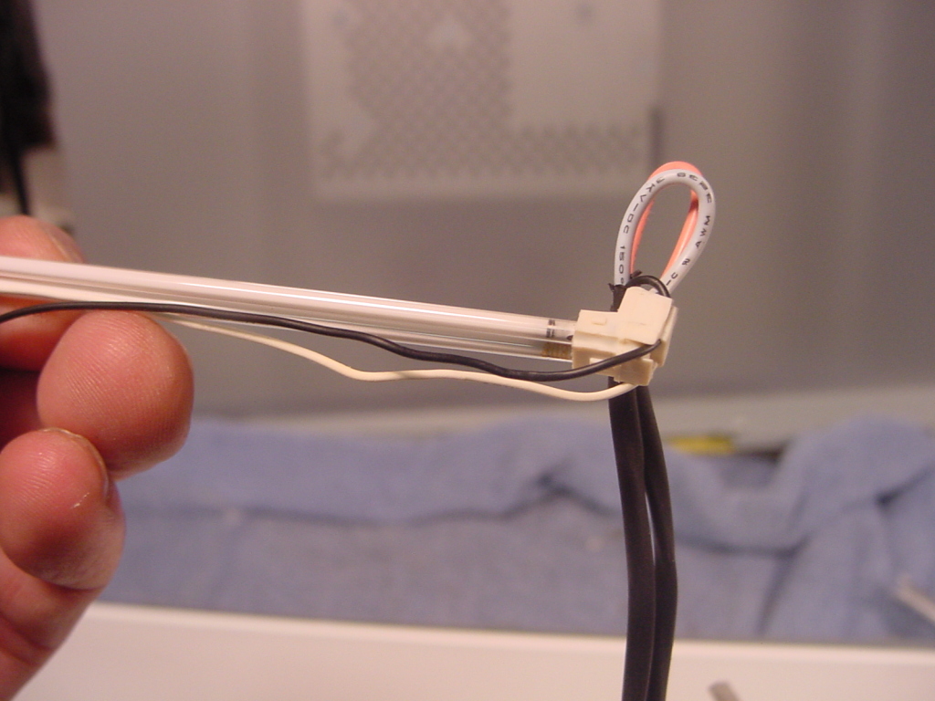

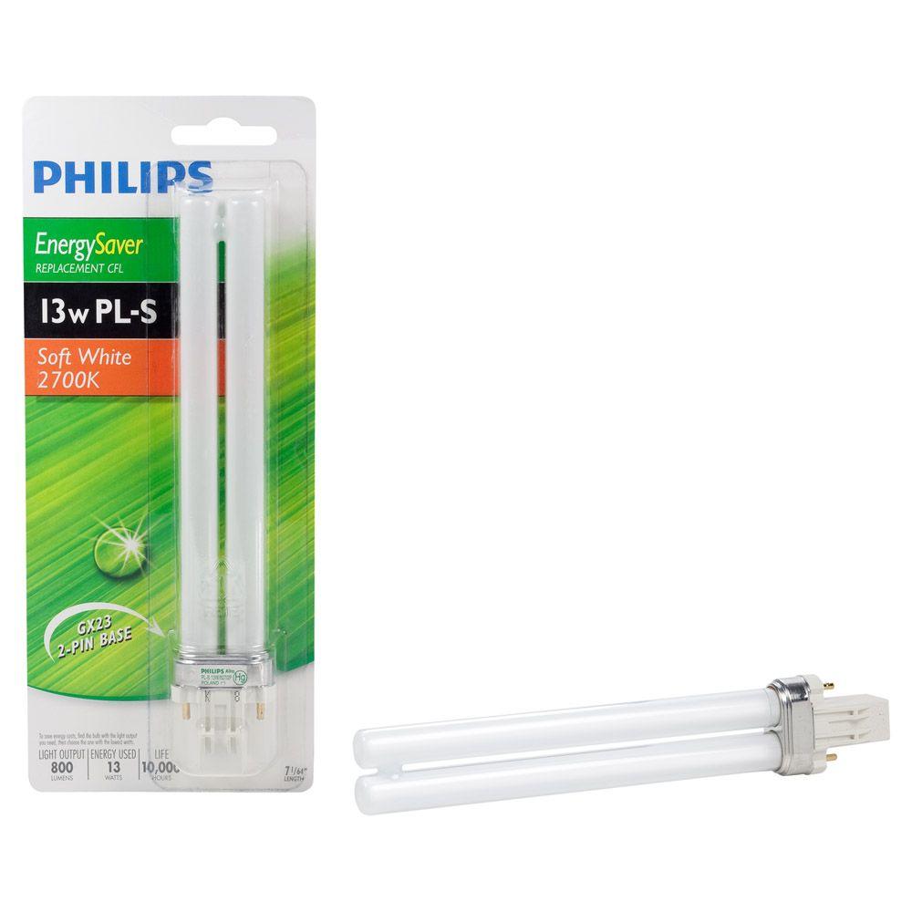

      Re: Inverter tester using old CFL
      Hey Budm,
      I have a few of these lights, do you think I could use them without having to open them?
      They are sold at home depot for 4.97$
      Tks!
        #83
        You could use those directly, yes.
        Just bear in mind that they may not last as long as they would when used with the correct inverter, I think the monitor inverters drive a higher voltage as their CCFL tubes are longer, so the test lamps may fail faster. That's what I experienced anyway - although I was using scavenged tubes from CFL lamps which may have been near their end of life already...
        -David VanHorn

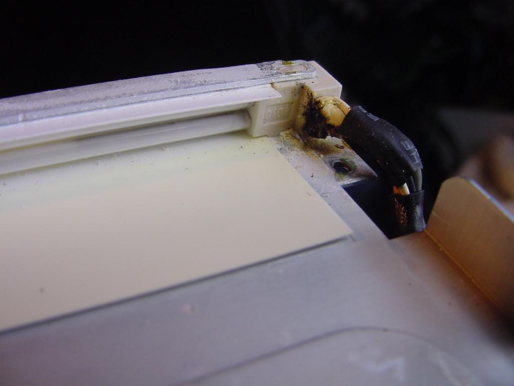

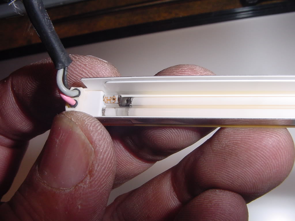

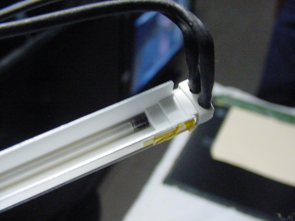

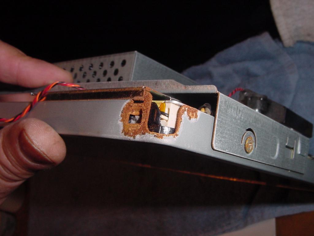

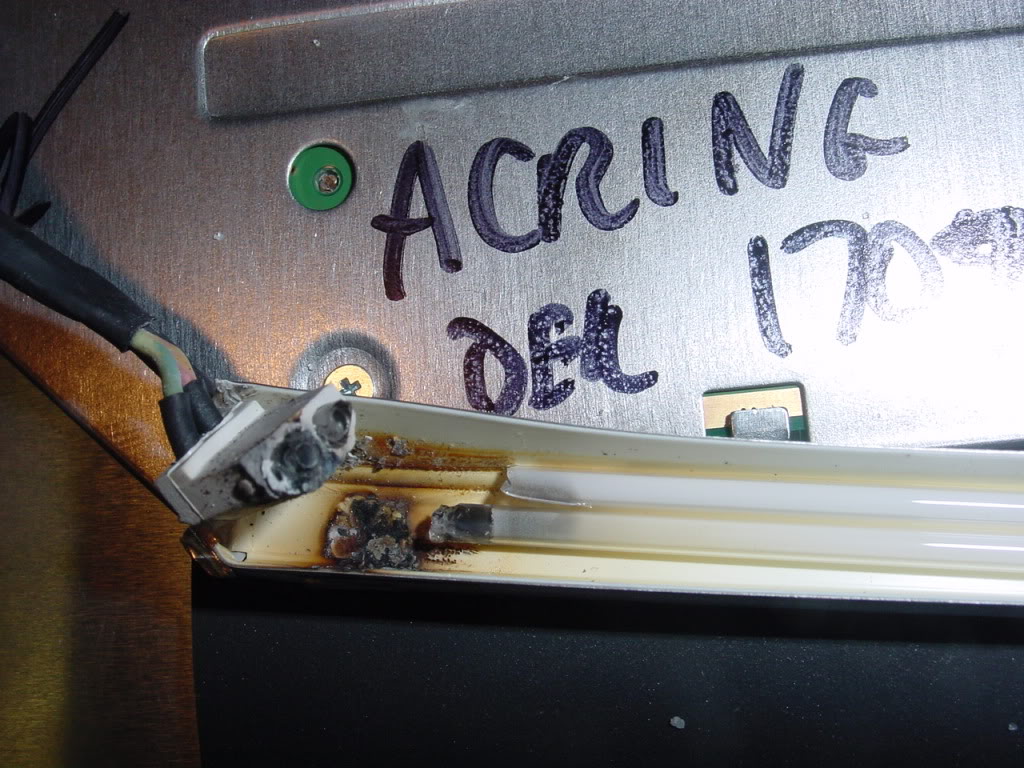

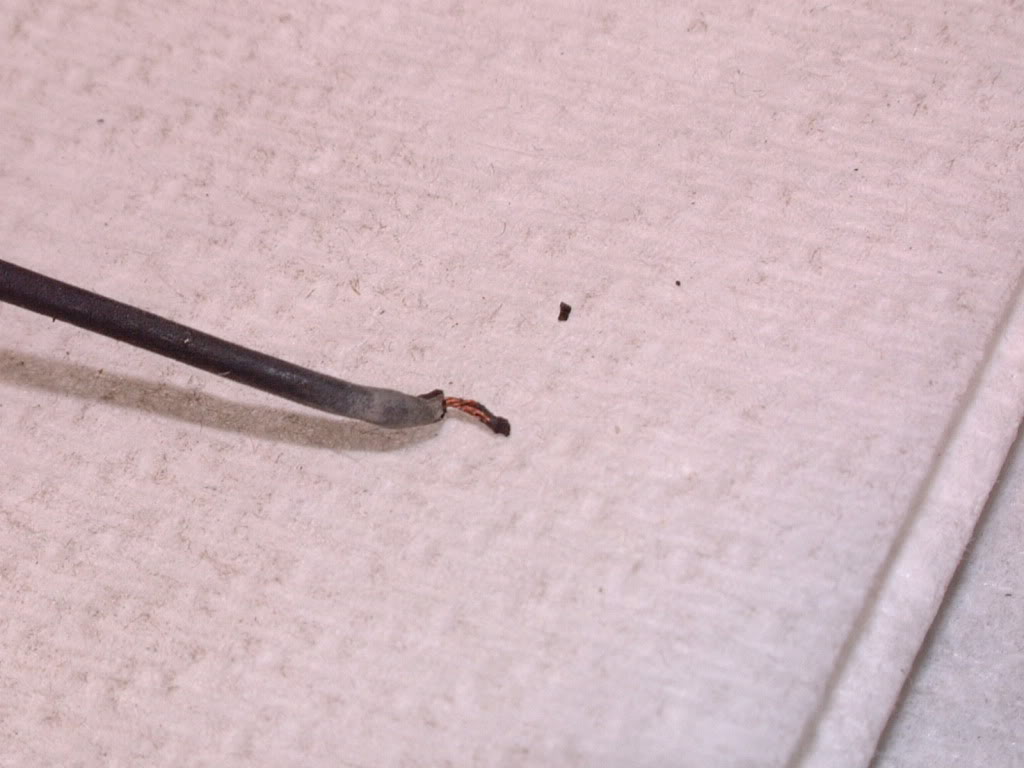

          #84

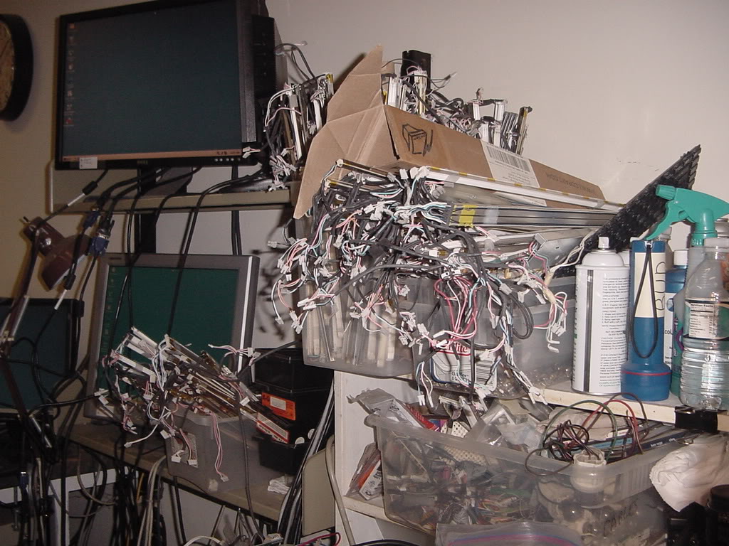

          Bad lamps and bad wiring.
            #85
            Bad lamps and bad wiring ii.
              #86
              ^^ OH MY.... ^^
              How many thousands of LCD monitors have you fixed to collect all that?
              Gee. To think I already had second thoughts of doing a lamp replacement after I did my first, because I thought it was so "involved".
              My deepest respects and hat off to you sir! You have quite the patience and skill.

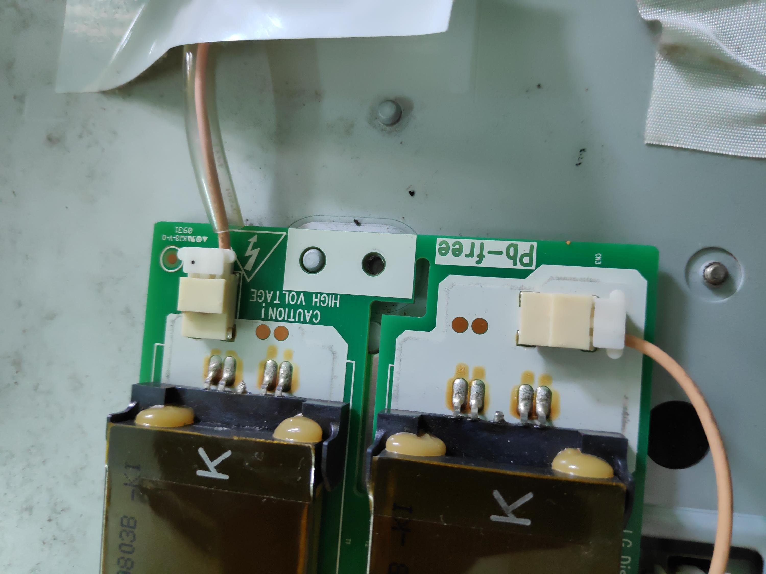

                  Can I be able to use this technique in following picture, where there is only lead out from the master and slave as in the picture.
                  will there be any circuit or capacitors underneath?
                  this is a old 32 inch , lg 32lh60yr. backiight sometimes stays on varying intervals,sometimes just flashes just for a second. and want to determine inverter or lamps that is bust.
                  panel : lc320wud
                  inverter board : LG 6632L-0548A
                  thanks for the help
                      Can't say for sure. You would have to trace how the CCFLs inside the LCD are connected. Perhaps someone who've seen this might know better. But from what I can guess, there are two possibilities: either each CCFL inside the LCD is connected to ground (or perhaps another grounding circuit) -or- two CCFLs are in series and there is no connection to ground anywhere.
                      If it's the latter, I'm not sure if a regular CFL would be okay or not, as the voltage might be much higher. And if it's the former, then it becomes a question of where/what circuit the CFL should be grounded to.
                      Thus, I think you might need to make a new thread on this, open up the LCD screen so that you can trace how the CCFLs are connected inside, and post pictures there. That should allows for a more definitive answer, I think... of course, unless someone has seen this before and can tell you for sure.
                        Perhaps if you trace out how the output windings of the transformers are connected it will give you some clues?
                        -David VanHorn
