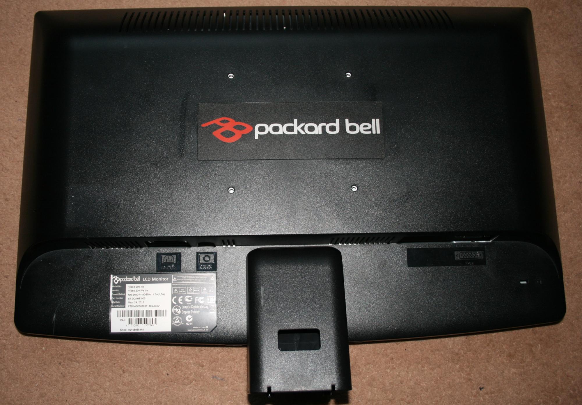

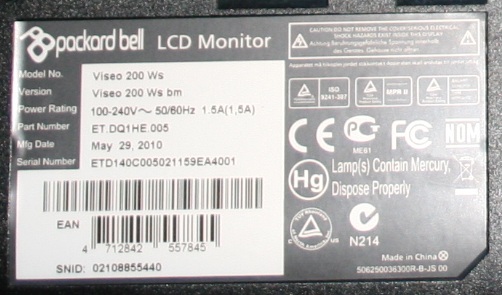

This may also been known as an ACER 200 WS. I can only find the service manual on pay sites. I am guessing that these pay sites are probably bogus sites?

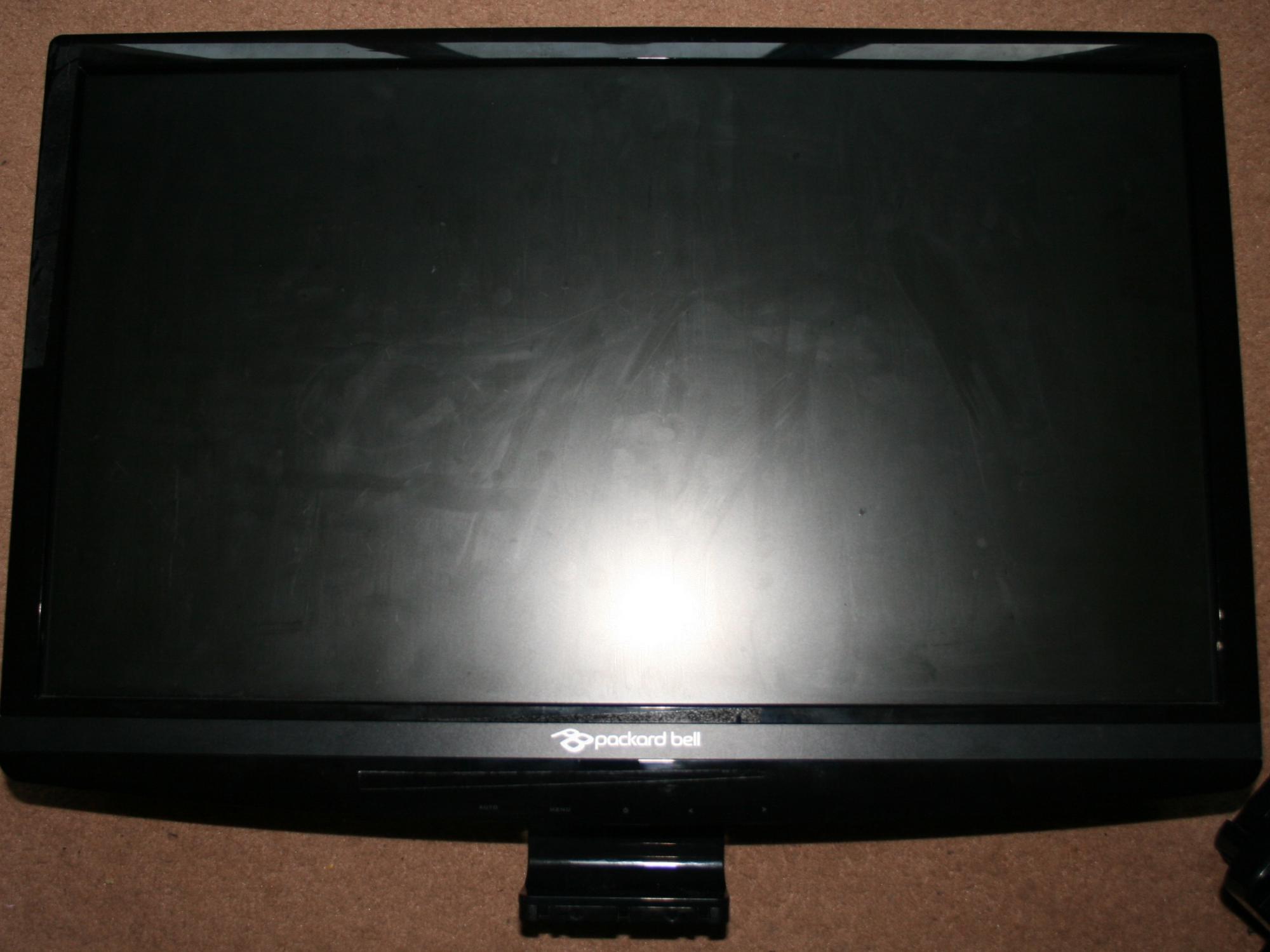

Lay it on a soft(ish) surface like in pic 2 and start levering the case apart. Like 90% of todays cheapo LCDs, the case is held together by plastic clips all around.
Start on the bottom of the LCD so any pry marks in the plastic aren't visible once it's back together.
The main mistake most people make is trying to get the front cover off. Those always open up from the back, exposing a metal cage sitting on the back of the LCD panel (usually not even held in place by screws), which in turn sits in the front half of the casing.
Managed to finally get this thing open and it looks like there was a poor connection on one of the ccfl's which meant that it wasnt connecting properly. The connection had melted the on the end causing the plastic cap to break in two and the end of the ccfl has burnt off.
I am looking on the net now for a replacement CCFL and I am wondering if it is even worth replacing it?

Okay, i got it open finally thanks for help so far.
Capacitors look fine on the power-board.
Will take a look at the backlicht connections.
Kensington Lock, normally used in shops to stop the item from being stolen,so not being used.
Put your fingernails under the top/Bottom or sides of the Surround from the front, and you should get enough slack from one of them to be able to work your way around with a 'flat blade type thingy'
I used a credit card to slide it open, the card will get damaged but the monitor stays pretty, started at the control buttons, there you can pull it back and then slide the card trough.

I have a service manual for a viseo 200t. Looks alot like yours but i can't upload the pdf. PM me your email addy and i'll send it that way.
Hi, I know this is an old thread but I am having trouble with my viseo 200t (dim and flickering) and I could really do with getting a copy of the service manual.
If you still have it can you send me a copy - I am new to this site so I don't know if I will be able to get PMs
