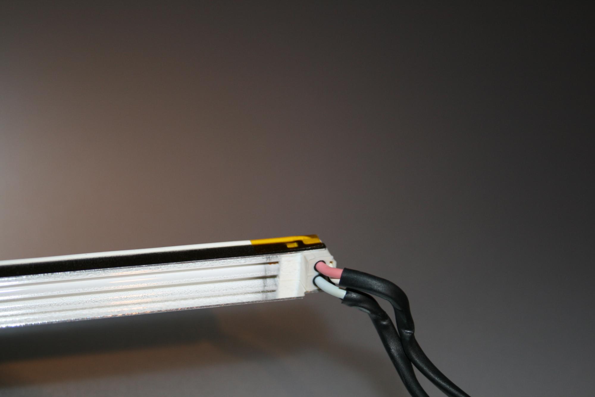

      Re: Samsung 920NW 2 Seconds to Black

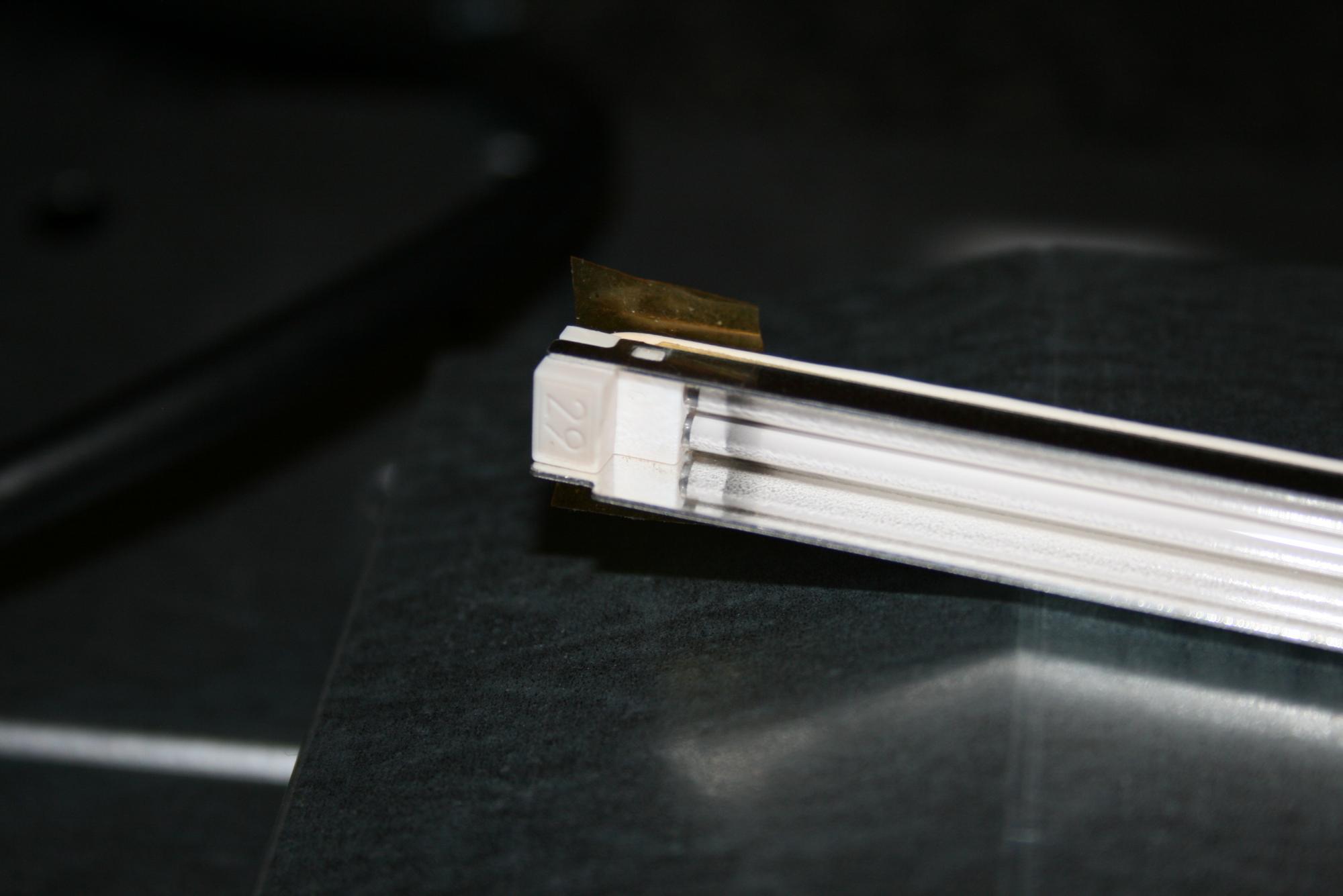

      Tried the CCFL's again and it turns out that one of the 4 is not working.
      I have had a good look and it doesnt seem to be damaged?
        The return wiring (the thinner guage) can often be frayed or charred, but you can't see it with the silicon ends covering them.
          retiredcaps after snapping 2 ccfls yesterday trying to repair them I almost gave up. Giving it one last bash I took the end off and the smaller wire came off in my hand I have spent about an hour trying not to break anything and I have managed to get another wire soldered on the end and it works! only thing I need to do now is join the 2 smaller wire neatly so that they fit back in. Are they ok with insulation take on them?

          • retiredcaps
            • Apr 2010
            • 9271
            That is why I only do preharnessed replacements as per
            https://www.badcaps.net/forum/showpo...5&postcount=10
            Alexanna is the king of these repairs.
            I estimate about 50% of the people who try ccfl replacements are successful. Most don't have the patience do it.
            If you mean insulation tape (not take), I'm sure alexanna uses Kapton tape. I think Toasty recommended silicon caulk at the tips where the solder joint is, but right now I can't find that thread in my bookmarks.

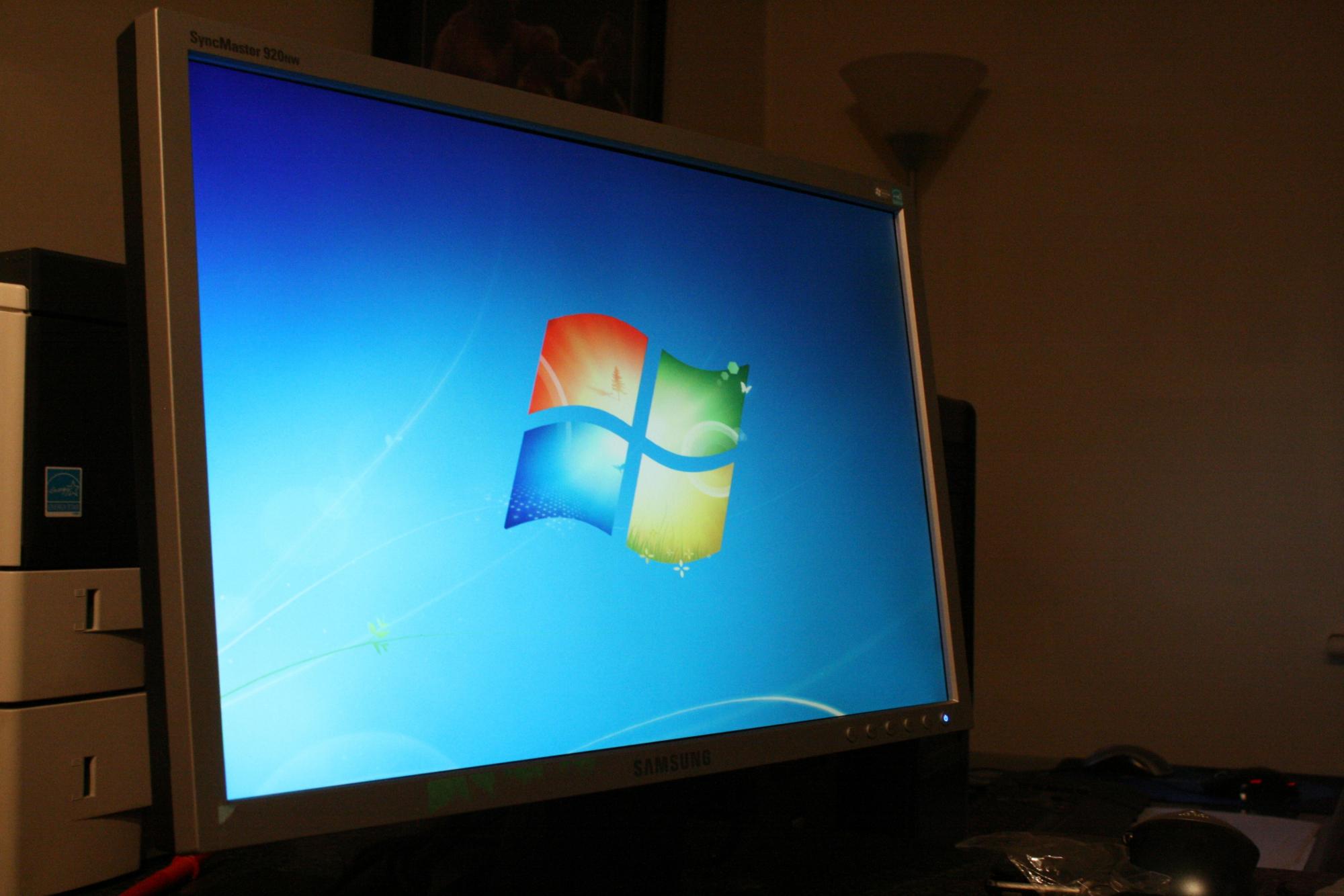

              Guess what!
              Finally up and running!

                    • Jasgriff
                      • Feb 2012
                      • 578
                      #30

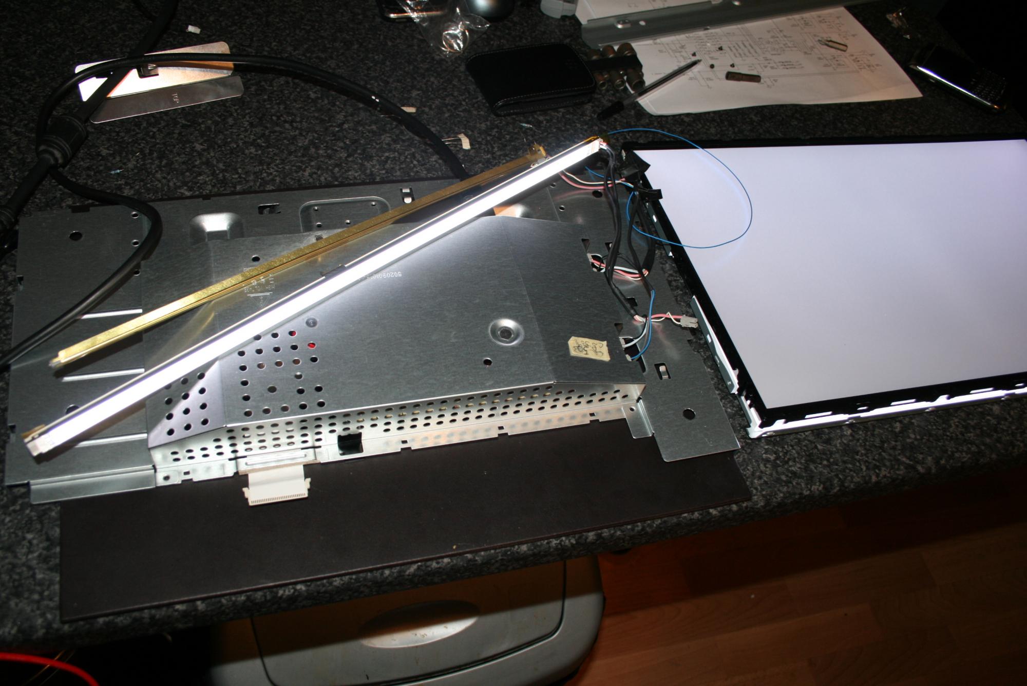

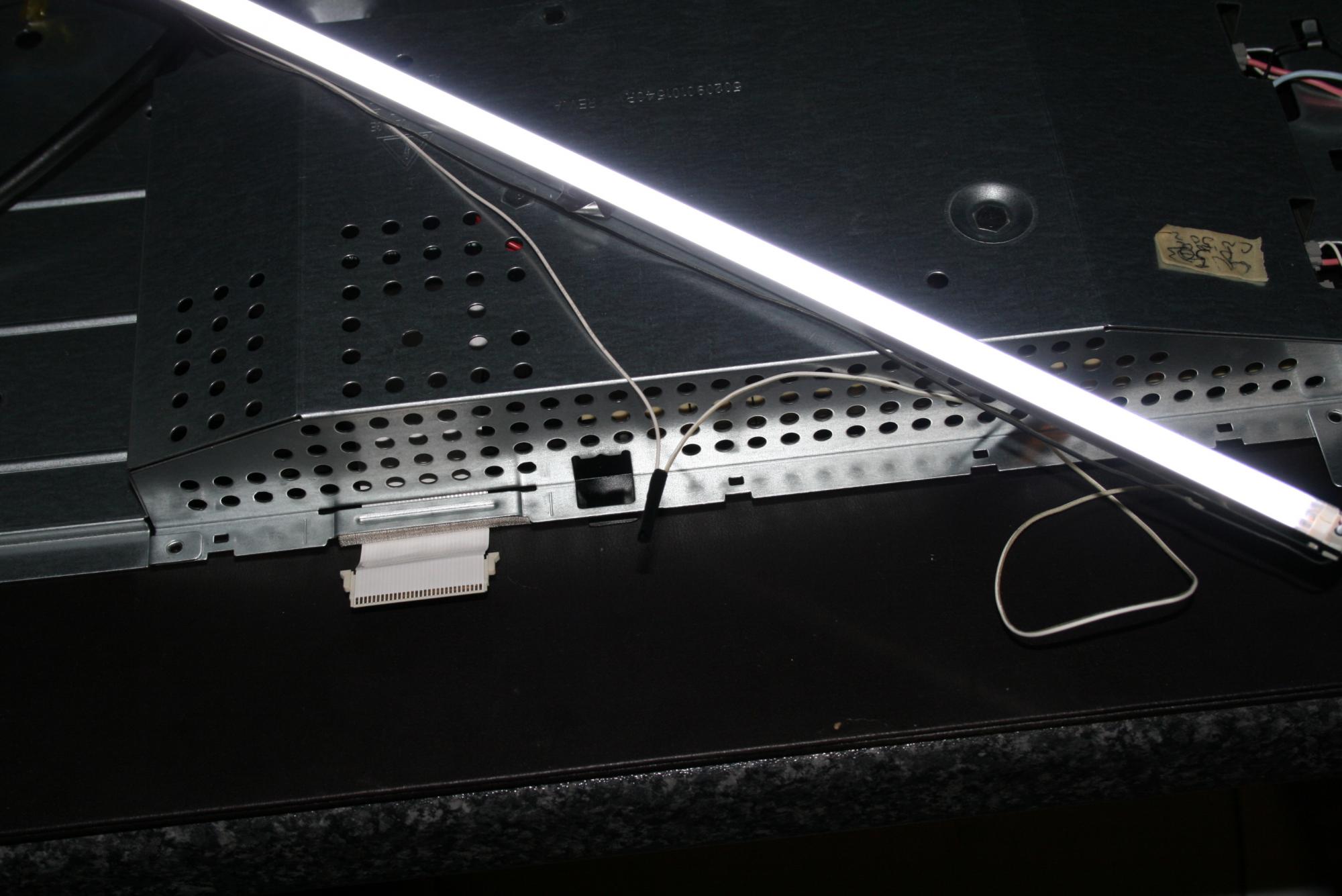

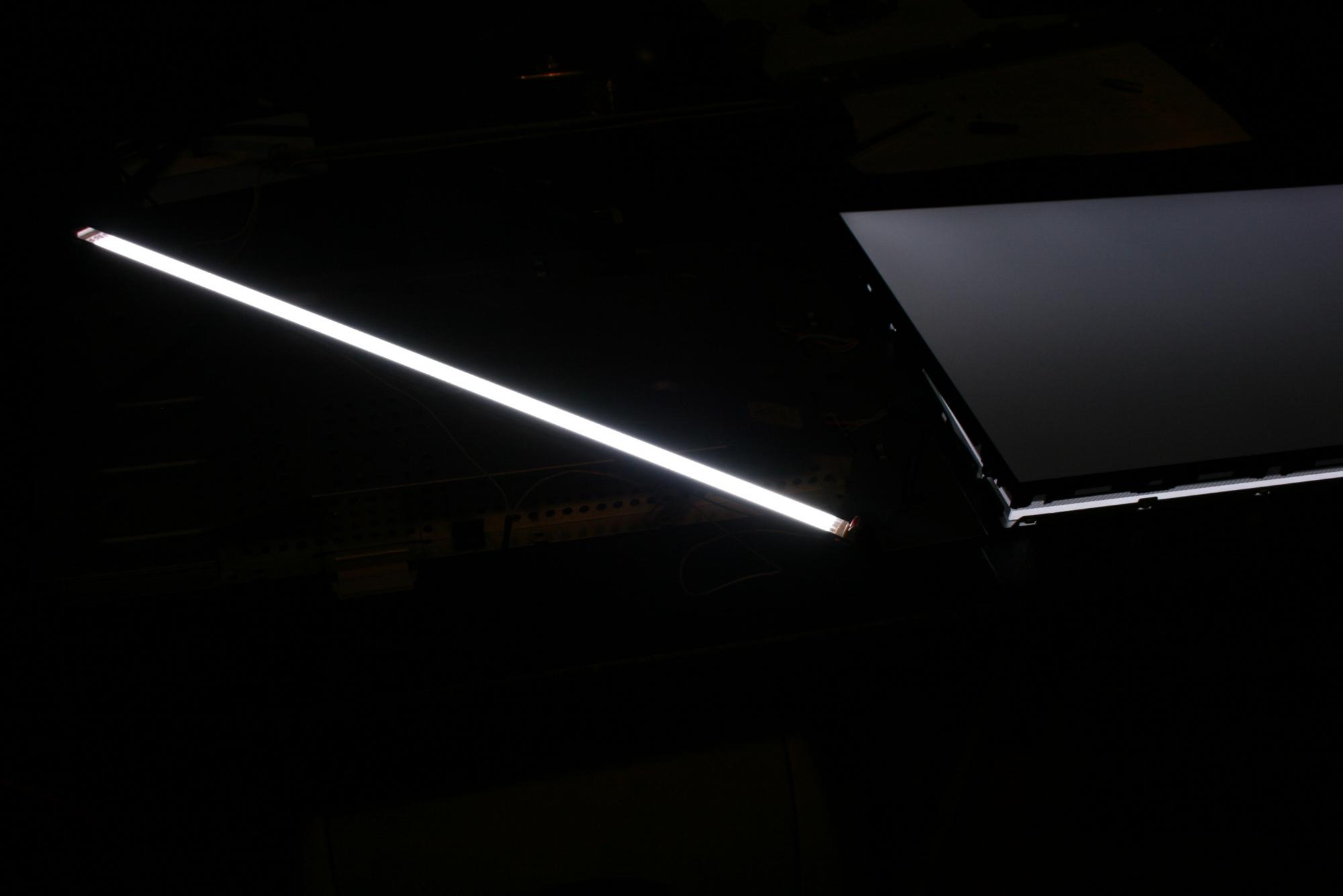

                      Well I learnt alot from repair this one.
                      When I first tested the CCFL's in another monitor they did work ( The fact it worked must have just been luck, as it was loose every now and again it must have made a connection maybe when the corner had been push a little? ).
                      So I though thought right I have another monitor with its back off I will try all 4 in the Samsung rather than one at a time and that still went off in 2 seconds ( I didnt verify properly that all 4 CCFL's in this good monitor were not intermittent )
                      What I should have done is had a loose known working CCFL and tried each socket not all at once.
                      Lesson learnt here is that its not a check box exercise you really need to check and re check what your doing then have a think before you move on to testing something else. Ohh and always have a at least 1 good CCFL to hand.
                      Thanks for your patience bubm and everybody else's help and thoughts including retiredcaps who encouraged me not to give up on bad CCFL connections (my Fluke still hasn't arrived!)

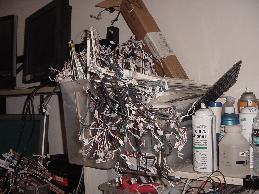

                        Yes, that is the best and easiest. I have one lying around from a botched repair.

                          I have lots.

                            lol How did that keyboard make its way into your CCFL tub?

                              Ran out off space for laptop parts.
