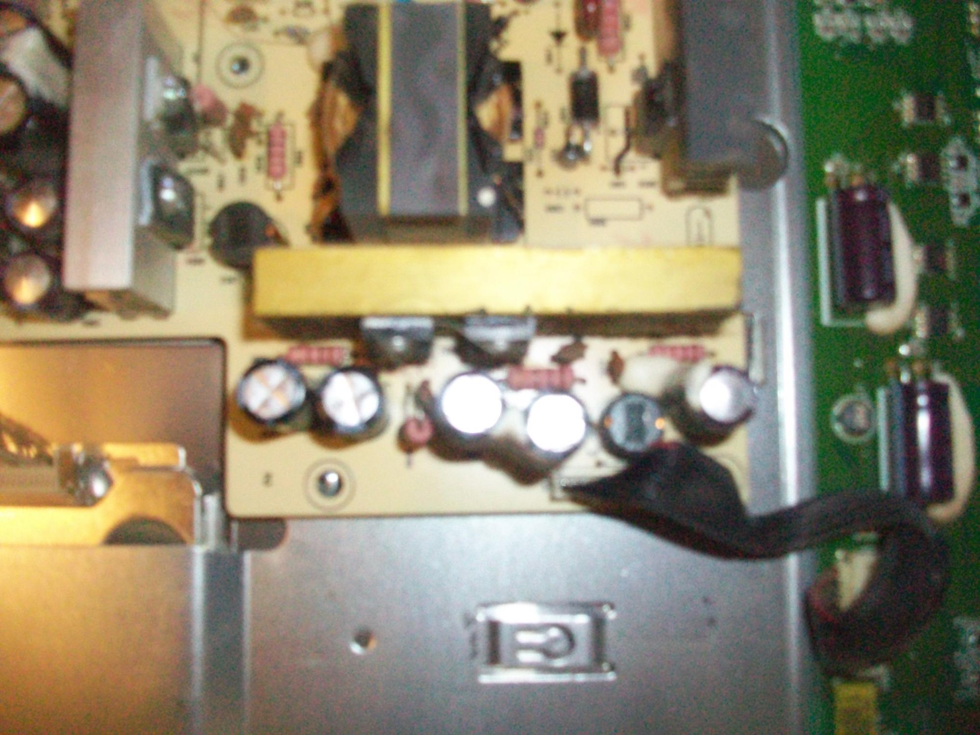

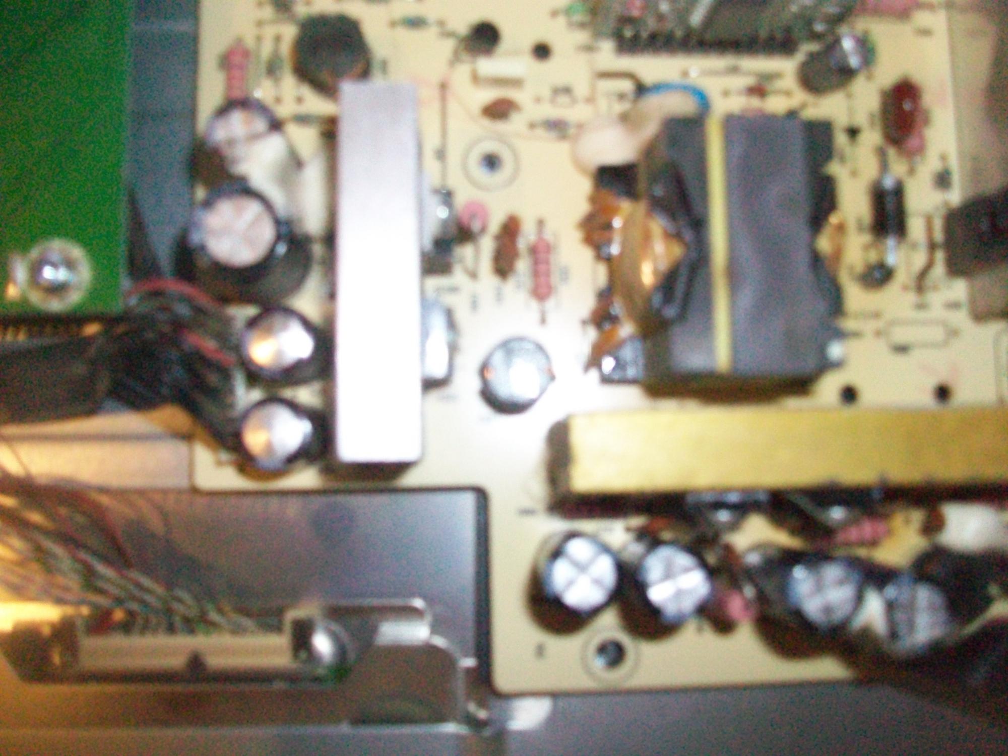

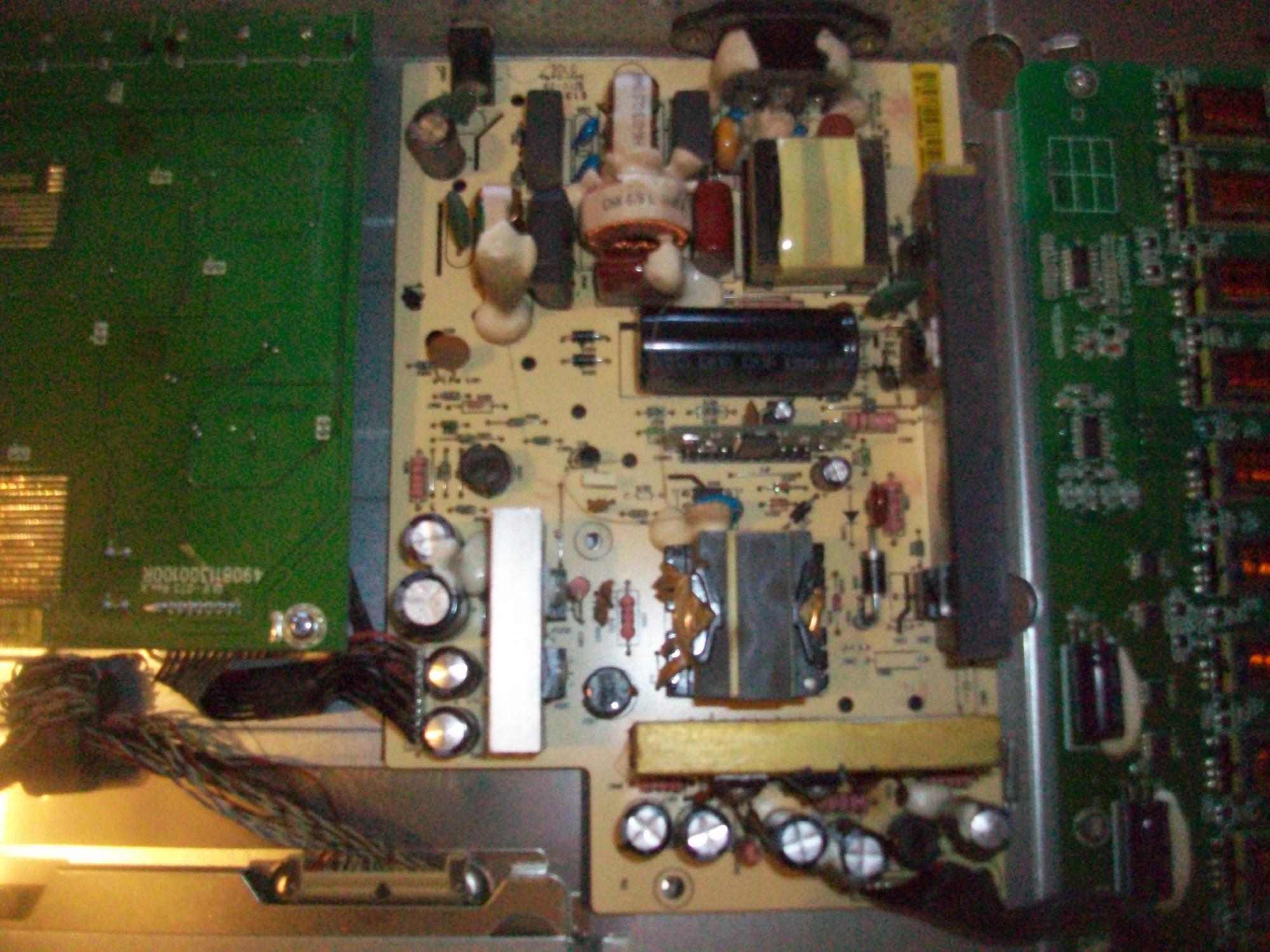

                          Re: Gateway FPD2485W | 2 second to Dark
                          Hey guys,
                          Well i finally had some time to do this, here is the pictures as requested. I look forward to your findings, also just to let you know i had noticed the ones that look bad are also rather loose.
                          Acidrain
                            See section 1 of the troubleshooting guide in post #19. It will explain, with an example, how to choose replacement caps.
                              I can see at least 3 bad caps with domed tops, very common in all MONITOR BRANDS as you can see in my albums if you want to see them.
                              http://s807.photobucket.com/albums/yy352/budm/GATEWAY/
                              See PDF of your picture that I red circle the bad caps.

                                Thank you replying, i bought an entire set through some of the recommended site everyone had referenced. Are my pictures clear enough to know which ones? Iam going to go pick up volt meter for the checks.
                                        Greetings all,
                                        I have successfully changed out all the damaged capacitors and replaced them all and the Monitor is once again working. Ill update in a few days if anything comes up, but i suspect that nothing will.
                                        Thank you all so much!!!!!
