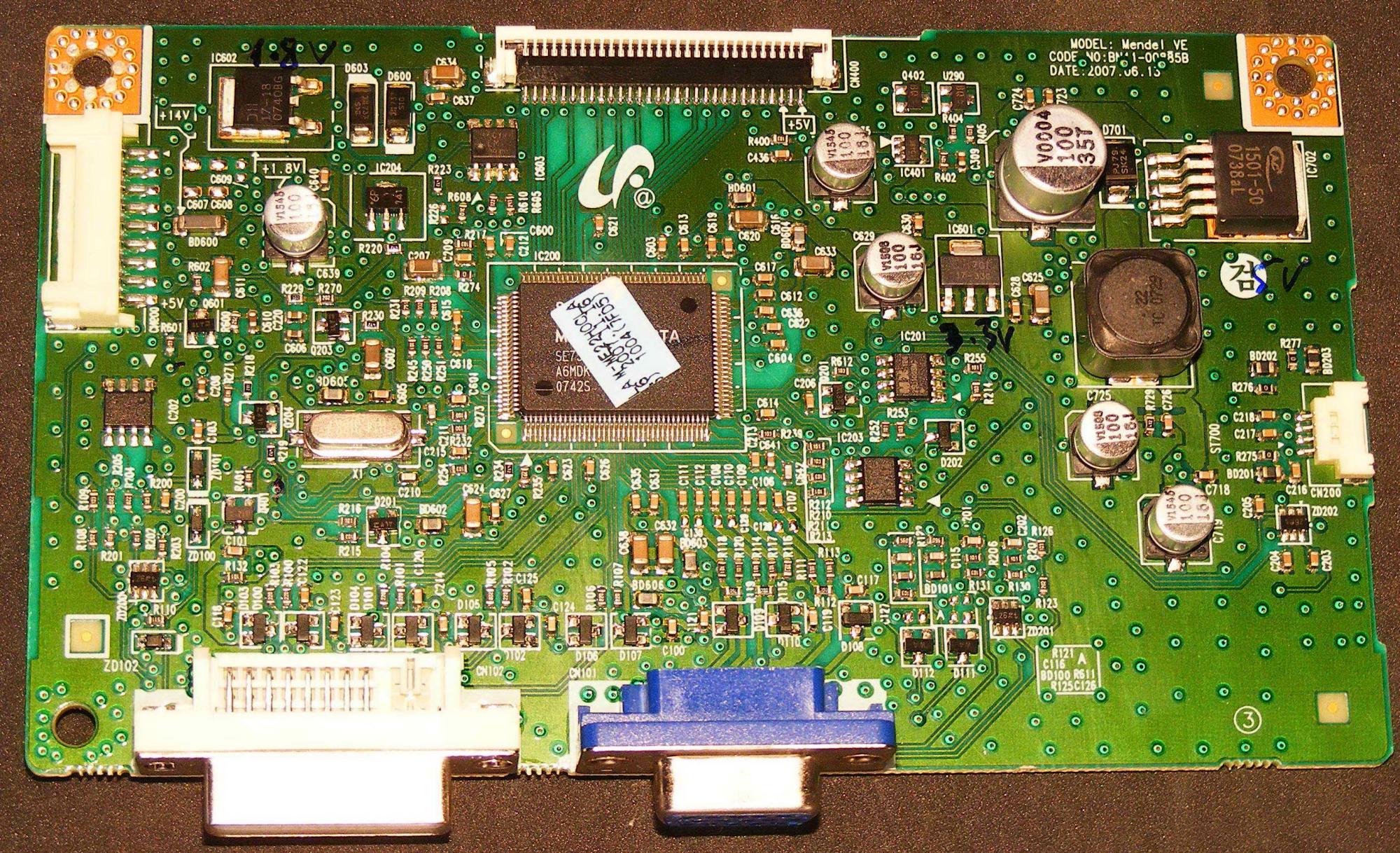

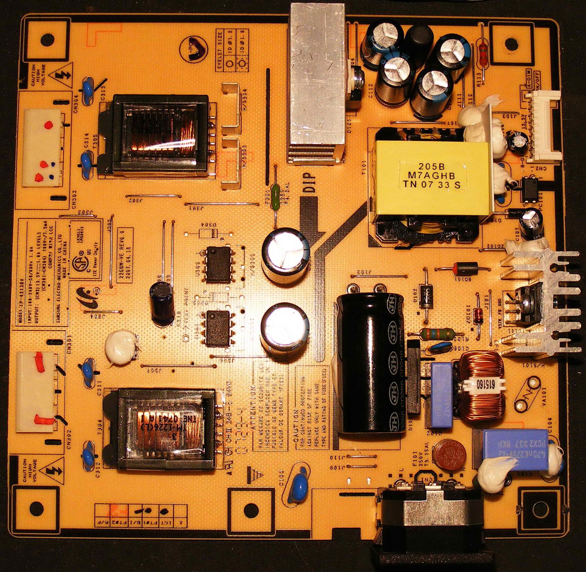

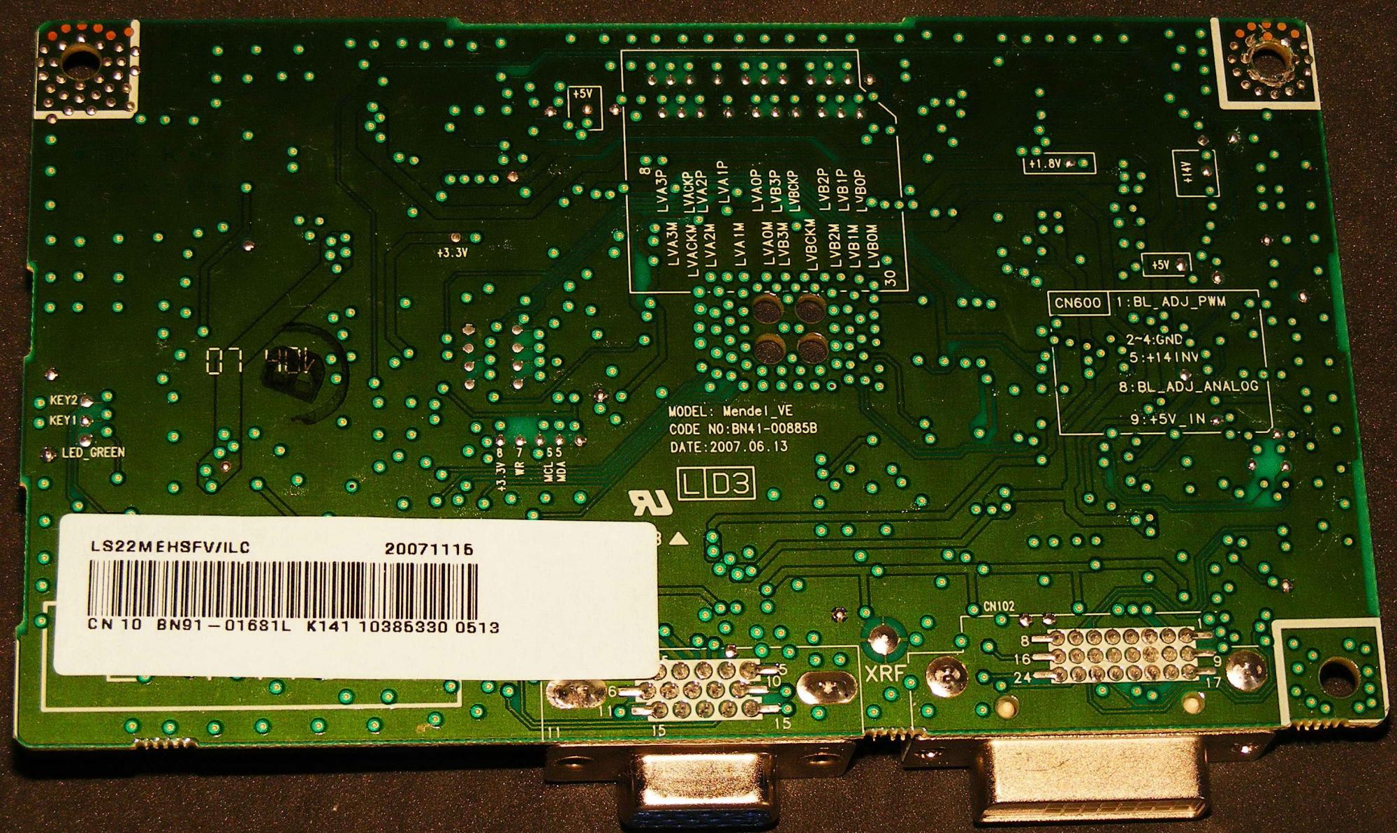

    I am trying to troubleshoot a samsung syncmaster 226bw.
    The monitor apears to be completely dead. no blue led, not 2 seconds to black, nothing.
    I opened it up and looked for bloated caps on the power supply board. found 4 bloated caps. I decided to recap all electrolytic caps on the power supply board. nothing ! (no blue led , and I can't turn on the monitor).
    I found a service manual for the 226bw (which is only close to the circuits in the monitor) and started checking for voltages.
    Listed are the voltages I found at the connector to the logic board:
    Pin 1-> ~0v should be ~0v
    Pins 2,3,4 -> 0v (these are gnd pins)
    Pins 5,6,7 -> 15.2v should be 13V
    Pin 8 -> ~0v
    Pin 9 -> 0.465v I think this should be higher.
    Now, on the logic board I found the three regulators for 5V 3.3V and for 1.8V to be working fine (all output the correct output).
    I scoped the crystal oscillator and it oscillates at the correct frequency.
    Pictures of the boards are after recapping the PS board. I can also upload the service manual for the monitor if needed.
    At this point I ran out of ideas.
    Any ideas ?

    The 15.2V is probably ok, since it's an unregulated output and will drop under load. Do you have an idea what pin 9 is for? Have you checked the output voltage for the buck regulator, IC702?

      On the PCB pin 9 is described as 'on/off' which makes sense as I fear this must be related with the problem.
      The service manual describes pin 9 to be 'BL_EN' I'm guessing 'BackLight_Enable' ?
      IC702 - 1501-50 Buck regulator for 5v gives 5.12v
      Thanks !

                  I double checked, the 3.3v regulator seems fine.
                  jetadm123, you had such accurate insight that I never realized you don't have the board (monitor) to take measures from. (: I guess this means you are doing a great job !
                  The part number of IC204 on my logic board is :
                  6P 741
                  In other picture posts I've found, I see that 6P is reoccurring and that the second segment (741) is a different number on every board.
                  so my guess is that the part number is only 6P.
                  SMD can be so frustrating!

                      Yeah, I figured it must be something like that. It's nice to know you follow up on your threads even when they are only mentioned as reference...
                      But hey, maybe you have an idea what the mystery IC204 is ?
                      Its marked 6P and it's an SOT223-4 package.
                      I'm clueless.
                      anyone ???

                        Re: samsung 226bw
                        I searched for "mendel ve ic204" and found
                        http://www.scribd.com/doc/61780258/S...NW-216BW-sw77i
                        says it is an
                        IC-Vol detector; 7024; sot-89; 3p,-,plasti
                        which might be
