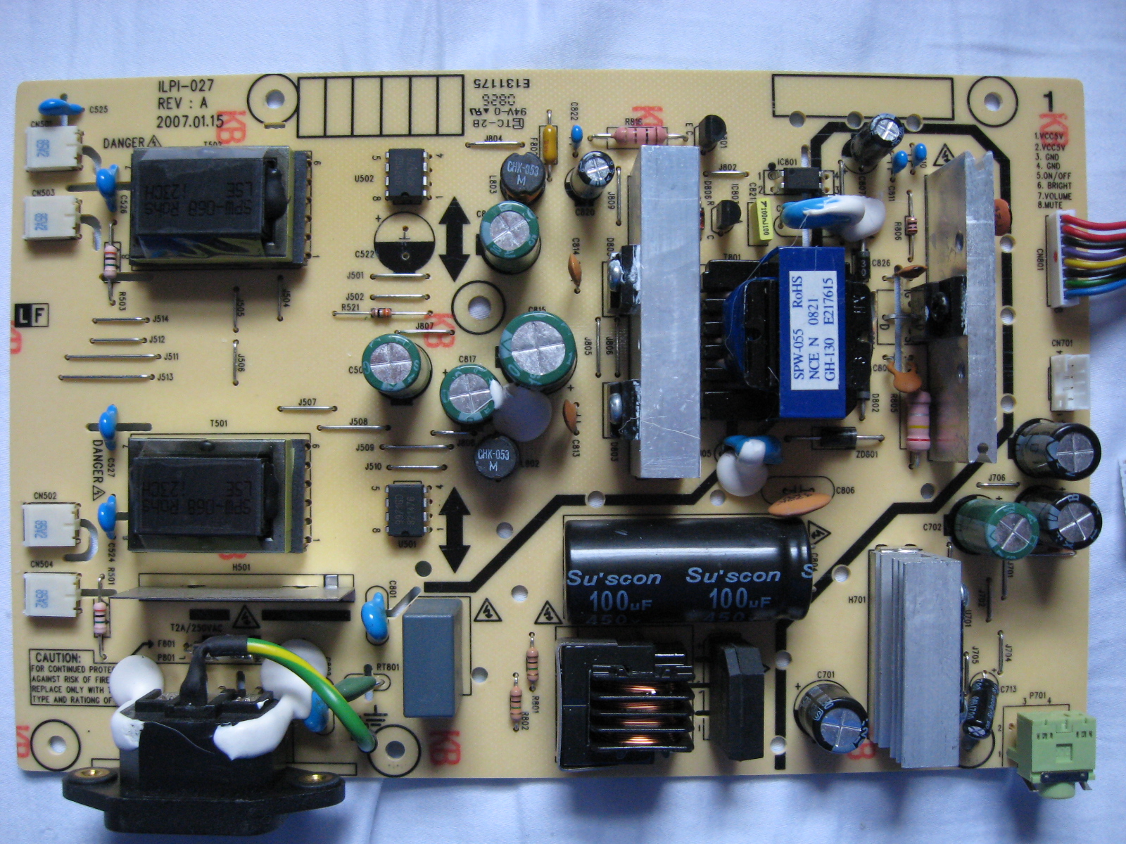

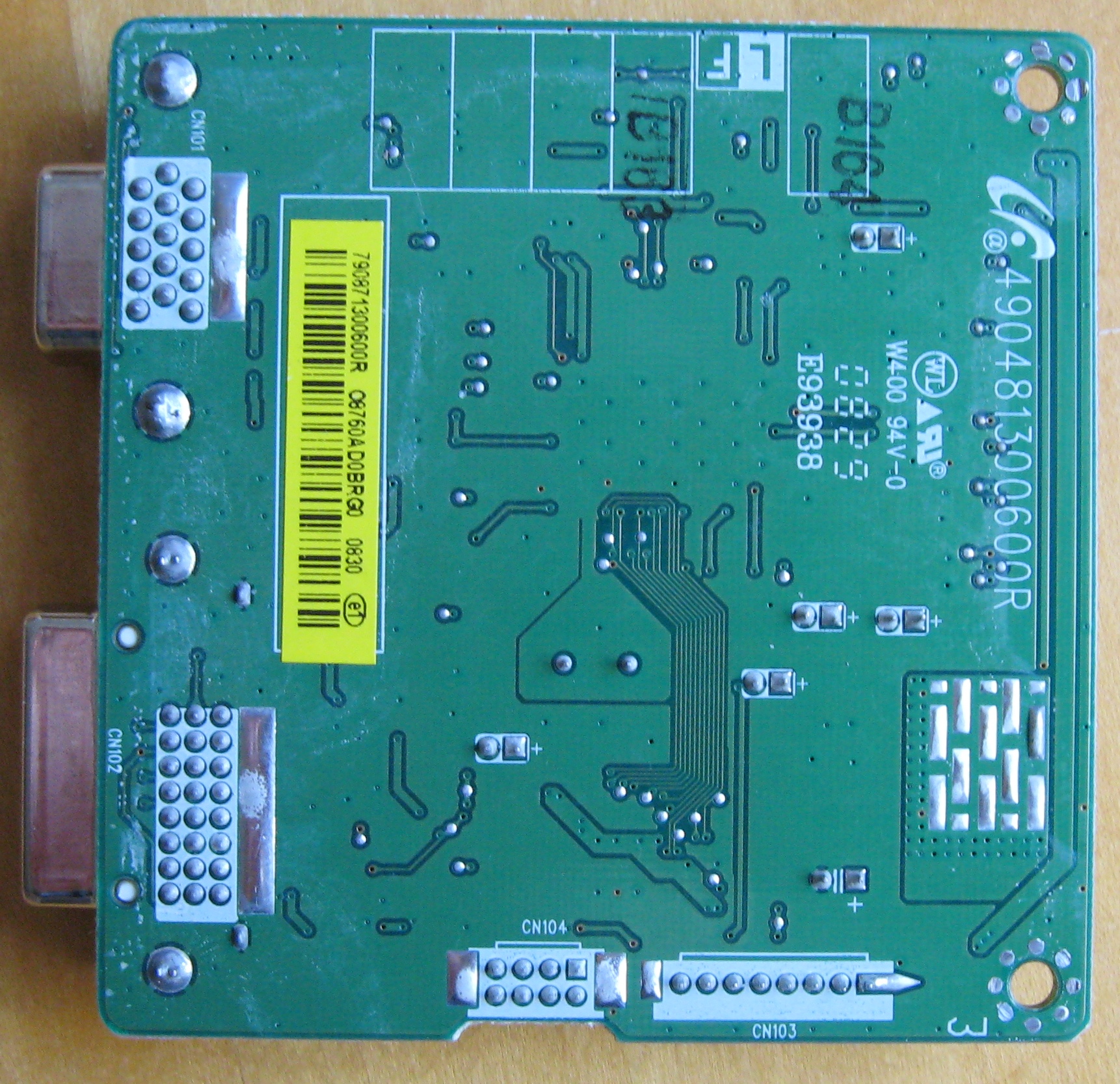

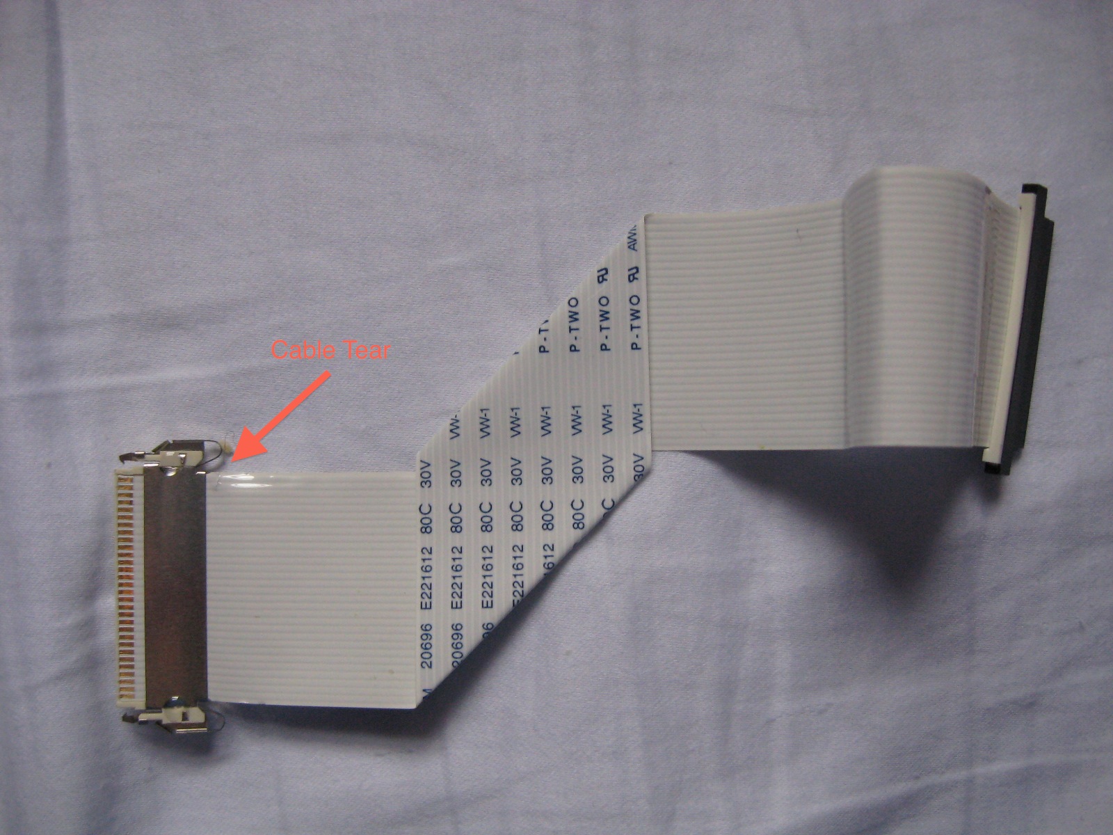

    I picked up an HP w1907 LCD display with the 2 second to black problem at my local Goodwill outlet store. Took it apart looking for bad caps but found no obvious problems. Tested the monitor again and found an all white screen. Playing around with it, I discovered that reversing the top two CCFLs make the backlight work until power save mode kicked in. Noticed later that the LVDS cable had a small tear in it. Thought that was the cause of the all white screen, but found out later it probably isn't.
    So I picked up an HP L1908w display at the same store a few days later, planning to use its LVDS cable to fix the first one. But things haven't been that easy.
    Both monitors use the same power boards and logic boards. They use different revisions of the lcd panel (Innolux MT190AW01 versions 3 and 5). The L1908w lacks the speakers and associated electronics on the power board, and lacks the DVI input on the logic board.
    The power board contains the inverter, AC supply and the sound circuitry (if needed). It only supplies 5V to the logic board. The logic board contains circuitry to produce the needed lower voltages. Specifically the AS1117-L
    versions -33 and -18. And it also has electrolytic capacitors from Samxon and Su'scon.

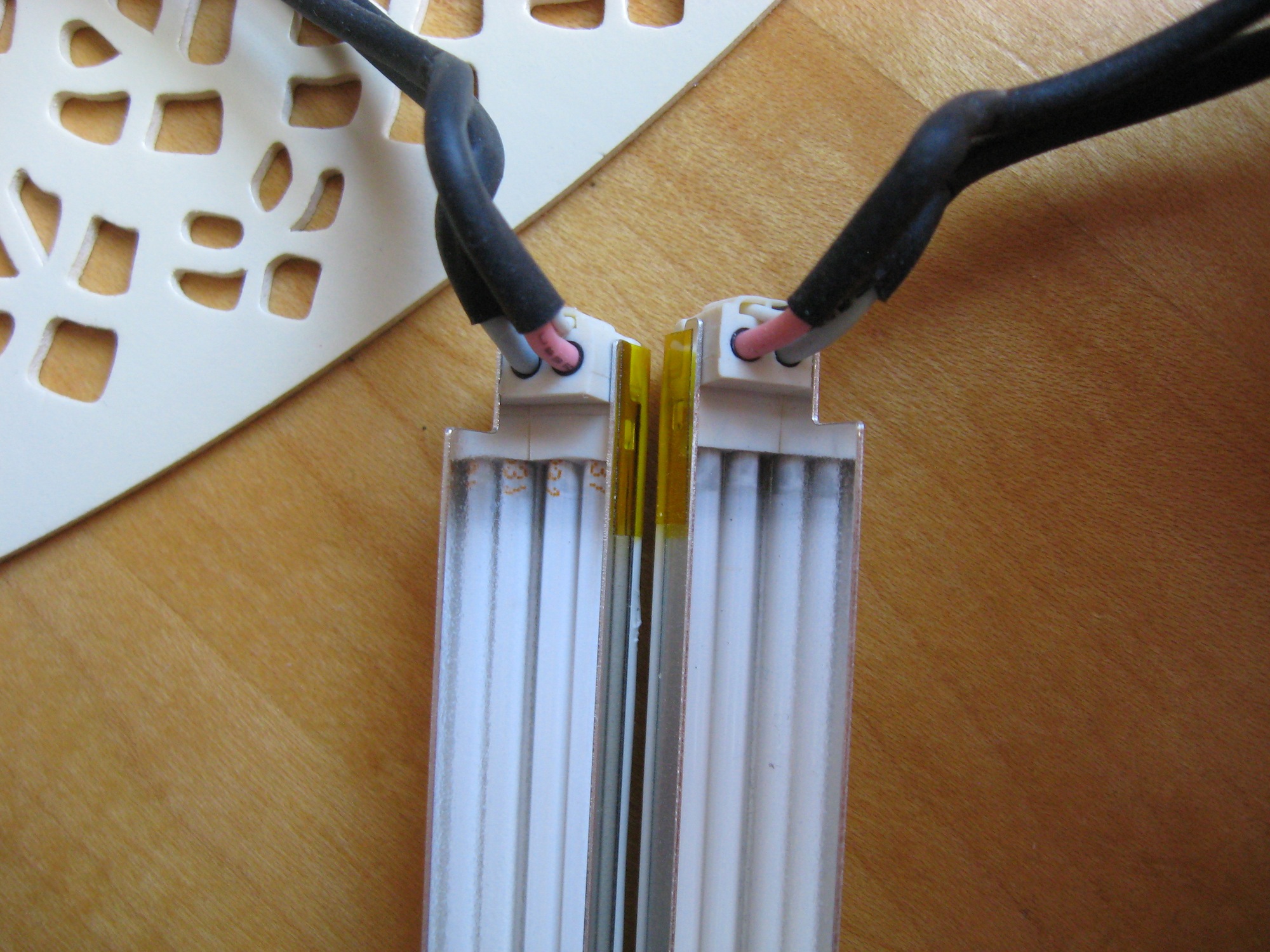

    Pulled the ccfl holders from the 1907w panel, figuring to repair them and then use them to repair the other panel. But there is no apparent damage to them.
    Tested the second monitors backlight by reversing the top ccfls and they worked until power-save mode kicked in (no computer attached). Decided to use that LCD display since the cable was stuck to the LCD panel really well and I was being very careful not to damage the LVDS cable.

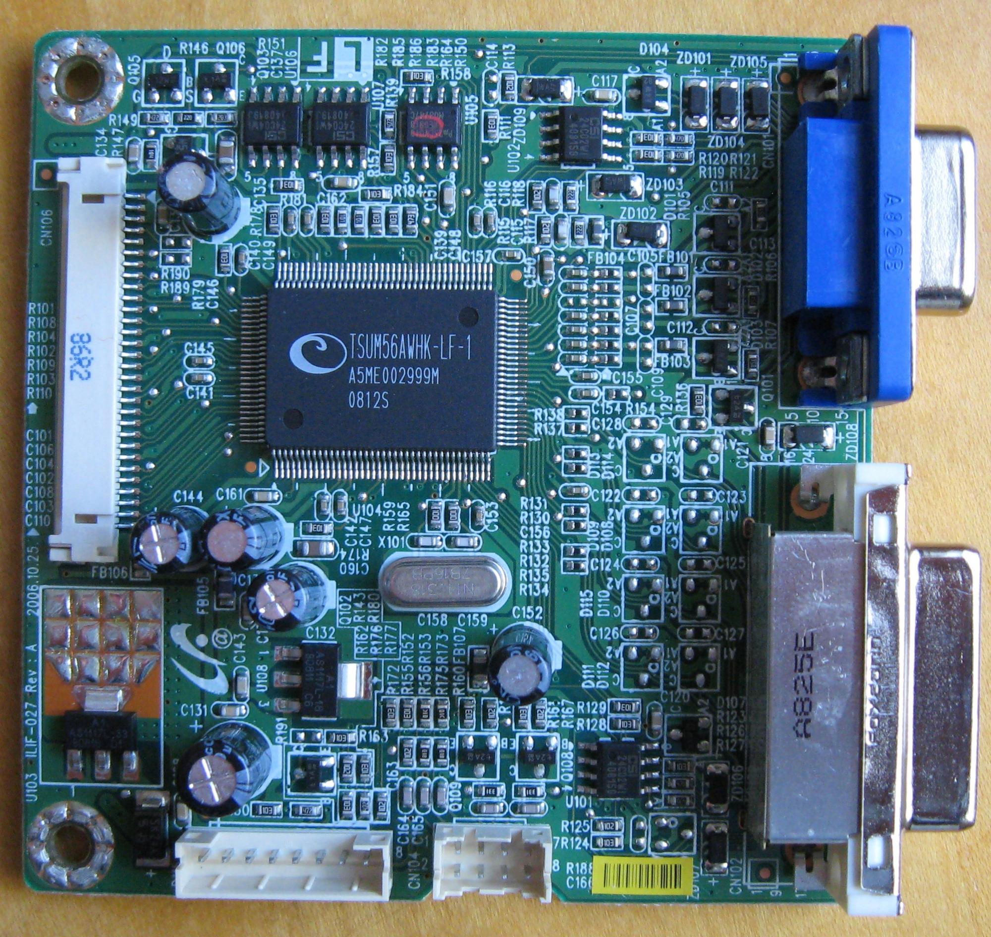

    But the LCD panel(version 5) will not work with the w1907 logic board. Always get the white screen, even after switching power boards. Tests OK with the L1908w controller card.
    So now to the questions:
    1. Is it likely the problem is a incompatibility between the logic board and the LCD panel? Or would a recap help? Or did I do damage to the board?
    2. Does the change in behavior of the ccfls after reversing their positions on the power board mean a problem with the ccfls or the power board?
    3. The Samxon datasheet lists the impedence in ohms. The DigiKey website also uses mOhm. Is this Milli-, so that Impedance at 0.038 Ohms translates to 38 mOhms? Got to the decimal place in the right place.
    4. Since some of the caps on the logic board are for the power supply, shouldn't they be low ESR? Or does that matter with the AS1117 chips?
    5. Recapping the boards make sense for reliability, but could they cause the problems I've noted?

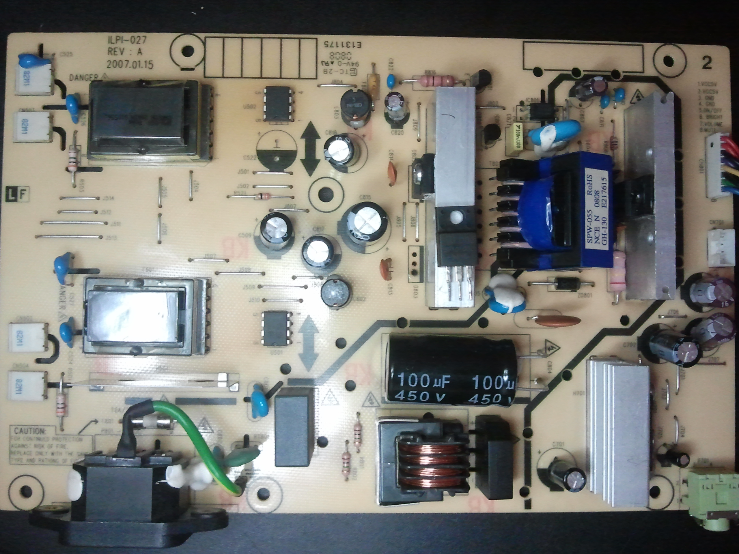

    Power Board -- ILPI-027, Rev A, 2007.01.15
    C804 - Su'scon SE - 18mm x 40mm - 7.5mm leads - 105C 100uF 450V Ripple=720 - Not to be replaced
    C807 - Su'scon SH - 6.3mm x 11mm ??? - 125C 47uF 25V Ripple=110
    Note: size not in datasheet
    C820 - Su'scon SH - 6.3mm x 11mm ??? - 125C 47uF 25V Ripple=110
    C818 - Samxon GK(M) - 10mm x 16mm - 5.0mm leads - 105C 1000uF 10V Ripple=1430 Impedance=0.038
    C509 - Samxon GK(M) - 10mm x 16mm - 5.0mm leads - 105C 470uF 25V Ripple=1430 Impedance=0.038
    C817 - Samxon GK(M) - 10mm x 16mm - 5.0mm leads - 105C 470uF 25V Ripple=1430 Impedance=0.038
    C815 - Samxon GK(M) - 12.5mm x 20mm - 5.0mm leads - 105C 1000uF 25V Ripple=2360 Impedance=0.021
    Sound Subsytem - For Future Reference - NOT to be replaced
    C701 - Su'scon SH - 10mm x 13mm - 5.0mm leads - 125C 220 uF 16V Ripple=300
    C702 - Samxon GK(M) - 10mm x 16mm - 5.0mm leads - 105C 470uF 25V Ripple=1430 Impedance=0.038
    C705 - Samxon BD(M) - 10mm x 15mm ??? - 125C 470uF 16V Ripple=256
    C707 - Samxon BD(M) - 10mm x 15mm ??? - 125C 470uF 16V Ripple=256
    C713 - Su'scon SE - 5mm x 11mm - 2mm leads - 105C 10uF 25V Ripple=45
    Logic Board -- ILIF-027 Rev A, 2006.10.25
    C152 - Samxon KM(M) - 5mm x 11mm - 2mm leads - 105C 100uF 16V Ripple=125
    C138 - Samxon KM(M) - 5mm x 11mm - 2mm leads - 105C 100uF 16V Ripple=125
    C135 - Samxon KM(M) - 5mm x 11mm - 2mm leads - 105C 100uF 16V Ripple=125
    C144 - Su'scon SK - 5mm x 11mm - 2mm leads - 105C 22uF 16V Ripple=63
    C132 - Su'scon SE - 5mm x 11mm - 2mm leads - 105C 4.7uF 50V Ripple=35
    C130 - Su'scon SE - 6.3mm x 11mm - 2.5mm leads - 105C 100uF 16V Ripple=140

    Easily the best post #1 this year with a ton of info, detail, and excellent photos. Hopefully my response is up to par. Thank you.
    The caps on the logic don't undergo the same stress as those on the power board, but they can go bad.
    The eeprom on the logic board might be programmed to a specific lcd panel board, but that is pure speculation on my part.

    PS. While the ccfls look good, the return wire (thinner guage) on the top ccfl is sometimes burnt out and not making proper contact with the ccfl end. Alexanna has a lot of experience in repairing these types of problems and he reports that snipping off the bad wire and resoldering the ends results in a success repair.
        It shouldn't be. The only difference between the two that I could find is that V3 is one of those disgusting glare/glossy LCDs, while the V5 is a matte one.
        The pinout and all the other specs seem to be identical.
        edit: the LCD that always shows a white screen might not be getting any voltage. most LCDs of up to 24" are the "normally white" type, i.e. with no voltage to the T-Con (= the whole panel itself), all you see is white when the backlight is on.
        So either it's not getting any voltage from the controller board (should be 5V as per the datasheets below) or a fuse on the T-Con might be bad (if it has one, which is should)

            I think the LCD panel is probably OK. When connected to the L1908w logic board, the board that came with the panel, the proper message about no video connected is displayed. Only when I try it with the logic board from the 1907w do I get the white screen. All the power and control for the panel comes thru the logic card.

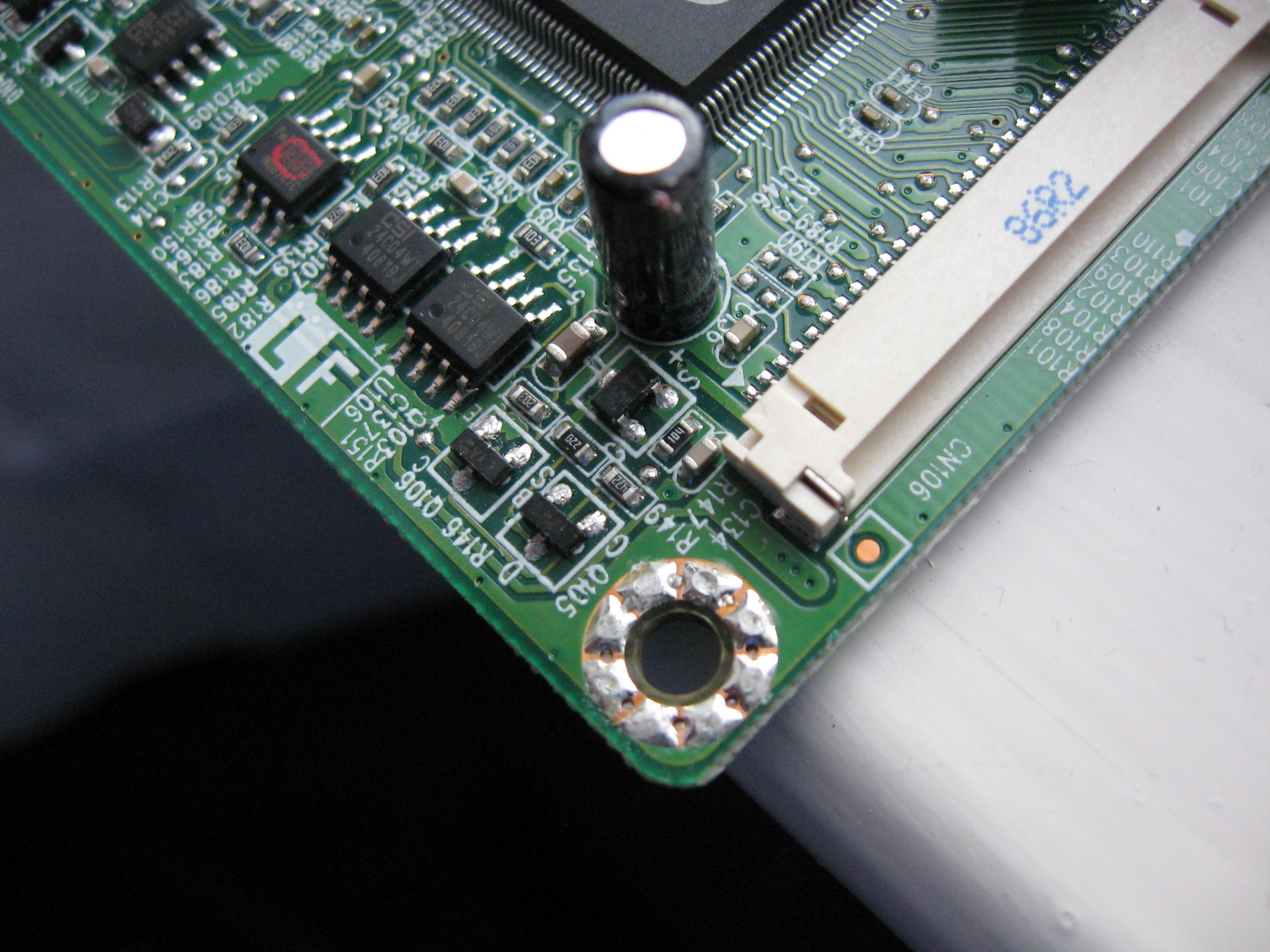

              In that case also check the MOSFET(s) on the 1907w logic board that feed the t-con with 5V.
              On the upper left corner of this picture, there are 2 MOSFETs and 1 transistor. One of the MOSFETs should be what controls the 5v rail to the t-con. So either Q405 or the one below it (I'm thinking the one below since it has thicker traces going to it). Make sure it's not open-circuited or short-circuited. I had a 17" Dell that blew this MOSFET instead of blowing the fuse on the t-con (fun!). In my case, the fault with the MOSFET was visible, though.

                Checked a couple of the fuses near the LVDS cable and found them to be good. Checked the resistance of the transistors on BOTH of the logic boards. The results follow. And a picture.
                1907w Logic Board: (Problem)
                Q105
                S-G 1.38 M
                S-D 1.4 M
                G-D 5.06 K
                Q106
                C-B 4.5 M
                C-E 4.49 M
                B-E 14.84 K
                Q103
                S-G 290
                S-D 145.6
                G-D 380
                L1908w Logic Board: (Working)
                Q105
                S-G 2.6 M
                S-D 1.68 M
                G-D 9.72 M
                Q106
                C-B 5.36 M
                C-E 5.32 M
                B-E 14.92 K
                Q103
                S-G 98.8 K
                S-D 8.93 M
                G-D 9.2 M
                None of them are shorted, and I'm assuming their ok.
                Will procede to recap once I get the parts ordered in a week or so. Looks like it might be harder to recap the logic board due to the smaller looking spots on the back of the board. Will have to be more careful where the solder goes.

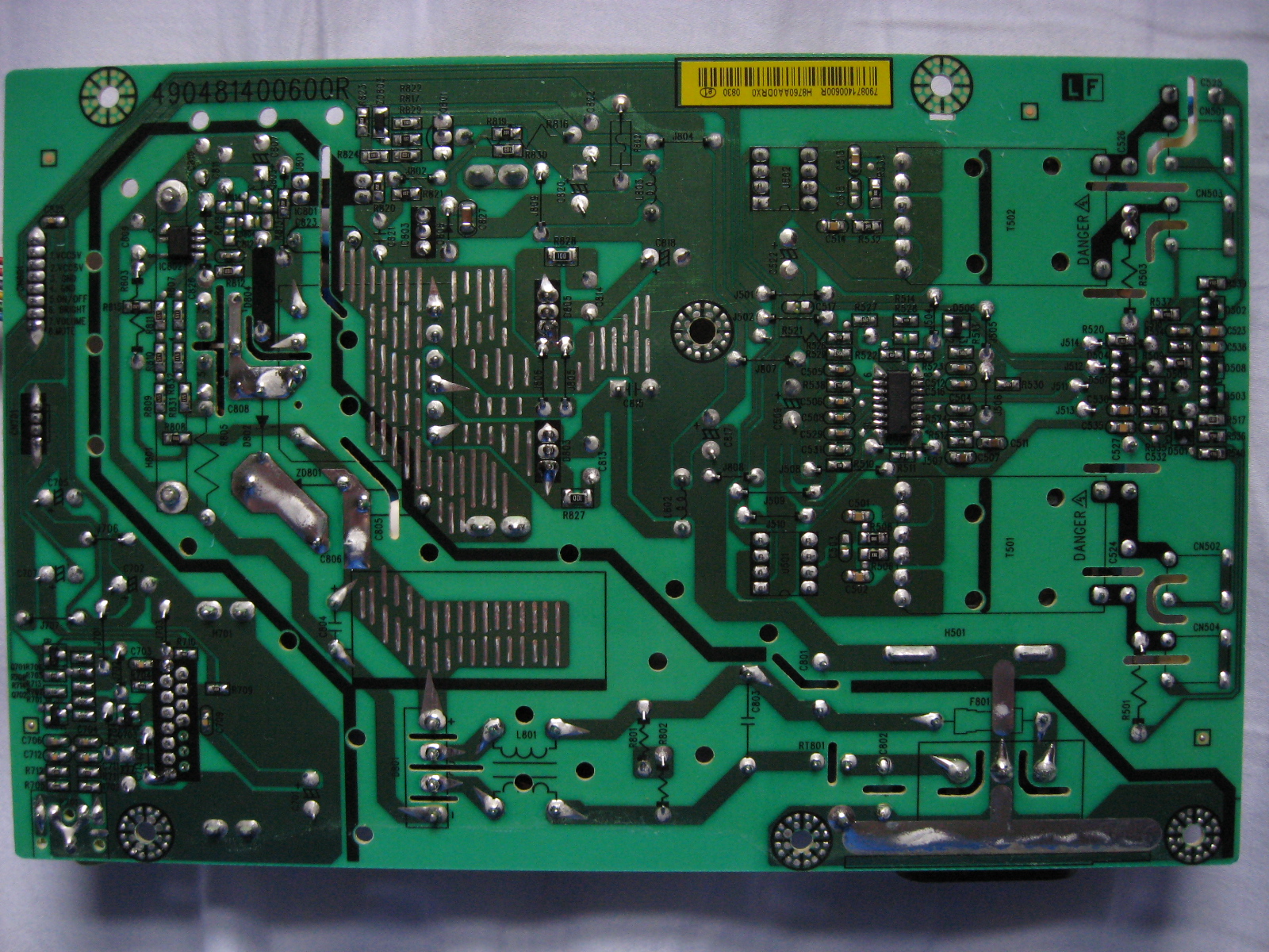

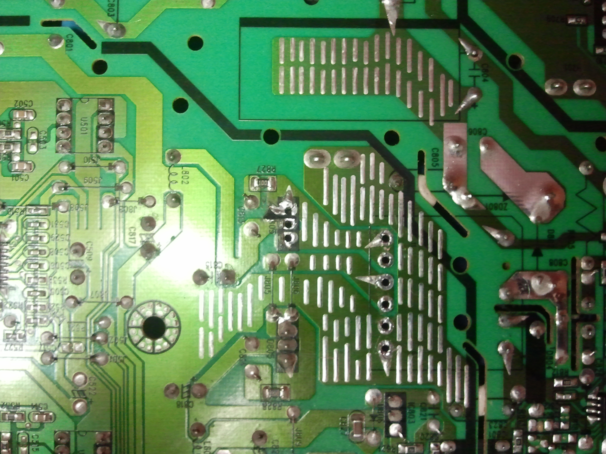

                                  The rectifier is a sp10100c , the one next to it was almost burning too last attempts to check the power board. I've tried to check voltage on transformer SPW-055 but no joy. Let me remember that i'm a beginner with electronics but i deal with electrical devices and installations every day and i'm used to troubleshoot them.
                                  Here, i'm stucked here because i don't know where to start looking at. Usually i start searching for evident failures like bad caps or solders, but this happened just after i resoldered all advised components . Please forgive too for my bad explanation as i'm not used to ask for advises on the internet and in another language other than mine. I'll do my best thou.
                                  • Rtech
                                    • Jul 2010
                                    • 1095
                                    Re: HP Monitor Mash-up
                                    Normally these Boards give very little trouble,and most problems are caused by failure of either the wiring or the Backlights at the top of the Screen.Did you eliminate these as the problem,before re-soldering erc ???
                                    I would also check where you have resoldered to ensure that inadvertantly you have not created a short circuit somewhere,it is easily done.
                                    Looking at your photo it would seem that there is some heat discolouration around U502,again this is unusual for this Board,although quite common on lots of others.
                                    After checking your soldering,and advising ref the Backlights,I suggest you diconnect J808,which supplies the Source voltage for the N channel mosfets U501 and 502,and see if your Schottky diodes D803 and D805 then still get hot !!
