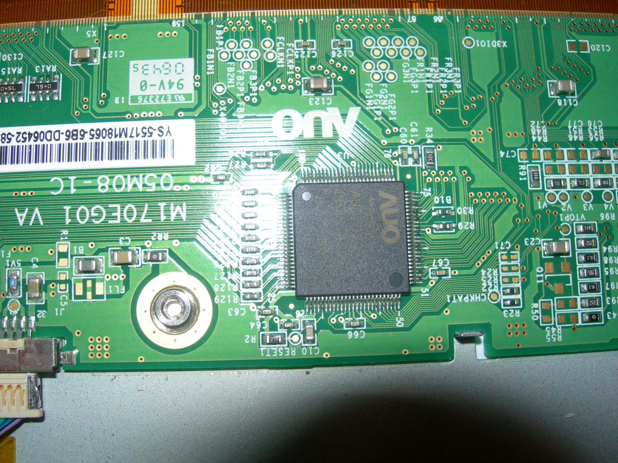

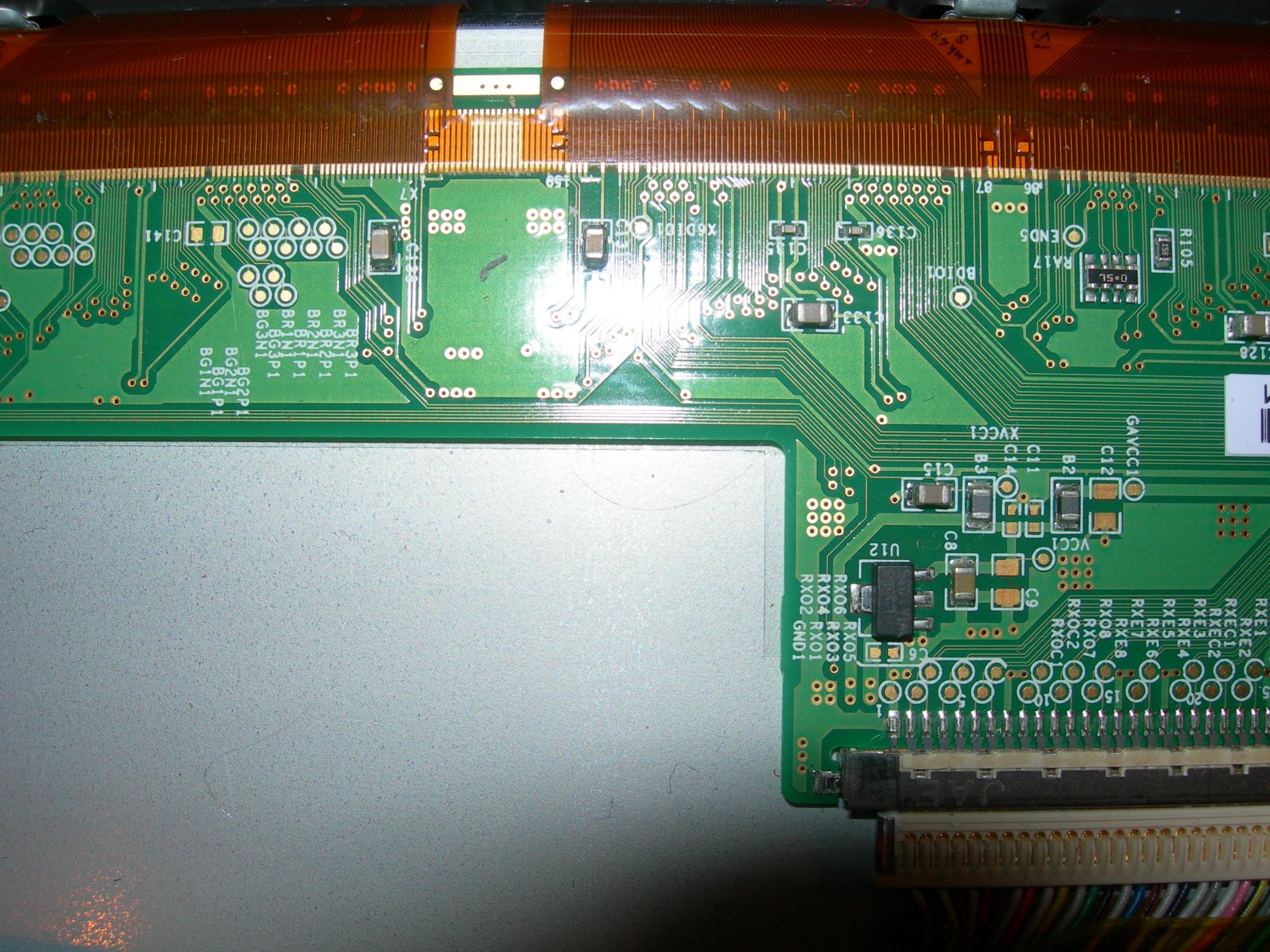

                          Detailed pics of T-con...

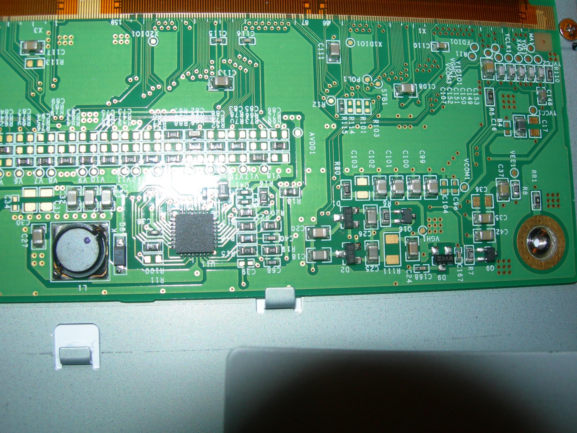

                              There we go. The first picture (this one) has pretty much all of the test points you need, so I'll use that as reference in this post.
                              The main step-up voltage rail is connected to test point AVDD1 (just a little above the center of the picture). Using your multimeter on the lowest resistance scale (typically 200 Ohms for manual ones), check the resistance between test point AVDD1 and ground. Post what resistance you get.
                              When the monitor is working normally, this rail will be typically between 9v and 15v (depending on design).
                              Next, check diode D8 to see if it's shorted. D8 is located to the right of that round inductor, L1. Diode D8 is the rectifier for the main step-up voltage rail.
                              Finally, there's the two secondary step-up voltage rails. The positive one is connected to test point VGH1. The negative one is likely VEE1.
                              Again, using the first picture as a reference, test point VGH1 is close to the lower-right corner of the t-con and test point VEE1 is just slightly above the screw hole.
                              Just like you did for AVDD1, check the resistance between test point VGH1 and ground as well as test point VEE1 and ground. Post the results you get here.
                              Lastly, should things get more complicated, write down the part number of U11 (located to the right of the round inductor). U11 is the controller for the t-con's power supply. The data sheets for these controllers usually give you sample circuits and a lot of other useful info. Sometimes, the circuit on the t-con can be very similar to the sample circuit, so it's always worth having a look.

                                Well, this monitor got put on the back burner, but I decided to have one last shot at it again.
                                I did the unthinkable, of course - I bridged the fuse with some solder. Heh, I thought the monitor may as well be scrap, anyway. So, plugged it in, and it seems like it didn't want to come on, but then the screen started flickering and it powered up but no power LED because 5V was shorted. I heard the occasional SMPS click from a shorted output.
                                Then smoke comes from one of the MLCCs. I guess that was the shorted one then... I must have missed it in my tests or maybe it was only short circuit with a higher voltage.
                                Removed it... Got a display (no signal!)
                                BUT... it's very blurred and pretty poor. And after a while, it goes away and goes white again. And the PCB got a bit... melted... from that MLCC. So I'll have to figure a way out of putting a cap on there.

                                  That shorted ceramic cap was mostly likely on the main step-up rail, AVDD1. Would have taken 5 seconds to check it with a multimeter and avoid all of that damage above... Oh well, too late now .
                                  I hope you get fixed, though. Looks like you're almost there. And at least the monitor works somewhat now.
