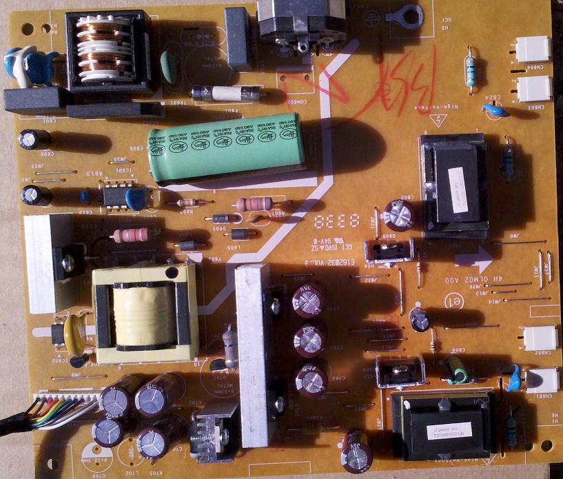

    Greetings everyone this is my first post here. I generally like to fix things myself when they go bad, but this is my first foray into replacing anything on a PCB.
    As stated in the title this is an Acer x223w, it powers on for a few seconds and then shuts off, and the power led remains on and blue colored.
    I used a flashlight while it was in this state to turn the brightness down, so the display is still visible with some extra light. I tested each set of two CCFL wires then swapped them and still achieved the same result (on, displays image, then off 2 seconds later) I then plugged in only one set of CCFL wires (blue and gray) and ended up causing a hissing and a bit of smoke from the PSB. At this point I decided to abandon testing the other three in this manner.
    The capacitors in the PSB are as follows:
    5 Elite 35v 330uf (C802, C801, C702, C703, C704)
    3 Elite but may be generic 16v 1000uf (C706, C707, C708)
    1 Elite but may be generic 10v 1000uf (C712)
    3 FAOI 50v 47uf (C611, C606, C805)
    1 Lelon 450v 120uf (C605) "the big one"
    1 Lelon 50v 10uf (C809)

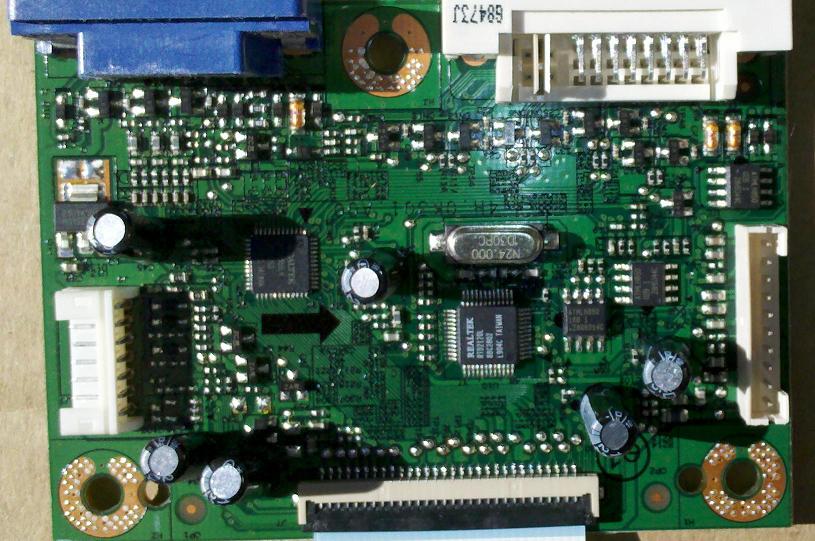

    the logic board:
    5 FAOI 25v 47uf
    None of the capacitors appear bulged or scorched.
    I do have a digital multi-meter but I am not quite sure where to actually check the voltages (on brown side of the board, green side.. which side is + etc etc.) I've perused the forums, but I'm not quite sure what to do next, since I would have to buy a decent solder station and sucker, practice, and not ruin things to replace the capacitors

    2 seconds to black can be
    a) bad caps
    b) bad inverter transformer
    c) bad ccfls
    d) bad ccfl wiring (especially the return wire)
    All are explained at
    https://www.badcaps.net/forum/showthread.php?t=10419
    starting with posts #13 and #14.

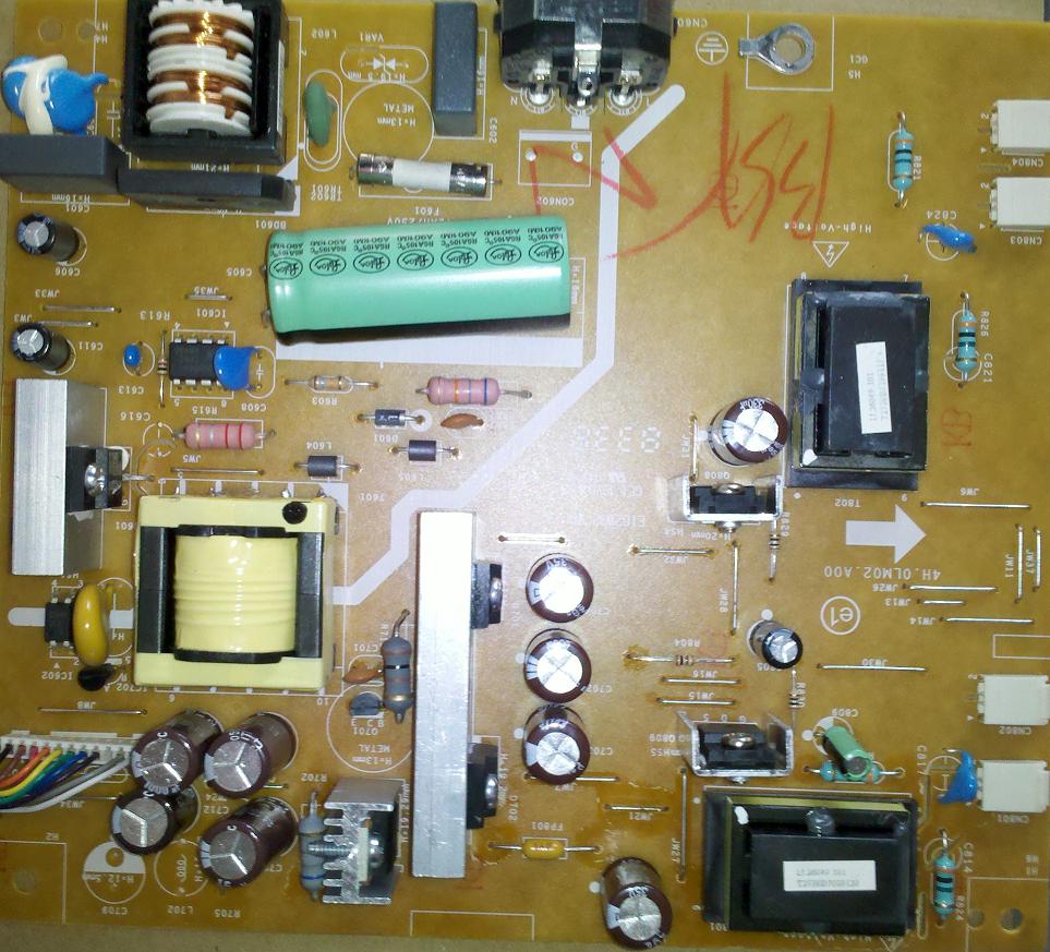

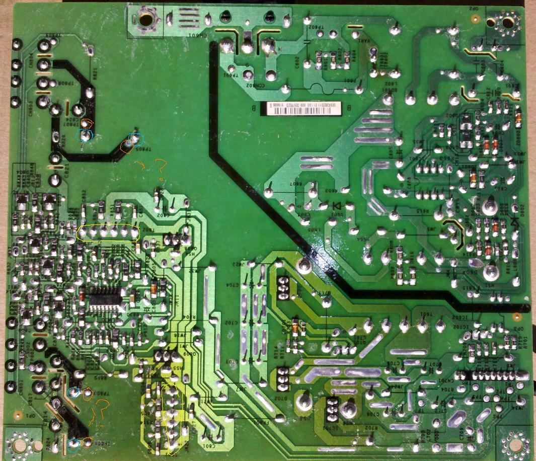

    PS. I marked what I think are your secondary inverter transformer pins. With power off and lcd unplugged, measure the resistance between red. Do the same for yellow. They should be within 3% of each other.

        A few quick newbie questions. When I am reading my DMM and it is set on 2k and I get a reading like .490 do I assume that reading is .490 of 2k ohms? (i.e. 980 ohms)

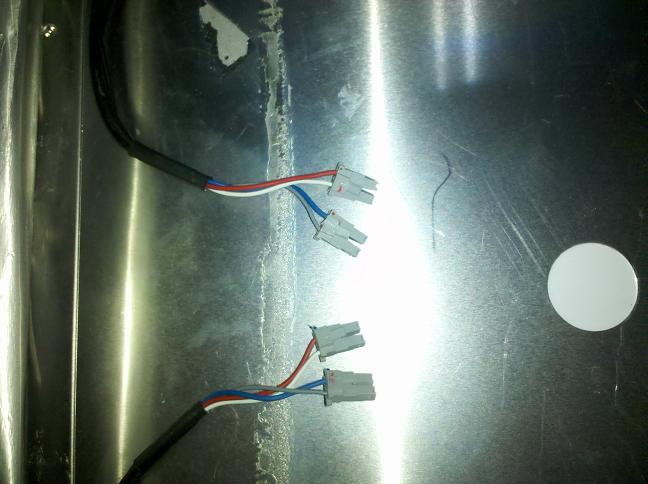

        Could someone indicate which other pins I should be testing on the transformer. It would be fantastic if I could get a markup on a picture. Attached is what I observed holds the transformer in place, but the row of pins I circled in yellow seem like just an attachment to the board.
        Judging by the wires, is this a 2 or 4 CCFL monitor? Are the red and white the "to" wires and the blue and gray the "return" wires. OR are is the red a "to" and the white a "return."

          .490 ohms on the 2k scale is 490 ohms. The dial scale (200, 2k, 20K, etc) tells you the highest unit it can measure before it displays "over range".
          The pins that I indicated earlier is all you need to measure.
          There are ccfl 4 tubes. The thick wire (4 of them) is the high voltage wire. The thinner guage wire is the return wire. The return wire may be desoldered from the end of the bulb or frayed.

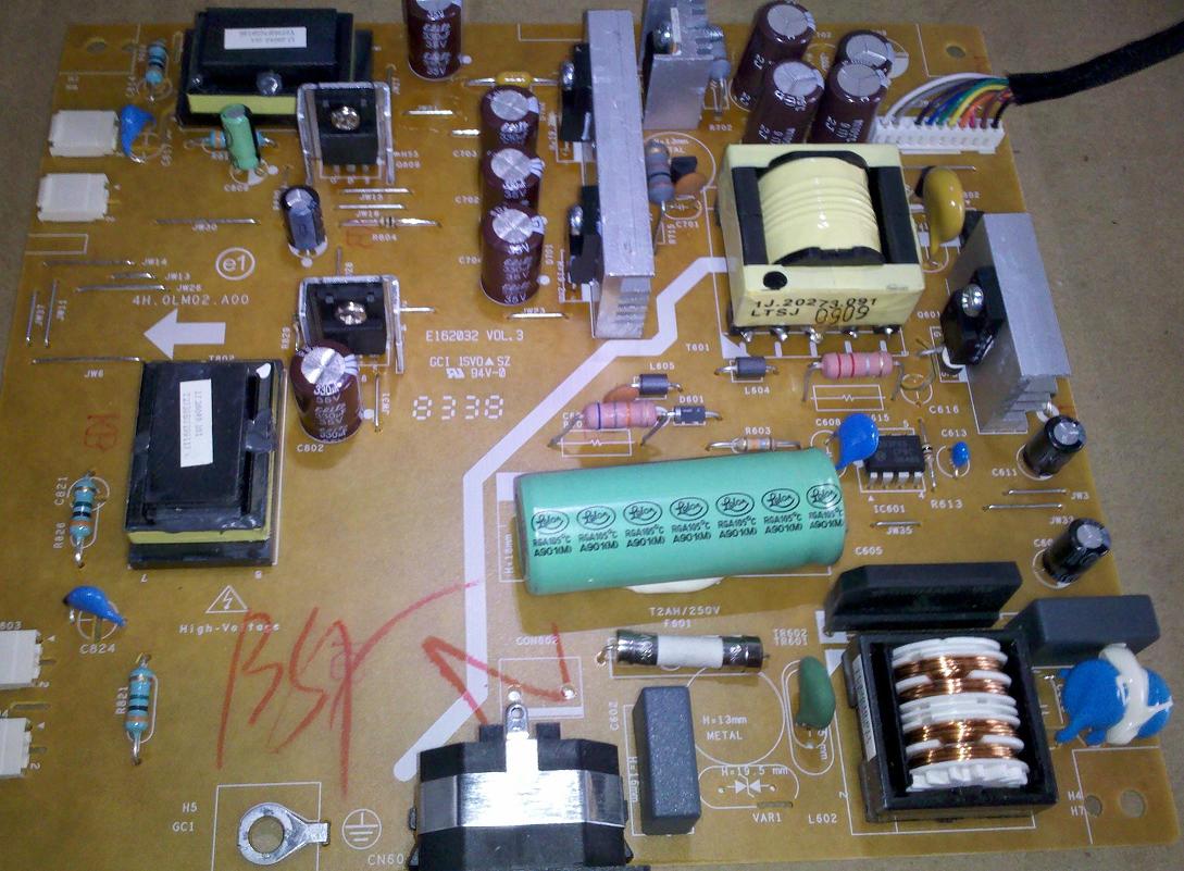

                    Update: So I noticed one of the high voltage ceramic caps what a bit discolored, so I ordered a few of those and replaced the two next to the transformers. When I tested the monitor disassembled it exhibited 3 different sets of symptoms. 1) It would work for a minute or two then revert back to the classic 2 seconds than black set. 2) it would work but with intermittent partial flashes of black screen 3) classic 2 seconds to black.
                    In all three of these scenarios, when the power was turned on and the d-sub wasn't connected it would make a slight hissing noise (sounded like it was coming from the bottom CCFL) It would also make a lesser hissing noise while it was on and working in scenario 1.
                    To recap what has been done:
                    All electrolytic caps + 2 ceramic caps on the power board have been replaced.
                    CCFLs/wiring have been tested
                    resistors, diode, fuse, transistors, inverter transformer have been tested.
                    Two of the thin circuitry strips attached to the contact points were lifted slightly in the removal of two caps, When i put the new caps in, the contacts seem to come back down flush with the board.
                    Should I investigate the video board?
                    I don't think I have much more patience with this monitor.
                    Thanks in advance for any replies.
                      Re: Acer X223w turns on a few seconds then shuts down.
                      On several occasions when I have had monitors with the high voltage caps that were damaged by the inverter transformers, I have found faulty wiring on the HOT wire connected to the CCFL. Is the hissing noise coming from the area where you had to replace the high voltage caps?
                      Dose one transformer appear to be running hotter than the other?
