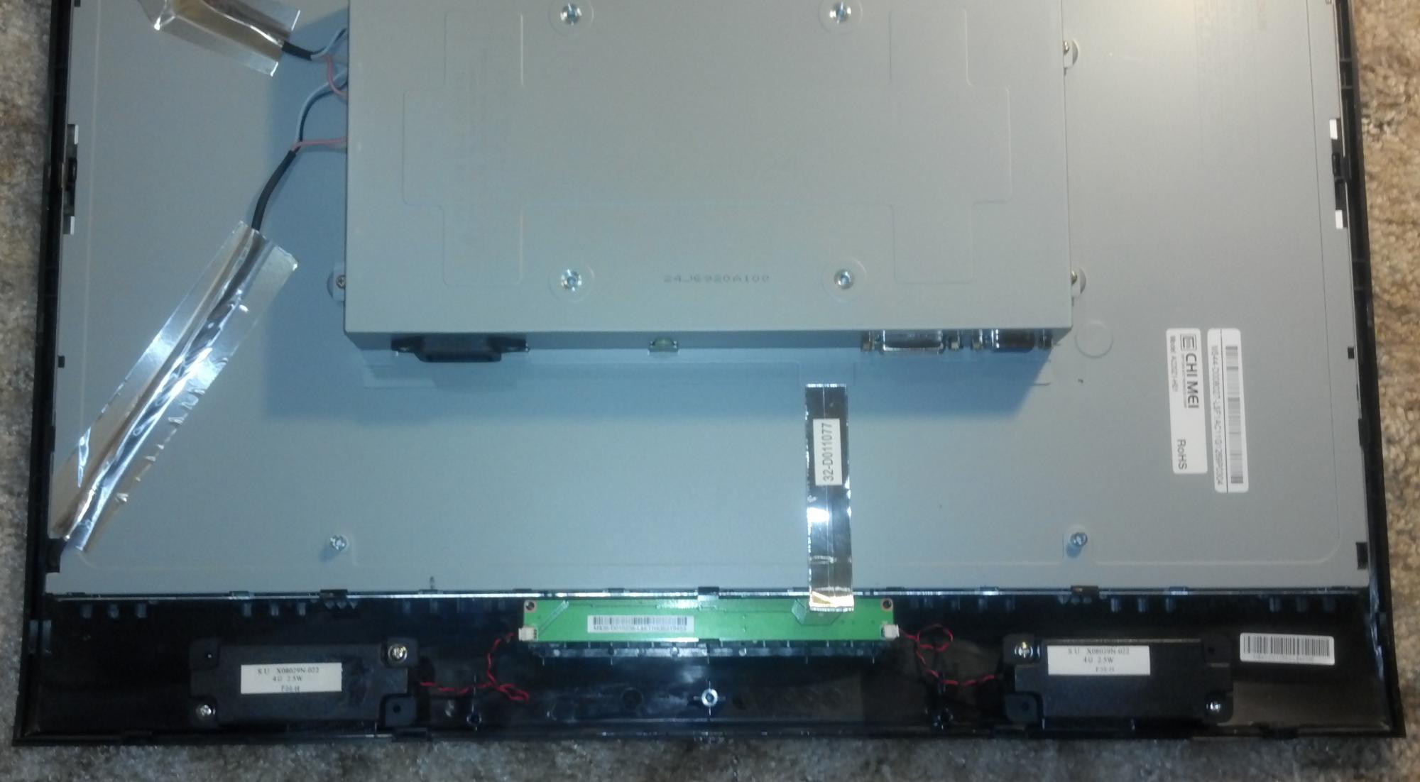

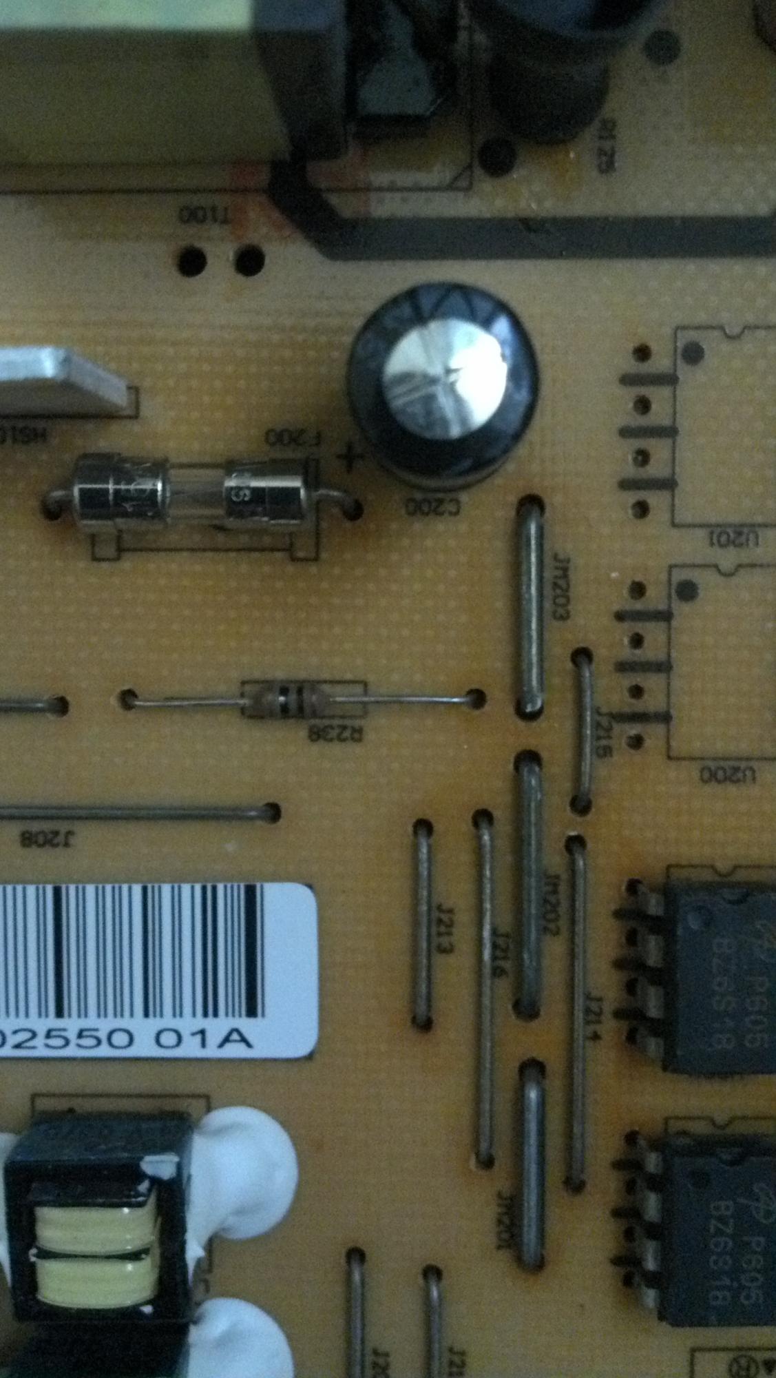

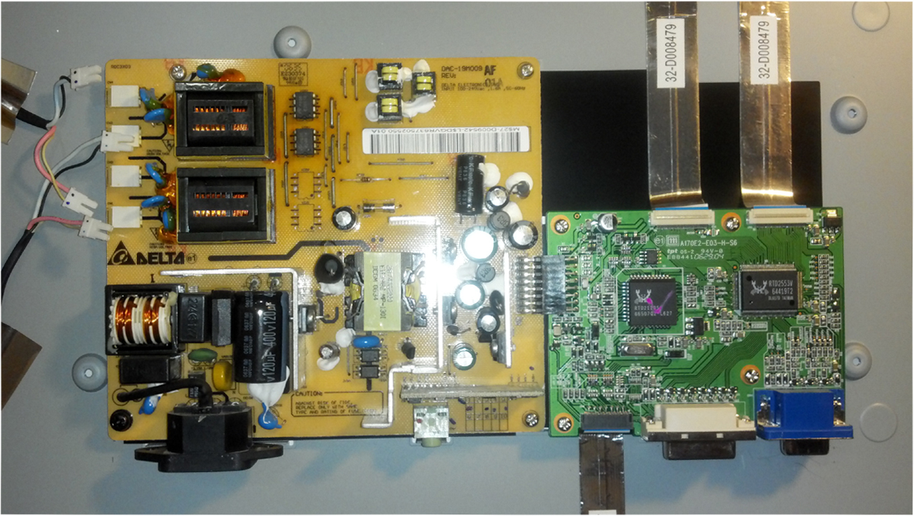

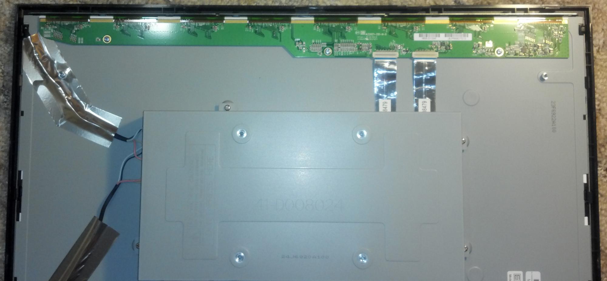

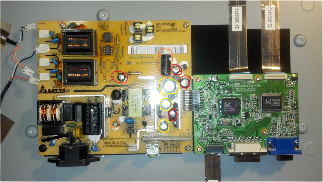

      attached are the screenshots of the full monitor, top and bottom, plus the circuit board/power supply. thank you!
        Re: ViewSonic VX2235wm...
        Even with the flash, I can see at LEAST 4 bulged/domed caps. Since 4/9 failed (or almost 50% failure rate), we recommend replacing ALL the electrolytic capacitors except the largest one which rarely, but not never, fails.
          Not exactly what I asked for, but good enough that some problems are obvious.
          Caps circled in red. Definitely bad, replace.
          Caps circled in orange. Could be bad, replace.
          Caps circled in yellow. Not visibly bad, but it would be a very good idea to replace them.

                        i've replaced 3 small capacitors successfully and the screen doesn't give me problems anymore. i still have 2 more to replace of which i couldn't find at the store and need to be ordered, but i want to thank everyone who helped me resolve this issue. you guys are the best!
                                      Here is the original caps list for this one.
                                      It has Power Board: Delta: DAC-19M009-AF, REV: 01A
