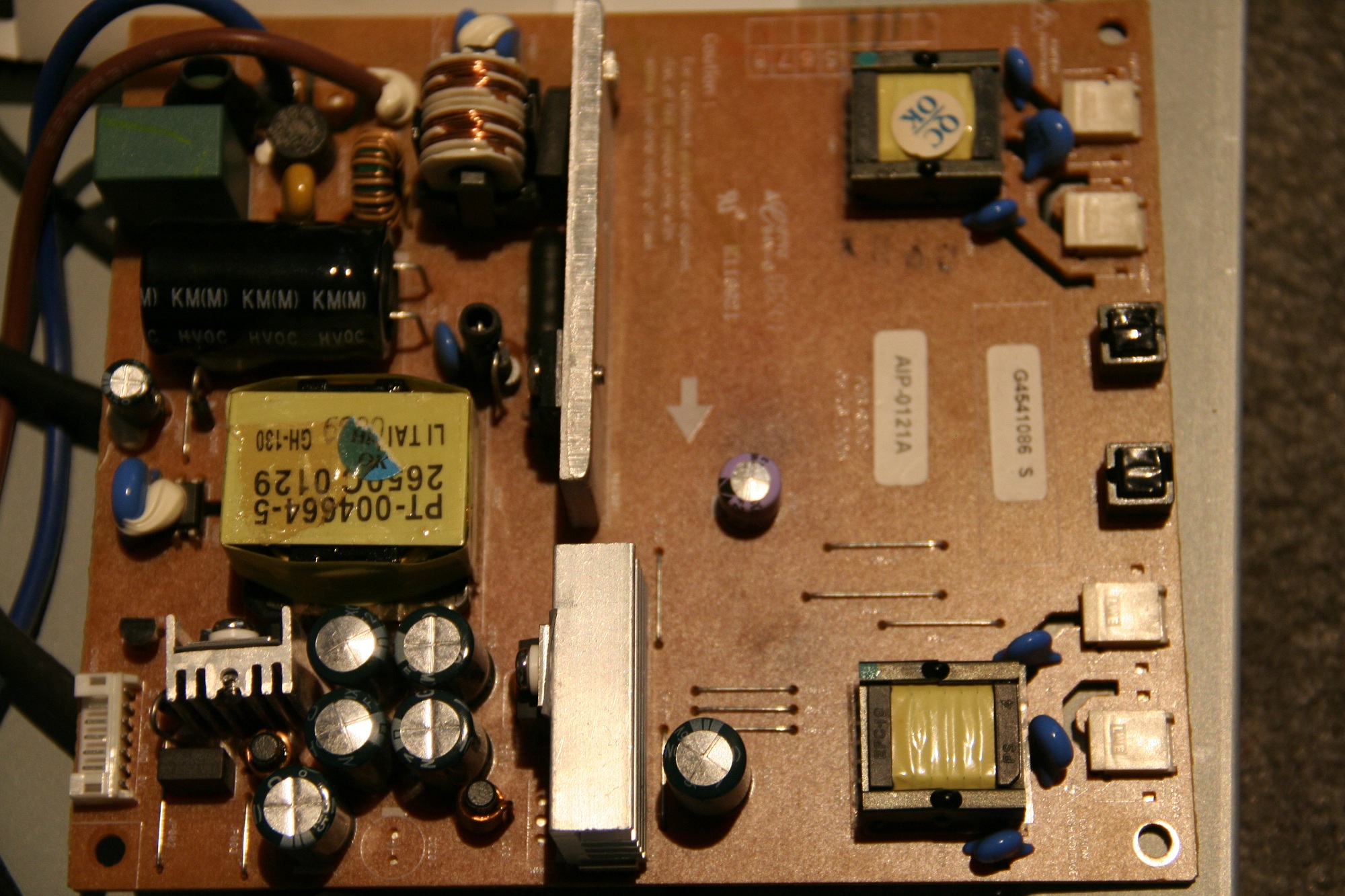

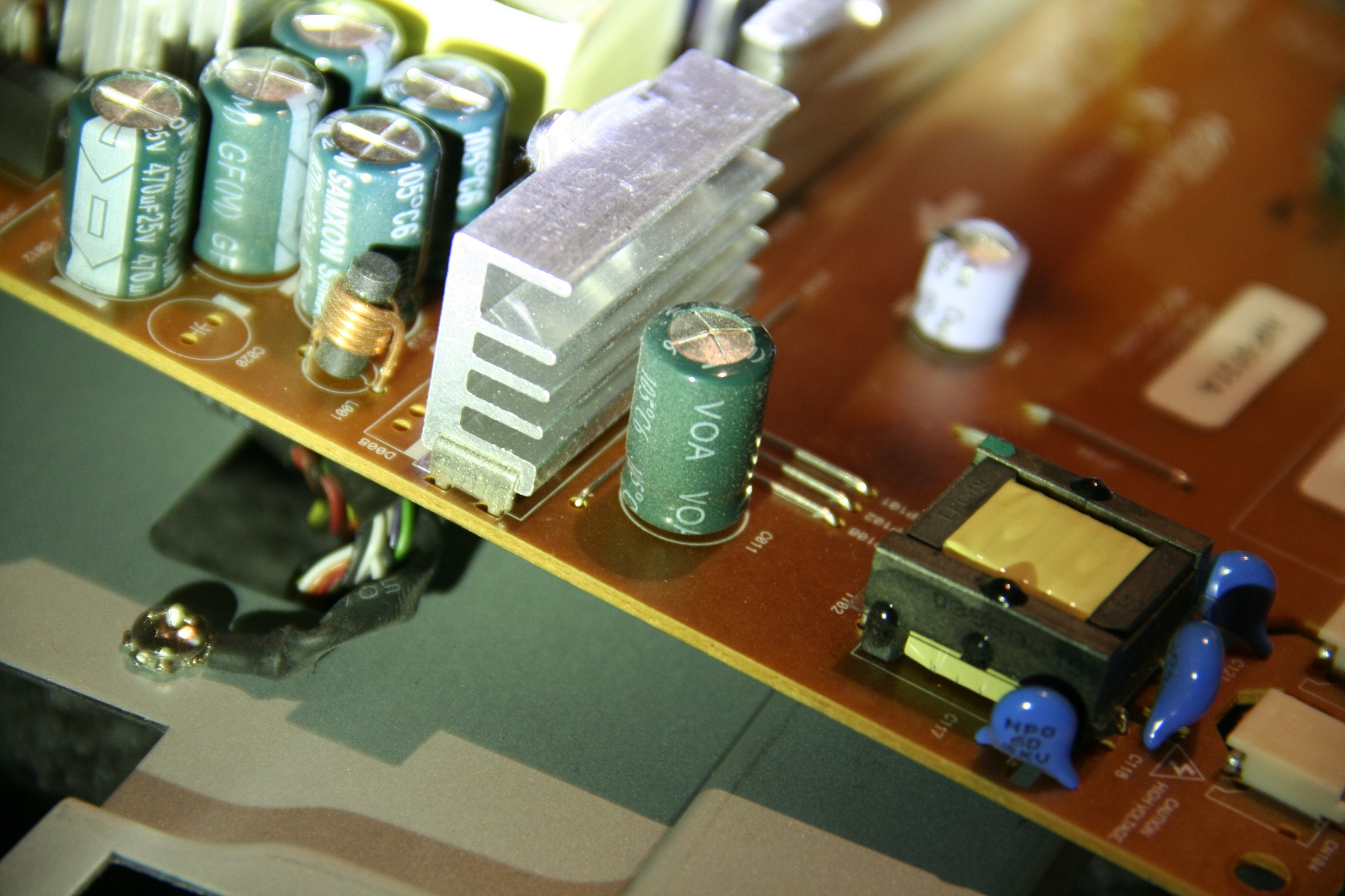

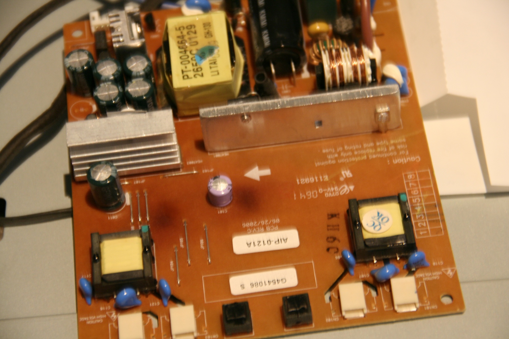

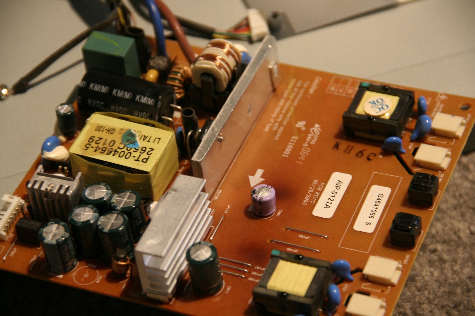

    When waking up in the morning I usually have to find something to do for 30-1hour before the monitor turns on. It started happening about a 3-4 weeks ago. The power light for the monitor will constantly flicker on and off but without showing anyscreens. I have taken it apart to find 3 of the 6 Samxon 470uf 25v capacitors were bulged, and the little Samxon 150uf 25v was bulged aslo. Near the 150uf 25v is two brown spots as if there has been some burning or something. When the monitor does decide to turn on it works perfectly with no hiccups.
    Since I'm no pro, would I be able to find these capacitors @ my local Frys Electronics or would I have to order them off badcaps/ other retailer? How easy would It be for me to replace these myself without having much experience at all?
    ps: I've looked for the 150uf 25v on badcaps and it seems to be non-existant
    Amateur pictures.

    Frys will probably not work, they probably sell general purpose capacitors, which are often not good enough.
    Since you're in US, I recommend digikey.com
    150uF 35v : http://search.digikey.com/us/en/prod...2408-ND/613769 (yours is rated for 25v, 35v works as well)
    Can't tell the series from the pictures, but it's not like you have much choice and the one above is a good brand with good specs for the series.
    CapXon GF series 470uF 25v is 10x16 mm , 1415mA ripple, 42mOhm impedance
    Any of these should work great but pay attention to the height, some of these are 20mm tall - it looks like you have the room as the transformer seems taller in the pictures.
    http://search.digikey.com/us/en/prod...2415-ND/613776
    http://search.digikey.com/us/en/prod...1694-ND/756210
    http://search.digikey.com/us/en/prod...2388-ND/613749
    http://search.digikey.com/us/en/prod...441-ND/2433575

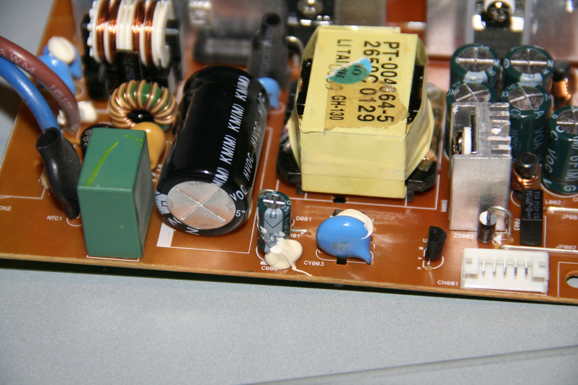

    ps.. replace all six 470uF at the same time, there's also a capacitor near the big black KM series capacitor that seems to be smaller than those 470uF capacitors... look around the transformer for a smaller capacitor that's probably around 22uF-47uF and might be worth replacing as well.

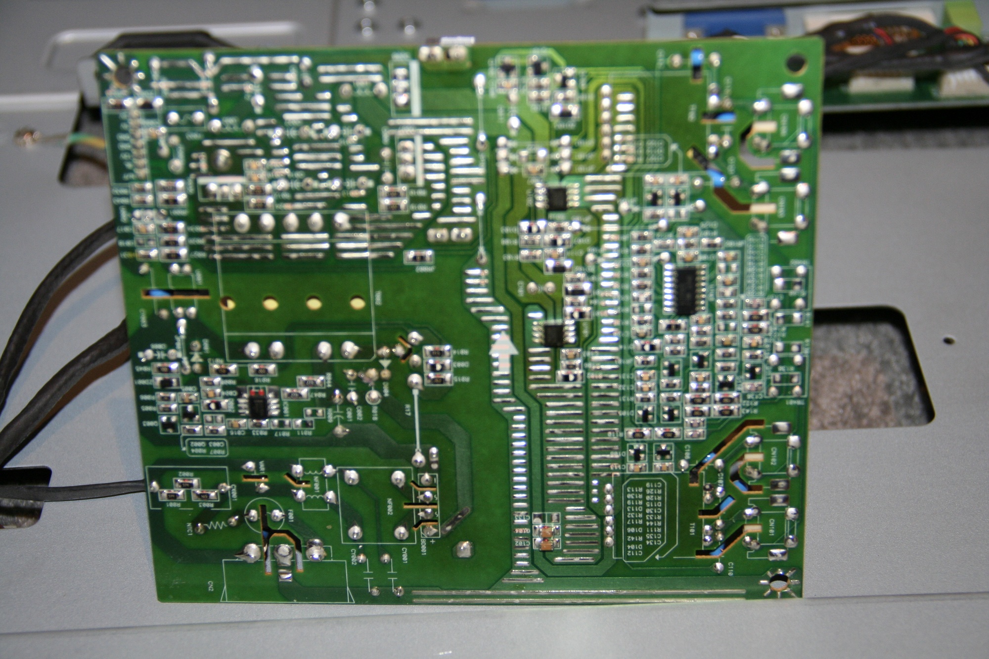

    ps2. wouldn't hurt to post some pictures with the back of the board and one picture straight from above the board without flash just in case there's something else with that monitor going on... use the manage attachments function (in advanced mode edit, click go advanced below)

      Frys is unlikely to carry/sell low ESR capacitors which are required in a SMPS application.
      You can buy them at badcaps.net, digikey.com, or some other equivalent online distributor.
      Members here like Panasonic FR/FM series in addition to
      https://www.badcaps.net/forum/showthread.php?t=2280
      There are a number of excellent soldering tutorials including
      https://www.badcaps.net/forum/showthread.php?t=485
      http://www.youtube.com/watch?v=I_NU2ruzyc4
      can't add as attachments because I don't want to re-size for quality purposes.
      For many reasons including imageshack's annoying redirection to partypoker.com, I will NOT look at offsite images. Other people have loaded excellent focused pictures with resolution less than 2000x2000.

        Re: Sceptre Naga 20.1' monitor
        Will post more pictures and try to resize them,
        @Mariushm the back capacitor near the black one is a 47uf 25v
        Will take pictures with back of the board.

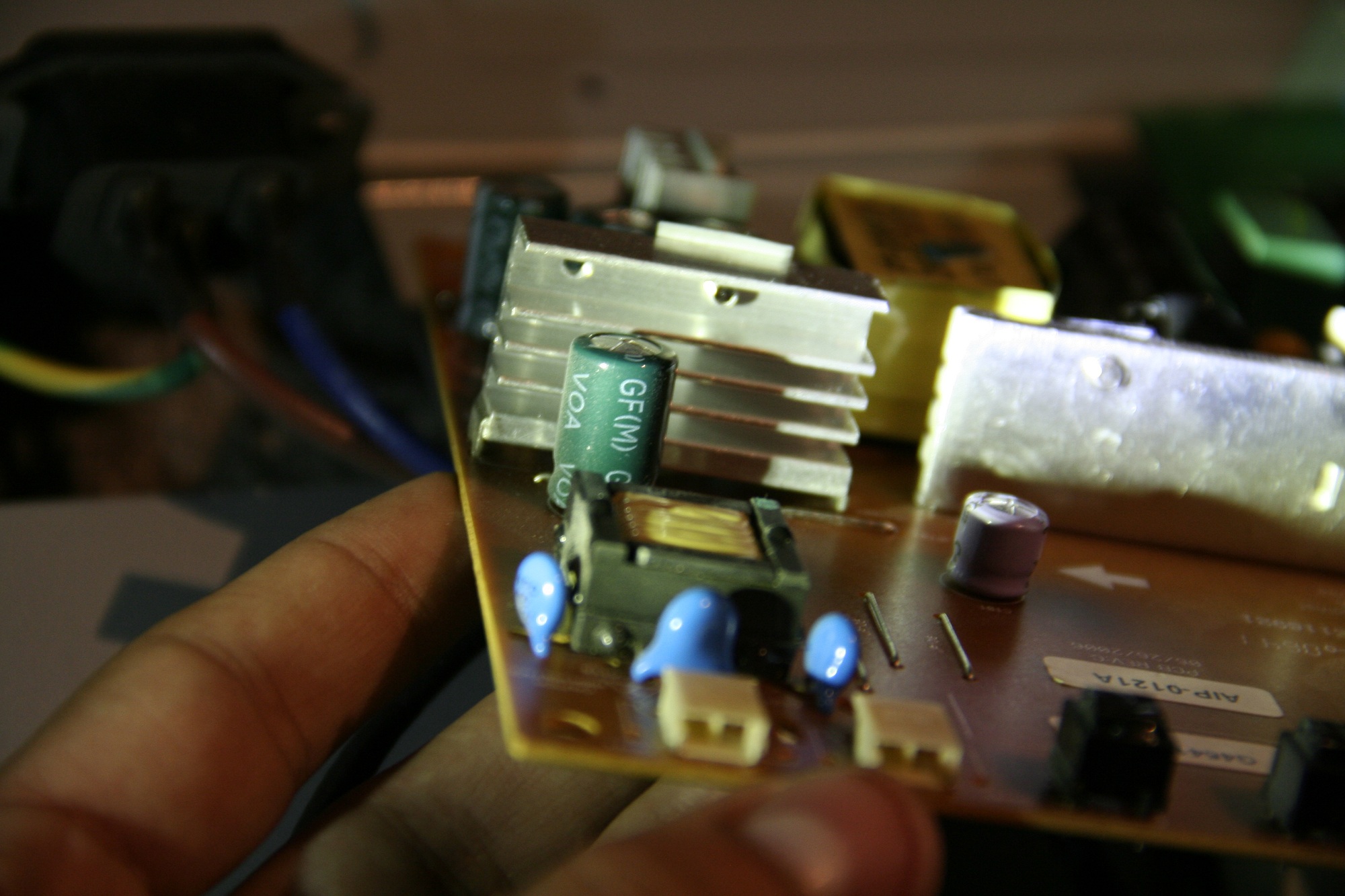

          updated couple more pictures.
          Should I replace the 47uf 25v capacitor in the back as well?
            Members here suggest replacing ALL the electrolytic capacitors except the largest one which rarely, but not never, fails.
            The 47uF 25V plays an important part in the SMPS startup process so definitely replace it.
            Samxon GF (your green caps) are a problematic series. They die after 2 or 3 years due to heat. I have replaced a few of them in lcd monitors.
