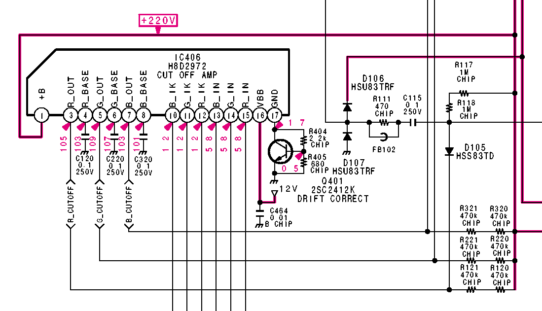

            Re: Dell P1110 21" CRT repair thread
            Haven't kept you up to speed with the news, have i? A while back i got a P1130. It only had the excessive brightness issue, after adjusting with WinDAS everything is fine. As opposed to my P1110, it didn't do the whole "start up bright then slowly drift back to normal" thing. And by slowly i mean slowly - the darn thing took over 2 hours for brightness to stabilize, and if the computer went idle and turned the monitor off, then it would do the same thing over again. The P1130 worked normally after i adjusted the G2. Interestingly, the P1130 got a G2 voltage of almost 100 volts above the P1110 for the same brightness range, and i started to dig further.
            Turns out there was a little difference in the video circuitry of the P1130 (built in 2003) as opposed to the P1110 (built in 2000). Attached you will find the relevant portion of the schematic of the P1110. Take note of pin 17 of the cutoff amp, with the funky self-biasing transistor circuit. Someone had analyzed the circuit before and it turns out it was some kind of thermal compensation, but noted that it does affect brightness. Well, compensation or not, the P1130 didn't have this, and instead connected pin 17 directly to ground. It also didn't have the brightness drift issue.
            So, connecting the dots, i bypassed the drift correct thingy on the P1110. The brightness got significantly lower, i had to adjust G2 value with WinDAS again. The new G2 voltage for the P1110 was almost identical to the one the P1130 wanted. And... NO MORE BRIGHTNESS DRIFT!!!! I can finally have a proper monitor. Well, in fact, now i have two proper monitors.
            Now, some might wonder what was the circuit doing there in the first place. Well, i think i got an answer for that. As you know, vacuum tubes take a while to warm up, and CRTs are no exception. A CRT monitor starts up dark and takes a few minutes to warm up and get to normal brightness. What Sony wanted to do was to eliminate this warmup period, so they put that little transistor that shifts the cutoff amp's bias point during this warmup of the tube, so the brightness starts up at nominal levels from the get go.
            At least that's the theory. And it probably even worked when the monitor was brand new. But apparently the bloke who put that little transistor in there forgot to factor in the aging of the tube... and thus the circuit ends up overcompensating, causing the brightness drift i mentioned above. A monitor that takes 5 minutes to brighten up is lots better than one that starts up over bright and takes two hours to get to normal. Plus given its position on the board, i cannot possibly understand how that transistor could have ever sensed the temperature of the tube, or even of the video amp for that matter... No wonder it got removed in the following version.
            Anyway, there you go. If you ever see one of those, now you know how to fix it. IIRC lti had a Sony Trinitron with the same brightness drift issue, get to work already man!

                  Very interesting find, Th3_uN1Qu3!
                  Since I have some Sony CRT monitors as well, I decided to check the schematics of their A-boards and here's what I found:
                  My 21" 1998-built Dell D1626HT doesn't even have a cutoff AMP IC for the RGB. Instead, it has a separate transistor/op-amp circuit for each. So I'm not sure if this incorporates such a drift correction circuit. See lower-right corner of attached picture.
                  On the other hand, the Sony GDM-FW900, does have this drift correction circuit. In fact, the cuttoff AMP is the same as yours. Heck, even that portion of the schematic you posted is exactly the same as the FW900's - same part numbers at the exact same locations with the exact same board numbers. I think I will grab me a copy of the P1110 schematic. I still need to find a flyback for that other GDM-FW900. I doubt the P1110 will be compatible, but I'm still curious to see how much in common they have. Last month I saw 2 of these P1110 CRT monitors on Craigslist here.

                    By the way, my D1626HT has good colors, but the contrast seems a little weak - that is, if I want bright whites, I have to turn up the brightness. But then the blacks become washed out. And if I turn down the brightness so I get nice deep blacks, then my whites are a bit dull. My contrast and color bias/gain are turned all the way up. Does this sound like a G2 issue? Or old tube, perhaps? I have somewhat corrected this issue by turning up the gamma through software. Colors are still not as vibrant as my older 17" Dell D1025HTX, though.
                    Check G2 voltage as per your service manual. Probe before the resistor that feeds it to the tube (otherwise the impedance of your multimeter will have an effect and the reading will be inaccurate).
                    If the picture is otherwise correct (no color issues, no trailing shadows or things like that), i'm guessing aged tube though.
                    Btw, i'm currently developing a method of thermal compensation involving the CRT itself - my P1110 still takes 15-20 minutes to warm up and 30 minutes to fully settle, and this is entirely due to the thermal dependence of the tube. The method i've devised should allow for <5 minutes warmup time, and uses a minimum amount of parts. It will control G2 voltage based on tube temperature, and will be done with a NTC thermistor placed on the tube neck and either a small micro (easier to set up) or just a couple trimpots (simpler, but takes a longer amount of time to tweak). I'm partial to the microcontroller solution, i have a couple PIC12F675s lying around doing nothing, and it's easier to touch up, as the percent of brightness drift over temperature will vary with the age of the tube.
