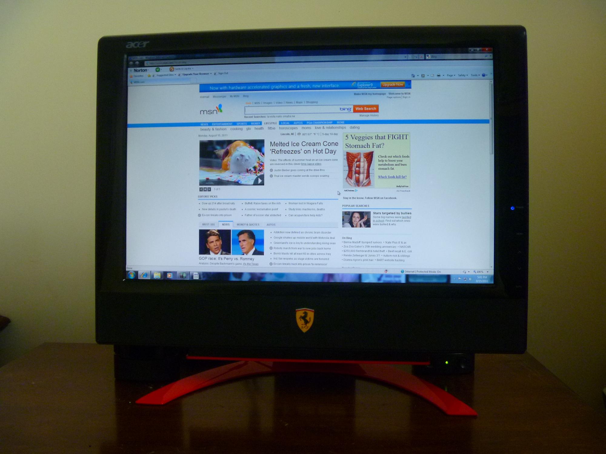

    I just pick up Acer Ferrari F-20 monitor but is missing inverter, I check online but can't find the inverter parts # and Acer Ferrari F-20 monitor Service Manual
    Any one know the inverter part # or Service Manual please repost at my thread?

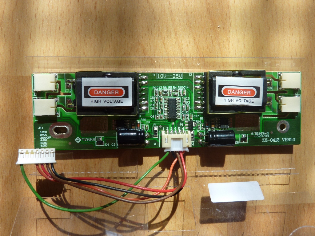

    Have you checked into using a universal inverter? I used one to fix an X2Gen 19" monitor that was missing the inverter some time ago. I ordered through e-Bay from either Hong Kong or the Czech Republic and it arrived in about 2 weeks.
    There are several choices depending on size available for the inverter, mounting, 5 or 6 wire supply, and 2, 4, 6 lamps, etc. You will need to verify the voltage output to the inverter to make sure that it would work for your particular monitor.
    Here are a couple of examples that might work for you:
    http://cgi.ebay.com/PC-LCD-MONITOR-S...ht_3184wt_1396
    http://cgi.ebay.com/ZX408-4-lamp-CCF...#ht_621wt_1396

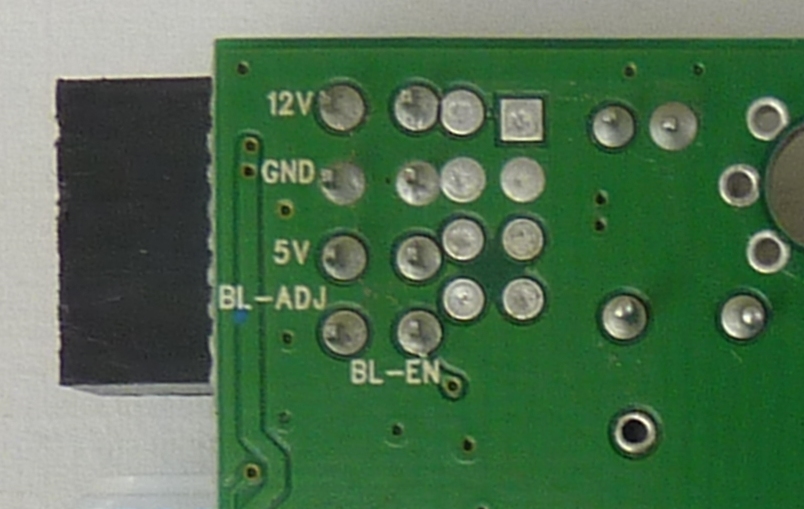

        The outputs of the pins may be listed on the PCB (sometimes front, sometimes back) or you might be able to plug it in and measure the voltage of each pin of the 6-pin connection.

            I was referring to the silkscreen designations on the PCB that might tell you what voltages are for each pin. See the attached photo as an example.

              It's really easy
              Locate the 12 volt feeds to the inverter with your voltmeter.
              Locate the ground wires either with the voltmeter or ohmmeter.
              Find the backlight on signal it's usually around 3 volts, when there is a signal going to the monitor
              This will most likely go to 0 volts when you remove the VGA cable from the monitor.
              The other important voltage is going to be the dim voltage; this varies from around 3 volts full brightness and down towards 1 volt when you dim the monitor.
              These can all be located with a voltmeter
              LCDPARTS.net gives a really good explanation Just look for their universal inverters section instructions

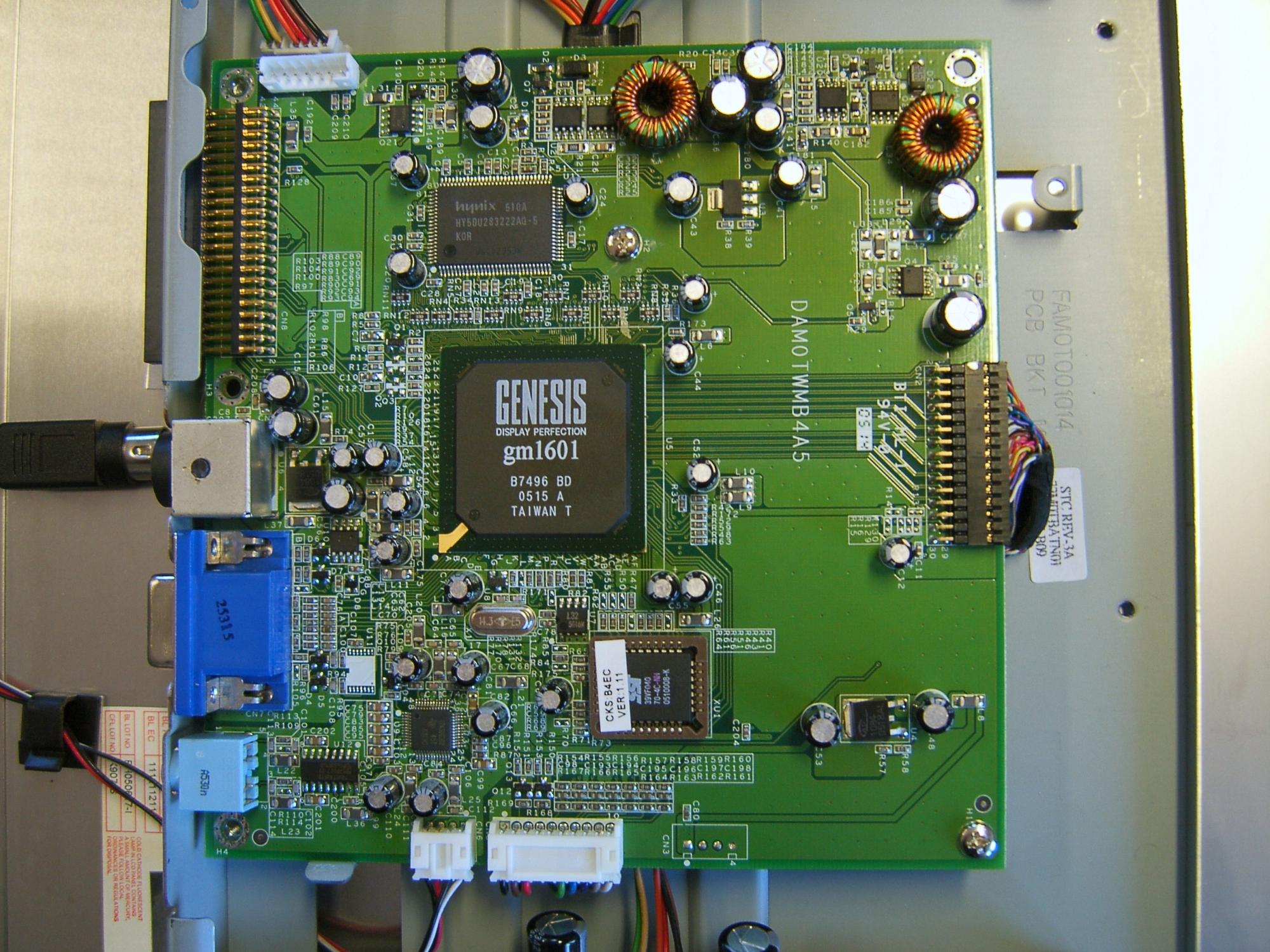

                          If is the F-20 and AL2032W are the exactly same monitor I already get Service Manual
                          I find AL2032W T/S
                          https://www.badcaps.net/forum/showth...t=Acer+AL2032W

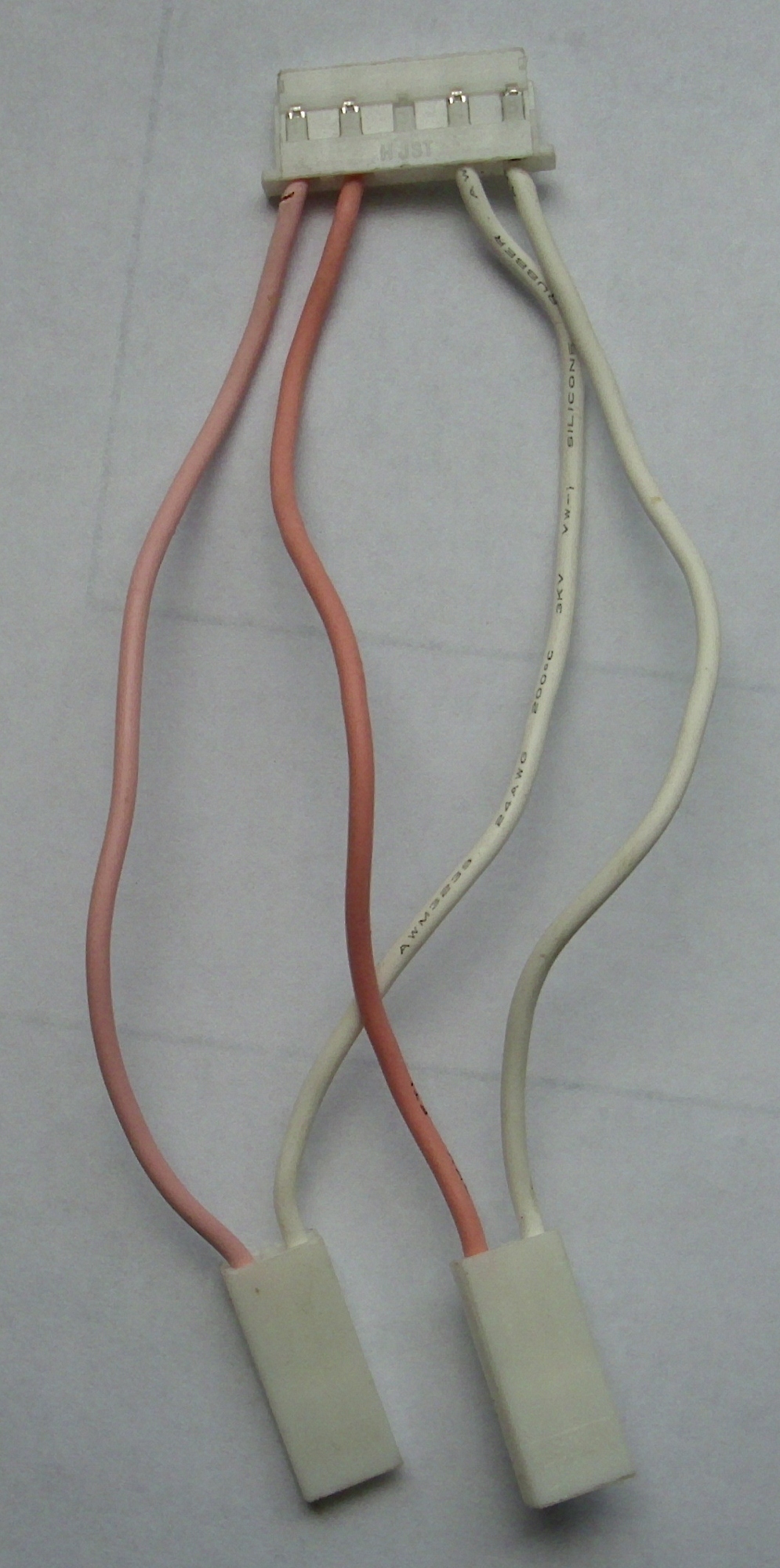

                          But I not understand on AL2032W inverter had 6 quick disconnected to backlight lamps you can see 2 wide quick disconnected for 4 lamps & beside had 2 small quick disconnected for 2 another lamps

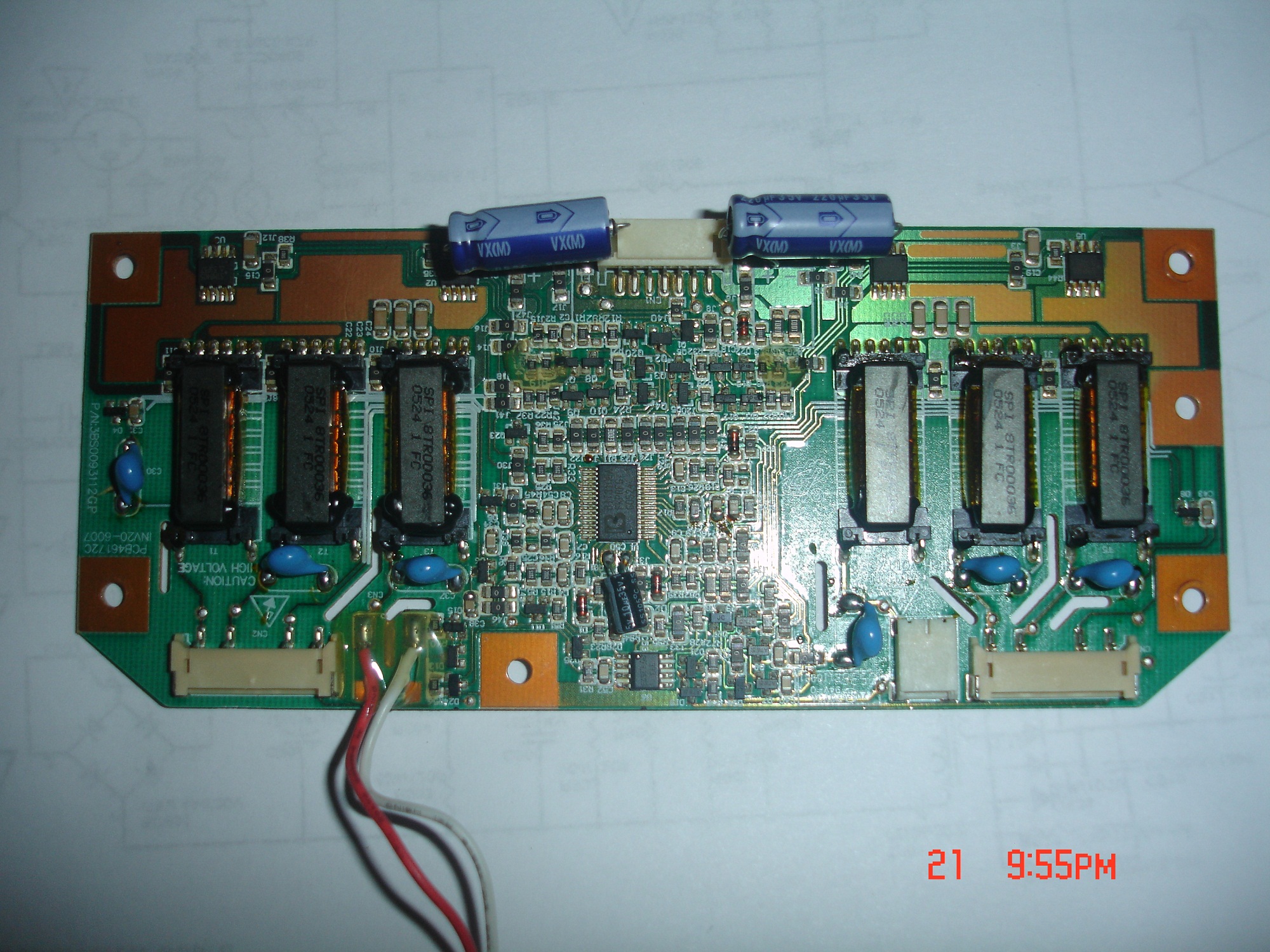

                            Dose this picture help?

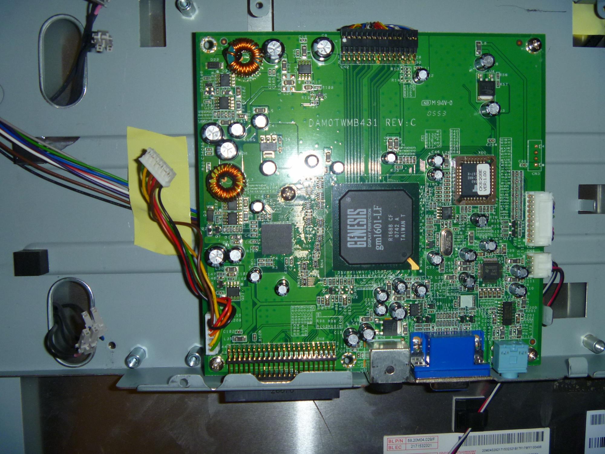

                              I already had this but my question is F-20 just had 4 lamps & AL2032W look like had 6 lamps is will work on F-20?
                              Another quesion why my F-20 use DAMOTWMB431 mainboard and AL2032W use DAMOTWMB4A5 mainboard at looking is almos the same but why they do not math parts #

                                Finally I get Acer Ferrari F-20 monitor working
                                Here the color code for
                                At CN1 connect from pin 1 to 7 at mainboard
                                pin # 1 (green) & 2 (Yellow) is +18 VDC
                                Pin # 4 (light brown) & 5 (red) is Ground
                                Pin # 6 (Brown) Dim
                                Pin # 7 (Black) on/off
                                  Re: Acer Ferrari F-20 monitor
                                  I find inveter from another LCD monitor & install today now Acer Ferrari F-20 monitor is working
                                  Here the pin & color code for Acer Ferrari F-20 monitor from mainboard
                                  Pin # 1 (Green) & 2 (Yellow) is + 18VDC
                                  Pin # 4 (Light Brown) & 5 (Red) is -0VDC or ground
                                  Pin # 6 (Brown) Dim
                                  Pin # 7 (Black) On/Off
