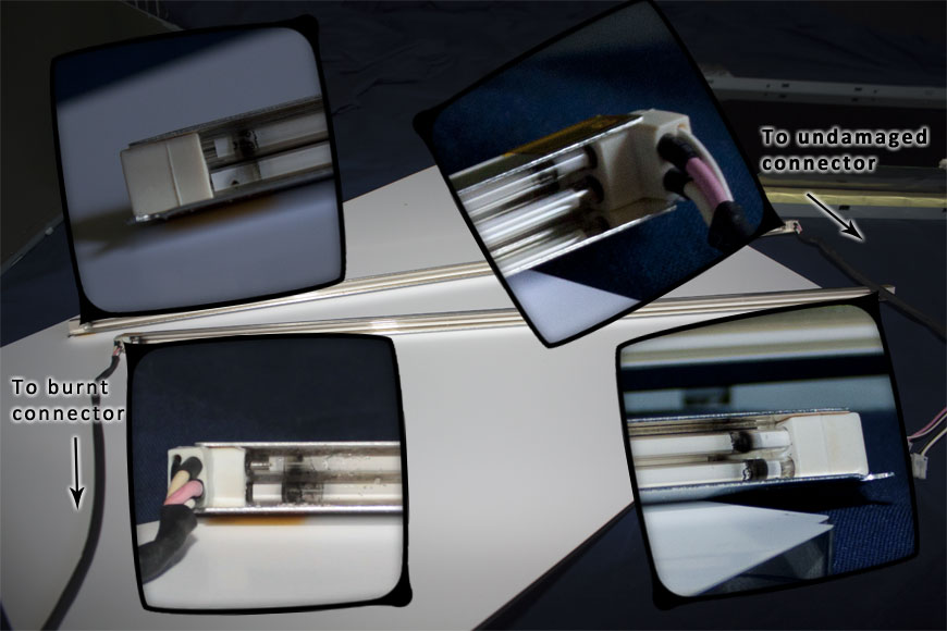

            Ok, tore all the way through the LCD and backlight assembly. Very fascinating!
            All four CCFL's look a little black towards their ends. However, the pair of CCFL's with the damaged power connector were at least twice as dark as the other pair.
            Do these look like they could be the cause of the problem?

            • PlainBill
              • Feb 2009
              • 7034
              Re: LCD monitor: burn marks in backlight connection
              Not directly. This looks like normal aging. At end-of-life a CCFL starts drawing MORE current. The problem was due to a CCFL drawing too little (or no) current. I'd suspect a broken lead or bad solder joint on one of the CCFLs is responsible, or possibly a broken CCFL.

                The picture isn't high enough resolution to tell, but the bottom two look like they're cracked.

                  Agree with Bill, but because it happened suddenly, BOTH connectors are charred, and the monitor was moved, I'd suspect physical damage to the 2 CCFL bulbs involved.
                  I suppose both connectors could have been jarred slightly loose, or wiring damage on both, but pretty unlikely given the circumstances.

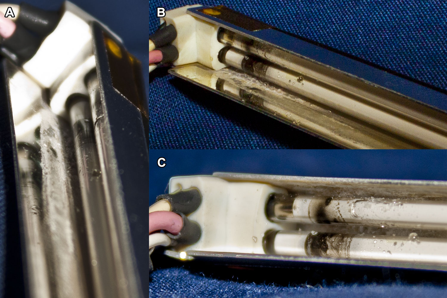

                      In the meantime, here are some closer shots of the suspicious CCFL.
                      Good eye jsog, it does look quite like a crack.
                      Also, there is a white/gray-ish residue along the bottom of the shiny metal piece (can be seen in photos A and B).

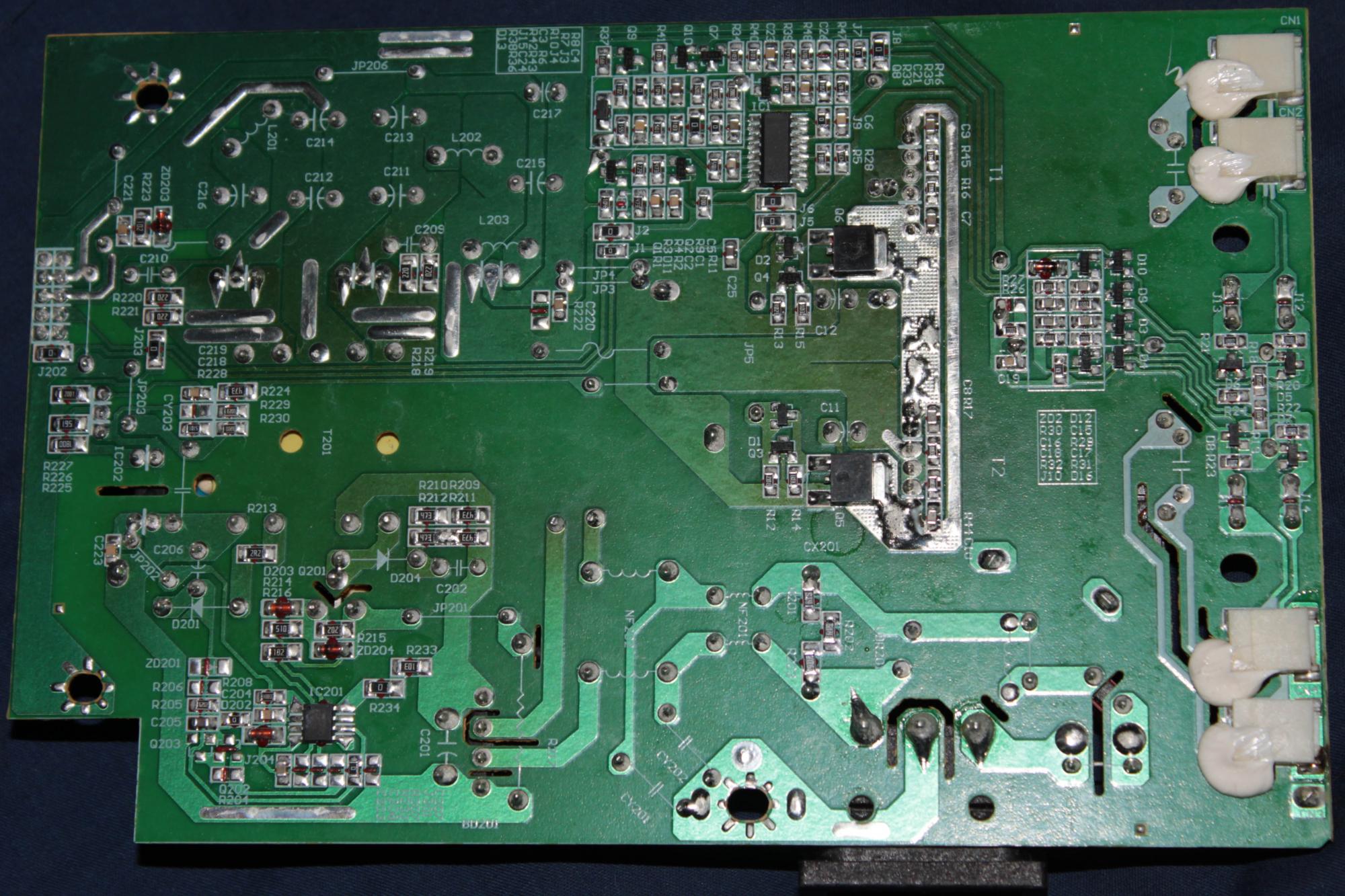

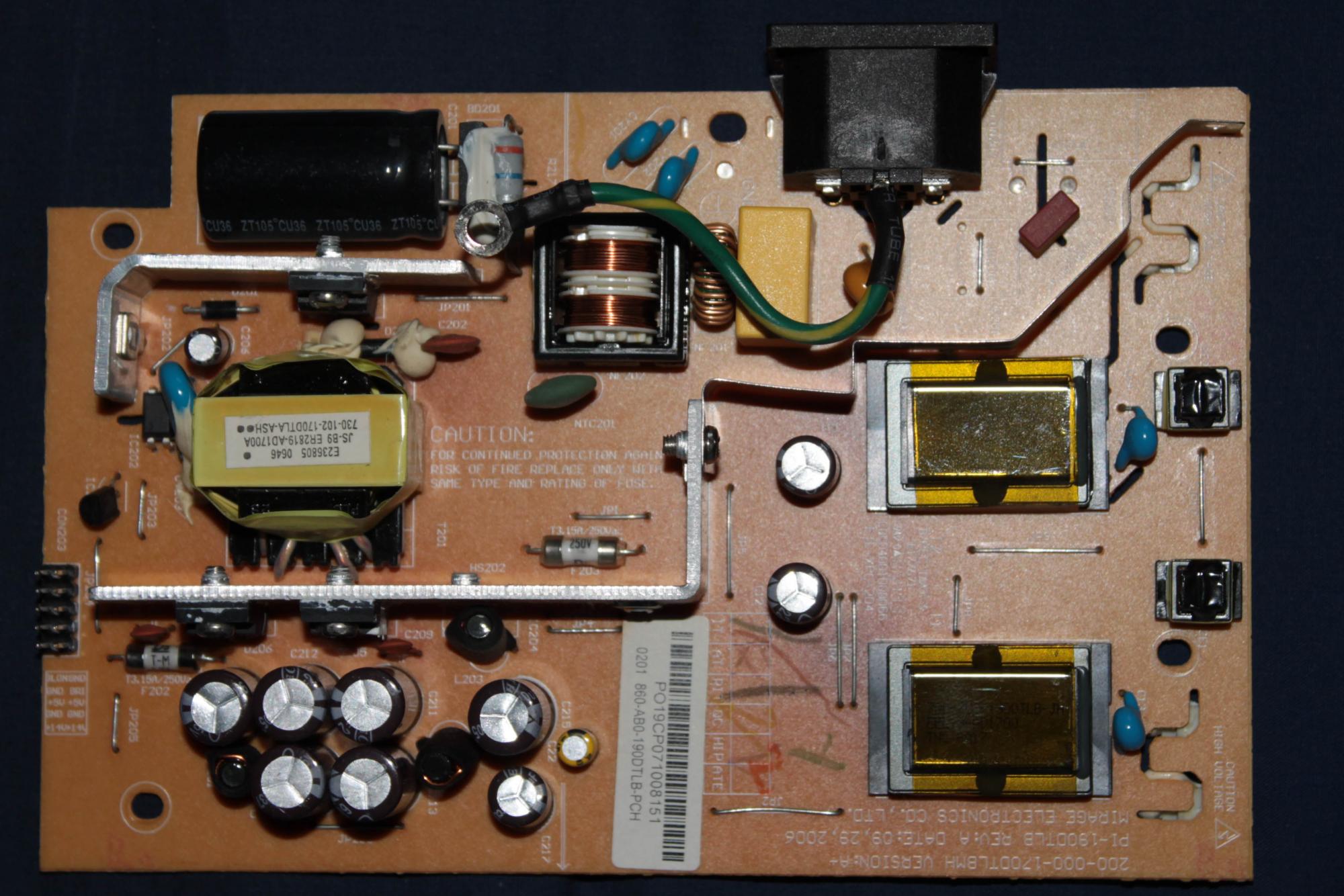

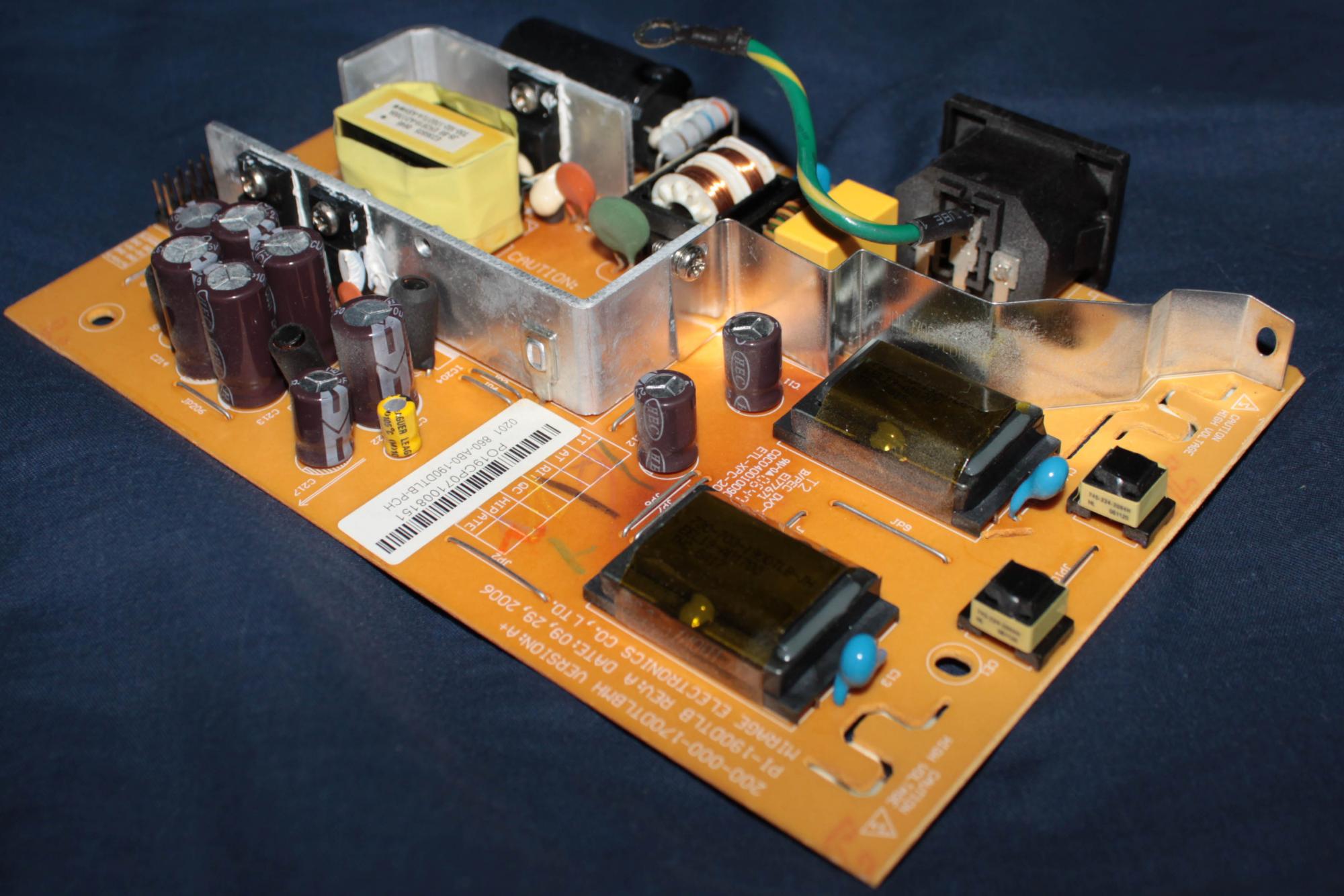

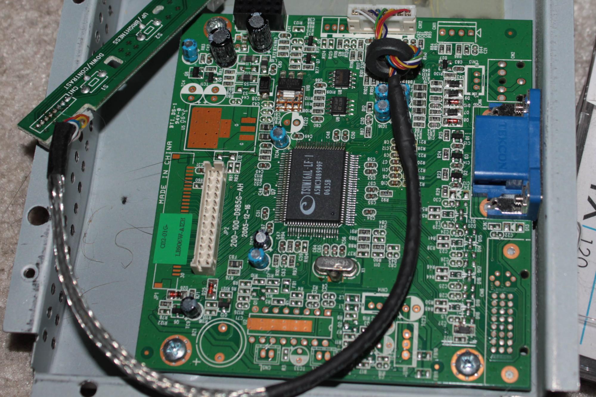

                        Attached are a few pictures of (what I presume to be) the power supply board. Also pictured is the one other board found within the monitor.

                          I'm guessing we will need to replace both CCFL's (the possibly-cracked one and the one next to it)? I'll start searching for possible replacements...
                          • PlainBill
                            • Feb 2009
                            • 7034
                            Sorry, I missed the earlier update. Looking at the back of the power supply / inverter, each end of the transformer secondary is tied to one of the two CCFLs. The return lines from the CCFLs go to ground. So, yes a single broken wire or CCFL COULD cause this damage.
