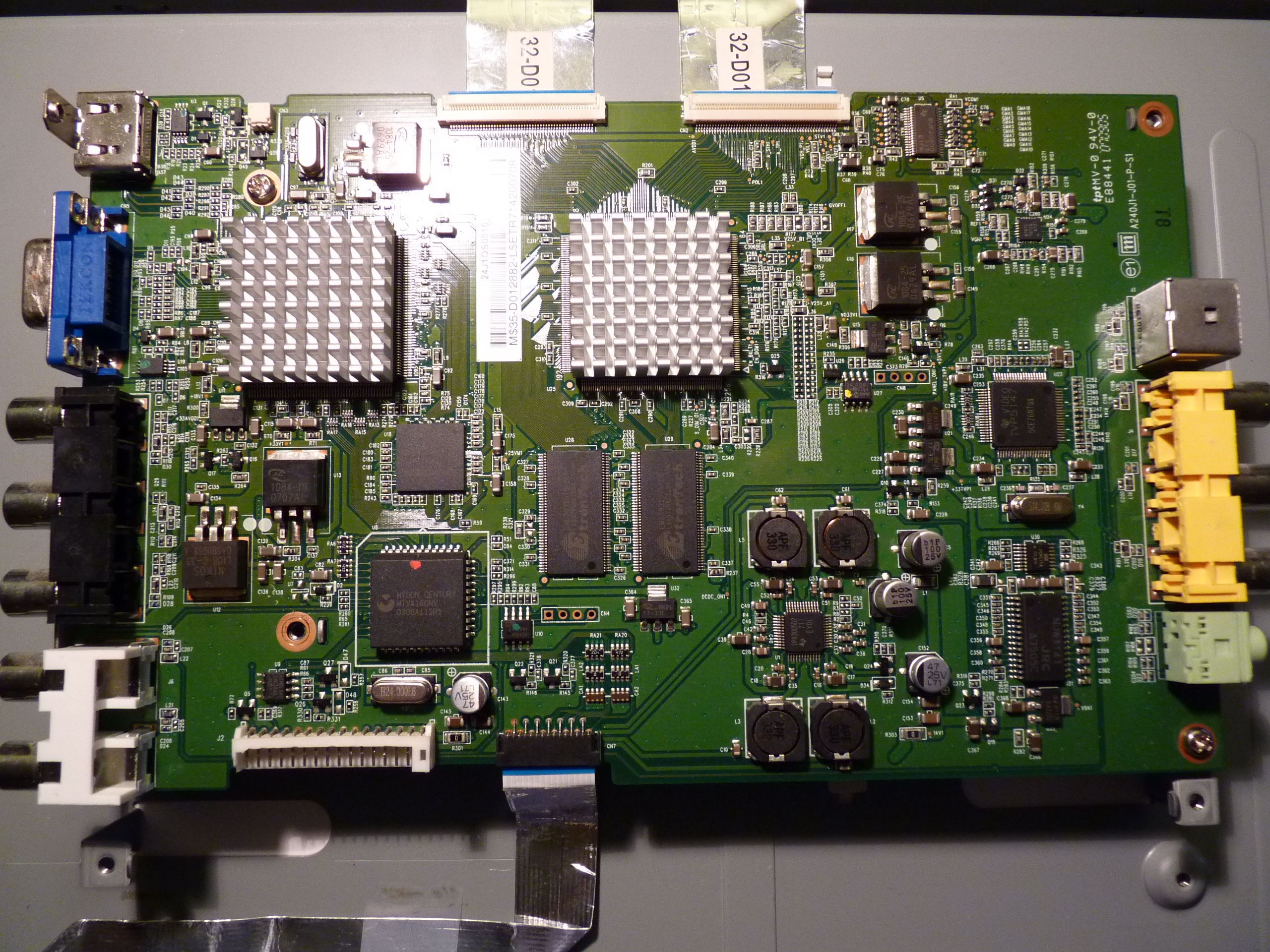

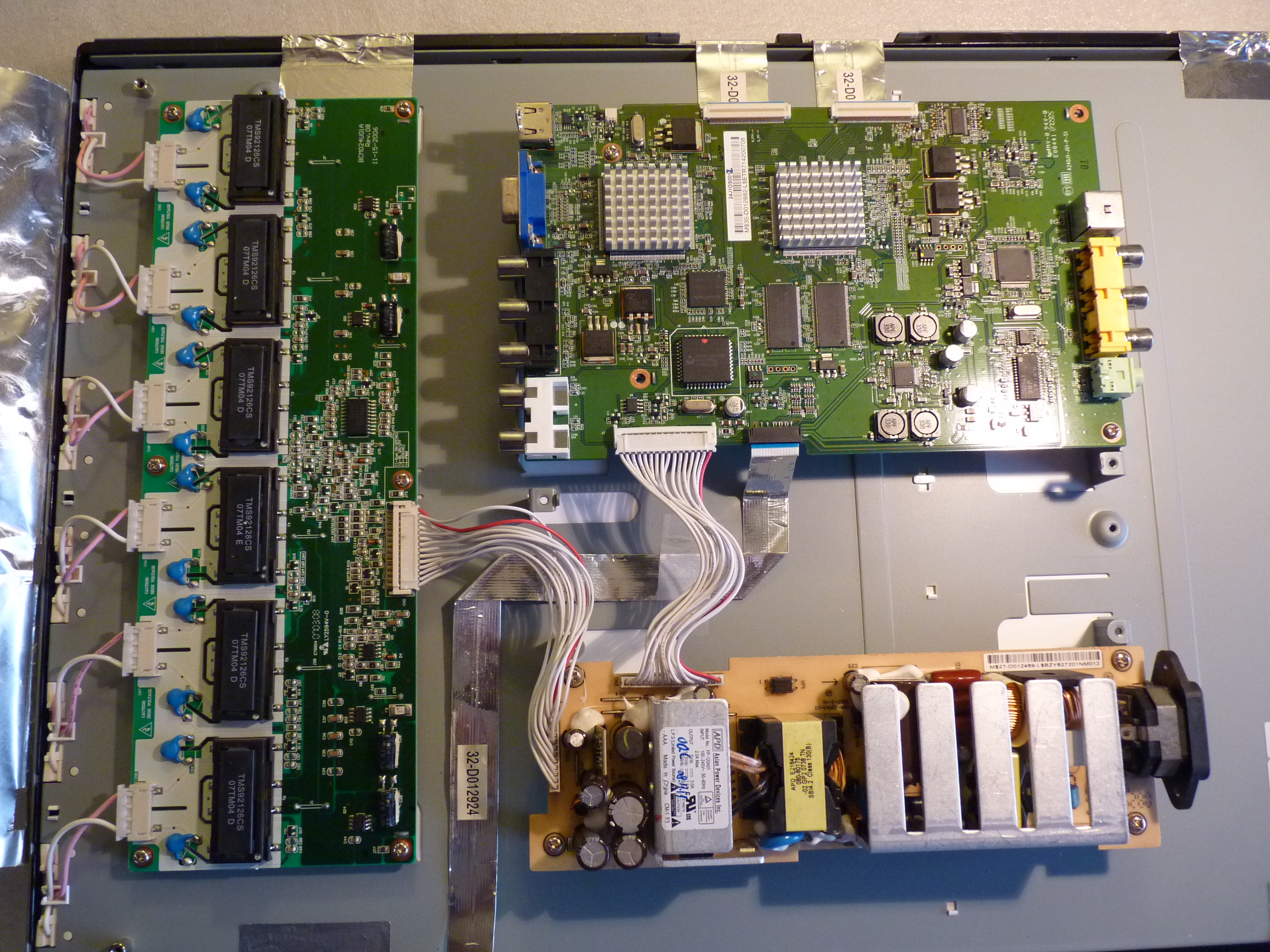

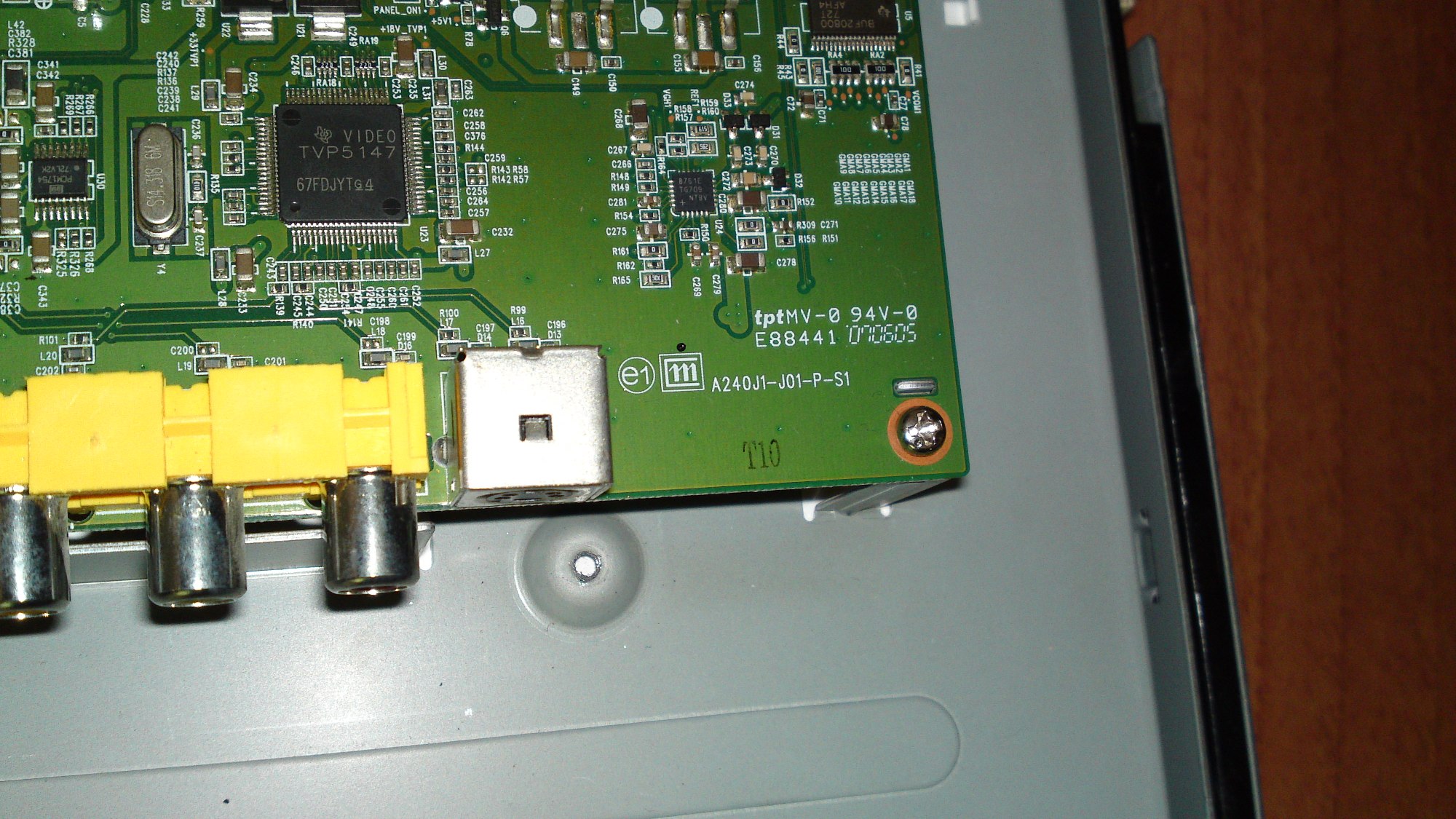

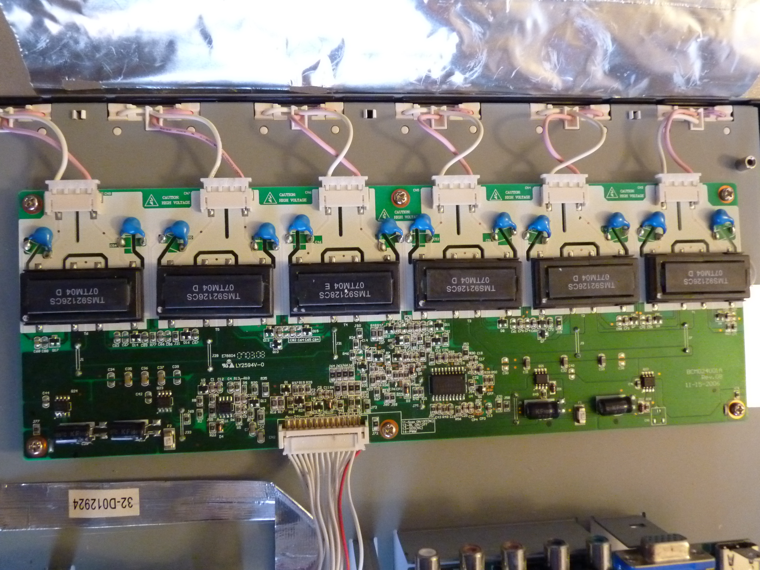

    Hello guys,
    my viewsonic vx2435wm has stopped working. There is backlight but no picture when its turned on, no osd menu, no nothing. Power and inverter board seem to be ok, and on all checkpoints on digital video board that i've tested I get proper voltages. What to check next? Please help
    PS here are some pictures of the logic board.

    I count 11 LDO regulators (U12 and U12 are examples of one style, U21 and U22 are examples of the other) on this board. Have you verified the output voltage of all of them?
    Does the power light work, and respond to the power switch?
    What do you see on the screen - black, or solid white?
    A picture of the entire back of the monitor would be helpful. I am particularly interested in the destination of the two cables coming off the top of the board.
    PlainBill

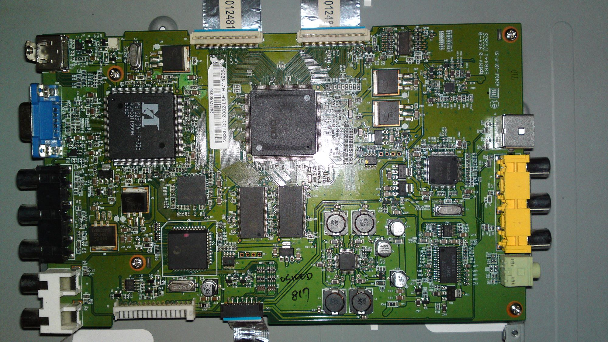

      Hi PlainBill
      power button works, I can turn it on and off. Signal light is blue when it's on, and orange when it doesnt detect video in signal. When i plug in vga cable it goes from orange to blue but few secunds later it goes to orange again. The screen is all black, but i can see that the backlight works.
      I dont have any more pictures but i can post some tomorrow of t-con board and everything else you asked for.

        With a black screen but backlights on, the symptoms point to a failed IC in the signal processing path. I can't narrow it down from there. It is obvious that there are a LOT of potential suspects.
        PlainBill

            Those 2 flat ribbon cables at the top of the 1St picture go to the LCD panel; it looks like the left one may not installed correctly.

                Look at the board. On the upper left corner you have a MST6251. By it's location it's handling the VGA signals from the VGA connector and from the BNC? connectors below them. The 44 pin chip directly above the cable from the power supply obviously handles the control functions. Between the two is a BGA chip that is obviously linked to the MST6251. The NJW1141 is an audio processor. The TVP5147 is a video encoder. The video signals obviously go through the CMO chip. The 44 pin IC surrounded by 4 inductors possibly produces the voltages required by the LCD panel. Either of these last two could CERTAINLY cause the problem you are seeing. The 44 pin control processor (which probably generates the OSD could also.
                As far as loading code on a chip, I identify three chips that have the tell-tale dot of paint, indicating they have a custom program.
                Other than a misplaced cable, failed regulator, or a non-functioning power supply there is very little chance of repairing this card.

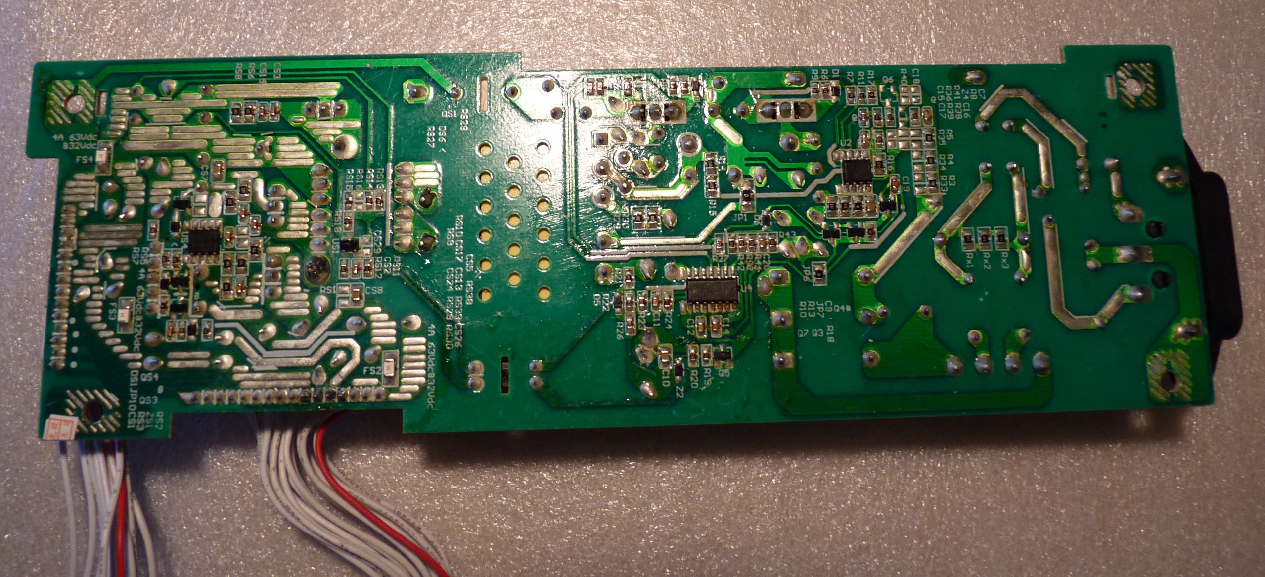

                  Hi everyone,
                  I'm new to this forum, so please be tolerant. I have the same monitor VIEWSONIC VX2435WM, it worked great for awhile, and suddenly stopped working. I read all the info above, and this seems to be the only thread about this monitor on the forum. So keeping it all in one place... Answering above Qs, my monitor doesn't power on anymore, it doesn't react on Power button, and power light is not lit.
                  Where should I start troubleshooting? Please don't suggest to buy a new one. I'm aware about this option.

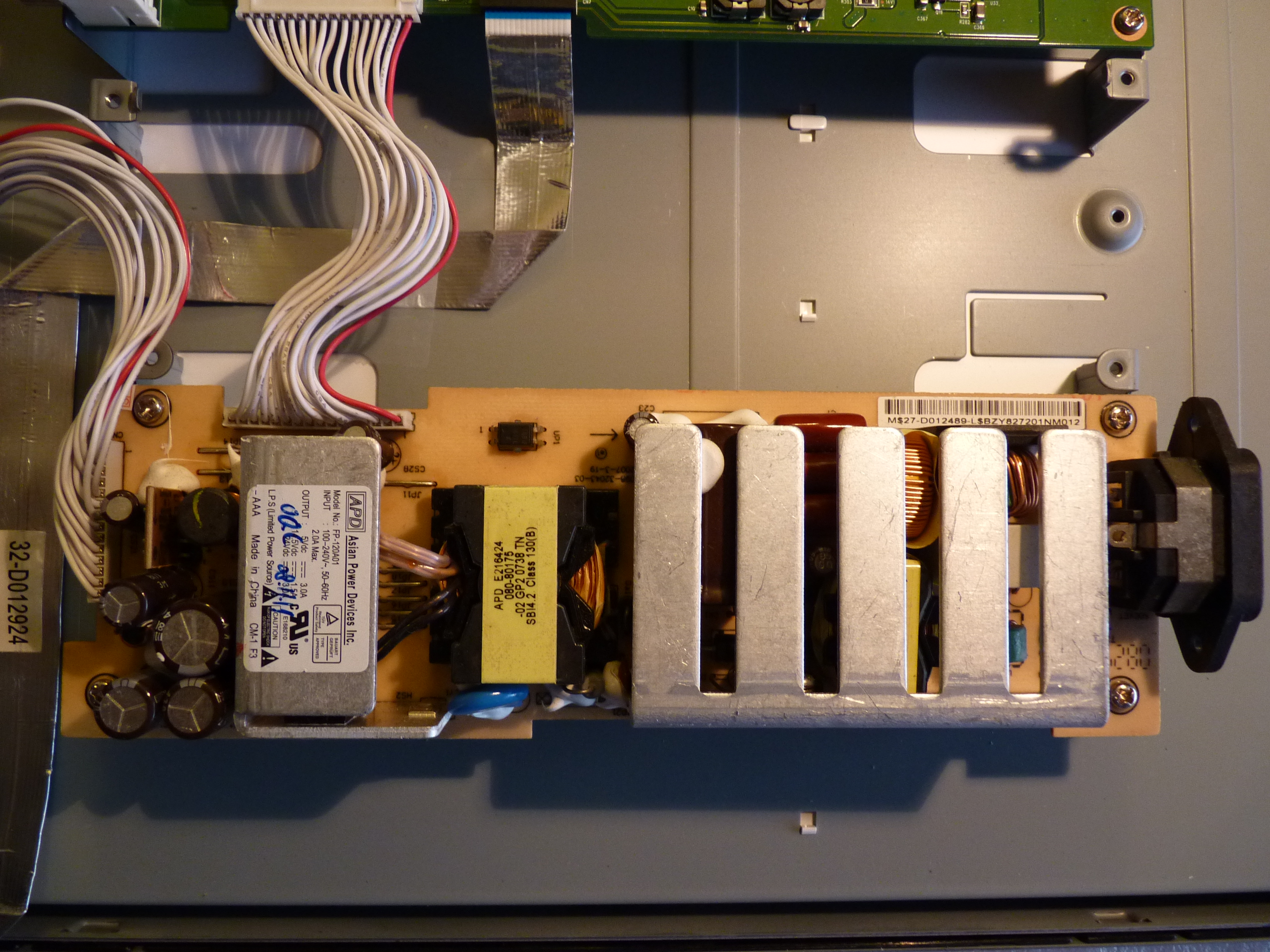

                    Please provide GOOD CLEAR pictures of the boards in YOUR machine.
                    We need to be able to read the white part designation numbers on the board.

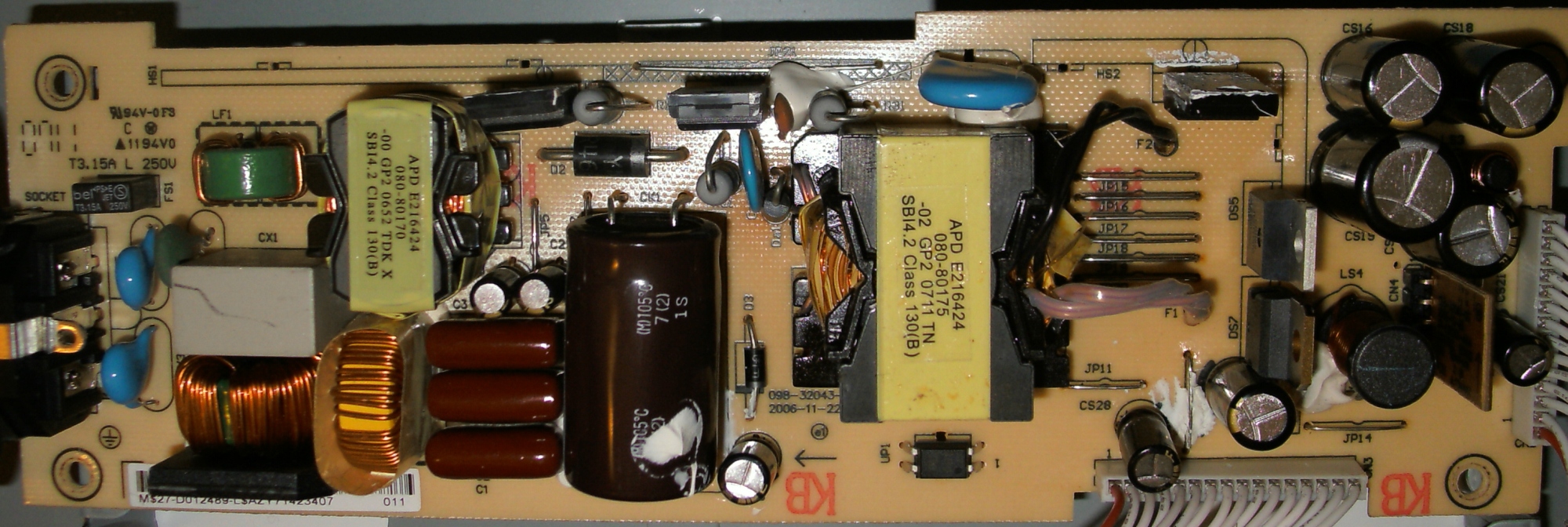

                        OK First find the fuse shown on the last pic then locate the solder joints on the back of your board. Set your meter on ohms200 and with the board not plugged in test the fuse. Should show the same as holding the probes together.
                        If that is good then see the BIG capacitor CK1 find the solder joints of that on the back of your board. Working on a non conductive surface set your meter on VDC600 and with the mains power applied to the board Very carefully test the
                        voltage on the Big Cap. DO NOT touch anything else on the board.
                        Pics are very good thanks

                          The fuse FS1 gives continuity sound on the multimeter. The big cap CK1 shows 190V.

                            I am not sure about some of the solder joints on the back of the power supply
                            is pic of the back of the power supply board your board?

                            Also there is a fuse FS2 on (EDIT) the same board near the "out" socket at the bottom in your picture- a small white one maybe with an "M" or a "w"on it IIRC. With the power off resistance test that. (( also some of the pins look brown on that socket!!)
                            Also an the left had end of the board in that pic there is FS3 and FS4 so test those as well
                            Two fuses on the inverter board F1 and F" and also near the white socket from the power supply ther are a couple of jumpers J72 and J73 they are zero ohms resisitors and are sometimes used as fuses to test those as well.

                              Yes, the bottom PSB pic is from mine. Sorry to ask a stupid question, but which one is the ground screw on this power board? Is it the one next to red wire, though that screw doesn't look connected in the circuit? Or the opposite screw on the same side, which is connected in the circuit line passing under FS4 fuse, but not through it? Or the screw on the other side with like a ground sign next to it?
                              Why there's only one red wire on each connector, what the red color marks? If you can refer to component IDs on the PCBs, I could find them more easily.
                              On PSB other fuses give:
                              FS2 - 610 Ohm, FS3 - beep, FS4 - 420 Ohm
                              If I need to replace those, where to find the new ones, and what's the technique to remove them? Any other components I need to check that may have blown up with these fuses?
                              On the main board I don't see any fuses, unless you can point where they are. On the inverter board ceramic fuses F1 and F2 give beep.

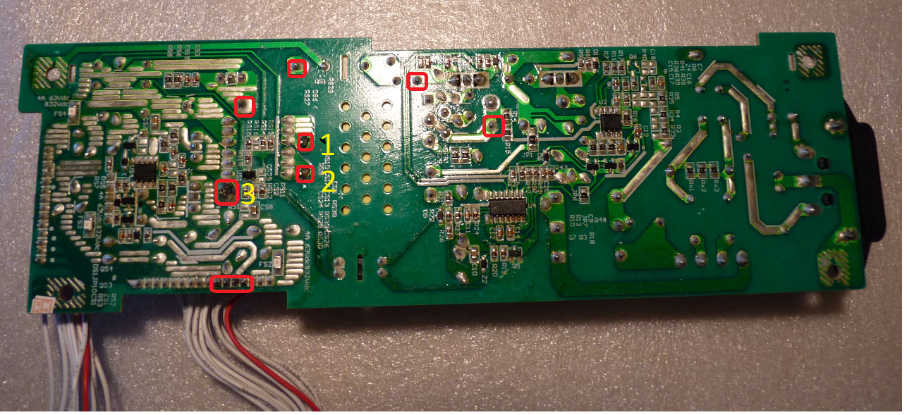

                                        "Two fuses on the inverter board F1 and F2 and also near the white socket from the power supply there are a couple of jumpers J72 and J73"
                                        I have attached a picture with some joints marked that look a bit odd. Often this is due to shadow on the picture but check them out and reflow any that look bad. Reflow = remove most of old solder and add new preferably leaded solder to the joint. What are 1 and 2 and is 3 the heatsink?
                                        Tests FS2 and FS4 again and also check meter batteries are good.
                                        The main board is suspect it appears to not be sending signals to switch everything on ( the power led not coming on is a bad sign ) though if you dont have it all connected up then obviously it cant.
