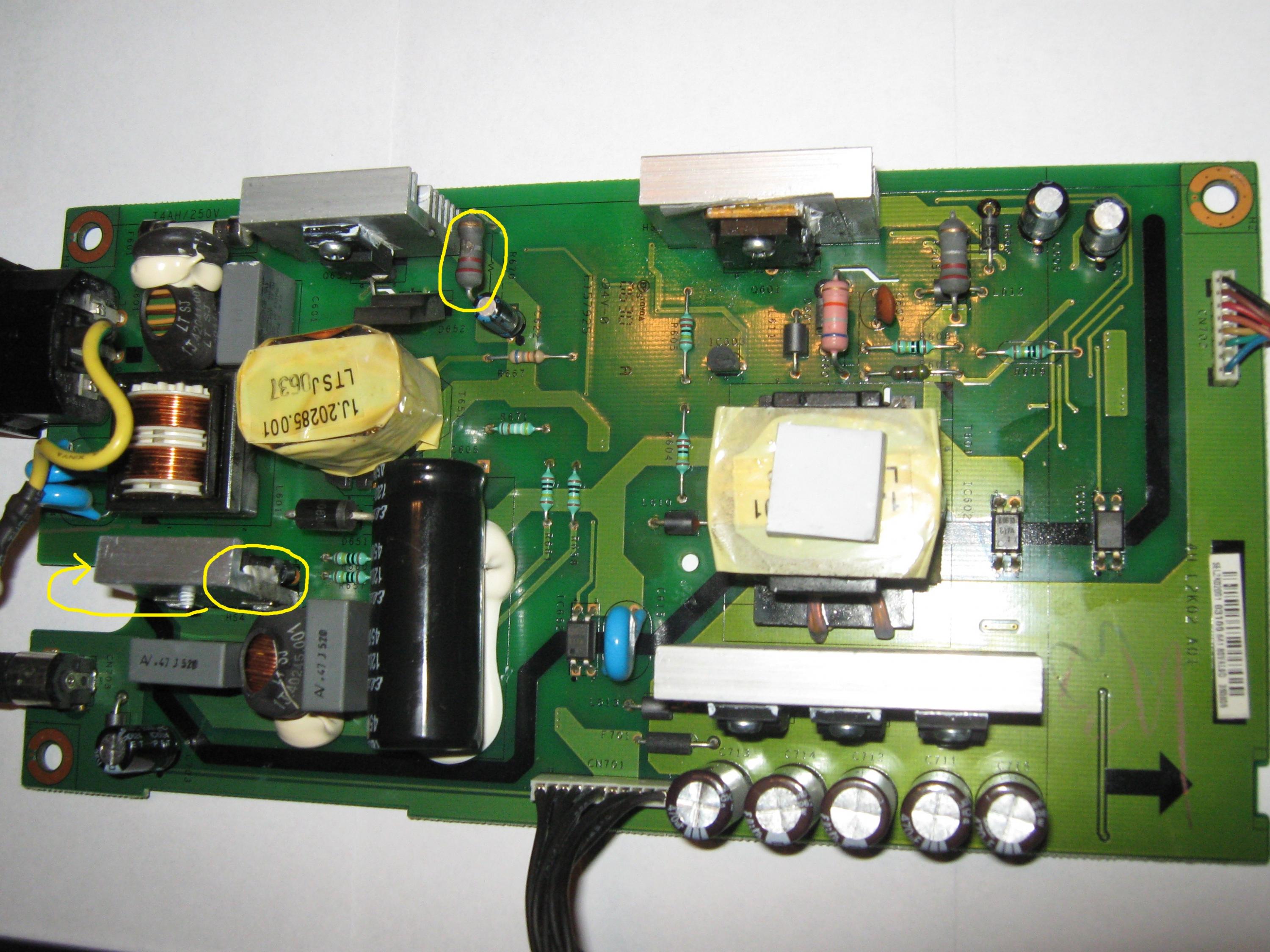

              My 2407 also gone these Days but its not only the screen is black or power dont turn on .
              I was working normal but then this little "boom" and the complete Power of the electric curcuit was gone. After checking the fuse box the fi switch and the circuit switch where off.
              So for now i am not able to connect the Power Cable from the Monitor to an electric Curcit without activating the saving switch in the fuse box.
              So first i am happy to found this Forum because i think this is exactly was i was searching for . i dont know anything about electronic but know someone if something have to be fixed.
              So first thing i found after some research in that thread is that R 670 is definitly gone. For the C605 i am not sure its a little bit corrosion but not that much as on other pics in this thread.
              Also theres an component called BD601 that have some white "fluid" clue left and right that is not that hard one so pherhabs this is also damaged.
              I also have made an Pic of the Board with the Connections because there are also capacitors that seemed to be damaged of what i read so far on the internet. They are lightly "arched" (dont know if this is the right word) on the top .
              All other Capacitors seems to have no damage on the sides or on Top.
              So first because theres no measurement possible because no connection to the electronic curcuit possible should i try to change R670 and C605 first and then if that works check all other components .Or is a measurement always working (as i said i know nothing about electronics) so i have to check my friend first so he can test everything ?
              Or do you think this Monitor is really Dead because the save electronic switch turn on ?
              PS.: I am from Austria so i dont know if some replacement are working in Europe because we have a different Power Supply System.

                I also have a no powering 2407WFP. As for many, leakage can be seen on the + PIN of C605, and a damaged R670. I also have a completely destroyed IC 651 (L6561 D) + R669.
                Don't know what caused IC 651 destruction, maybe a sudden voltage increase at the CS PIN which may also explain R670 and R669 destruction due to C605 failure.
                I have many LCD power boards, but none has a L6561D, each use a different IC for power factor correction. And there seems not to be PIN to PIN equivalency.
                Hope that after replacing all 4 parts, it will work again.

                      I desided the broken 2407WFPb SMPS would be a great project to fix, since the great amount of information found at this forum and it's well documented PCB (thanks Dell!). It started as an small one-evening hobby project and turned out to be an 6-months on-waiting-for-parts-off experience. It has been an joyful experience however, which I am now typing looking at a fixed monitor. I would like to thanks all for the information provided.
                      Reading shortlist:
                      A special thanks to the following posts for their usefulness and/or high entertainment factor:
                      The fix:
                      Replaced both ICs together with the 'usual' suspects, making it the listing of:
                      • IC601 NCP1200D60
                      • IC651 L6561D
                      • ZD601 15V 0.5W Zener diode
                      • C605 RUBYCON KXW 120uf 450v 120mfd Capacitor
                      • F601 4A 250V Quick Fast Blow Glass Fuses Fuze
                      • R669 0.22 ohm 0R22 2Watt Metal Film Resistors 2W Resistor 1% #0680
                      • Q651 2SK3502
                      • Q654 2N3906S
                      Ordered them all on ebay.com, it took me roughly 4-6 weeks for items to arrive (based in The Netherlands):

                      The total costs of my project was roughly 35 EUR/USD. I ordered multiple quantenties allowing me to kill a few and more importantly use them as reference measurements counterparts to find out if my board component was still working. If somebody based in The Netherlands, is looking for the components, feel free to send me a message to get my remaining stock sent.
                      Lessons learned:
                      • Reading the whole thread (multiple times) proved to be usefull and nessasary, yet an lengthy process, I hope the post will be a nice summery to success.
                      • If you are unsure with the logic-board and/or inverter board is still working, use the quick hack of AdrianM to first verify they are still working.
                      • Mind your safety, it are high voltages after all, use common sense and tricks like the 'bulb' test to limit the amount of fuses you have to replace. Always measure voltage over C605 ensuring it has dropped to a safe level, before handling the board.
                      • SMD soldering is a 'art', if possible use an SMD soldering station, a cheap one in the range of 100-150 EUR will do the trick over here, and/or go to your local MakerSpace to get help with soldering.
                      • Be careful when soldering, it is very easy to make solderjoints, re-test all new components before powering on. Also verify the the pads of the ICs are not floating. Put one test probe on the leg of the IC (near the black casing, not on the solder) and the other probe on the component it is connected to, use the famous 'beep test' to verify the path is made successfully.
                      • Test the board without the inverter board and logic-board attached. If successful attach the logic-board, you will now see output of by the LED of the power-button. The board itself will then consume roundabout 20W (easy to use with the light-bulb test). Mine was flicking and the board was making 'clicking sounds' after repair, this was fixed by soldering an floating IC leg, and cleaning the board with isopropanol one extra time to remove left-over soldering paste 'mess'.
