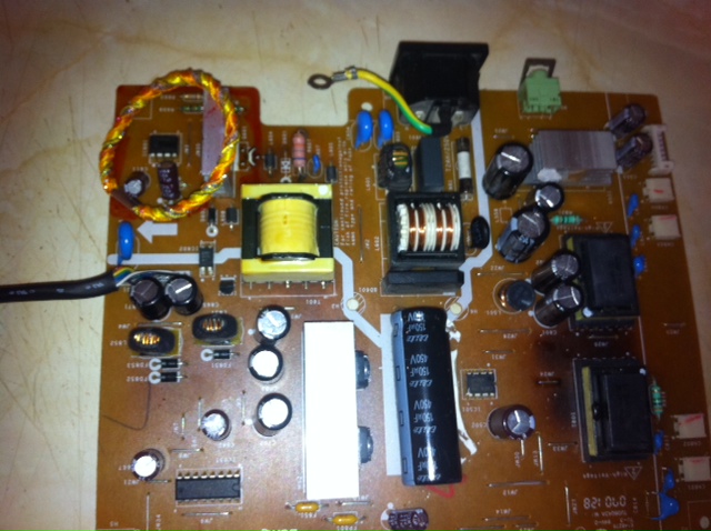

    Benq broken chip
    I have a belina monitor with Benq motherboard, Q601 has blown so I cant read it, can anyone help me with device no. The only ident no for the m/board ican find is 070 128.

    1) Post a clear focused picture using the manage attachment function of the entire board. See my sig file below for instructions.
    2) Circle which is Q601.
    3) BTW, this question is better suited in the "Troubleshooting Computer Displays" sub forum.

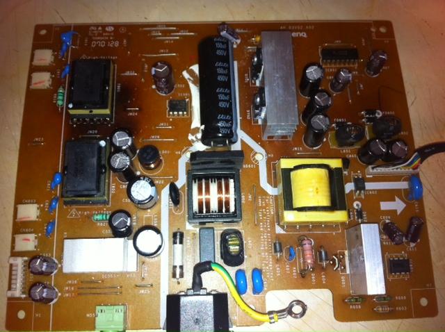

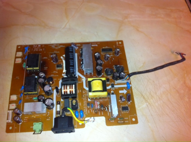

      Re: Benq broken chip
      I am not too good with uploading files. I hope these are ok, I have no photo editor, so have placed a yellow hairband on one of the photos to indicate the position of Q601.

        I'm more concerned about the darkening around your inverter transformers

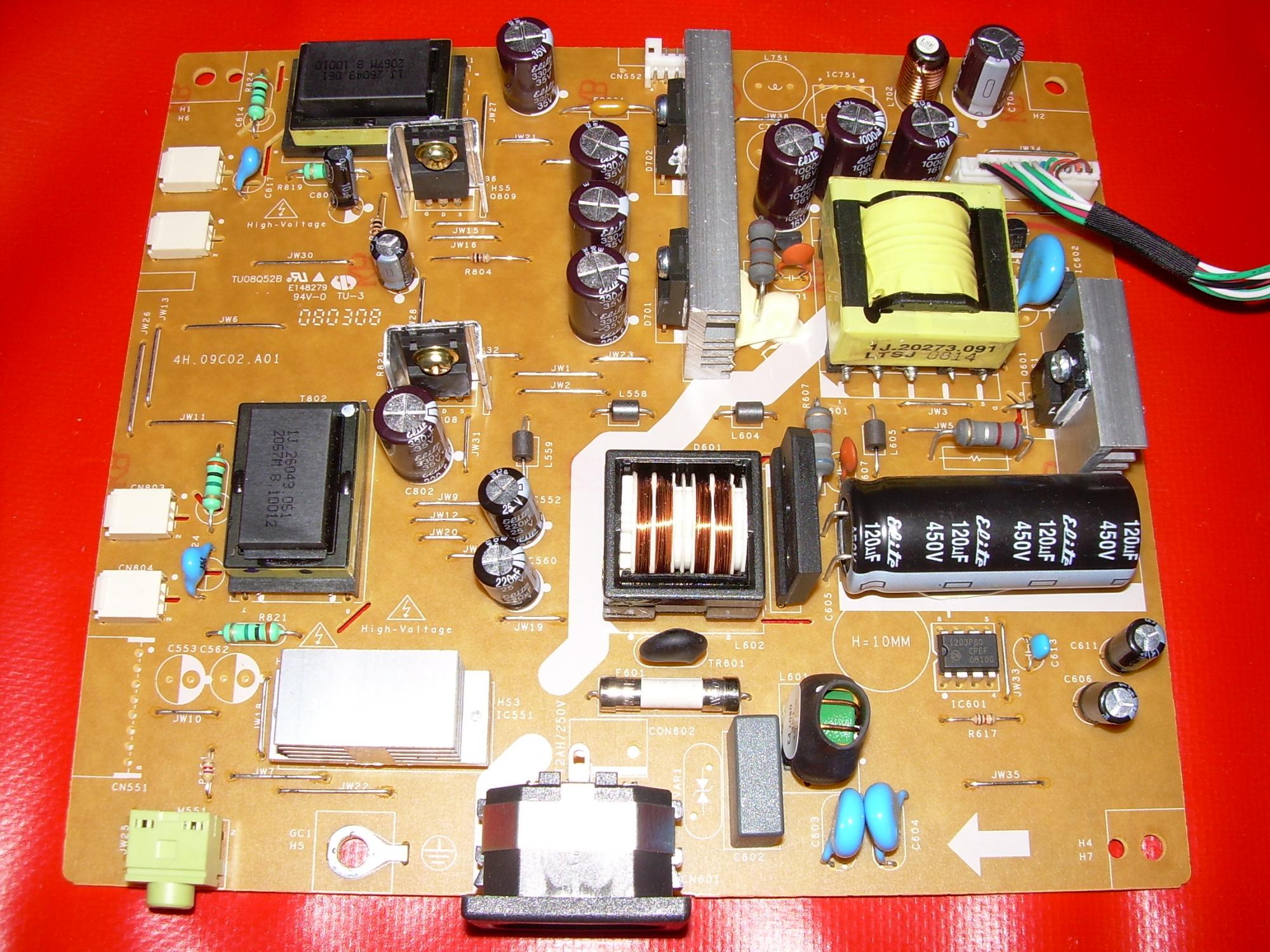

          I had a similar board type and info is here.
          You might want too double check that the chip is of the same type as mine was.
            With regards to the dark area, i have replaced the two inverters, the two driver devices plus all the caps, so i hope the new q601, a three leg device with heat sink.
                  Like I said, the ship is most likely a 1203p60 8 pin dip 'PWM Current-Mode
                  Controller for Universal Off-Line Supplies Featuring Standby and Short Circuit
                  Protection' as it was on my board, see my picture.
                    I think there is some confusion here. For Q601, the "Q" designator is for a transistor. In this case, it's the switching mosfet transistor mounted on the heatsink. However, the OP has circled the 8-pin PWM chip in his photo, which should be labeled IC601. The OP needs to identify which component they're really asking about.
                      Ahh now I see what the fuzz was all about - I just saw his picture with the yellow hairband and did not see the 'Q601' part.
                      If he however is thinking of the PWM chip it most likely is a 1203p60.
                        Thanks to all. Gabriel was right, I did not put the hairband over to the right enough, the heatsink is only just visible, and it def is Q601 NOT ic601, this device is next to L604 and D 601. Sorry for problem/
                                Maybe i am wrong , but the BenQ number printet on the board is
                                4H.03V02.A03
                                If so Q601 is a K3530, IC601 a 1203P60
