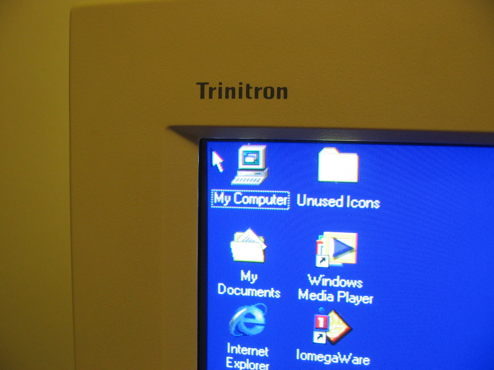

    This monitor was given to me about fiive years ago, and it has always had the issue shown in the picture. You can see that the black outline of the mouse cursor is offset from the white cursor. Blue lines up properly, but green and red are not in the correct location. Other than this, the monitor gives a good picture. What could cause this?

    It's a convergence problem. CRT monitors are prone to this problem.

      I believe you have some adjustments in the menu, but they are for the overall picture.
      Trinitron tubes are prone to this kind of local convergence issues - they are corrected in the factory by small magnets placed around the tube. You can try taking it apart and placing small fridge magnets on the back of the tube in the affected area to see if you can improve it without affecting the rest of the picture. Use Nokia Monitor Test for the generation of convergence patterns.

        If it's only in that corner, it may be a slightly bent aperture grill. Unfortunately not fixable.

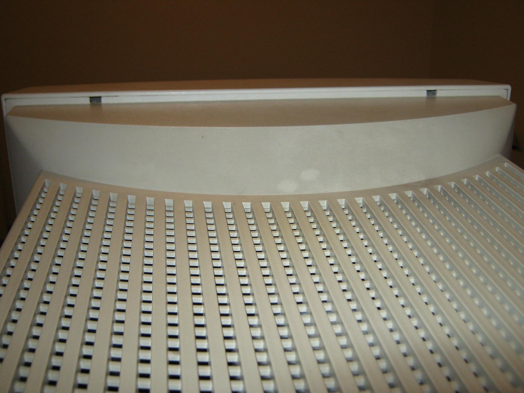

          I can't figure out how to take it apart. Something is holding the back cover on along the top edge, but I can't see what it is.
          It only affects that corner and doesn't extend past the My Computer icon on the desktop.

            There may be 2 or 3 plastic latches on the top. Should be similar to LCD monitors, but usually much easier to unhook them, though.
            Try running degauss a few times and see if that fixes the problem. If not, then perhaps try Th3_uN1Qu3's method.

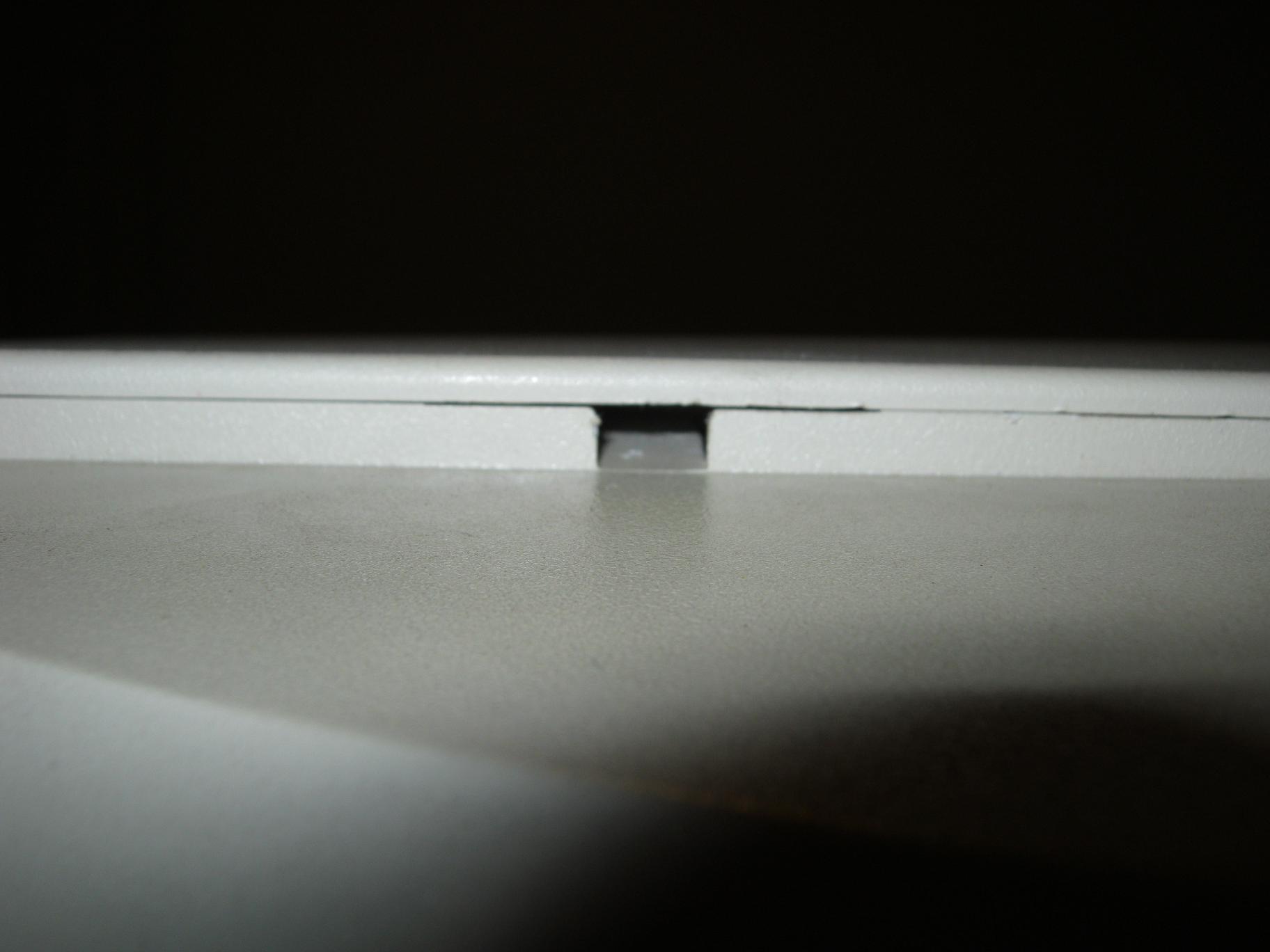

                  On the Sony monitor, I can't find the latches along the top edge. There are two slots on the top edge, but I don't see any way to unhook any latches that might be there. The problem has existed for at least five years, so it should have been degaussed enough times.
                    The latches may be next to the slots (or they may be far away too).
                    Post some pics if you want. CRT monitors are usually very easy to open.

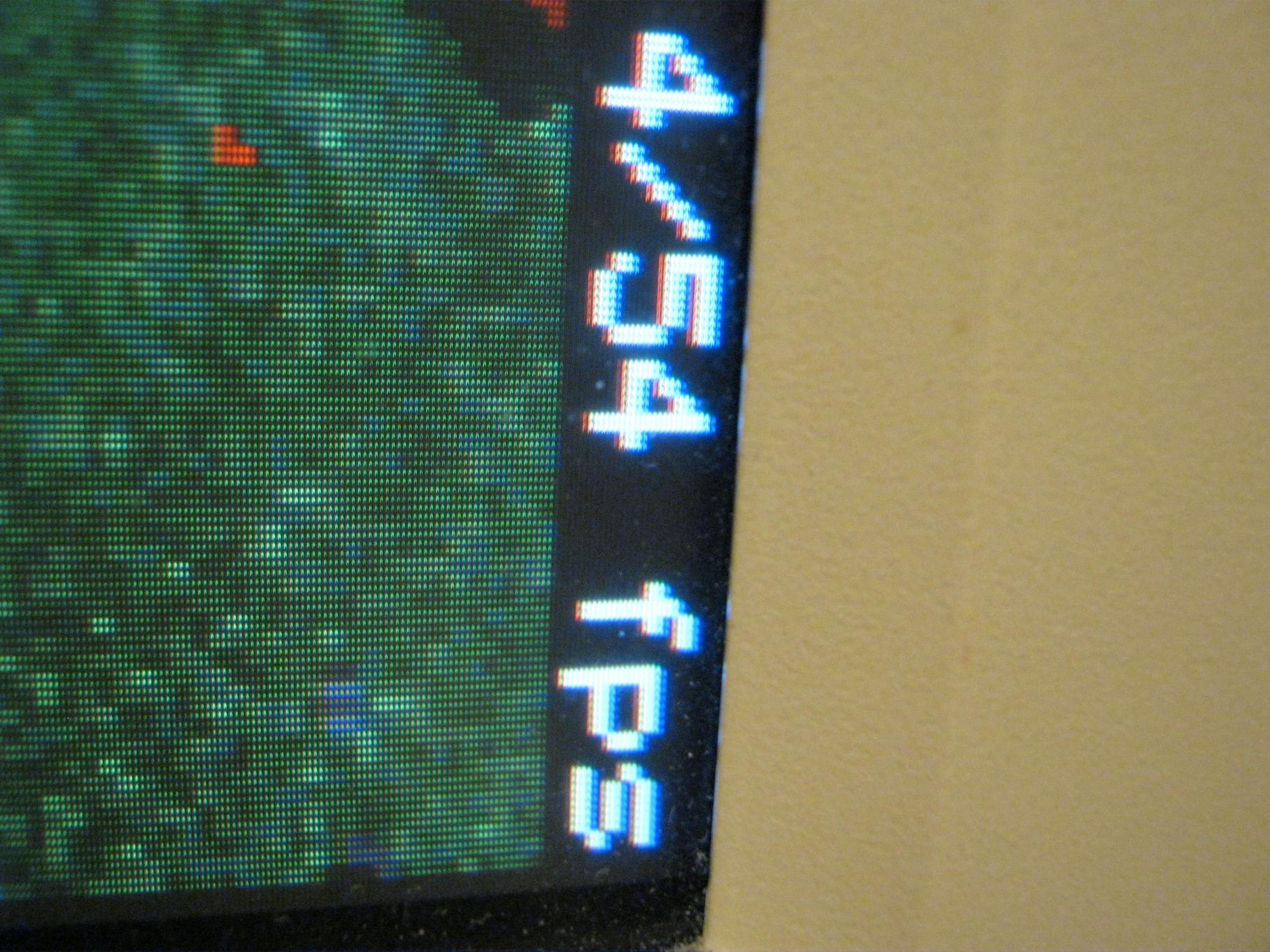

                        Now this monitor has another problem. The convergence is completely screwed along the right edge of the screen. The problem gets worse at lower resolutions and is very hard to see at 800x600. I will post pictures of this later.

                          Here are pictures of the top of the monitor and the problem that I am having. This only happens to white objects along the right edge of the screen. Any objects that are another color are displayed properly.
                          My camera never focuses on the object you are trying to take a picture of. Its OSD will place a box around the object I want to take a picture of, but it actually focuses on a random object or takes a picture that is completely out of focus.

                            Looks like there are latches right next to the slots (to the right for the slot on the left and the left for the right slot). Try sliding a thin object (like a putty knife or an old credit/debit card). If not, perhaps use a flashlight into one of the slots and see if you can see anything (maybe a special tool must be inserted in the slots?? - I doubt it, but still).
                            Normally, most CRT monitors of this size and age have only 4 screws and about 4 latches or so.

                              There are latches in those two areas. I just found them.
                              This monitor has those two latches at the top and two screws at the bottom. The base is attached to the back cover.
