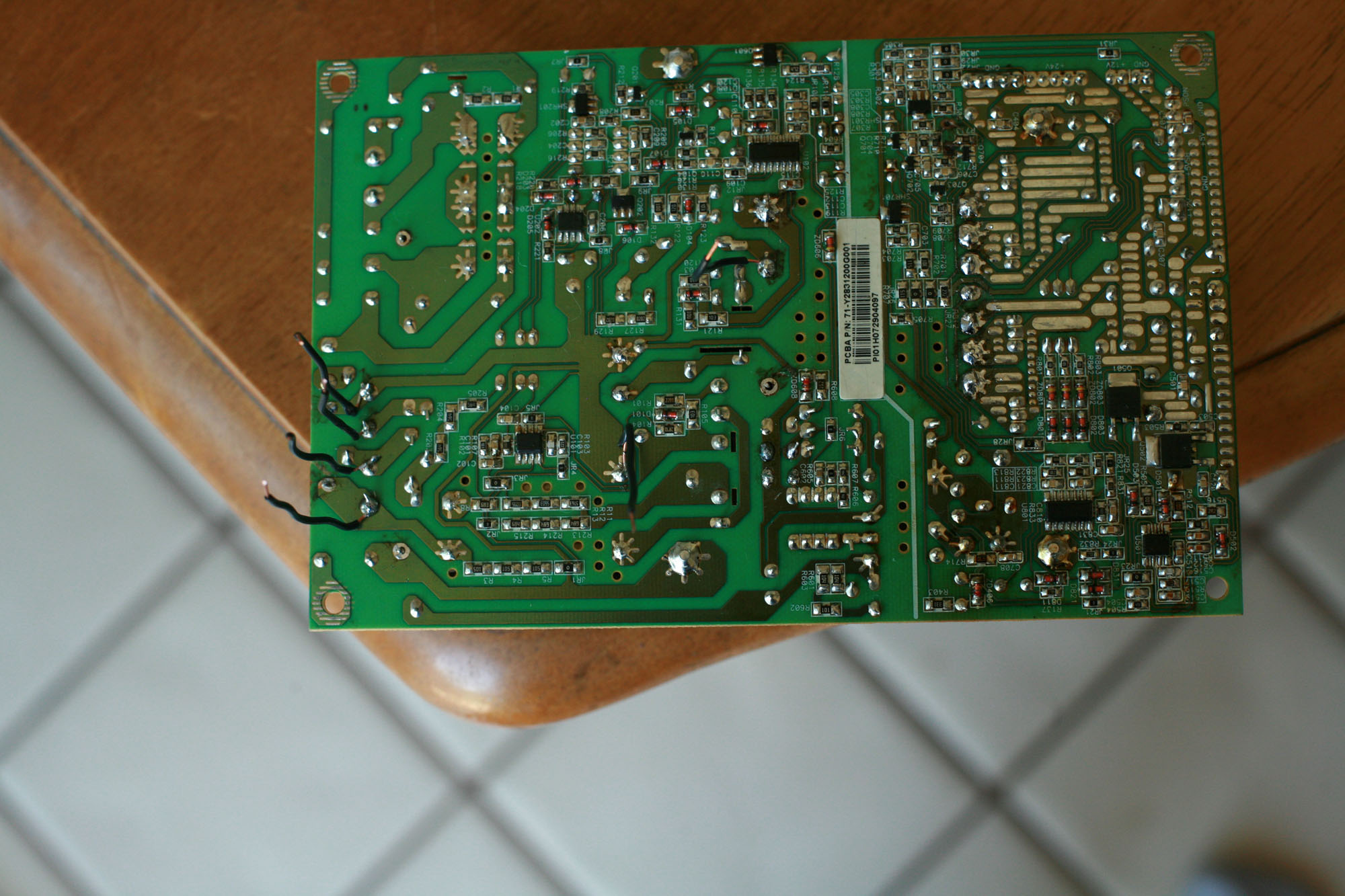

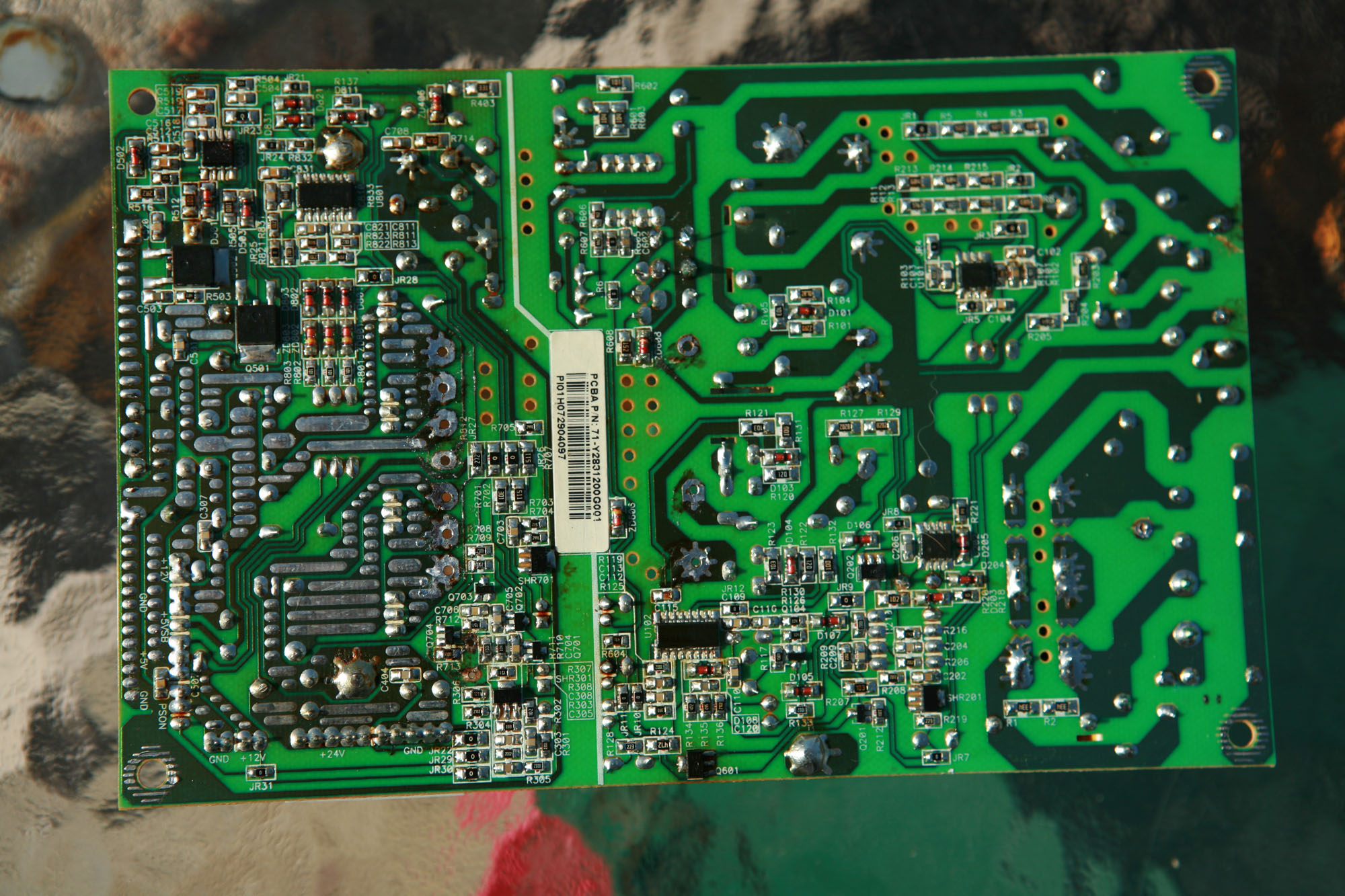

    I've got the older Hanns g 28 monitor with power supply Phihong psm217-h-r. My power supply quit. I've troubleshot it down to the 12V & 24V transformer failing (i.e. Phihong 26002170001). These boards and the transformer are nowhere to be found.
    I've got a couple of questions for those who might know the answer. I don't have 5V or 12V at CN1. I don't have 24V at CN3. I have 5VSB (I've already swapped out the dried out capacitors). Additionally, the PSON functions properly.
    (1) Does the 5V derive from either the 12V or 24V transformer? The PWA states that it supplies 7A.
    (2) Since these boards are difficult to procure, is it possible to solder a couple of wires from the transformer pinouts which connect the 12V and 24V duo diodes and supply the DC voltage externally from regulated switching power supplies? I'd leave the transformer out and solder 2 wires for the 12V and 24V supplies and 1 wire for the returns respectively. This would cover 12V and 24V DC the transformer is supplying. My assumption is that the transformer output at the duo diodes is DC.
    (3) There is a center wire leading from the transformer of which I am uncertain what it is to supply/what it's function is. It is connected to a diode on the PWA.
    (4) If the 5V isn't derived from this transformer, where is it supplied from? Perhaps I have an additional problem on the board.
    Any help would be appreciated. Thanks much.

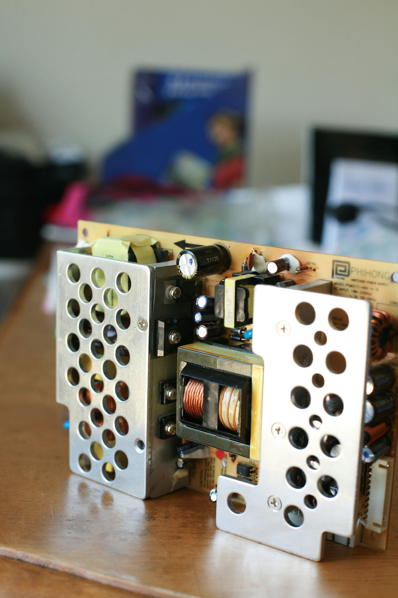

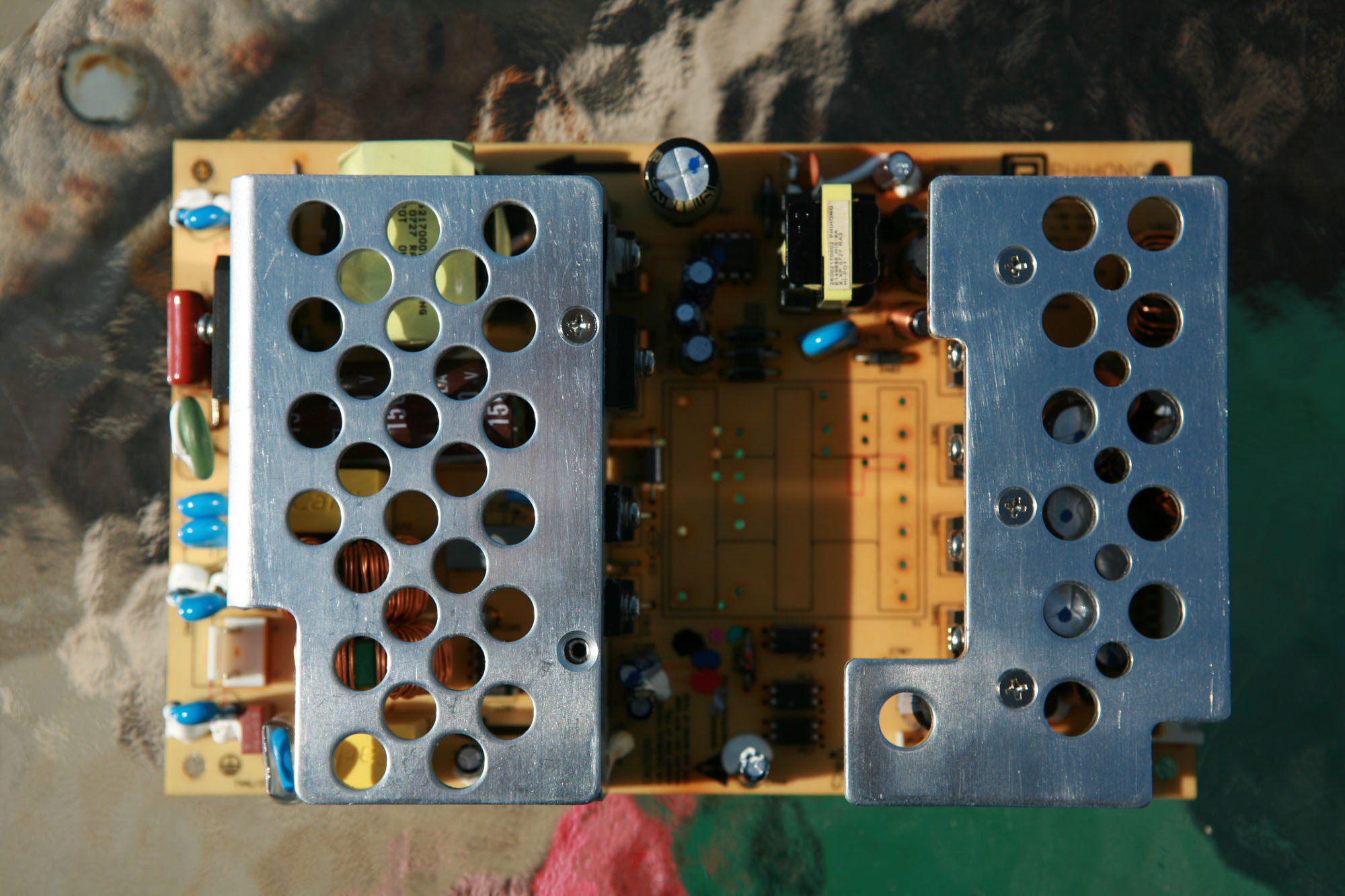

      Pictures, pictures, pictures!!!! Not a lot, just one or three - one overall shot of the circuit boards, one top view of the power supply, one bottom view of the power supply. 2000 x 2000 pixels, please.
      Virtually every large monitor I've seen has a dual power supply. The 5 volt standby supply is on at all times; the main supply is turned on only when the monitor is active. If you look at the board you should see a broad line zig-zagging across the power supply. One side is labeled Hot, the other Cold. How many transformers straddle that line?
      Given the fact that PSON functions properly, it indicates a problem with the main supply.

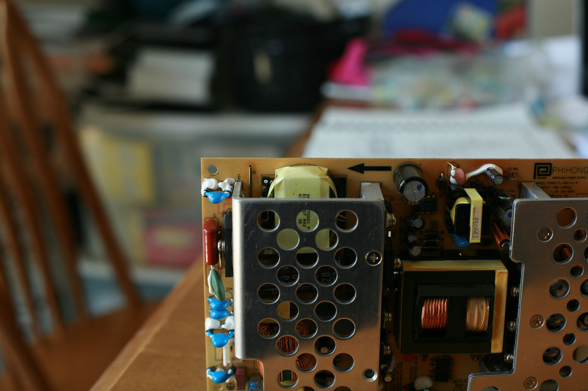

                From the pictures you posted here, I can definitely confirm that the 5v rail is indeed derived from the 12v rail via Q501 and Q502. If the 12v rail is not present, then you won't get a 5v rail either.
                See if the 5v rail is shorted to ground. Also, you do need to have low ESR capacitors on the 5v rail because the MOSFETs (Q501 and Q502) likely operate at a high frequency.

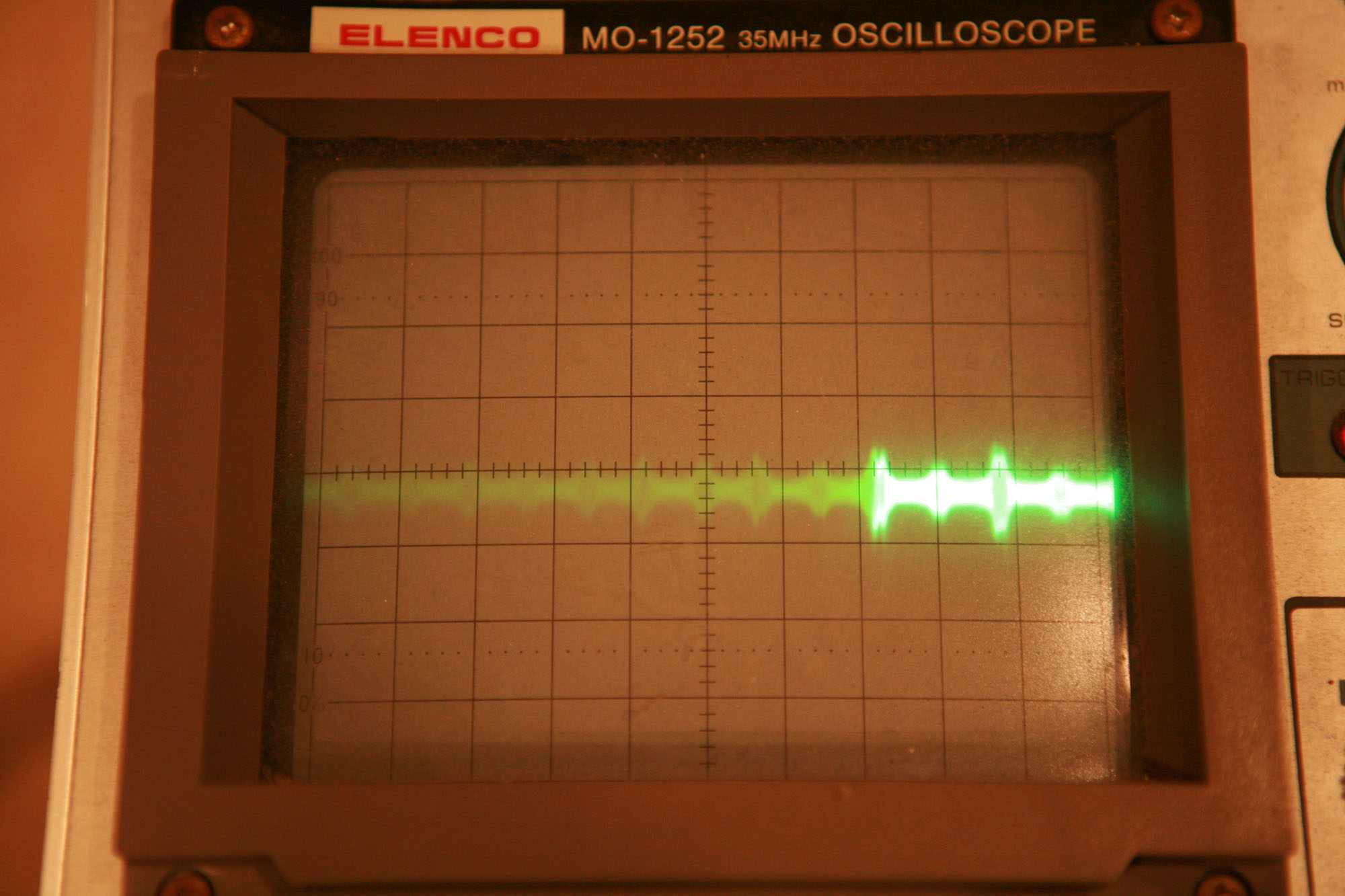

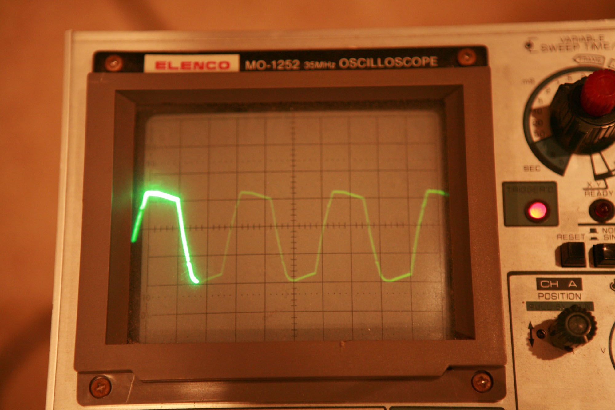

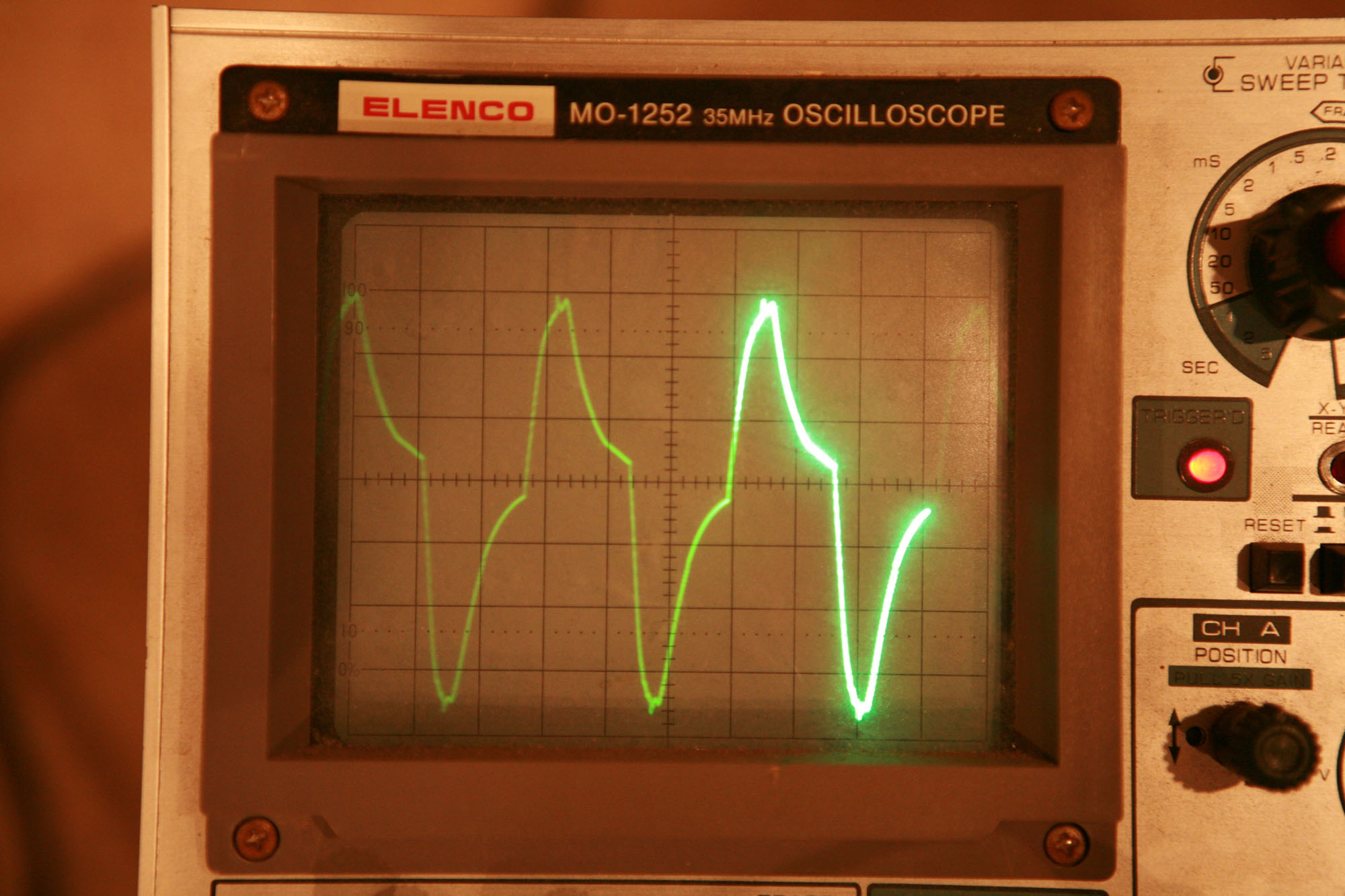

                        I made the measurements before that warning Bill so I'm uncertain if the measurements are valid or would shed any light on my board's problem. I'll have to get an isolation transformer as I don't have one on hand. The ground lead of my probe was tied directly to the neutral pin of the outlet for each measurement.
                        One of the images shows a funny waveform on input 1 (i.e. 24V) to the transformer with the transformer removed. On input 2 (i.e. 12V), the semi square waveform is constant under load or unloaded. Both transformer input 1 and 2 look the same (i.e. semi square wave 150V p_p) with the transformer on the board. The scaling on the unloaded waveform @ pin 1 is 20V/div @ 6 1/2 divisions ~ 130V peak to peak. The square waveforms are 50V/div @ 3 divisions ~ 150V peak to peak which would be more meaningful. The third photo shows All of the outputs as being less than 1 V referenced to chassis ground.
                        It seems to me that I should have some voltage at the transformer output.

                          I don't know how I can make this much simpler. You are dealing with a hot ground. The waveforms you are seeing do not reflect the actual voltage present ACROSS the primary windings of the transformer.

                            I think I understand Bill. That datasheet I believe helped me grasp this concept. I could be measuring what I think is a 150V sinusoid peak to peak when in fact a fluctuating reference gives me a meaningless reading. Moreover, a chassis ground reference is only useful with respect to a secondary measurement because the ground is the reference for that side whereas it is not on the primary.
                            So if I understand correctly, the isolation transformer kills any DC which would affect a scope reading via the common neutrals to the monitor power supply and scope. Moreover, the reading across the primary must be directly across the transformer (i.e. from figure 1 on that datasheet, it would be the dotted side of the transformer with respect to the non-dotted side on the return. Any other reading is useless.).
                            I'll get this test configuration and post scope pics.

                                Measurements:
                                (1) 12V/24V transformer input (one with respect to the other) is less than a volt with a very poor sinusoid.
                                (2) The rectifier (D10XB60) input is +/-160V peak to peak.
                                (3) The rectifier output (i.e. pin 1 referenced to pin 4) is 160V DC.
                                (4) D1 and Q101 have no shorts.
                                This rectified input leads to a yellow transformer which sits underneath the heatsink. (see 1st pic) Assuming this rectified input is the dotted input to the transformer, the non-dotted return has a diode D1 (anode side) and transistor Q101 (pin 2) electrically connected (see 2nd pic). Measuring this non-dotted side with respect to pin 4 of the rectifier is difficult because (a) it's close to zero and (b) has what looks like aperiodic switching. I can't get my scope to consistently trigger on it. I'm guessing an ic is switching Q101.

                                  One correction. That transformer under the heatsink is part of the PFC correction circuit. It corresponds to LP801 on the Samsung BN96-03775A schematic I attached earlier.
                                  Two points about the PFC correction circuit. It is enabled only when the main power supply is active. When it is active, the voltage across CP812 (in the BN96-03775A schematic) is about 385 volts. When it is inactive the voltage is about 165 volts.
                                  There are two concepts for the activation. The older controllers activate PFC correction when the PSON signal goes high. Newer controller designs activate PFC correction when the current demand reaches a certain threshold.

                                    CP812 in your schematic corresponds to the large cap on this board underneath the heatsink. When PSON is enabled, the voltage is in fact ~ 380V DC. When PSON is off, it drops very slowly down to ~ 165 V DC. It jumps to 380V very quickly, but takes a couple of minutes to drop down to 165V DC.
                                    Any suggestions up to this point? It looks like the PFC correction circuit is operating properly. I'm following your schematic as my board appears to be very similar.

                                      Yes, seems like PFC is working correctly. Not sure if this is how long it should take for the primary cap to discharge, though. If the primary supply is either detecting a fault on secondary or just faulty on the primary, this could well be why the primary cap is discharging so slowly.
                                      I think a good point to start would be to identify the PWM controller and see if is getting power. There are 3 ICs - U102, U201, and U202. What numbers are written on them?
