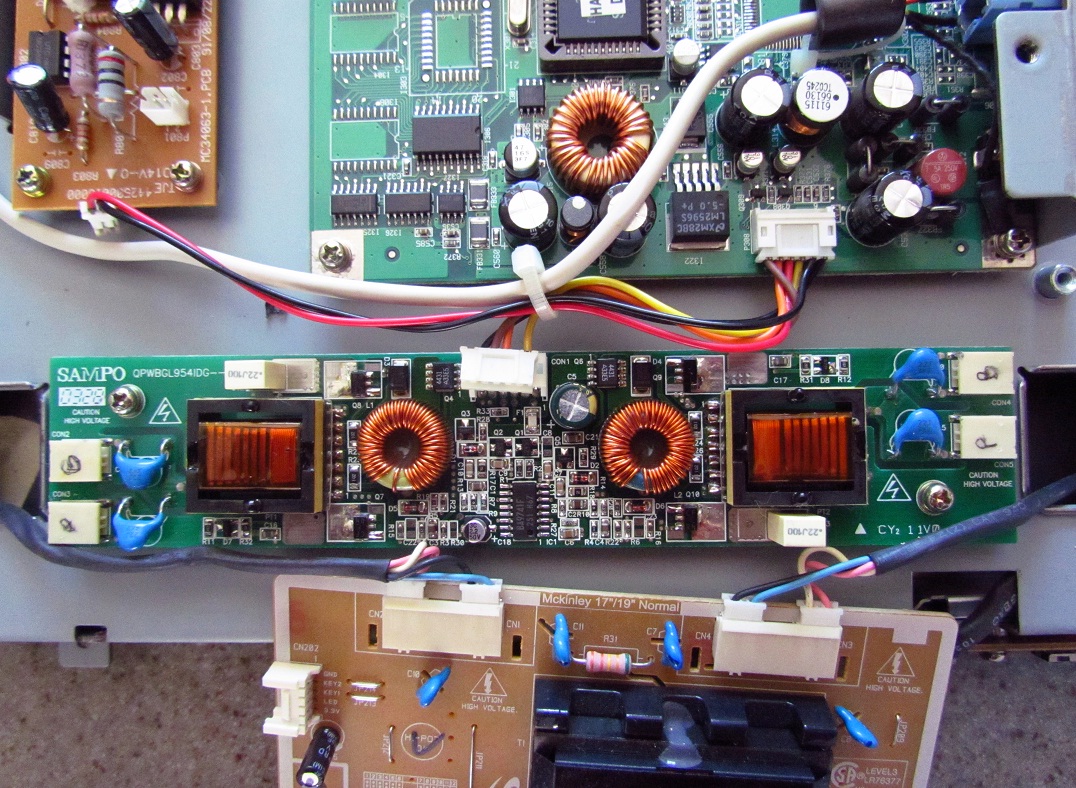

    I've bought this Elo 1825L that has a main logic board of PTB-1195 // 66832119500-01 in it. It showed no signs of power.(no lights available) after tearing apart and testing volatge with a volt meter I found the 12v... To start I decided to plug in to a laptop via vga cord, and test the backlamps with another inverter stand alone, to see what happens. So..... here is what I found:
    the inverter model is: QPWBGL954IDG--- Voltage Inverter / Ballast Board - Master for SYLVANIA PD-80A
    link can be found for purchase from here:
    http://www.discount-merchant.com/SYL...-p/1124777.htm
    After finding that link and placing the order, I decided to seek into this inverter more finding the fuse blown - F1 fuse blown (I think this is smd ceramic 4a)
    anyone help me out on choosing the right one from mouser of digi-key? I can cancel my order I believe from the discount merchant on that board
    I will also say that when I used the inverter from another power board, then pluging in the laptop to the elo monitor via vga cord the screen works great (other than after 30 secs or so... it shades purple with lines like a screen saver kicking in while the subst inverter makes a zeeezzzz noise before it blinks out) ...any tips? trying my best here ...BlkSmth

          I sourced a 4A fuse from digikey based on the 1206 package that I think will work:
          http://search.digikey.com/scripts/Dk...FF400F/32CT-ND
          A fuse can fail for no reason, or you may have a short on your inverter board. Try checking the mosfet transistors (4431) Q4 and Q6 for shorts. Also, check the 4 transistors (2 at each end) starting with Q7? for shorts. Hard to tell, since photo was cut off

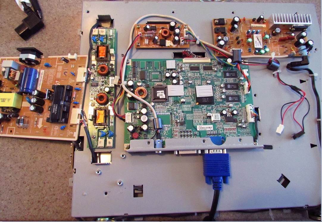

            whole inverter image updated

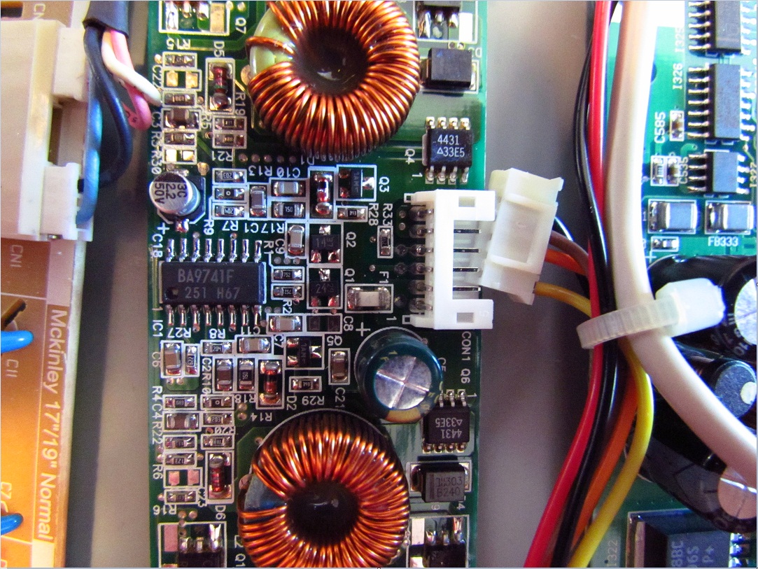

              Based on your new photo, check transistors Q7,8,9 and 10 for shorts. If the capacitor C5 is a unknown brand, consider replacing it.

                How to check that mosfet transistor (4431)? thats reffered to as soic8 right?
                • retiredcaps
                  • Apr 2010
                  • 9271
                  Re: Elo 1825L Touch Screen (need help choosing fuse)
                  See #2 at
                  https://www.badcaps.net/forum/showpo...0&postcount=13

                    On these 4431, there is no notch or dot to indicated whats pin 1...
                    now since the 8 pins are: 4 top all same pad, 4 bottom 3 same pad, 1 not lets assume 1 not below the number "5" on the top of this chip is perhaps the "G", meaning gate? so bottom row would be s,s,s,g ...then top row is d,d,d,d? I think that would be correct no? Thanks for all your help my friend!
                    • BlkSmth
                      • May 2010
                      • 89
                      nm.... heheh
                      I guess that is what the little "1" is on the board for after i look and pay more attention LOL. I'll report back here in a few.
                      make my theory correct though :P
                      • BlkSmth
                        • May 2010
                        • 89
                        DMM set @ 200k
                        SOIC LT of input plug: Q4
                        B S1,2,3 - R G1 = 39.1
                        B S1,2,3 - R D1,2,3,4 = 188.3 & starts climbing
                        B G1 - R D1 = NOTHING
                        SOIC RT of input plug: Q6
                        B S1,2,3 - R G1 = 38.8
                        B S1,2,3 - R D1,2,3,4 = 188.1 & starts climbing
                        • BlkSmth
                          • May 2010
                          • 89
                          testing on the transistors I find one that dont respond very well on Q2
                          I put the DMM on 200k still, black lead to pin assignment 1, red to 2,3
                          2 gives ohm 19.4
                          3 dont even make the DMM move....?
                          this means bad I believe...not sure what the values should be but all the rest on the board give readings from pin assignment 3....
                          how to pick this one for a replacement? not sure on how these numbers work.

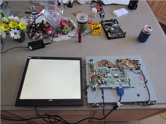

                              Since the board I already ordered, the board that I cannot cancel because it's in processing or has been shipped.... I decided to take a very small wire from a USB wire project from a Griffin Powermate (I mean very small!) and thus soldered it accross the fuse bad...bad.....) unit lights for about 30 secs the drops....eeeeewwww
                              so being creative I took and older aoc 712si 17" that I had laying around with a bad board with a small likely zenor diode and a removed donor 4502C for another elo 1925L model that I repaired with that part. Then having left over a screen of claa170ea 07 that had good bulbs with the same lamp style plugs, I decided to go dual
                              see the screen below....works with screensaver without shuting down unless 5 minutes go by which the laptop was set for screen power down. the mainboard is working when powered with own lamps for 30 secs, and with a flash light when adding Aoc backlamps.
                              looks as though from here that the bulbs caused the inverter to blow, thus thrashing the 4a fuse on its board... wired direct (again dont do this heheh no..no...no) I show it now works. Now the question would be..... shall I replace the elo 1825L 18.1" bulbs with the aoc 712si 17" bulbs since I really dont have any sources on the web after exhaustion of major googling for them? would it really un-illuminate correctly? I have never tried this before.....
                              dont axe me :P please for the extra soldering creation...normally I would not even consider this, but since it was infact a seperate board already ordered...well, you get the picture.
                              This other bulb testing has worked for 4 mouse pad laptop resumes from sitting idle. so more than 20 minutes so far.
                              One thing I didnt mention was the fact that I did reZAP the solder connections on them Q7,8,9,10
