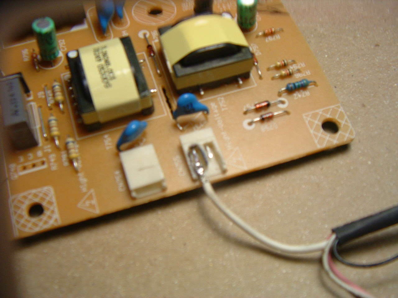

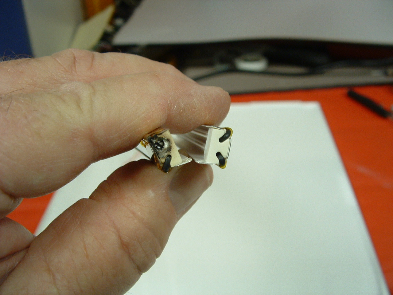

        Hi ,I have read this entire board about 2 am when I finally threw in the towel. I am trying to get this Dell E173FPb running again. Been apart about 20 times ,Think I might be getting lead poision already. I have tried all of the suggestions tests ect that I am capable of doing .I got the big old oversize MJE 3055 trannies,That many post suggested using .
        I have cut out the side so they fit (like a saddle on a cow). I have done everything I think possible. It would actually run hours witn out shutting down some times,till I did something like move or touch it. I thought "I got it" at least half a dozen times. But the result at the end is a dark screen,little green diode flashing (laughing )at me every time. I thought to myself,what do all these monitor have IN COMMON (there are sooo many on ebay that have the identical symtoms). I thought that crummy little terminal that connects the ccfl to the board. I would move these around and the panel would flicker some and mostly shut down(I didn't find this out till the day before yesterday ) . I had my most luck with it when I soldered the ccfl leads directly to the pins on the board. I knocked it around shook it banged it against the table ,didn't shut off at all. But I had a defective tube that would not restart once you shut off the monitor and tried to fire it again .You could see a spot on the bottom of the lcd panel when it tried to light up again like a rainbow shape only with out the colors. I believe these (relaxing with the heat )clips may be part of the problem . I replaced the tubes with others cleaned the pins up plugged the new (used) lamps on the pins .It fired up and ran along time before it shut down about 1 hour . I suspect the same thing with the loose pin connections that are falsely tight because of the plastic plugis tight. Think about it ,they are probably expanding as they heat up. The way they are made there is a VERY SMALL amount of contact with the pin. I am going to try and solder the new (used but working)ccfls and put the correct transistors in because I have a space heater of a desk top already.The 3055 trannies get as hot as 250 F degrees ,I checked them out with a heat gun and a probe to be certain,I saw temps normally around 150 F. What do you all think about this? ,Something I would have never thought about till I saw that thIng blink and shut off when I moved the wires and put the steel cover on. I am trying to get 2 monitors working out of the 3 I have here. Boy It hurts when you get zapped with that high voltage on those wires. Here are a few pics of what I am saying. also the transistor size difference for those who are coming on board for the first time. I call it the winter transistor cause it runs so hot.The little on is one that s--t the bed,you can see the hole and how loose this plug is if you zoom in .

            I absolutely agree about replacing caps ,I did do that . all that desoldering and soldering made me almost blind. I changed all the caps except for that 450 volt one could it be that one? here are better pictures.This pin pictured is really loose it would definatelycause a loose connection

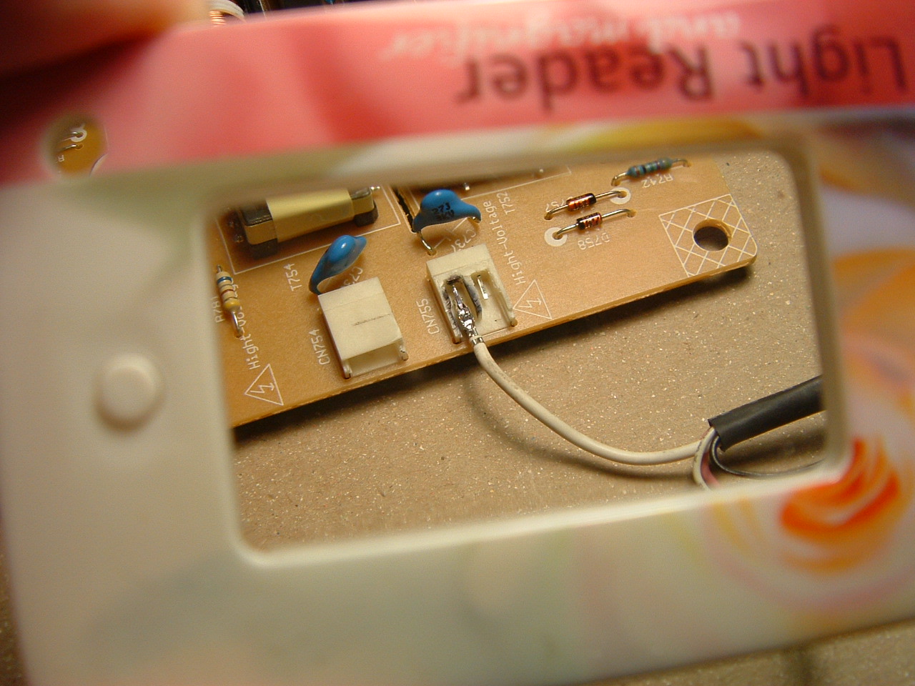

              Sorry, Jim ,my mistake you meant those little blue caps that go between the high voltage outlet of the transformers amd the output pins on the ccfl sockets. My goof. No I did not change those ,never read anything about them going bad, thanks for that advice and I will do that as soon as I can figure out what they are as far as a part # or is this something that is common to all invertors .I am flying by the seat of the pants here and relying on alot of good smart people on here to get me straightened out.I am an old dog trying to learn some new tricks.
              Here is that transistor picture I can't seem to get posted.
              I am pretty good at keeping a secret,it's the people I tell that can't keep their mouth shut!

                Just remember that this is high voltage at that point. They are 3kv caps.
                So you don't want any solder spikes or leads sticking up.
                There is even sometimes an air gap in the board under them to keep the arking suppressed.
                If you fire up your laptop for any length of time,
                just run your hand along the lower edge of it's screen.
                Those inverters have been made so small that they get hot, very hot.
                Many are wrapped in flame retardent material.

                  OK Jim ,I have learned that there is some serious power there. I accidentally pulled one of those ccfl plugs out while it was running(I guess it don't shut down when it is trying to arc weld) . I am not kidding the arc burned the plastic as it was going to ground like a little lightning bolt .I panicked grabbed it to pull the power plug out of the bottom and I got a large dose of some p-ssed off electrons. Got a good shock 2 times already from that bad boy.There is some new found respect happening here.I really don't understand where it goes to 12 volts,I assume there is 12 volt somewhere on this board I thought it was at the large transformer ont the safer side of the board. I wish I had the schematic for this dell e 173 FPb.

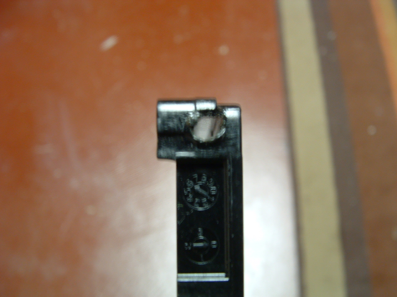

                        Wicked when it has nowhere to go, I just took apart another monitor I picked up . I found one of the plugs messed up (somebody tried fixing it before) looks like the ground was lost somewhere along the line . I couldn't believe how it burned through the plastic housing ,burned the wire off and cooked the rubber insulator and lamp holder.Or just maybe they had the high voltage post connected to the skimpy little groung wire. I was impressed how it bored it's way out seeking a ground,bet it stunk a little when it happened.

                          Anew developement with my dell (pita) W173 fpb. It worhs beautifully since I changed the power fuse at 751 ,only thing now the back light stays on when you shut the thing off or the computer off now,it works too good, AHRRRRGH.
