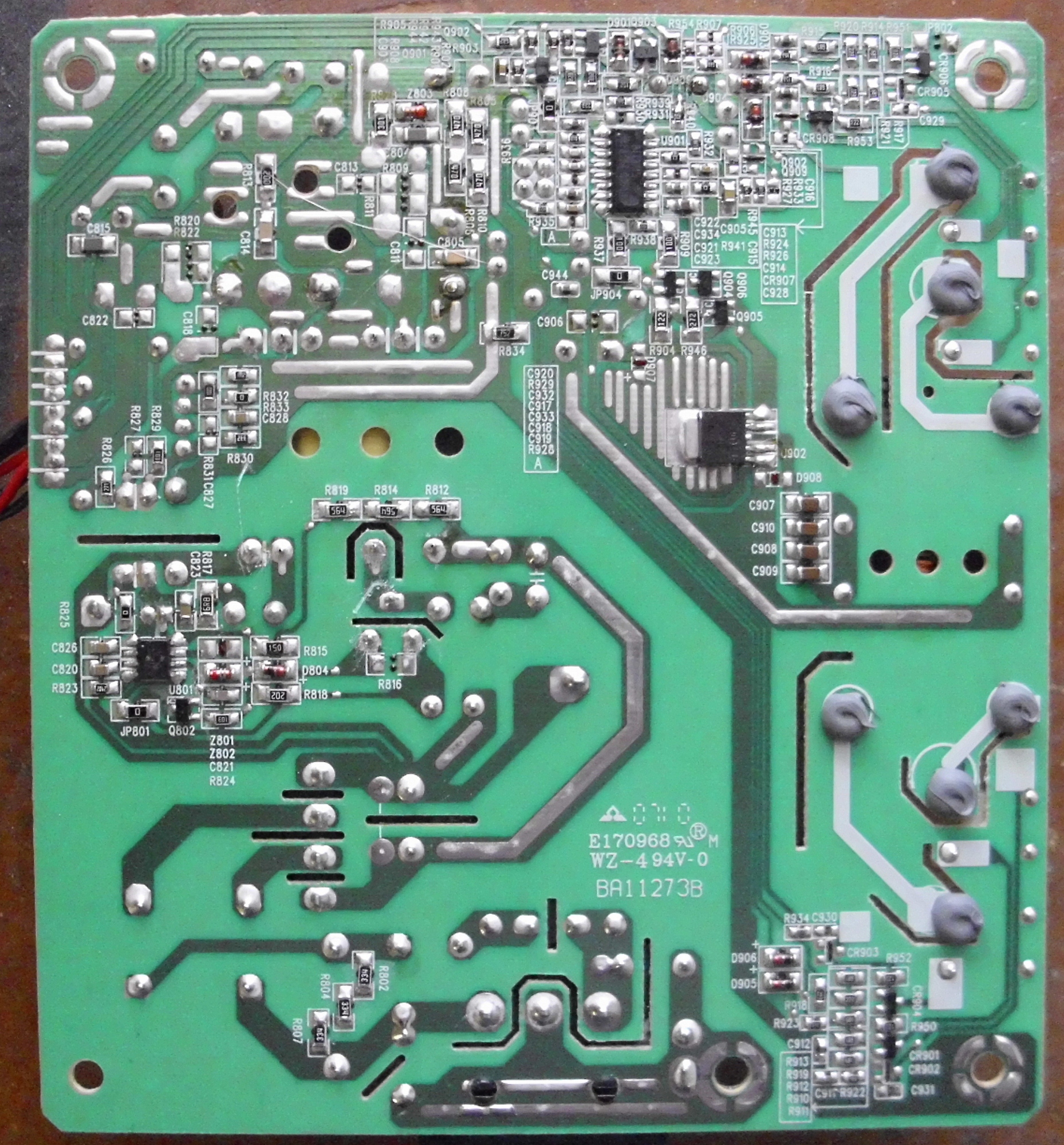

    I have a Optoquest Q9 monitor that has no secondary voltages.
    It uses a SG5841 SMPS controller.
    I have a steady 162volts D.C. at the large capacitor.
    I can follow what I think are a series of startup resistors R812 R814 and R819
    The voltage starts up stable at 162 volts on R813.The voltage through R814 starts to become unsteady jumping from 59volts up to 62volts,and the voltage is really unsteady through R818 jumping from 12volts to 17 volts very rapidly.
    Pin #3 of the SG is the Vin at its very unsteady jumping from 12 to 17 volts rapidly.
    Pin 7 VDD is jumping from 11 to 15 volts .
    Pin #2 is FB and its jumping from 0 to 4.5 volts rapidly.
    There is 50v 10Uf C824 that has been replaced. The voltage on it is jumping from 11 to 15 volts rapidly
    Because of the unsteady voltage at the Vin pin#3 I suspected a problem with the SMPS controller, I have replaced it with one I had from a spare board that was working. It did not make any difference the voltages stayed the same.
    http://pdf1.alldatasheet.com/datashe.../SG5841SZ.html
    What am I missing?

                A little bit of an update,
                I have replaced diodes 802 and 808 these are on either side of Q801 mosfet ,There are two large resistors R821 and R803 and these check OK.I also have substituted a good mosfet Q801.
                I have removed the 24v, 12v and 5v capacitors on the secondary side to try to rule out something on the secondary drawing an excessive load, I am still noticing the voltage fluctuation to pin 3 of the SG component.
                I am noticing something different today. If you look at the picture of the bottom side of the power supply just to the right of the A.C. plug. CR904 and CR901 are clicking, its very noticeable.
                These are BAV99 which are switching diodes, Could this be a clue of anything else to check

                        My understanding of how the SMPS works if very fogy .Pin #3 of the SG5841 is fed from R819, And the voltage is jumping all over the place.
                        I have tried to isolate to one side of the P/S, I am unsure if I did it the correct way. Earlier in the process I did remove the photocoupler to see if voltages would stabilize on pin #3 of the SG component.
                        Other than getting grand Uncle Blackbeard's blunder buster out, I'm unsure on what to try.
                        Is there any thing I have missed on the primary side that could be causing this problem?
                        You say The SG5841 and SG6841 have similar pin outs, Could SG6841 be used as a substitute, I notice that part on a lot of used power supplies that I have sitting around?
                        I am totality up to suggestions so if anyone has ideas I am willing to try.

                            Unfortunately I have not found a circuit diagram I am just trying to compare things between a working board and the one that's not working

                                        Re: Optiquest Q9 No secondary Voltages
                                        The part number and revision can be seen in the first photos.
                                        If you need any thing else let me know
