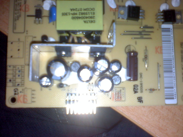

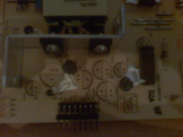

    I have recently been experiancing power issues with my Chimei 19" CMV 946A. I diagnosed this problem as a capacitor issue (power light stays on, strange hissing / buzzing sound well running, blank screen) and after opening the case i seen the expected bulging caps and a little corrosion on one of the aluminium tops.
    So i have decided to replace the whole set as they are CapXon which ive heard arnt very good and also im not 100% sure what one are broken and what ones arnt. The only problem is that i have no idea where to start in buying the new capacitors .
    The caps i removed where:
    CE101 - 220uF 25v
    CE102 - 1000uF 10v
    CE103 - 1000uF 25v
    CE104 - 1000uF 25v
    CEGiantSmudgeOfGlue - 2200uF 10v
    CE109 - 220uF 25v
    They are all Black with a grey stripe going up them. (see attatched images)
    I would like a good brand name that would work as a replacement to these (i hear nichicon HE is good), but i dont know what particular models i should be looking for that would be compatable with eachother and my moniter. Any suggestions willl be apreciated.

    PS: Sorry for picture quality its only a 1megapixel camera.

                                    Which 6 caps? I count 7, and there are at least 2 more that are not visible in the very bad pictures. (That was a hint to provide a good picture of the power supply.)

                                      The 6 which are listed in the first post. These are the vertically mounted ones shown in the picture.
                                      There are 2 other caps on the board, the horizontally mounted redish coloured one which is visible in the picture, and the large one on the high voltage side of the board.
                                        Re: Chimei CMV 946A caps
                                        There are 2 more capacitors you did not list,Going from memory they are a 50v 47UF and 50v 22UF these are very small capacitors around 4mm in diameter.
                                        You really need to provide some better focused pictures of the entire board.
