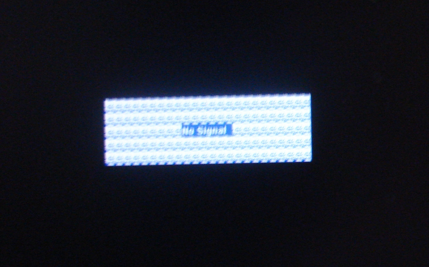

    I have another LCD with a problem. This one has a blank display.
    When the monitor is powered up with no computer connected, the display shows a No Signal message after several seconds and then goes blank. The power light also changes to amber.
    With a computer connected, the display remains blank and the power light remains green. I have shined a flashlight on the screen and I am not able to see any image.

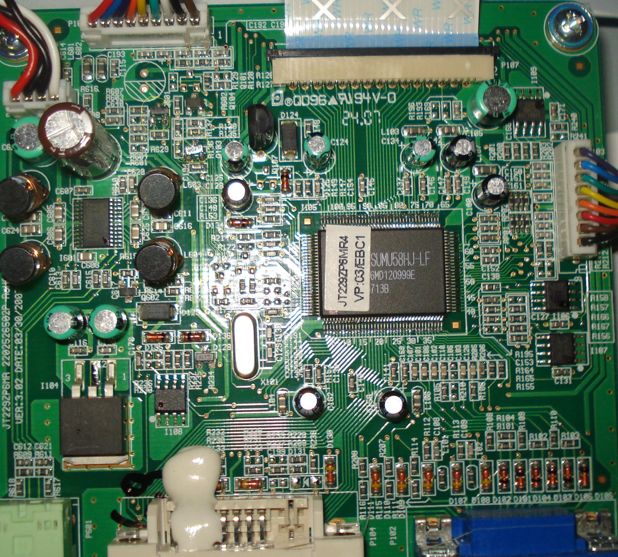

    On the logic card, there is a voltage regulator at I104. With respect to ground, list the voltages on all pins.
    Please also report the part number of I104.

        Did you try repairing the logic board at all? Looks like two transistors have been resoldered/replaced? Circled in photo.

          I will check the voltages when I get home. However I did note that the middle leg is missing on that regulator. The part number is 1084-33 0712HL.

          I removed both transistors to test them out of circuit. So the poor soldering is my handywork. (it's a bitch soldering those little things)

            Pin 1 is 0V
            Pin 2 is 3.3V
            Pin 3 is 4.7V

              Looks like the 3.3V output is good. Input should be closer to 5V, but 4.7V will do.
              Did you verify that the video cable used to connect your pc to the monitor is good?
              When you say the screen is "blank", I'm assuming that the backlights are also off?

                Why does I104 not have a pin #2 connected to the board?

                    The middle pin of I104 is internally connected to the metal tab on the back of the regulator.
                    You should at least be getting an image, since the the logic board is getting 5V.

                      Since there is no image from either the DVI or VGA line, could the main IC on the logic board be bad?
                      The only image I ever see is the No Signal message with no input connected.

                        Yes, I'm starting to think something is wrong with the scaler chip (main chip).

                            No way to replace the scaler chip. As for the way you tested the caps, it will give very limited results at best. Since you had them out, it would have been best if you had just replaced them all with Panasonic FM or FC series caps.
