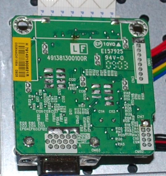

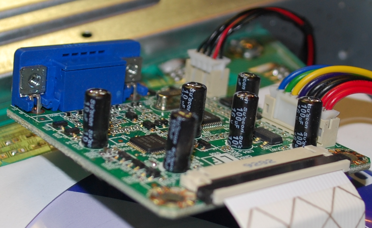

          My Acer v193w has a different problem
          Just got one myself. It displayed typical behavior in terms of power. I got the "Cable Not Connected" message and the "No Signal" messages when I turned it on and plugged in the video cable. I was not able to get a video image, so I focused on the video board.
          All are Su'scon caps. Three of them at 10 uF and 25V tested around 9 uF and 4.1 - 4.5 Ohms on my ESR Micro 3.1 and all capacitors were tested in-circuit.
          The capacitor opposite the VGA port and the one near the center feature 150 uF and 10V and tested around 93 uF and 0.30 - 0.45 Ohms.
          I'm worried about the one on the opposite corner from the VGA port. It features 100 uF and either 10 or 16 Volts. When I apply my ESR Micro 3.1 needle probes, the meter freezes (it was set to cycle between displaying capacitance and displaying ESR). I have to remove at least one probe to get my meter to cycle again. While I get ESR around 0 Ohms, capacitance is anywhere from 1000 Ohms to (X times 10^4) Ohms.
          I'm planning to start with this wacky capacitor, but I'm also wondering if I should work on the other five.
          I can't figure out the best way to remove the power board, either.
